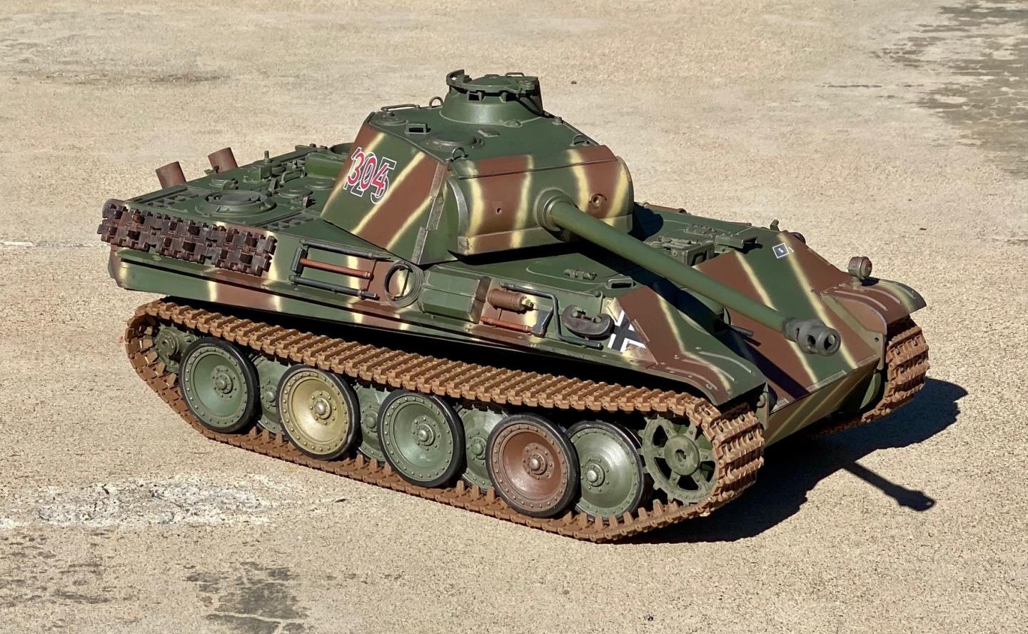

    Can someone please identify what this accessory is that I have circled in red? I have scoured the Internet and cannot find it anywhere. It’s the oval item mounted on side of the panther

    Hello all, I have a heng long /motion RC professional edition panther five question having to do with tension on the metal treads. So when I was inspecting it, I noticed one of the idler wheels was significantly back further than the other one. After doing some investigating, I found whoever put it together at the factory put on one of the plastic idler hub supports on upside down. So when I went to put it back together correctly, when I try to put the track back on which what feels like it is at the proper tension. I can see it putting tension on that plastic idler hub support. I know that’s not good. So when I adjust it to the next lesser tension setting, it feels like the tread is sagging too much. If anyone has a panther five professional edition that has the treads dialed in could you send me a picture of it from the side so I can compare it? My tracks are currently off for painting, but I will attach pictures of the angles that I have the plastic idler supports set at. This is the setting that feels like it just has a little bit too much slack but it’s not putting Tension on the plastic hub support. Thanks In advance
    Edit… I did look back and I did take a picture of what appears like it is too much slack in the tread, but this is the least amount that won’t put tension on the plastic hub. Thoughts? Thanks again.​

    Some tanks like loose tracks...some don't. All you can do is experiment. Most modern tanks like tight tracks. Those Panther tracks looks a little tight, but if it's reliable that way it may not be worth messing with.
    Ha ha I’m going to take that advice to not mess with it if it works.. I have the tendency to tighten the screw until it breaks, then back off a quarter turn 🤣
    thanks for your input 👌👌
  • tank_me

    I repaint the tires. I use a small brush, it's very easy. I use Tamiya's NATO Black, it's a charcoal'ish color.

    Ah ok I gotcha. Thanks . Looks great. And am I correct that the professional edition does come with plastic road wheels? Not metal?
