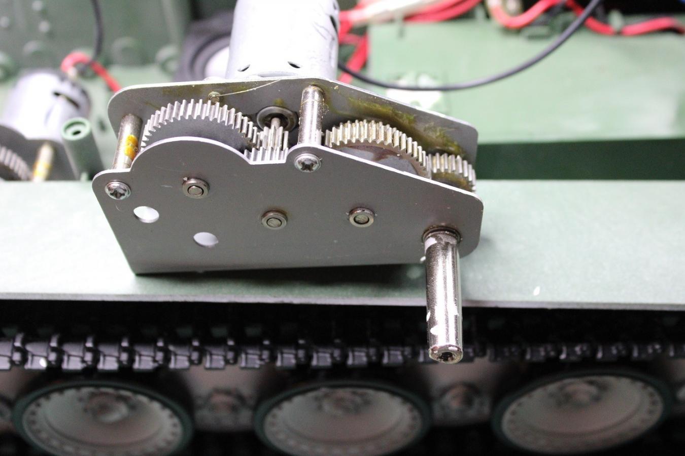

        This is the problem. The gears turn but the shaft does not turn. It is stripped? II may be ahead of myself but if I need a new right gear box, might as well upgrade the whole set of gears. What do you suggest that drops right in w/o additional things like cooling fan ? Dai
        • #44
          I remove the right driving wheel and the motor. I see the shaft is now turning with the gears so the issue could be either the connection between the shaft/driving wheel or the gear of the shaft to the motor is stripped does not allow enough torque to drive the sprocket. Dai

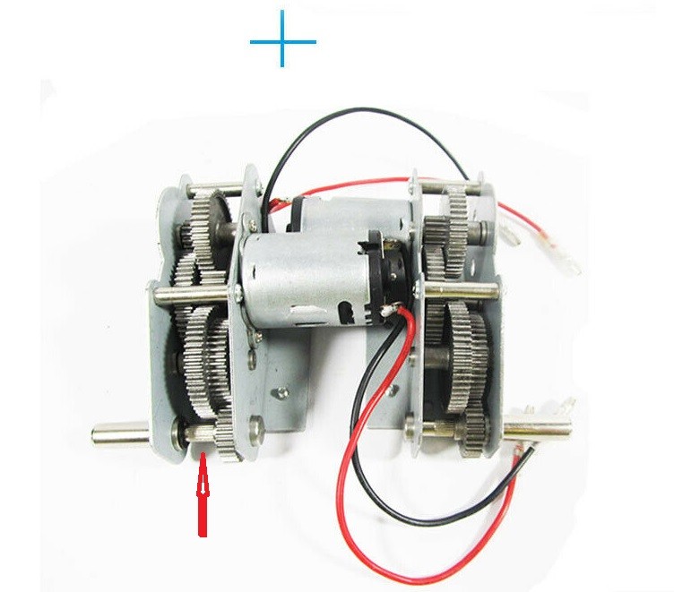

              I spoke to Toucan and the right gear box is damaged. They will send replacement but I would like to upgrade with after market parts so I can see a difference. How about this one ? Thanks Dai
                That is a very slow gearbox “5:1” ratio. Stock HL gearboxes are “3:1”. It is mostly used in tanks to represent heavy slow speed handling characteristics. It is smooth running but can be more noisy then stock.
                Overall it have its place most in WWII tanks.
                • #48
                  it is 3.1 as advertised. Thoughts? Dai
                    Based on the photo their products description is wrong. I have two of those they are NOT 3:1.
                    • #50
                      What do you suggest for a drop in upgrade? Dai
                      • #51
                        A solid upgrade gearbox is a Taigen 3:1 or HL Red frame gearbox. The Taigen shafts are very tight fitting with the HL sprockets and most all the time need to be filed/sanded down just a bit to fit cleanly.
