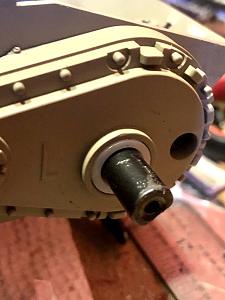

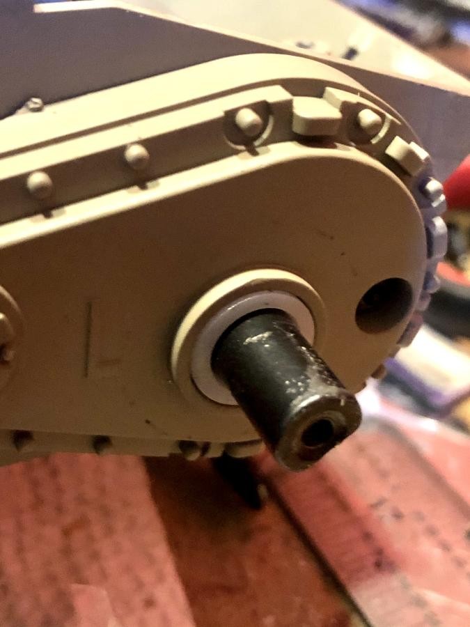

        Here's the bearings that I got. They snugly slip onto the driveshafts and can be pressed into the holes in the side of the lower hull wall where the driveshafts come out.They can be fit by tension of a dab of superglue. As an aside note I've found the bearings more important on Tiger I's.

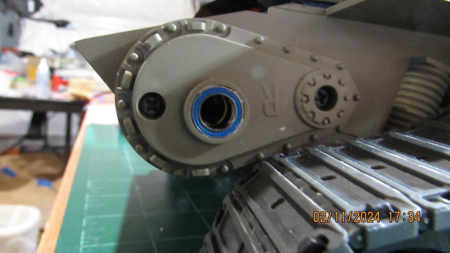

              For the Heng Long ball bearing need, I use Uxcell brand bearings from Amazon. Cheap, shipping fast and known quality. Not sure it is as good as Fasteddy bearings, but is definitely good enough for HL tanks.
              The picture below is an example on the HL Merkava.

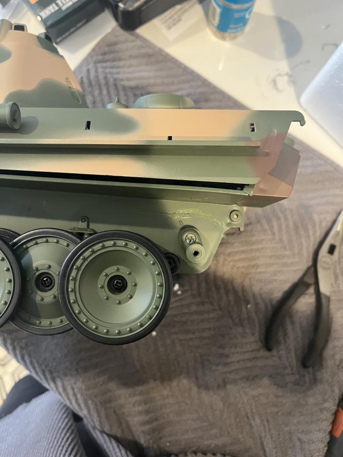

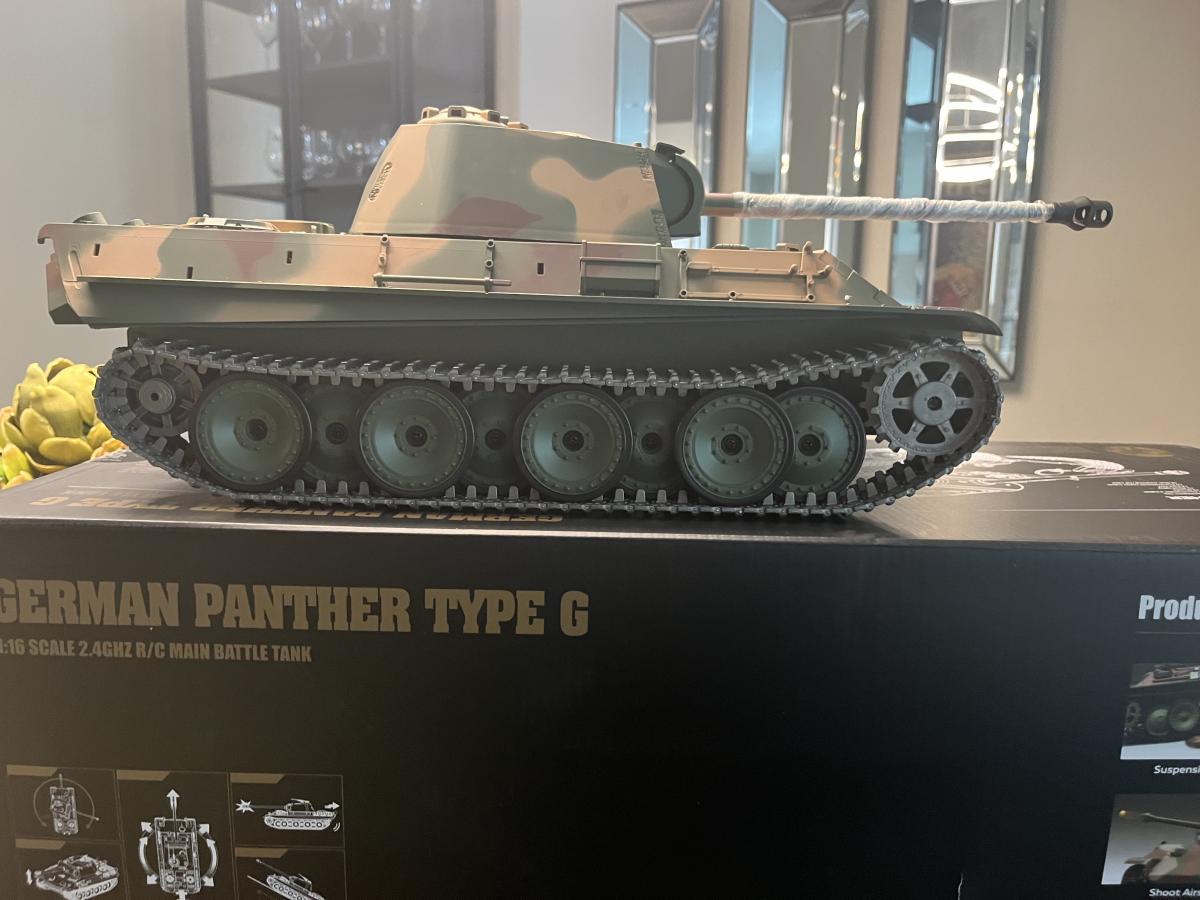

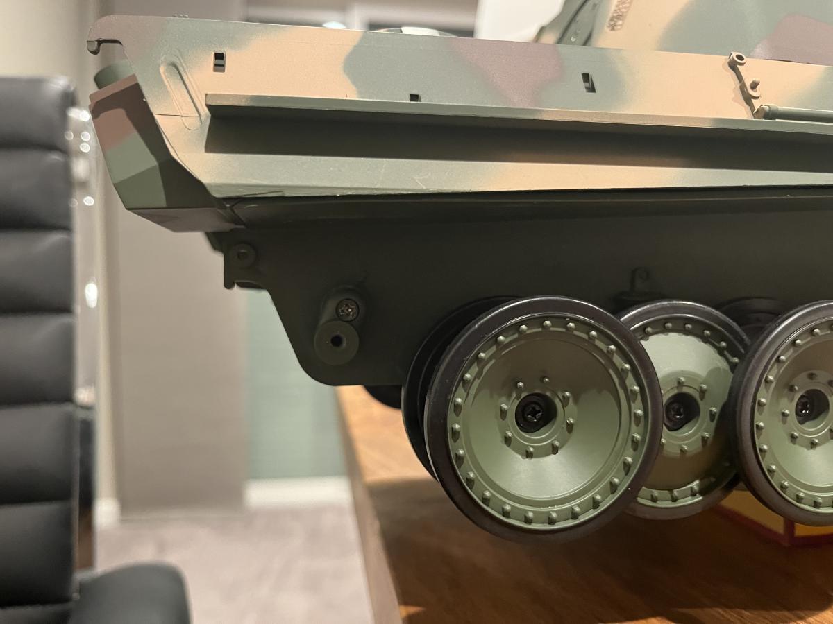

                  Hello all, I have a heng long /motion RC professional edition panther five question having to do with tension on the metal treads. So when I was inspecting it, I noticed one of the idler wheels was significantly back further than the other one. After doing some investigating, I found whoever put it together at the factory put on one of the plastic idler hub supports on upside down. So when I went to put it back together correctly, when I try to put the track back on which what feels like it is at the proper tension. I can see it putting tension on that plastic idler hub support. I know that’s not good. So when I adjust it to the next lesser tension setting, it feels like the tread is sagging too much. If anyone has a panther five professional edition that has the treads dialed in could you send me a picture of it from the side so I can compare it? My tracks are currently off for painting, but I will attach pictures of the angles that I have the plastic idler supports set at. This is the setting that feels like it just has a little bit too much slack but it’s not putting Tension on the plastic hub support. Thanks In advance
                  Edit… I did look back and I did take a picture of what appears like it is too much slack in the tread, but this is the least amount that won’t put tension on the plastic hub. Thoughts? Thanks again.​
                  • SoCalBobS
                    • 2761
                    • Southern California
                    #129
                    The test is in the driving; if it's too loose, the track will ride off the sprocket teeth, especially when turning or backing up in rough ground like sand dirt, leaves, bark or grass. If it doesn't, it's ok. Its good to keep an eye on the idlers, as they are the weakest link in our plastic tanks' suspension.

                      #130
                      I appreciate it thank you. I could see how those plastic idler attachment points could easily get overstrained. I have looked, but I don’t see any metal upgrades for those for the panther g

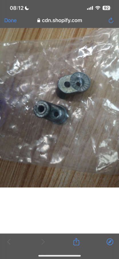

                        #131
                        Went straight to heng long.. these are on the way

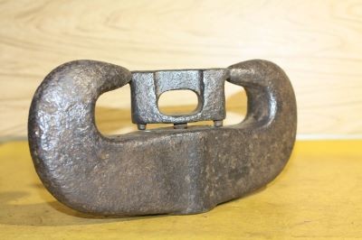

                              Can someone please identify what this accessory is that I have circled in red? I have scoured the Internet and cannot find it anywhere. It’s the oval item mounted on side of the panther
                              • tdriver113
                                • Apr 2023
                                • 111
                                • Peoples Republik of Illinois
                                #135
                                That is a " C Hook " used to connect cables for towing or lifting.

                                  Perfect! Thanks for the info

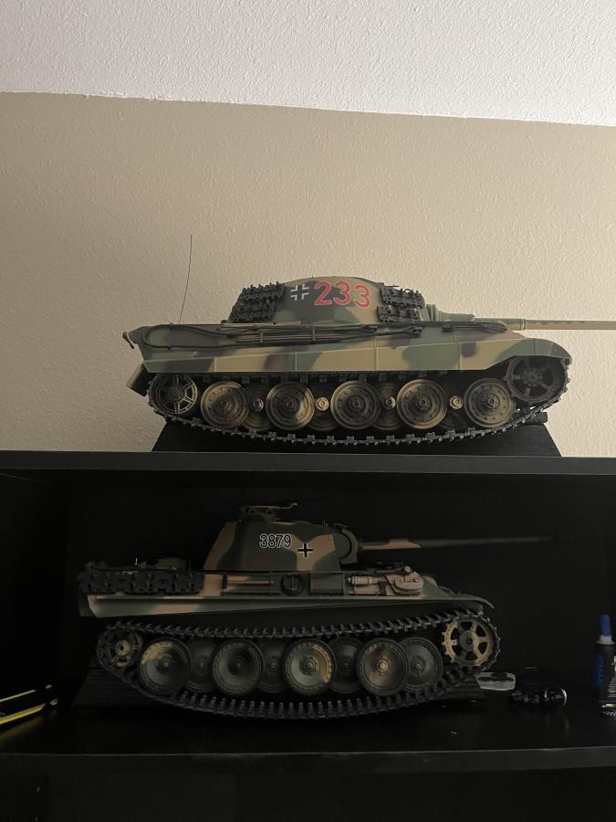

                                      I’ve got 4 HL tanks with 7.0 and they don’t have a bad squeaky turret noise. I have a king tiger pro with the all metal road wheels . Works very well. I found the metal hubs caps on the road wheels would pop off so I tacked them on with a small dab of rubber cement .
                                      I also have a panther professional edition (with plastic road wheels though) . The only issue I had with it was one of the idlers sat at a significant angle causing the track to bind on it. After shimming it to have it sit parallel to the rest of the wheels it’s been great

                                        I like your wheels. I painted mine all green but the color came out a bit brighter than I anticipated. I may remove the wheels and repaint them. What’s really awesome about the metal road wheels is that the tires come off really easily but also stay on during operation. Thank you.
                                          • 5415
                                          #140
                                          Great painting goose!
