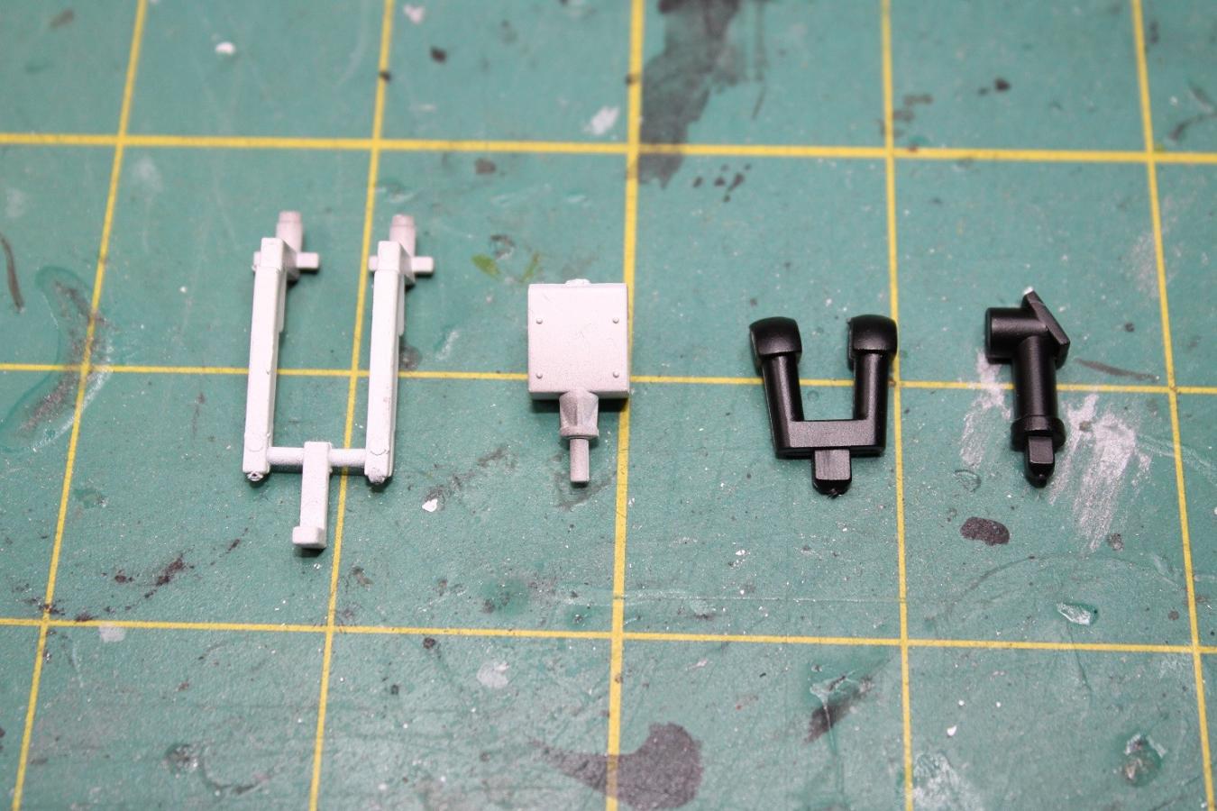

                        Hi all,
                        Can you please tell me where these parts go? Unless I am wrong these are for the fantasy Panther? Dai
                        • Sureshot
                          • 235
                          #32
                          I think the one on the left goes on the LH side of a Panzer IV. Not sure about the others.
                          Steve
