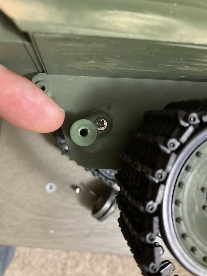

                        Originally posted by MaverickTank
                        I think it is the plastic block that the idler axle screws into. When there is a little force on it the block flexes a tiny bit.
                        The idler wheel is fine. In fact, I tried two different wheels with bearings and both were catching the track horns.
                        Is the block the idler screws into flexing where it attaches to the chassi, or where the idler screws in? Have you thought about using some 1.5mm aluminium plate bonded to the chassis and fixing the adjuster with a longer nut and bolt? This would spread the tension over a larger area over the chassis. Click image for larger version
                        Excuse the highly technical drawing. Hopefully it will explain things better than my words.

                          #112
                          Thanks for the drawing, it says a million words.
                          I have seen how others have done that, and how the aftermarket parts run a rod across the width of the tank. I'm going to try trimming the idler wheel first before I get into that kind of surgery. Good suggestion though.

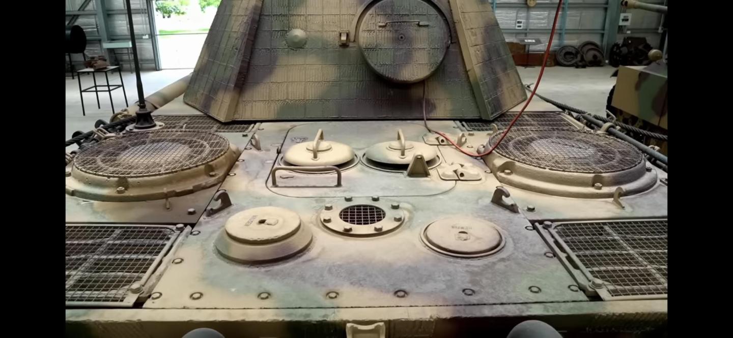

                            Originally posted by MrChef
                            Looking really good Srudiocat12! I like the pigment work, exhaust rust and soot.
                            Just FYI the screens on the rear deck go on top of the grills to prevent any grenades or other such from getting tossed in and mucking up the works.
                            I know this is an older thread but wondering what you used to do the Zimmerit on your Panther. Looks nice.
                              Just luck I checked back. That's a picture of a real Panther tank at the Australian Armor Museum.
