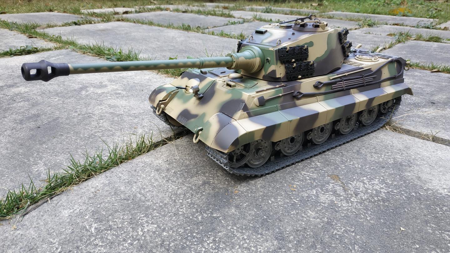

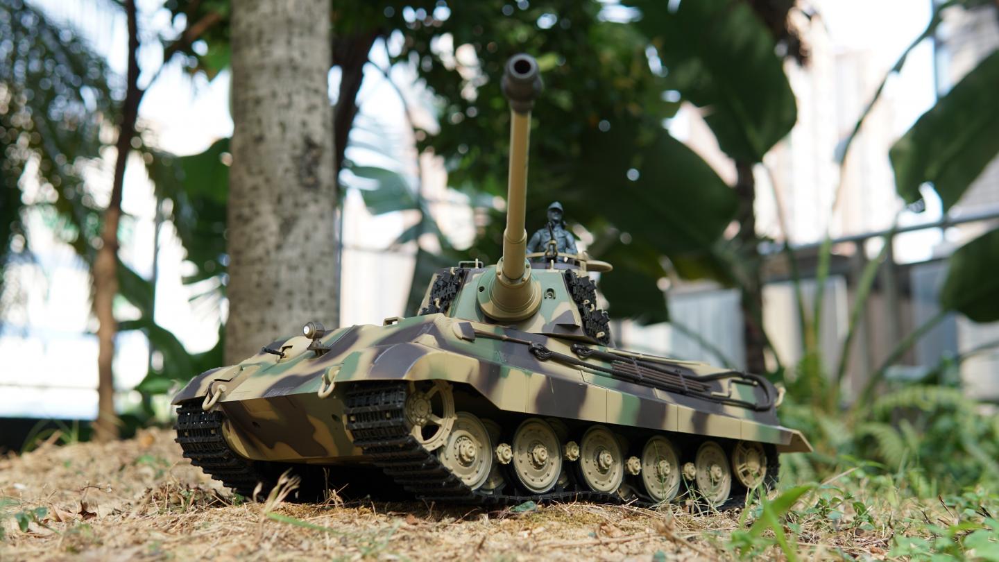

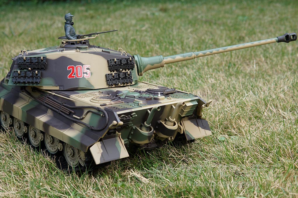

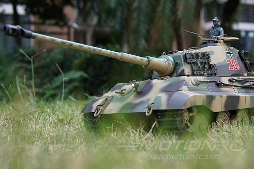

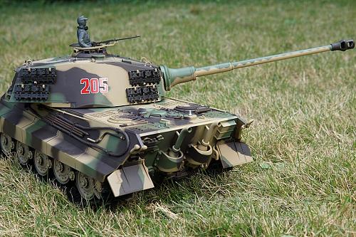

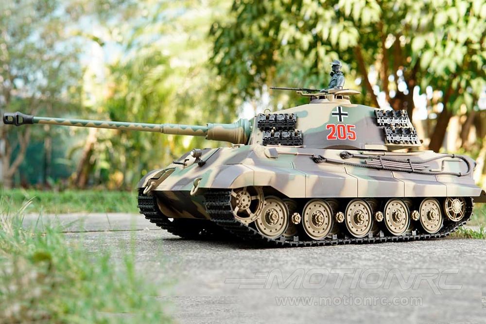

    Introduction:
    One of the largest tanks fielded in WW2, the Tiger II or "King Tiger" was built around a fearsome 88mm cannon, capable of piercing every type of Allied armor at over 1,000 yards. First deployed along the defensive lines following the Allied landings at Normandy in June 1944, the King Tiger was a potent weapon when deployed properly, but due to war material shortages and hampered by engine reliability, failed to make a significant impact on holding back the Allied advance. Of the approximately 1,200 units produced during the war, only two remain in running condition today.
    My Personal Averaged Total Score for the Heng Long 1/16 Scale "King Tiger": 87 out of 100
    The Heng Long King Tiger is an impressively large tank and literally stands a shoulder above all other tanks in the 1/16 scale series. If you want big, the King Tiger is worth a closer look. Read below to see how I arrived at this rating.
    As a visual companion to this written review, our Overview and Build Summary Video can be found below:

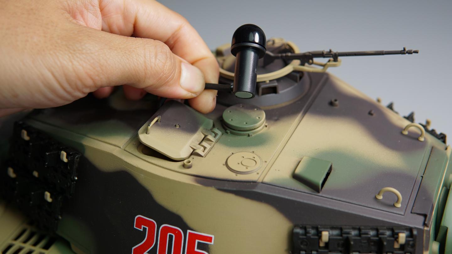

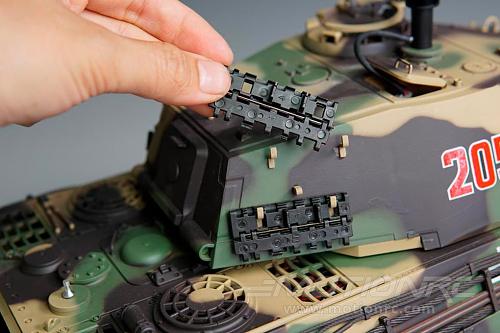

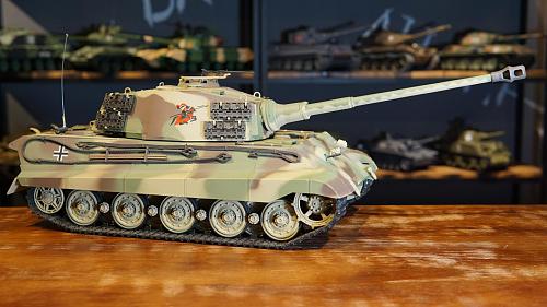

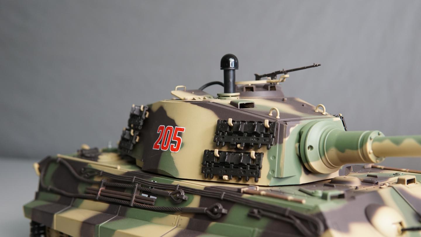

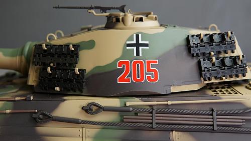

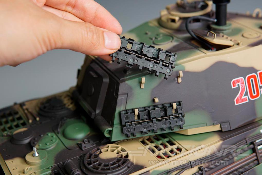

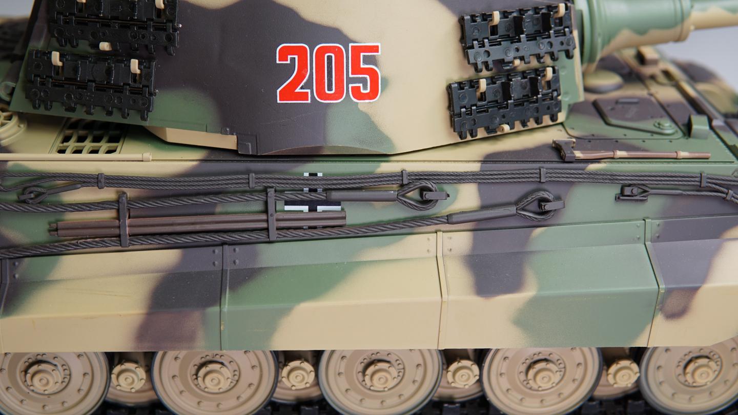

    Several sprues of plastic parts are provided for the modeler to install on the tank. These all plug into pre-drilled holes, and are nearly "snap fit". A few of the parts were loose, so I bonded them with ABS glue. But otherwise, I prefer to keep the parts unglued so they're easy to remove or replace if needed in the future. Plan for about 30-45 minutes to clip the parts off their sprues and attaching them to the outside of the tank. I recommend a sharp clipper designed for this purpose, as it makes cleanup much easier.
    The King Tiger's pre-painted tools, shackles, and tow cables clip onto the hull and turret with ease. Most of my time was spent assembling the tracks and arranging them on the turret, as shown below. I like that these tracks are functional track links, that can be used as spares if your track links ever need replacement. In addition, the track links shudder along with the tank's track recoil effect, which visually enhances the overall realism, as I imagine the recoil of the real tank's massive gun would cause anything loose on the tank to shake.

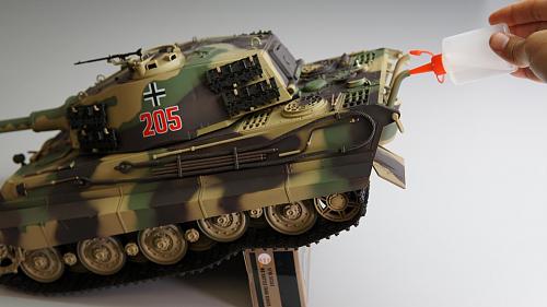

    At this point I also take a moment to hold the tip the tank's rear upward about 45 degrees and insert 1-2 small drops of glycerin oil into the exhaust stacks. The smoke effect is expelled through these two exhaust stacks, so don't flood the exhaust stacks. Less is more!
    Click image for larger version  Name:	DSC00051.JPG Views:	1 Size:	88.4 KB ID:	220882

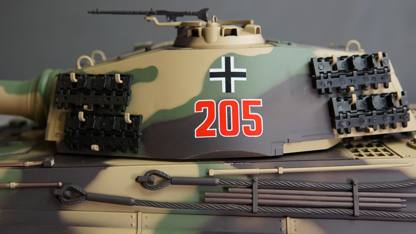

    Users may choose to glue down the spare track links onto the turret, but I prefer to leave them unglued. During transport, I'll remove them, the commander's machine gun, and the rear fenders. These are the only "loose" parts that are susceptible to falling off during transport due to their exposed locations. I also do not glue on any of the "hub cabs", because these also may need to be removed in the future for cleaning, tightening, or replacing.

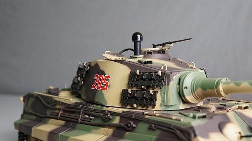

    Decals:

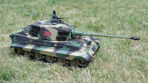

    Apply the decals, as desired, on a cleaned and dried surface, using the instruction manual's clear diagrams. These are simple "peel and stick" adhesive vinyl decals, NOT water slide decals, so do not soak the decal in water otherwise you'll ruin the adhesive. Stick the decal to the surface, then use the back of your fingernail to firmly burnish the decal onto the surface, then carefully remove the clear upper film off of the decal itself.
    Like many tanks, the King Tiger doesn't have many markings on it. Besides the German crosses, two decal options are provided, a simple red 205, and turret art depicting a knight on horseback. I chose the red 205.
    Click image for larger version  Name:	DSC09707.JPG Views:	0 Size:	161.9 KB ID:	220905Click image for larger version  Name:	DSC08935.JPG Views:	0 Size:	138.8 KB ID:	220904
    After applying the decals, you may want to seal them in with a clear coat such as a spray can of Testors Dullcote or WBPU ("Water Based PolyUrethane") from either Minwax or Varathane. I didn't apply a clear coat, but the decals continue to hold well to the surface, so I do not consider a clear coat absolutely necessary for casual use. If you do decide to apply a clear coat, always test under the tank first to ensure the colors do not react adversely to your chosen clear coat product.
    Click image for larger version  Name:	DSC00052.JPG Views:	0 Size:	110.5 KB ID:	220886Click image for larger version  Name:	DSC00053.JPG Views:	0 Size:	133.3 KB ID:	220887

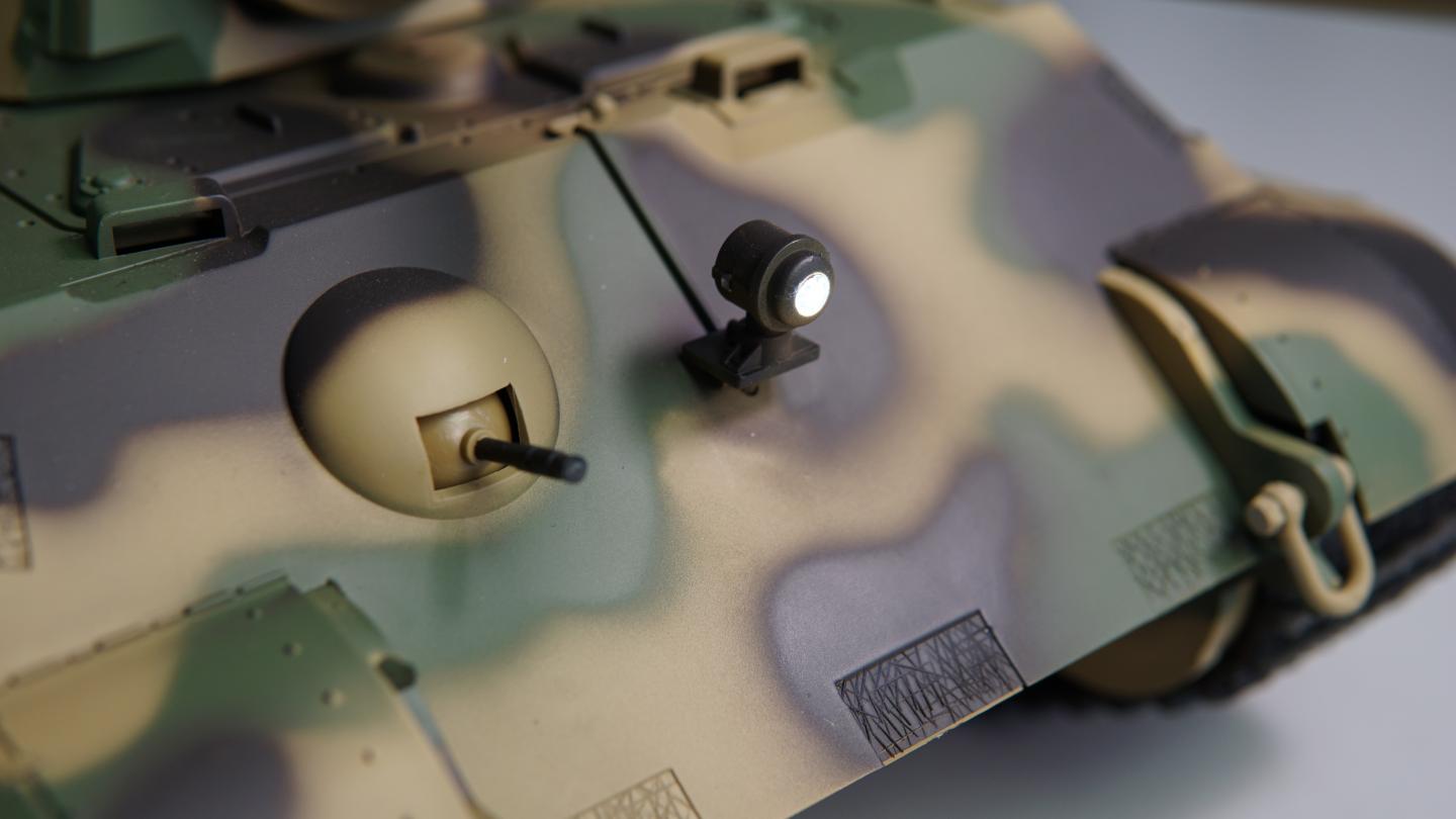

    The King Tiger's real headlight is replicated with a white LED. A low-brightness light on the rear hull face is not present on the Heng Long. As a wartime tank, there aren't any other lights such as brake lights or turn signals on the real King Tiger.
    Click image for larger version  Name:	DSC00039.JPG Views:	0 Size:	67.0 KB ID:	220888

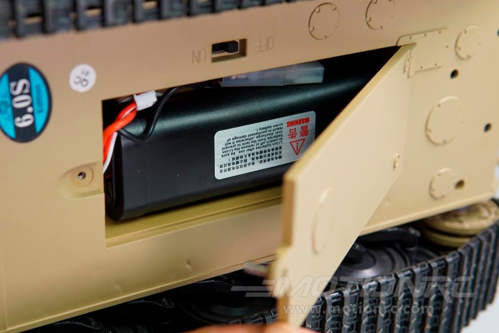

    Plug the battery back into the battery bay under the tank. I like how Heng Long designed the screw to always stay connected to the battery bay door, so it's impossible to lose that little screw. The 2s battery uses a Tamiya-style connector for main power, and also has a conventional three wire balance plug. I've found this to be convenient for checking the battery voltage with my battery voltage checker, just as I do with my larger airplane batteries. Heng Long's system will automatically shut down when the battery is depleted, although I prefer to use a low voltage alarm to notify me before that happens.

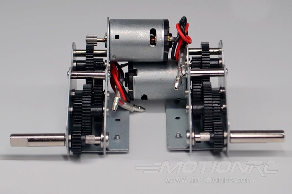

      Gears, Driveability, and Run Time

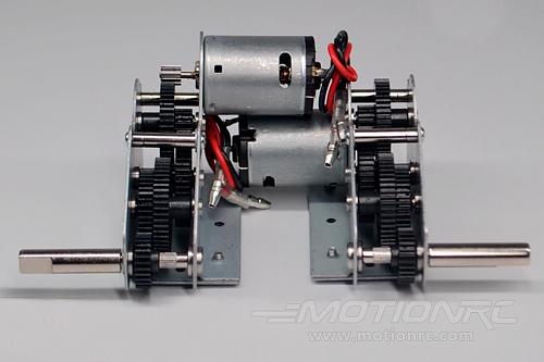

      The Upgrade version available from Motion RC does not use Zinc Alloy gears like Upgrade versions of years past. Rather, as of 11/2019, all of Motion RC's Upgrade version tanks include Steel gears, which are superior to the old Zinc Alloy gears in every way. While the remainder of the tank's running gear is ABS plastic, I prefer this Upgrade version because the steel gears in the gearbox are very durable, yet the plastic tracks keep the tank light and maneuverable. The King Tiger is already such a large tank that it has a good weight without extension metal parts. The Professional version replaces the plastic tracks, drive sprocket, and idler wheel with metal versions. This roughly doubles the weight of the tank from ~5+ pounds to ~10.5 pounds, and increases the cost as well, so I recommend the Pro version for tankers who don't mind having a shorter drive time or having to buy a couple spare batteries. The durability and heft of the more expensive Pro version will appeal to those who want weight above all other considerations. By contrast, for the average casual RC tanker wanting to save weight and cost, I think the cheaper Upgrade version is worth considering.
      Click image for larger version  Name:	bbkth4.jpg Views:	514 Size:	77.1 KB ID:	222530

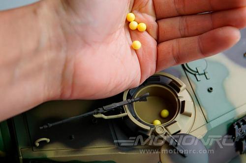

      "Send It!" Firing the Airsoft BB Cannon and the IR Battle System
      Firing the machine gun by pressing the labeled button triggers a machine gun sound and a bright LED at the base of the coaxial mount located in the turret alongside the main cannon. Firing the main cannon is accomplished by holding down both the cannon button and the machine gun button, resulting in a cannon firing sound and a track recoil and a 6mm BB going flying 30 feet out of the tank. It's all synchronized very well, so that the overall effect is convincing. I prefer the lowest or the middle setting for track recoil, because the highest setting is too exaggerated and unrealistic in my opinion. I appreciate the need to push and hold two buttons to fire the main cannon, as this prevents accidental firing of the 6mm BB. The BBs don't hurt, but they are projectiles nonetheless, so all precaution should be taken for safety. I normally don't load any BBs, and after about 30 shots at the included target, which humorously depicts a King Tiger with the earlier style of turret, I taped over the BB loading hole so that there's no risk of any further BBs firing from the main cannon. The King Tiger's main barrel is already a long weapon in and of itself; I don't need it firing projectiles, too.

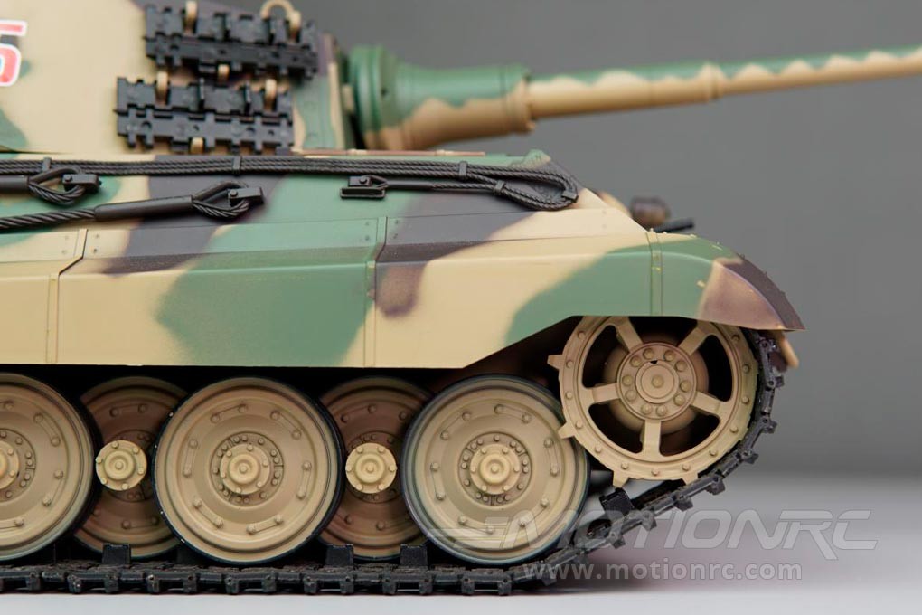

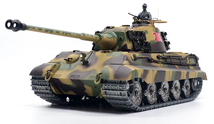

      The more expensive "Professional" version features metal tracks, road wheels, idler wheel, and drive sprocket --essentially all the moving drive system parts outside of the tank--. This significantly increases the weight, which some tankers may enjoy, and also the durability in certain conditions, but the trade-off for this weight gain is lower drive time. For anyone operating the heavier Professional version, I recommend buying a spare battery or two.
      The metal parts also arrive unpainted, making it easy to visually distinguish in product photos which version is which. If the road wheels are green and the track is black, they're plastic and that's the Original or Upgrade version. If the road wheels are metal colored and the tracks are as well, then they're metal and that's the Professional version. The metal wheels would need to be painted by the user, if he/she prefers. I know I do! Below to the left is shown the Original and Upgrade versions which are visually identical from the exterior. Below to the right is shown the Professional version, with its all metal unpainted exterior running gear (tracks, road wheels, idler wheel, drive sprocket).
      Visually distinguishing the painted wheels of the Original and Upgrade versions, left, is easily accomplished compared to the unpainted metal wheels and tracks of the Professional version, right:

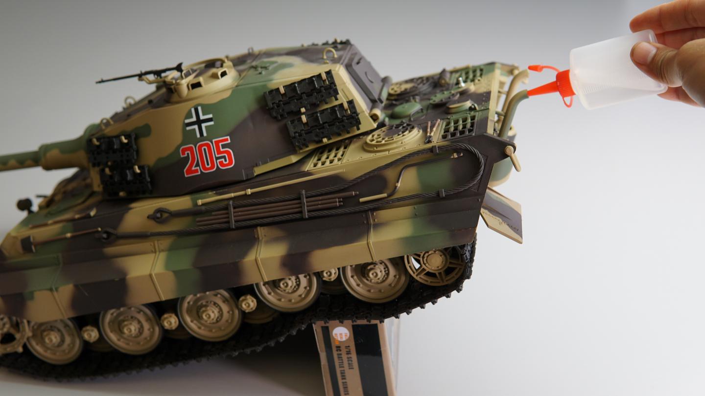

      2) Don't flood the smoker. There is one smoker in the tank, with two exhaust tubes. Those tubes in fact function as both the exhaust for the smoke and the intake for the smoke oil, so it's imperative that you only put one drop in each of the tubes every hour of smoking. Less is more! If you overflow the tubes, the smoke can't exit, causing the smoker unit to clog and die.

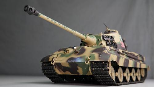

        CONCLUSION
        Click image for larger version  Name:	DSC09745.JPG Views:	0 Size:	149.5 KB ID:	220930
        As with all Heng Long 1/16 tanks, I assess a rating for each of seven key areas. To be fair, I don't rate the King Tiger against other tanks twice its cost, but rather in the context of its own price point and intended audience, which is the entry level and mid-level RC tank enthusiast looking to get started without breaking the bank. From that vantage point, here is how I rank the Heng Long 1/16 Scale "King Tiger" German WW2 Tank:
        Initial Quality: 93/100
        The King Tiger arrived in perfect condition and securely packaged. Like all Heng Long tanks, the King Tiger is primarily constructed from ABS plastic.
        The paint work from the factory was evenly applied and very good for this price point. I tend to think Heng Long does a good job on its multi-color camo paint jobs.
        Like the KV-1, Sherman, and a few others in the recent TK6 series, my King Tiger's tracks were properly tensioned out of the box, so did not require any adjustment. I have spent time at the Heng Long factory to discuss their track tension process on the mass production line, so I expect to see this positive trend continue. Two spare track links are included in a bag, and twelve additional links are hung on the turret, so there's more than enough spares!
        Despite being such a large tank with a long hull and tall side walls, the lower hull and upper hull didn't exhibit much noticeable flexing. I think a casual tanker would agree that under reasonable conditions, it is not necessary to reinforce the King Tiger's hull out of the box. Internally, the steel gears were greased and sounded good, although I expect after a couple of hours I'll need to reapply grease on the final drive gear.

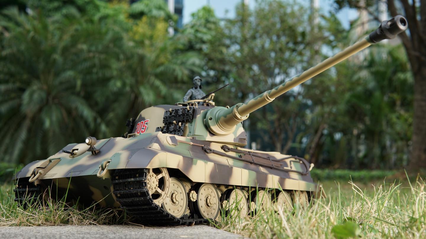

        Mobility and Drive Experience 90/100
        The King Tiger has surprisingly good mobility despite its size, owing to its wider area of track contacting the ground and thus lower ground pressure. The wide tracks give positive traction when climbing reasonable grades, and its independent suspension and tall road wheels naturally give it better handling over uneven terrain. When used in the context of a scale tank and not subjected to unreasonable expectations of being a Crawler, which it is not, the King Tiger demonstrated good mobility on all surfaces I drove it on. Probably better still, the King Tiger's ground stance looks intimidating and its practical as well, with sufficient ground clearance to trudge through grass, weeds, short rubble, and gravel.
        The aforementioned flex inherent in the plastic tracks found on the Original, Upgrade, and Upgrade-A versions, however, are prone to skipping a tooth if the user tries to do a fast "super spin" maneuver because the outer edge of the track cleat can dig into softer surfaces and gradually work its way out. In scale maneuvering speeds, however, the plastic tracks functioned flawlessly. It's a tank, not a drift car.

        Scale Fidelity 82/100
        Several sprues of plastic parts are provided for the modeler to install on the tank to enhance its overall scale appearance. These all plug into pre-drilled holes, and are nearly "snap fit". A few of the parts were loose, so I bonded them with ABS glue. But otherwise, I prefer to keep the parts unglued so they're easy to remove or replace if needed in the future. Installing the plastic "accessory parts", including the smoke grenade launchers, bustle bins, tools, rear view mirrors, and many grab handles, took about 45-50 minutes from start to finish. Plan for an hour if you want to take your time cutting the parts out of the plastic sprues. I recommend a sharp clipper designed for this purpose, as it makes cleanup much easier. The accessory parts are pre-painted and really enhance the tank's overall surface detail.
        There are some limitations inherent with this price point, however. Avid tank historians can probably spot several inaccuracies, from the glacis' welds, lack of engine deck screens, simplified MG mount, etc. The spare track links would also benefit from some filling and detailing. For the average tanker, I don't think these individual scale inaccuracies are deal breakers --Heng Long's King Tiger is still an impressive brute of a tank-- but they are worth mentioning. Super scale modelers will likely spend time further accurizing the Heng Long base model, and I think such will be time well spent. I'd recommend looking for the Trumpeter 1/16 Scale King Tiger, which is a static (non-RC) plastic model, to use it as a donor for spare parts in certain areas. The Trumpeter 1/16 static kit is often recognized as superior even to Tamiya's 1/16 kit.

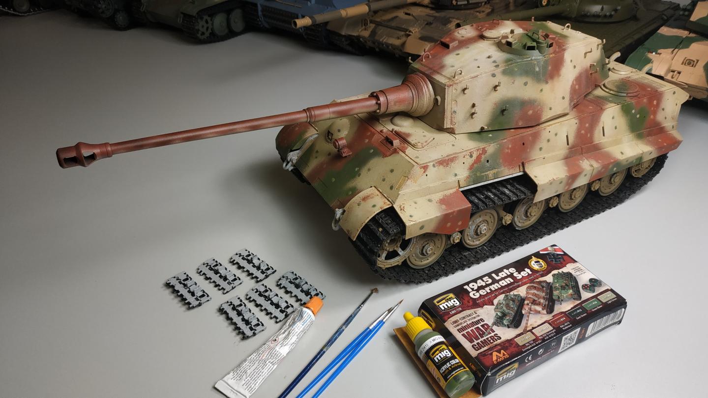

                    I've begun to paint one of my King Tigers in the so-called hidenhalt "ambush" scheme used later in the war. While most KTs didn't last long enough to become very weathered and rusted, I'm going to take liberties with this one and heavily weather it as time allows over the next couple weeks, including installing weathered metal tracks. Stay tuned!

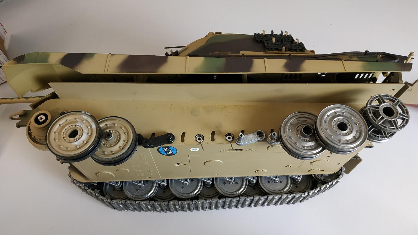

                                    To the left can be seen the baser versions that have plastic painted road wheels and ABS suspension arms compared to the right side's metal arms and metal wheels. The wheels house two bearings each. The same springs are used between both versions.
                                    Click image for larger version  Name:	IMG_20200113_103039.jpg Views:	0 Size:	116.8 KB ID:	235762

                                      With steel drive sprocket, and idler, wouldn't steel road wheels make the suspension somewhat...complete?
