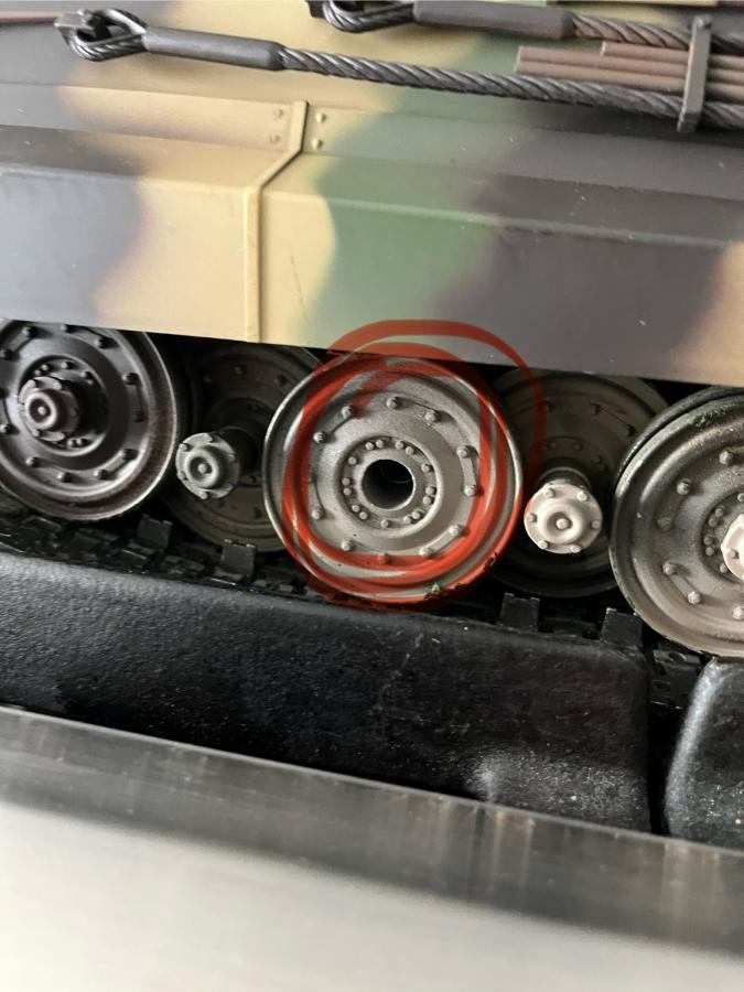

              Well, of course the first time I had it out at my girlfriend’s house I lost one of the center hubcap covers, and it blends in perfectly with the terrain. After hours looking, I gave up. I have already reached out to toucan and Matomart about replacement sets, but if anybody has one They want to send me so I don’t have to order from overseas I would be happy to pay you up front

                Wow…. These metal caps are absolute unicorns. I reached out to toucan hobby and he can’t even find any. (He is awesome by the way. Great customer service at toucan)
                I assume the plastic caps will fit on the metal wheels? Can anyone confirm before I buy them ? Thank you

                  Plastic road wheel caps fit plastic road wheels and metal road wheel caps fit metal road wheels. They will not fit plastic to metal or metal to plastic without extra fabrication to make them fit or glue them on.

                      I actually packed away the metal wheel caps and use the plastic wheel caps on all my tanks. Many of the plastic cap were a slight pressure fit to the metal wheel and stays in place very well. If the plastic cap turns out to be under sized, I paint its rim with acrylic paint to help the adhersion. In all cases, I paint the cap and wheel with 2-3 layers of acrylic paint to reinforce the holding. I prefer paint over CA glue because the cap can be removed if necessary.
                      I do not have the HL King Tiger and cannot comment on whether my suggestion will work on it.

                            I use plastic caps on my tank wheels because the plastic cap molding is usually much sharper than the metal cap casting, thus takes wash much better. A small, but significant improvement in appearance and the thick painting helps them to stick to the wheels better too. (The heavier metal cap falls off easily if I do not CA glue them.)

                              I guess I'm the only one who taps them in with a hammer and wooden dowel. After painting a primer and base coat they have a snug fit. I dab a shot of light thread lock. Lucky enough I haven't lost one yet, but because I just said that I'll probably start losing them left and right now.😝😖😲

                                i must admit that I never tap the plastic cap in with a hammer and wooden dowel. I use my thumb to push it in. I did what I did mostly for look. The lighter weight is a bonus to keep it from falling off.

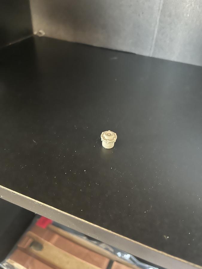

                                  Well, I borrowed a metal detector and look what came up!

                                    Well, as a previous user said, the plastic caps will not fit on the metal wheels. By the time I filed them down enough to fit in the hole on the wheel, the plastic just disintegrated.
