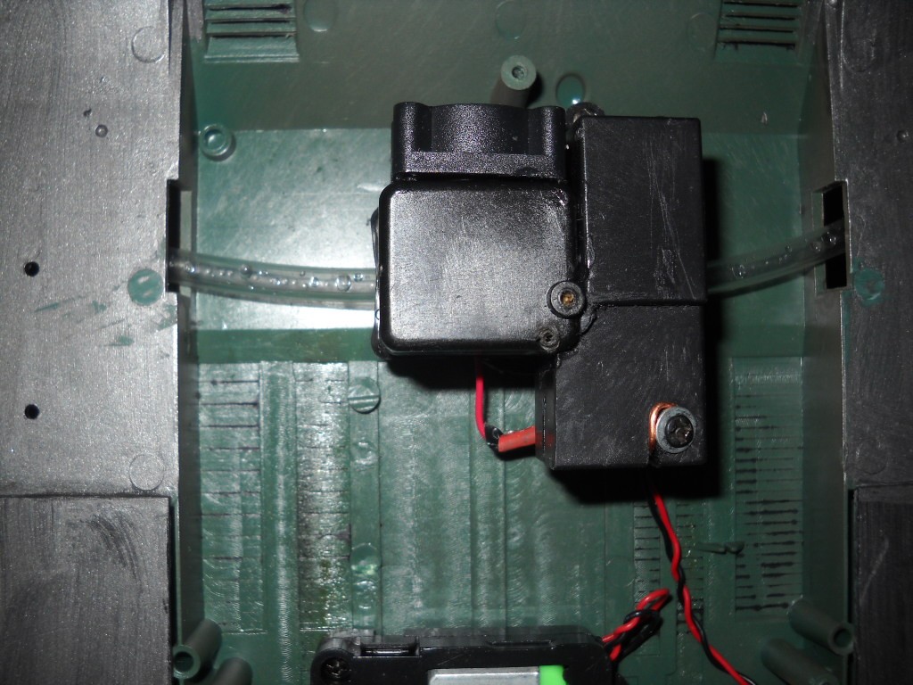

      HI I my M41 came yesterday and trying to get it going but my smoke going , I was hoping someone could give me a few pointers with out having to search all over the forum. I put the liquid in the tail pipes and after it starts I hit the smoke button and hear some kind of a pump noise or something but no smoke, it says it may take up to a minute . After several minutes not even a puff.
      The other thing is my gun does not depress very far and I get a gear grinding sound I think Im suppose to get 30 degs. up and down . I don't think its has much movement is this normal ?
      Thanks for the help

            How much of the smoke liquid did you put in the tube? Only one or two drops in one exhaust pipe is needed.
            Gun barrel elevation/depression travel is 30 degrees total I believe.
            Todd

              I am also still trying to find the sweet spot for the smoke. I learned here that the most common mistake is too much liquid, and only 1 drop per tube is enough. Also, add the liquid with the tank vertical so it runs down.

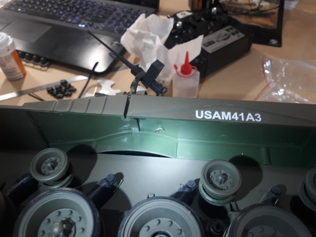

                well I guess I drowned it with liquid how do I clean it out ,,,,,,don't tell me a match 💣💥
                the gun dose make a gear grinding sound when it hits the limit
                I have smoke took it apart and got out the over fill with paper towel.
                So now the tank pulls to the right and I tried trimming it by the instructons with the g button and moving the the sticks found the center with the double beep and all but when I try to adjust it it seems to have no affect. Also my tank has the fwd backward on stick 1 and left right on stick 2 the instructons seem to show all the driving functions on stick 2 and the turret functions on 1. So im trying to find a mode switch for the controller and see if that's the reason my trim is not working.

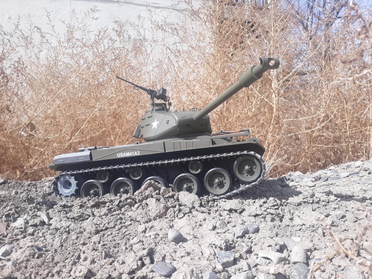

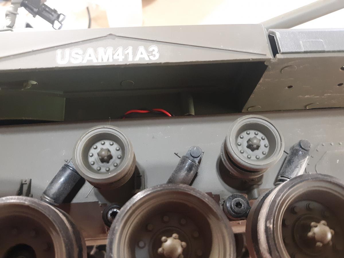

                  My Bulldog arrived yesterday. I had ordered the "Pro" version. I'm a very happy newbie Tanker!
                  Unboxing found all parts/components in good shape. And, the two minute test found everything in working order. I'm very impressed with the quality of parts, paint and finish. Drove around my living room for an hour last night. I set up some books on the floor and tested its ability to handle and maneuver on them. It was quite a lot of fun and a good learning experience.
                  This morning I took it out for it's first drive in the dirt and brush. Very impressive handling. It tore right through most things my back yard could throw at it. The only problem I ran into was when it picked up a long twig from a weed which caused the right track to come off. Overall I'm very happy with the experience thus far.
                  Now, for a few issues/gotchas that I've come across:
                  • The battery charger apparently doesn't do a balance charge. My battery showed up with %83 and the two cells were very close in voltage. After charging it though, one cell gets to almost 4.2v while the other gets to 4.06v. The same has occurred each charging cycle. I need to get a Tamiya adapter so that I can charge these on my regular battery charger.

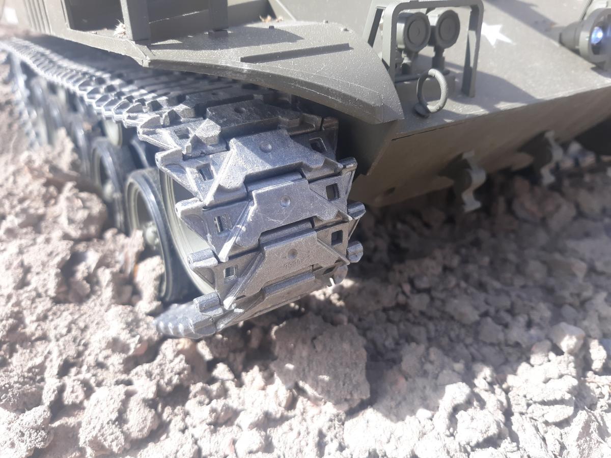

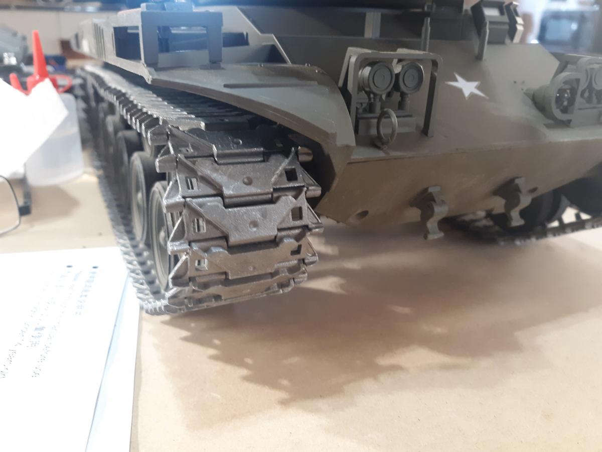

                  • My metal tracks were installed backward (or upside down?) by the factory. There is a distinctive chevron pattern to the Walkers tracks. That chevron should be pointing down when looking at the front of the tank. So, after the right track came off I took the opportunity to fix them both.
                  • The kit came with three extra track links. These are plastic, and not even the same design as the Bulldogs tracks. Do all the tanks come with the same wrong extra tracks?
                  • While correcting the track installation I discovered that a wire pair was pinched between the upper and lower hulls. This has also been fixed. Just something to keep a look out for, since the factory didn't seem to catch this one.
                  • The turret ring on the underside of the upper hull protrudes beyond the lower hull. This leaves a substantial gap for rocks, dirt, debris, and water to enter the tank hull. I only mention this as something to consider when driving your tank. If you drive in areas with lots of small debris or wet areas, then you'll want to seal that gap to prevent anything from fouling up the inner workings of the tank.
                  So far it has been great fun. I can't wait to get another tank and do some battles with friends.

                  • #29
                    Click image for larger version  Name:	20200306_111316.jpg Views:	0 Size:	311.3 KB ID:	240428
                    I know the little things add up but they are little things easily correct.
                    Don’t put to much worry about dirt getting inside. Mine have proven this is not an issue. The M41 is kinda like the AK of the HL line up, it can run dirty take huge amounts of abuse and come back for more with little pause for maintenance or cleaning. Take a look at my Instagram @fsttanks and watch my M41s in SLOW MOTION action and the abuse I put them through.

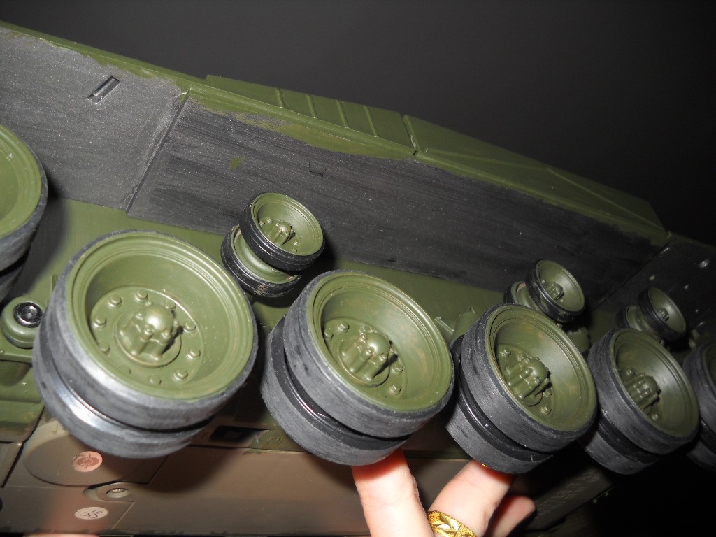

                                I'm a fan of Bulldog and this is 1 of 2 I have,it 's a plastic version.This's some tricks I do. modified smoker with 3 exhaust pipe,weight front body,push bearing in the idler wheels,
                                reinforce gear base,adjust driver periscope,cut front hook for better climbing,fill a straw in drive shaft to prevent grass,full side body,and use brass arm for road wheels.
