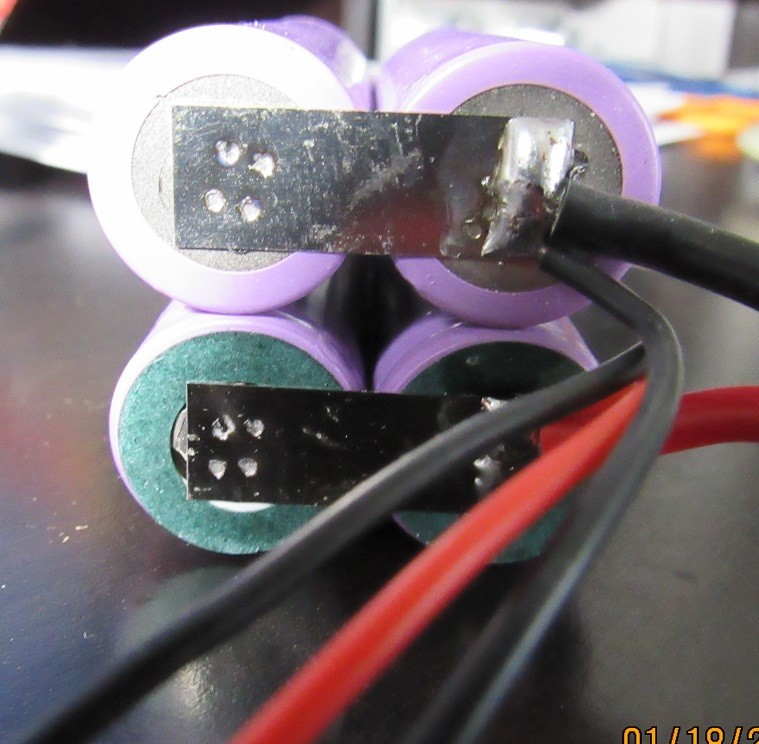

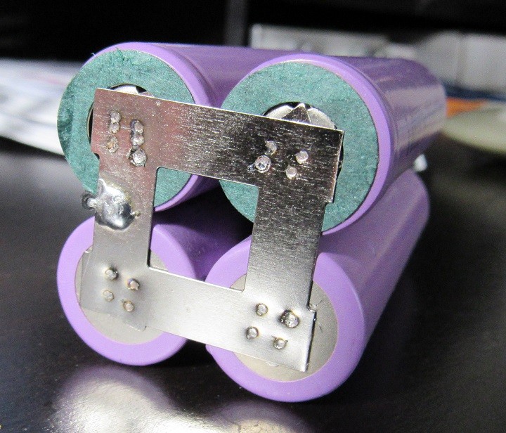

                                    You have me confused too. The original XT60 was later branched out to XT60I, XT60H and XT60U. I have not heard of the XT60 A or B connector. Can you show a link where they were mentioned?
                                    The Walk Bulldog can take any 6 cell NiMH pack or 2S2P lithium Ion. Heng Long ship newer Walk Bulldog with a smallish 2S18650 Li=Io pack with XT60 connector and balance connector.
                                    Commercial 2S2P18650 battery pack configured like the 3 pictures below will not fit the Heng Long tank.
