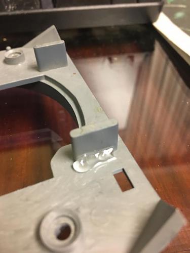

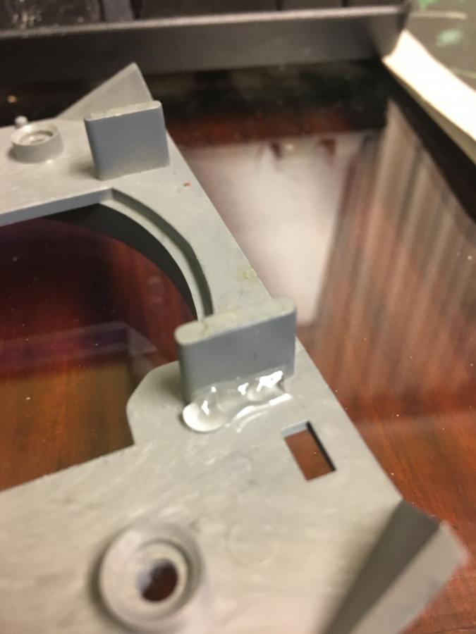

                                I found my turret problem. The barrel support was broken causing the housing to sag enough to hit the little hook in the front of the turret Click image for larger version
Name:	Panzer broken gun support.JPG

                                  Good to see you found the problem. Also good to see you took the tank apart👏👏. Many folks are hesitant to do so.
