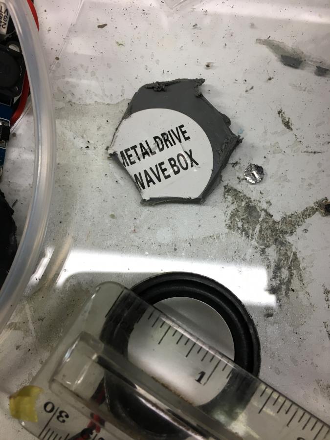

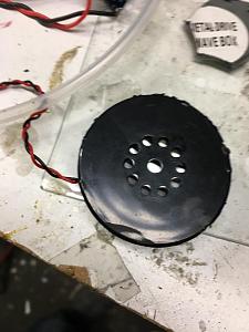

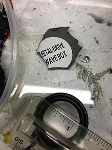

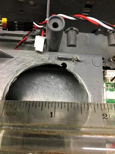

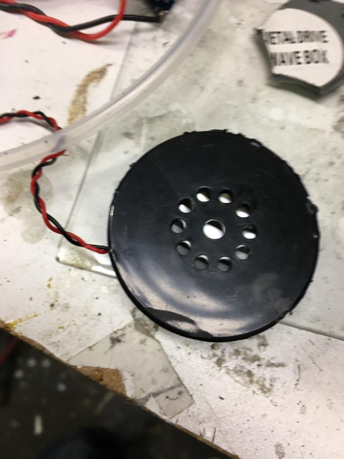

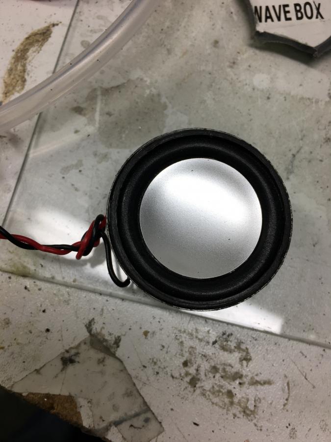

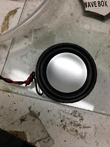

                        Click image for larger version  Name:	IMG_6427.JPG Views:	0 Size:	58.3 KB ID:	292428Click image for larger version  Name:	IMG_6428.JPG Views:	0 Size:	69.9 KB ID:	292430Click image for larger version  Name:	IMG_6429.JPG Views:	0 Size:	78.7 KB ID:	292432Click image for larger version  Name:	IMG_6430.JPG Views:	0 Size:	64.5 KB ID:	292434
                        Just in case anyone is interested. The stock speaker is really tiny itsi bitsi I cut it out to move it to my battery compartment. I'll order a 2" one later.

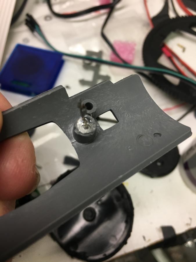

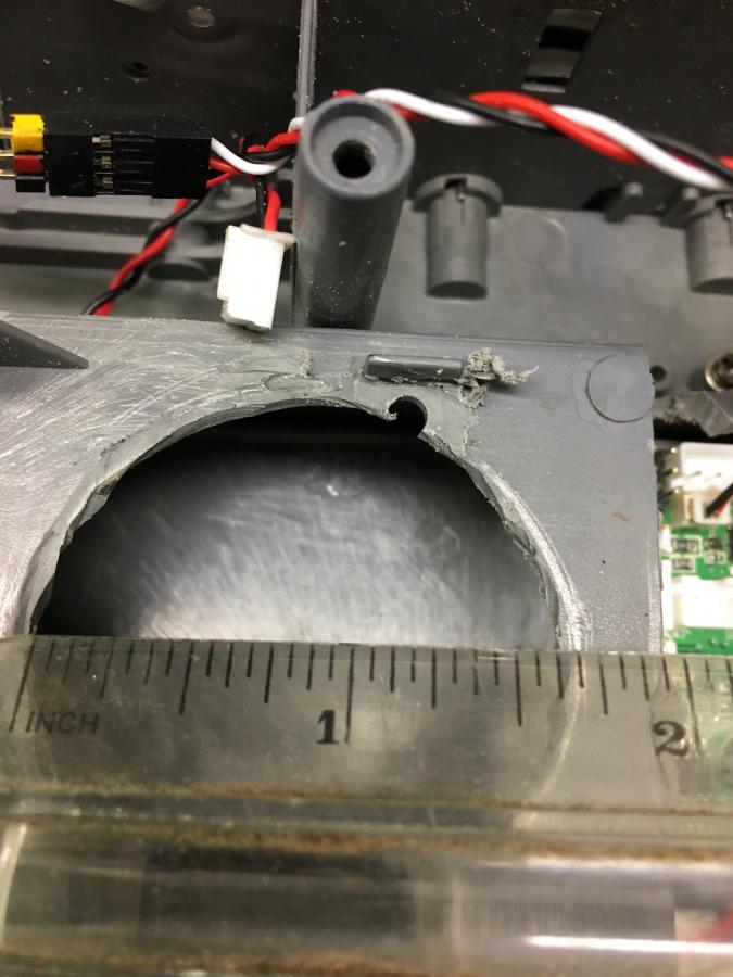

                            I ended up cracking the Mantelet trying to extricate the LED to put in the IR Emitter. Any ideas on debonder? The glue is tough.
                            • #74
                              MEK sub, or acetone, or I just scratched around it with a #11 while pushing on the LED with a punch though. Problem with debonders is they can make plastic brittle so im pretty leery about using them.

                                    Click image for larger version  Name:	Broken Mantlet.JPG Views:	0 Size:	51.1 KB ID:	293056
                                    The LED Holder is now almost broken off the back. I tried hitting it with a hammer and a brass tube(from the other side) to loosen it up and the mantlet broke as well as the LED holder.
                                    • #78
                                      Were it me and it was giving that kind of trouble, id just cut it off and fashion a new one out of brass tube. the tube also lets you set the bulb back so you dont get shotgunning as well.

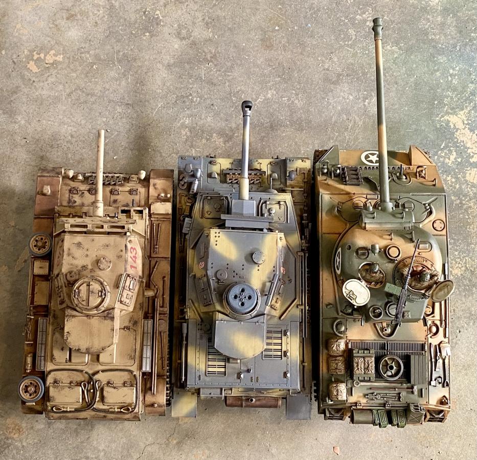

                                        Originally posted by dai phan View Post
                                        Hi all,

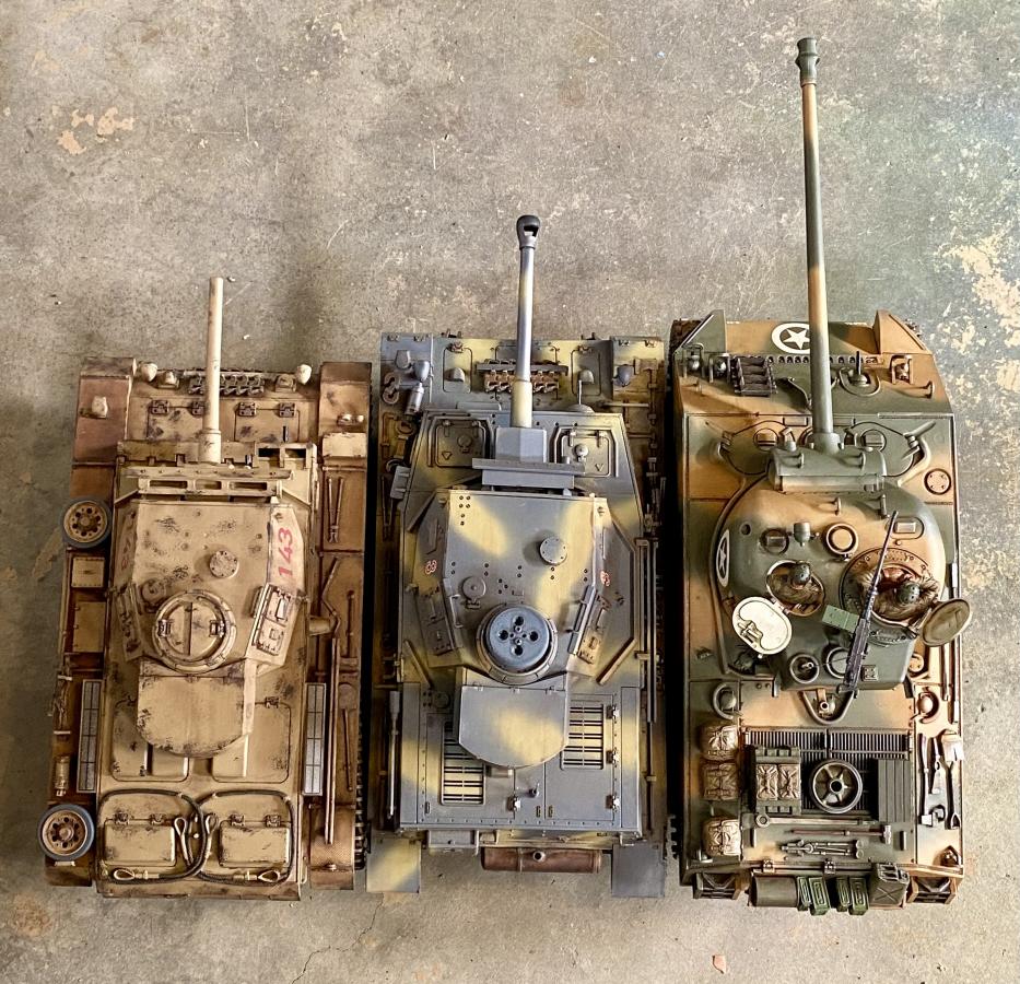

                                        I have been thinking about getting the Taigen Panzer IV but I have heard it is a very small tank right? Smaller than the Sherman ? Dai
                                        Howdy Dai, to pick the nits; (FWIW: from Wikipedia)
                                        PzIV (not counting barrel lengths) Length = 19' 5" (5.92m), Width = 9' 5" (2.88m), Height = 8' 10" (2.68m)
                                        M4 (minor diffs between variants, no barrel lengths) Length = 19' 2" - 20' 7" (5.84–6.27m), Width = 8' 7" - 9' 10" (2.62–2.99m), Height = 9' - 9' 9" ( 2.74–2.97m)
                                        Assuming H-L and Taigen commit to reasonable scale fidelity, these 2 tanks are close in size.
                                        • #80
                                          HL, not Taigen. I've been looking for an excuse to post these tanks! 😁
