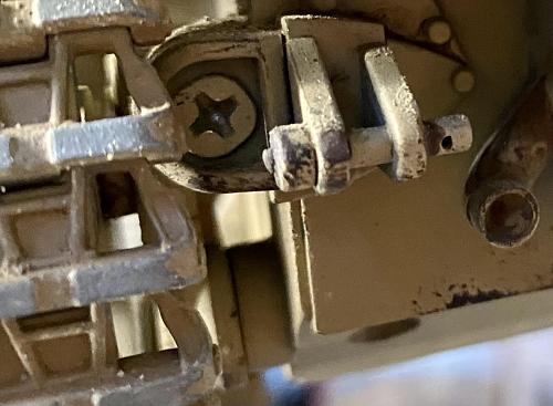

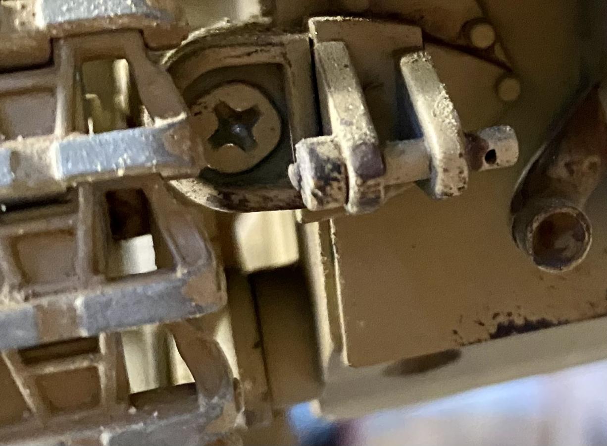

                    I'm posting this because I was pleasantly surprised to see it had adjustable tensioners!
                    SoCalBobS, what tensioners came on it? My StuG seems to be shedding tracks on a regular enough basis that it made me think about adding tensioners. I've seen the Mato ones. Wasn't sure if that was what Heng Long was using or something different?
                    Thanks,
                    Jim
                    • SoCalBobS
                      • 2754
                      • Southern California
                      #110
                      Thanks,
                      Jim
                      Hey. My 5.3 StuG did not have tensioners, obviously an older mold. The Panzer III is a 6.0 version. The tensioners look similar to the fake ones on the StuG, but they are in fact functional, adjustable by a phillips head bolt. By it's design, I'd say it was a tank-specific purpose built improvement.
                      Neither of these tanks shed tracks. If yours are coming off in the back off the idler, I'd look at alignment. Maybe a washer fell off or wasn't provided in the first place? All my tanks came with a washer inline with the idlers. Many's the time I've had to chase them around the workplace floor!
                      Bob
                      • OKC_Jim
                        • 53
                        #111
                        Bob
                        Thanks Bob,
                        Do the new Heng Long tensioners look like something that could be retrofitted to an older hull or are they part of the hull?
                        I double checked the washers, even tried an extra one on each side. Still throwing tracks.
                        • SoCalBobS
                          • 2754
                          #112
                          They're not like the add-ons I've seen pictures of, so I'm guessing they're built in. It's a 'worm gear" setup, as opposed to an "eccentric" one. They can be adjusted with the tracks on.
                          • OKC_Jim
                            • 53
                            #113
                            Thanks Bob,
                            These are the ones I am looking at.
                            https://www.ebay.com/itm/Mato-1-16-G...59.m2763.l2649
                            • SoCalBobS
                              • 2754
                              #114
                              Looks similar, could work. Don't know how the Mato's adjust, in mine the screw does it.
