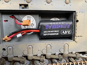

                          So my battery showed up and the 3500 will not fit my older chassis. So I did like I have seen others do on RCTANKWARFARE and dremmeled the battery compartment out. I will get around to cutting more out later once my new smoke system arrives. I drove the tank for the first time around in the house and the metal track side was getting no traction as expected on my smooth floors. I am going to gun blue the treads as soon as I can get some gun blue.

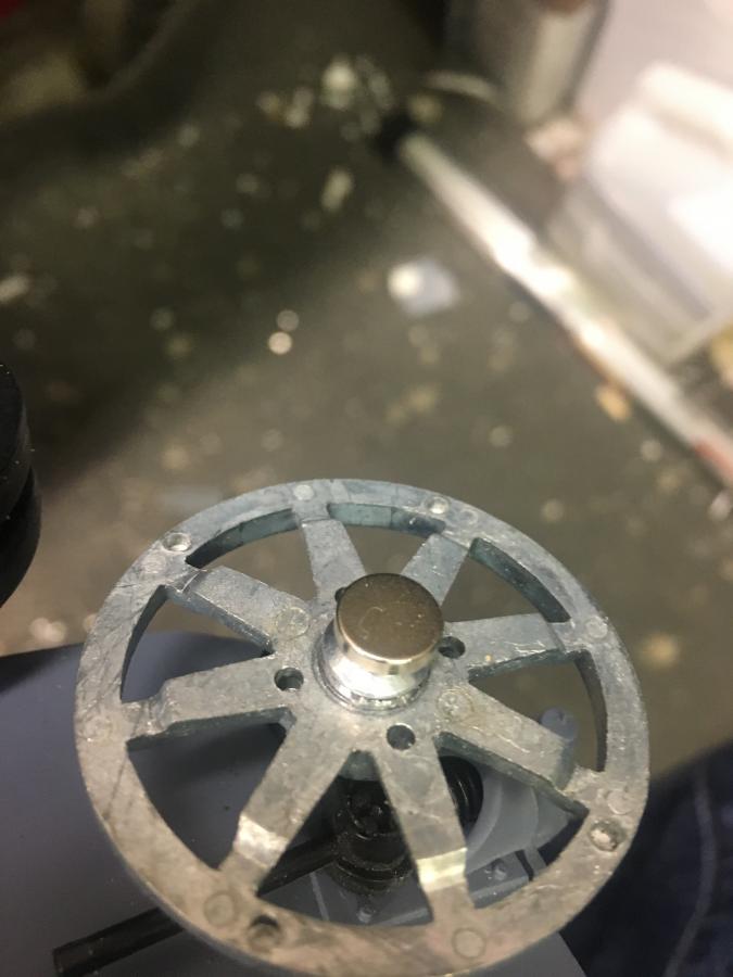

                            I saw this tip on RCTANKWARFARE. Magnet on the idle sprocket cover for quick access. I will abandon my screw on cover to try this first.
                              Interesting. Mine fit, just, with a little push. Regarding blueing the tracks, I've been just spray painting them with a brown (dirt, mud, rust?) paint then running it around on concrete to wear the paint off the high parts. I'm in the process of weathering my tank, but take a look at the treads.

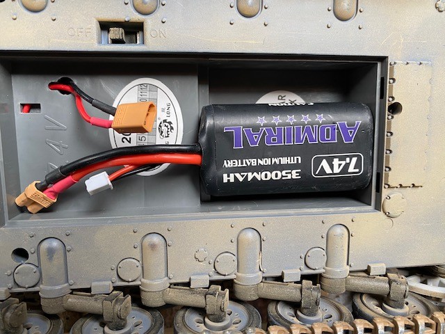

                                  Nice DAK. I thought about the paint, but will try the Birchwood Blue. I think my Tank being a 2015 model had a really small battery box. What does the newer boxes look like?
                                  Thanks. Box is the same. I found that instead of angling the battery, inserting it level, it would just fit pushed into that step in the front.

                                    Yes indeed the same. Well, after seeing a couple of Panzers online with the box cutout I went for broke and cut mine out. Plenty of room now in the chassis. I will see how big my barrel smoke unit is and if there is still room I can mount a bigger Tamiya speaker.

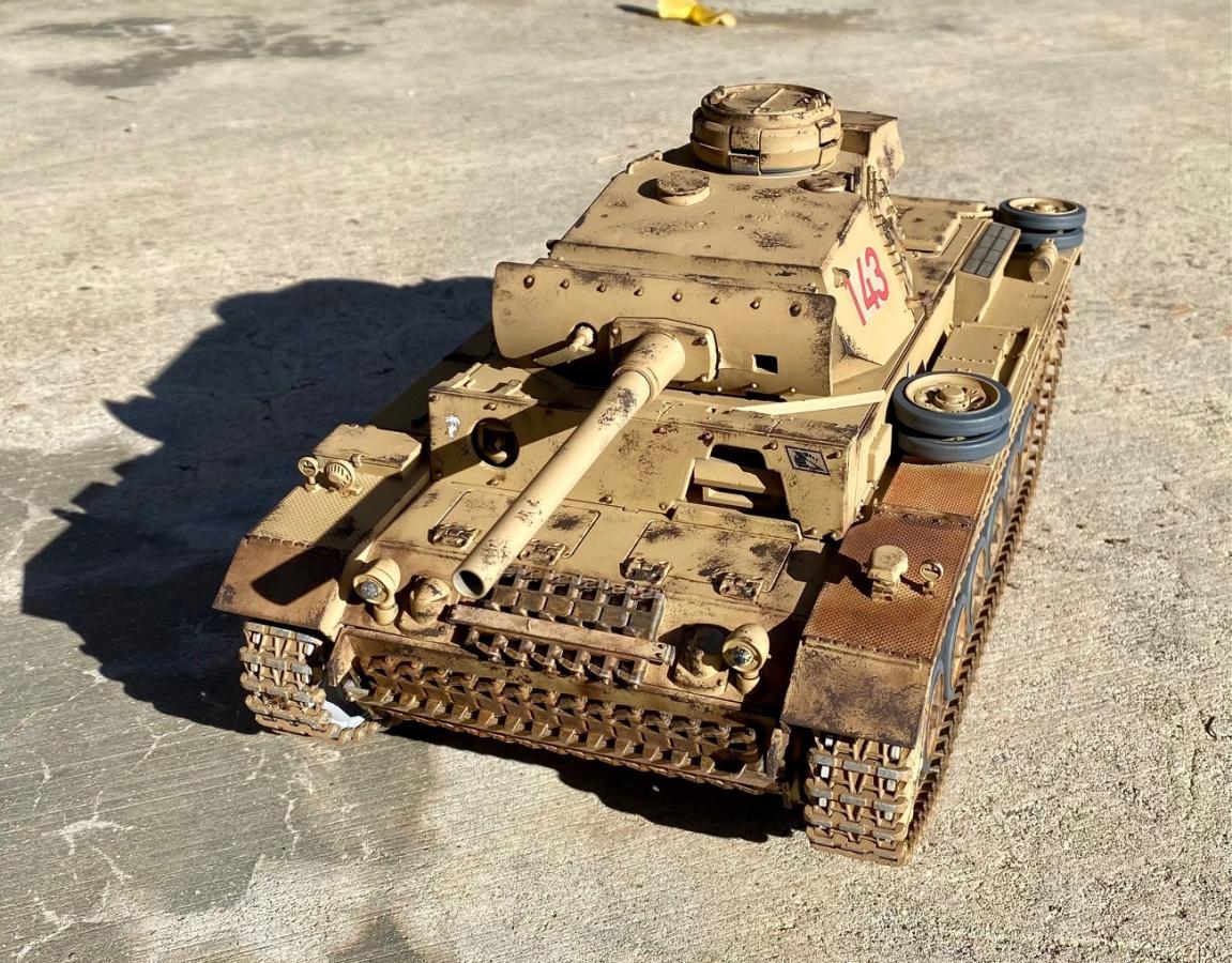

                                      #58

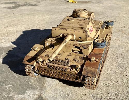

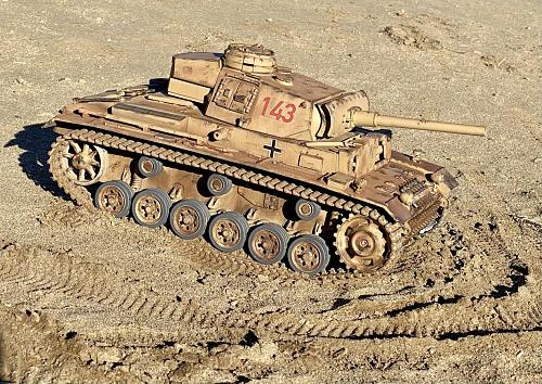

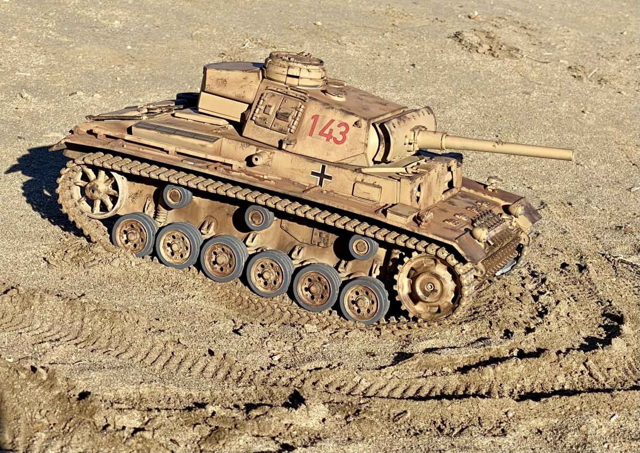

                                      I posted some outdoor photos in the gallery.
                                      ​​​​​​​ Click image for larger version
