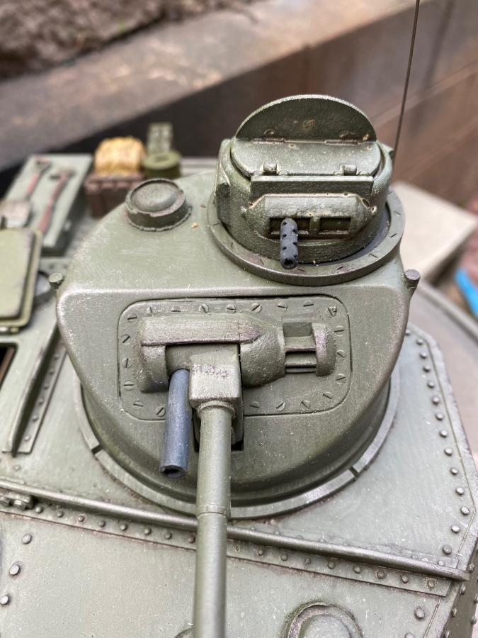

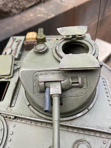

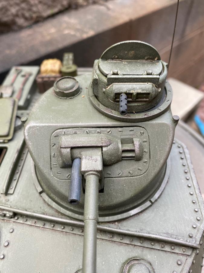

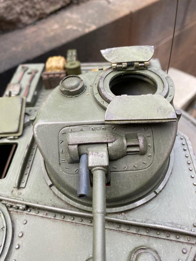

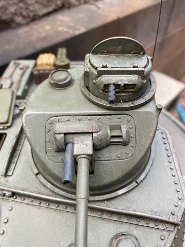

                I received the Shapeways Commander's Cupola for the M3 and painted it up to match.
                Before:
Name:	M3 Lee 26.jpg
                After:
Name:	M3 Lee 27.jpg
                The big gray tube is for the MG LED, which as we know can activate the IR receivers.

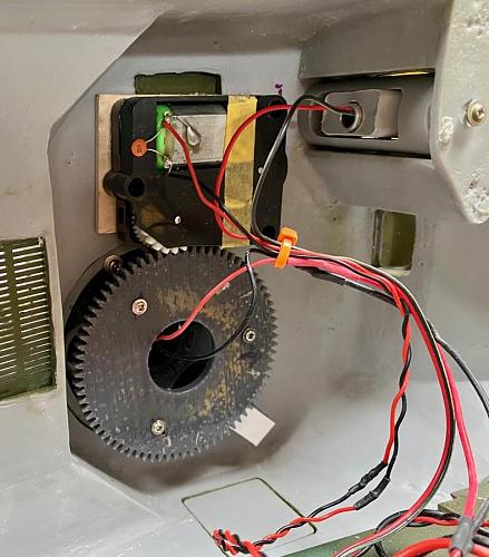

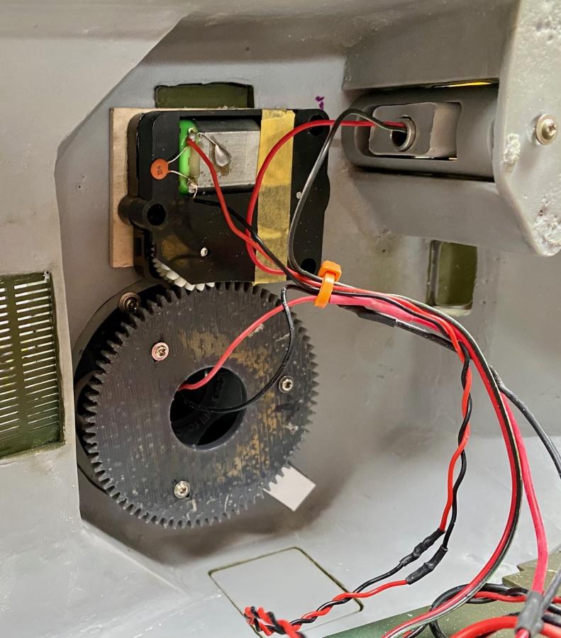

                                So: "How I did it".
                                There's actually two disks. One is inside the turret, and has three standoff posts. The disk itself is held in place by three screws with built-in washers that overlap onto the turret ring. You can see one in the background. The gear disk is screwed into the standoff posts. The HL rotation motor is glued onto the hull deck interior. You can see some plywood which acts to put the motor gear at the right height. The white square you see is actually on top of another post. It's function is to keep the gear assembly at the right height.
                                The biggest headache is to keep the turret from rising up out of it's track on the hull. If the gear disk is not exactly lined up, as the turret goes around, it'll bind up and push the turret out of the track. My current solution is to enlarge the holes on the gear disk and loosen the screws to adjust the alignment. Seems to work.
                                Why did I do it this way? "First-time syndrome" of course, and the desire to make it completely removable without affecting the body or turret. You know, in case I mess up! Also, I was able to use all HL parts and not buy expensive aftermarket components.
