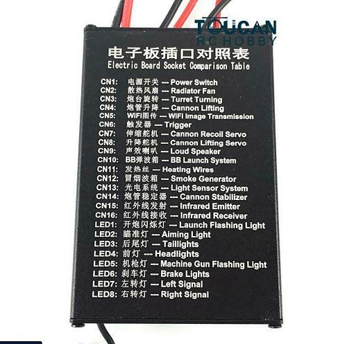

                      Posted elsewhere, but relevant here too. Back of 6.1S.
                      • Sureshot
                        • 235
                        #31
                        I hooked up the 6.1s MFU today to see what the servo functions are and they are pretty much as advertised.
                        The gun elevation servo is proportional over a 90 degree range. It can creep very slowly or move quickly depending on how fast and far you move the stick. It does not return to center when the stick does. Works very smoothly.
                        The gun recoil servo moves 90 degrees when the cannon button is activated and returns back to its original position almost instantly. If you put a jumper in place of the "trigger" connector the recoil and cannon sound are simultaneous. Much improved over the current barrel recoil system.
                        As you can see from the picture that Bob posted the 6.1s has a few other features also that are not on the 6.0.
                        One thing that caught my eye was the use of different style connectors for the IR connections. Not sure why that is unless maybe for some future change. That's all I know for now,
                        Steve

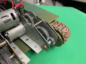

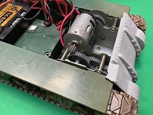

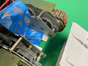

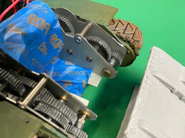

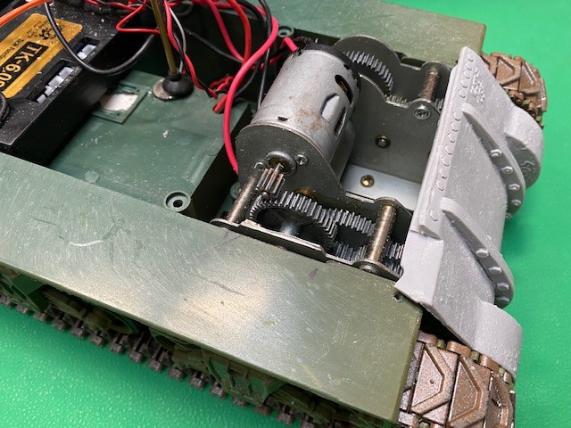

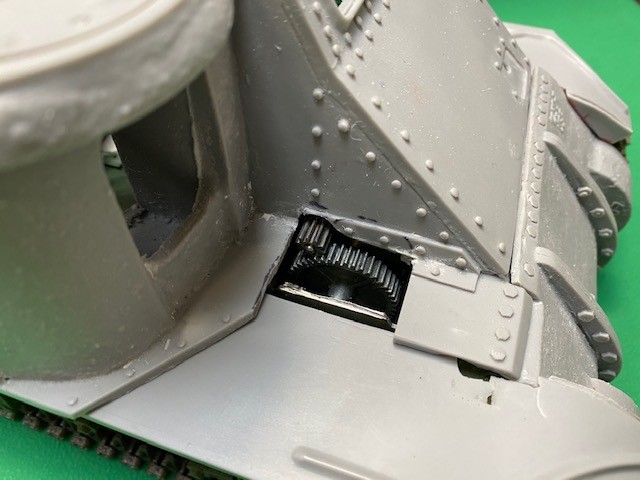

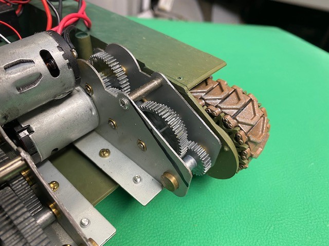

                                      I received my M3 Lee conversion kit yesterday from Kenny of DAKRC. So begins the odyssey. This is an as time allows, low budget project, trying to use as much original stuff as possible. It's also my first attempt at a resin conversion modification. I'm documenting this here for anyone who is contemplating the project, and for general hints and tips. Everyone is welcome to chime in!
                                      First thing is that the manufacturer Vandra states a low profile gearbox is necessary, for clearance of the M3 style front transmission cover and the upper hull. I wanted to try to retain the original, for cost and a worry that another gearbox might cause alignment or support problems.
                                      To fit the cover, portions of the gearbox frame and front hull have to be altered, in a fit and file process.
Name:	M3 Lee 06.jpg
                                      You can see the cuts that have to be made - on both left and right sides. Blue tape is to reduce the amount of metal shavings getting into the motor.
Name:	M3 Lee 07.jpg
                                      Here you can see the front cover is on. A portion of the gearbox frame that sits higher than the fender had to be trimmed too.
Name:	M3 Lee 08.jpg
                                      Now comes the bad part. The right pinion and first gear sit too high also. At some point I will have to fashion a plate and a small cover on the gap. Blasphemy for scale fiends, but fortunately armor can be kit-bashed to simulate field damage and repairs! Painting and weathering can cover a multitude of sins.
Name:	M3 Lee 09.jpg
                                      Last thought; resin molded parts aren't as precise as say, injection molding, so there is a lot of drilling, fitting, filing and finally filling with putty. Definitely a learning curve. It'll be cool when it's done though!

                                        #39
                                        You made the same discovery I did. After doing a lot of work trying to get the standard Sherman gearbox to work. Close but no cigar!. I gave up and ordered the right gearbox. Got it last week but other projects are in the way now, so hope to get back at it soon.
                                        I am very happy with the castings.
