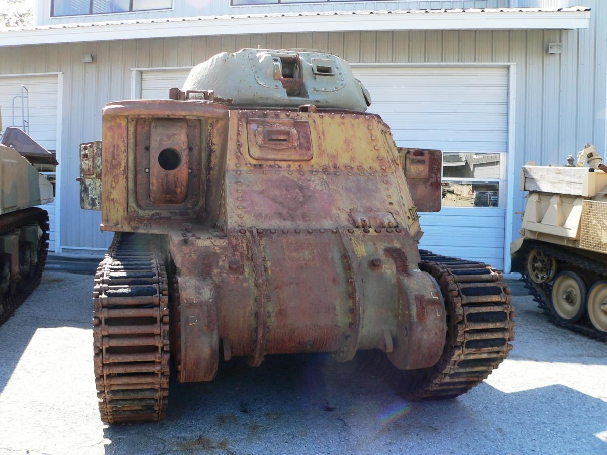

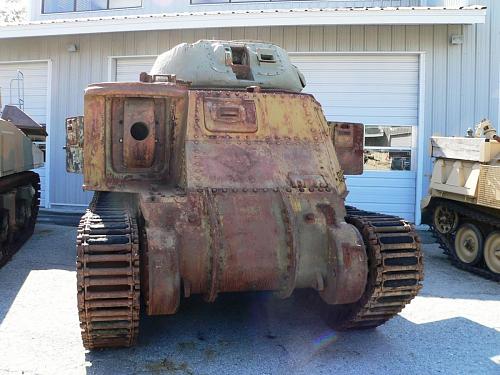

                        So DavidN. Wanna try weathering your Lee? Here's two shots I took of a Grant at MVTF some years back. How many colors of rust can there be? 😲
Name:	M3 Grant 01.JPG
Name:	M3 Grant 02.JPG

                          Thank you for those real pictures. The mother nature really did her work on the weathering. My M3 will be resin, plastic and cheap metal from China. It won't rust as much :-). I wonder if the owner intends to restore it. About Kenny from DAKRC, you were right. He is a really concerned person. He sent me a very detailed email and explained to me on many subject. I ordered the M3 and Stug kit and I was charged $50 shipping fee. He stated that the shipping fee was for international. So he refunded it back to me. Great guy! He noticed that I was new so he also introduced me to the LA RC tank club. It seems that those members have high end Tamiya IR type of tanks. I am a little skeptical to join them at this time.

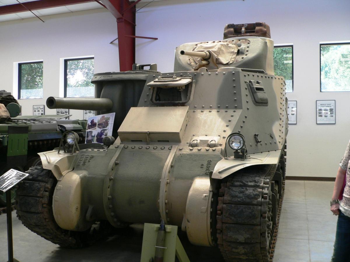

                            #93

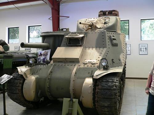

                            Glad to hear of your experience with Kenny. Regarding the LA club, I think Rubicon may have some advice on how they treat newcomers - not bad, as I recall. if nothing else, go by and just talk. Also, our San Diego club is much more informal, about half and half HL and Tamiya. We play fine together.
                            As far as the Grant, that museum is now gone. That tank was probably their parts skeleton for the nicer Lee inside!
Name:	M3 Lee 01.JPG

                              #94
                              Now that is a nice indoor picture! For the LA club, it is about 40 minute weekend drive from my house in HB. I will wait until the beginning of August. Rubicon will probably make announcement and I will just follow his advice.

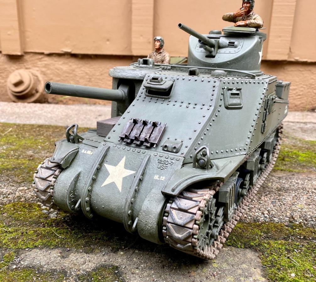

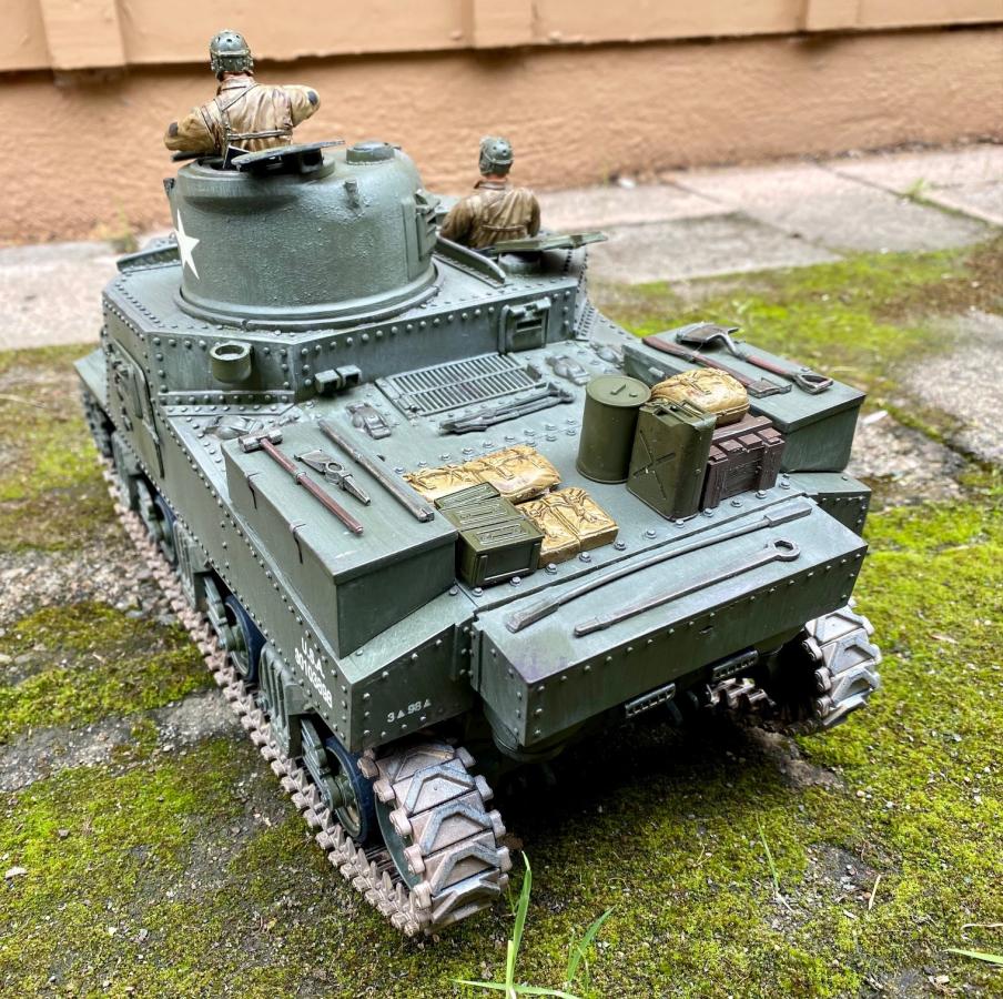

                                        Ok, getting there....

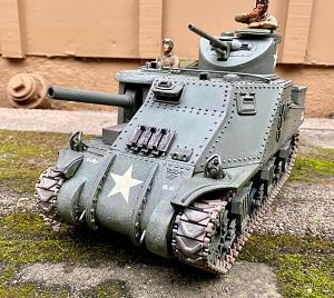

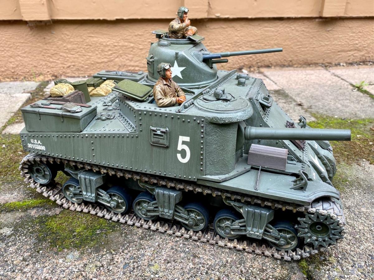

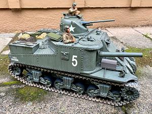

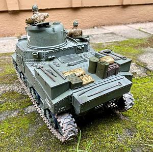

                                        Some weathering, accessorizing. Mainly, I ran an "AK Africa Dust Wash" over the olive drab. Sure changes the color, compared to post #54! Looks like it had been out in the sun for a year. Still some more to do, but the character is taking shape. As Rubicon has said, run it in dirt and sand a bit, and it weathers itself, so that's next.
                                        Click image for larger version Name:	M3 Lee 18.jpg Views:	0 Size:	187.7 KB ID:	305716Click image for larger version Name:	M3 Lee 19.jpg Views:	0 Size:	191.2 KB ID:	305717Click image for larger version Name:	M3 Lee 17.jpg Views:	0 Size:	249.9 KB ID:	305718
                                        Hi Bob! The two front lights on your M3, where did you get them from? Or did you cut them out from a HL M4 and modify them? Thanks!
                                        • SoCalBobS
                                          • 2716
                                          • Southern California
                                          #100
                                          You guessed right. Cut off the cages,drilled small holes in the fenders. Just make sure the wires don’t foul the tracks.
