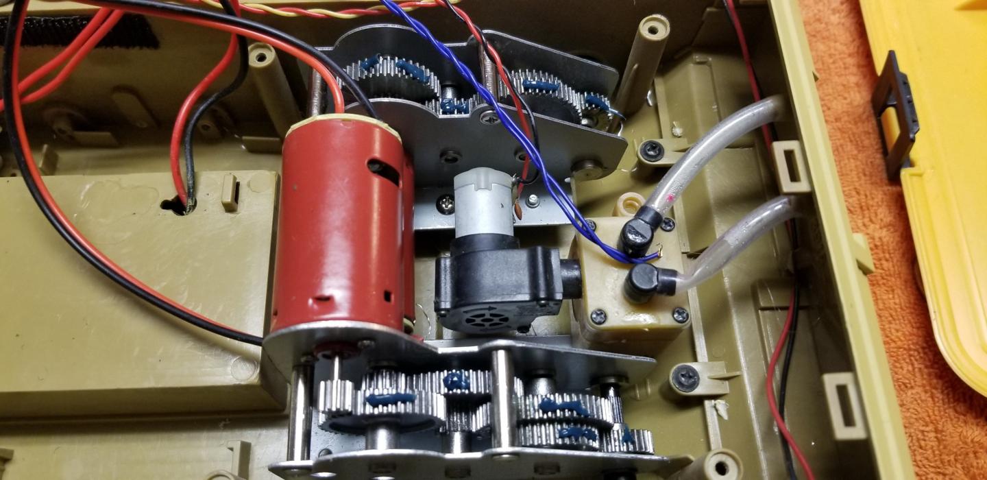

            Remove the plastic shield and you will see the other two screws that you have to remove.
            Also you will have to remove your smoke unit. You have one of the tanks where the smoke units is attached to the lower hull not the upper.
            The drive axles can’t be removed from the gearbox until the gearbox is removed and then you have to disassemble the gearbox. This does begs the question as to why you want to remove the axles if they are working? To do so is not hard just but I recommend taking a few photos of it to remind you as to where everything goes back.
            HUGE shout out to Rubicon & Sureshot (and everyone else commenting on this thread).....YOU guys are frigging TANK GOD's. I cannot express enough how much I appreciate the advice & suggestions. My confidence level is off the charts now.. You guys rock I say ! Muchas Gracias as we say here in Texas.
            Low speed performance is kick ass, top speed, well..........she ran so fast I lost one of those small idler wheels...I panicked. The wheel was easy to find of course, but that tiny screw and not to mention tiny bearing had my heart racing.....but I found them. Good thing I was only traversing a concrete driveway and not dirt. I put a tiny drop of superglue on the threads of ALL of them...so that shouldn't be a worry anymore. She runs like a champ and EASILY scales 4" curbs (at a crawl) like nobody's business.
            I'm knocking on wood because I only had to remove the left drive sprocket. The smoke pump stayed in place as well as the right drive sprocket. The screws were right were you guys said they would be....under that plastic cover that just snaps into place. Having rare earth magnets stuck to the side of my screwdriver made it possible I think. It was cramped quarters in there.

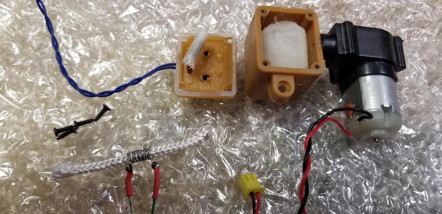

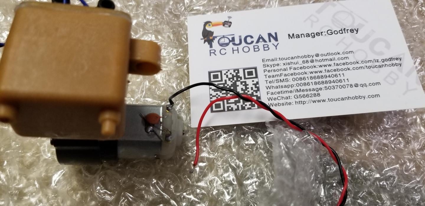

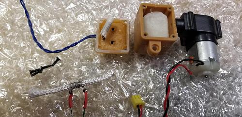

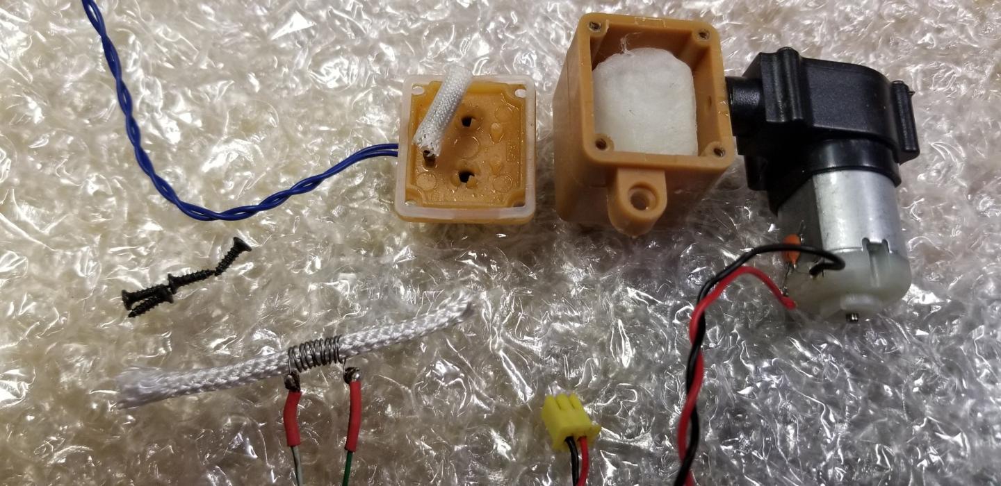

                  New Smoke unit arrived today...came with a lead broken off.....easy fix.
                  Click image for larger version  Name:	20210409_151142.jpg Views:	0 Size:	139.0 KB ID:	308024
                  Came with fluid...superglued the rubber seal in place as usual. The coil & wick look excellent. Need to test it out...
                  Click image for larger version  Name:	20210409_152934.jpg Views:	0 Size:	172.6 KB ID:	308026
