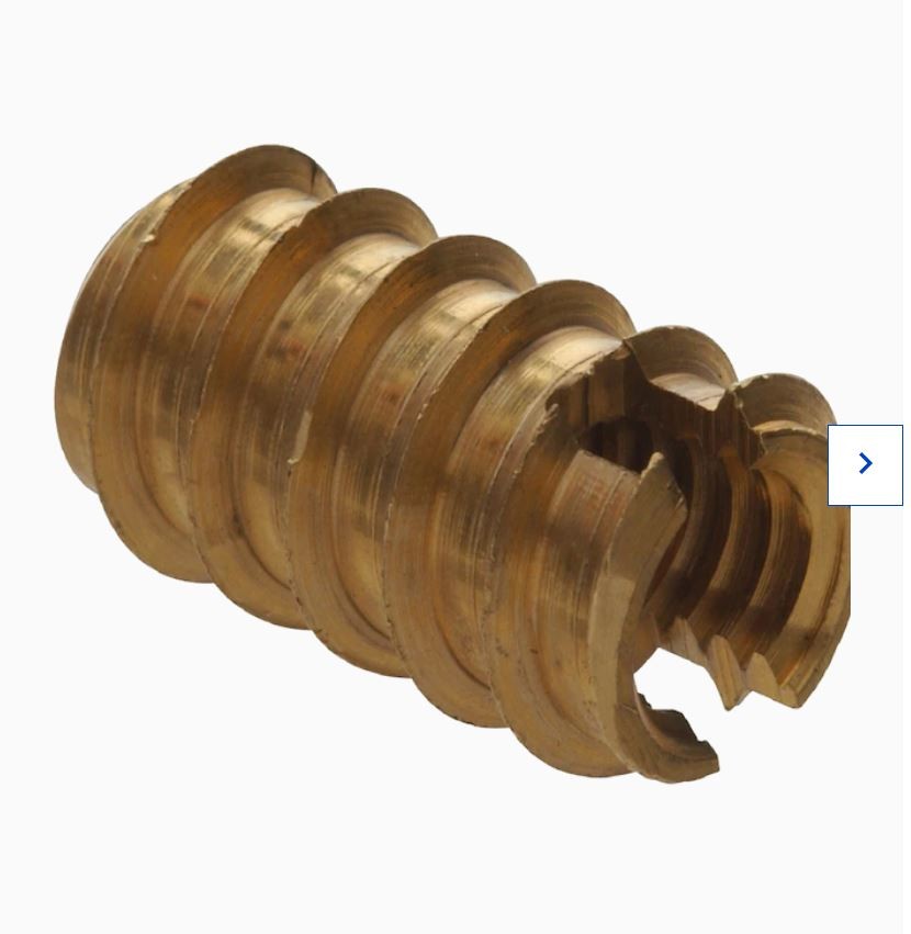

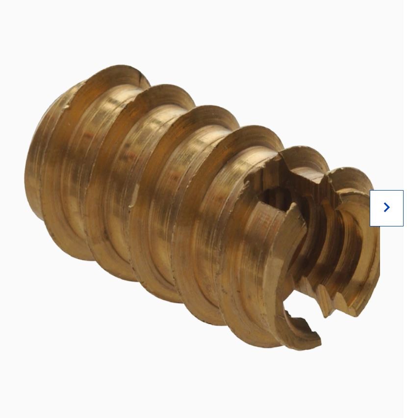

      When I first saw/heard of the magnet mod, the first thing that came to my mind was the immediate sacrifice of structural integrity. Personally, I don't think it's a good idea.

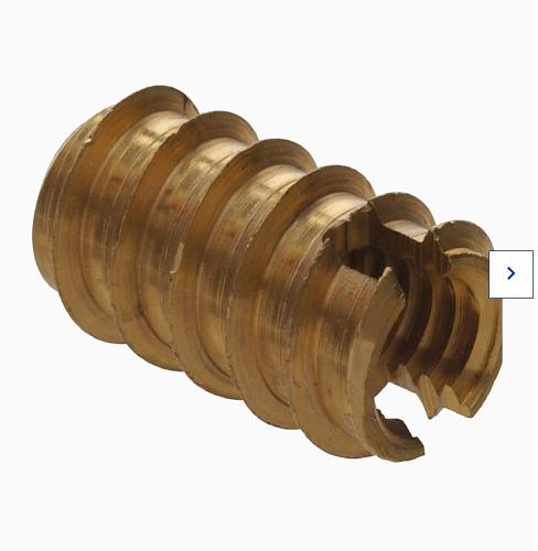

      The thought has crossed my mind however, to drill out the boss, and screw these into the post. That way integrity is increased, and the fear of striping out the hole is gone. I've used them in wood of course, and they work awesome. A tad bit of gorilla glue would anchor them in the plastic quite well I believe.

        The idler mounting surface material does look like it needs a bit of strengthening for the long term especially for use with heavy tracks and upgrades motors turning those tracks. How to best do this? There are a few ways I have seen and that I am testing. To that end I have had two 6.0+ hull for some time now and so far I haven’t broken the stock non strengthening mounts nor the strengthened mounts I am testing. So really at this point don’t know if the ones people have broken were flukes or poor design and material.

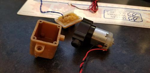

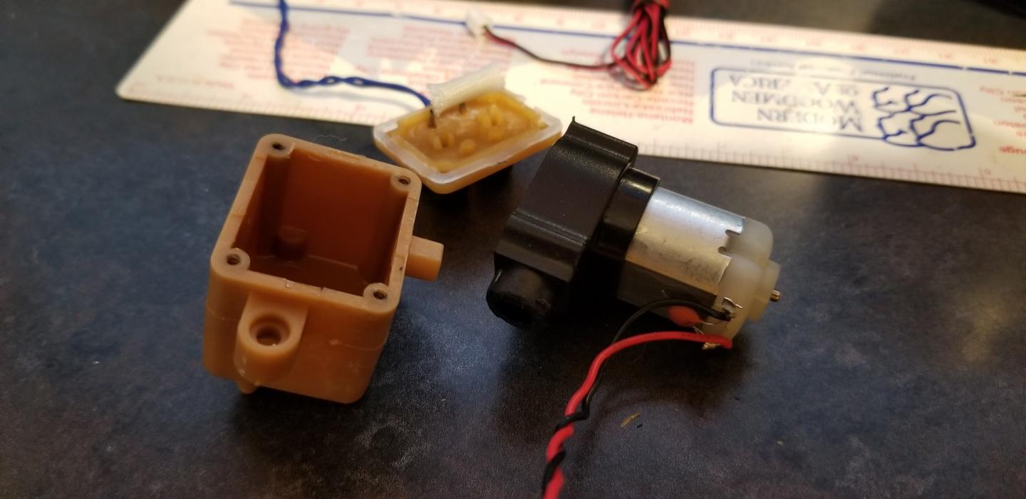

            Fans arrived... I started by giving the stock blower a soak in de-bonder, so I could remove it without destroying it.
            Click image for larger version  Name:	20210508_102453.jpg Views:	0 Size:	87.3 KB ID:	312043

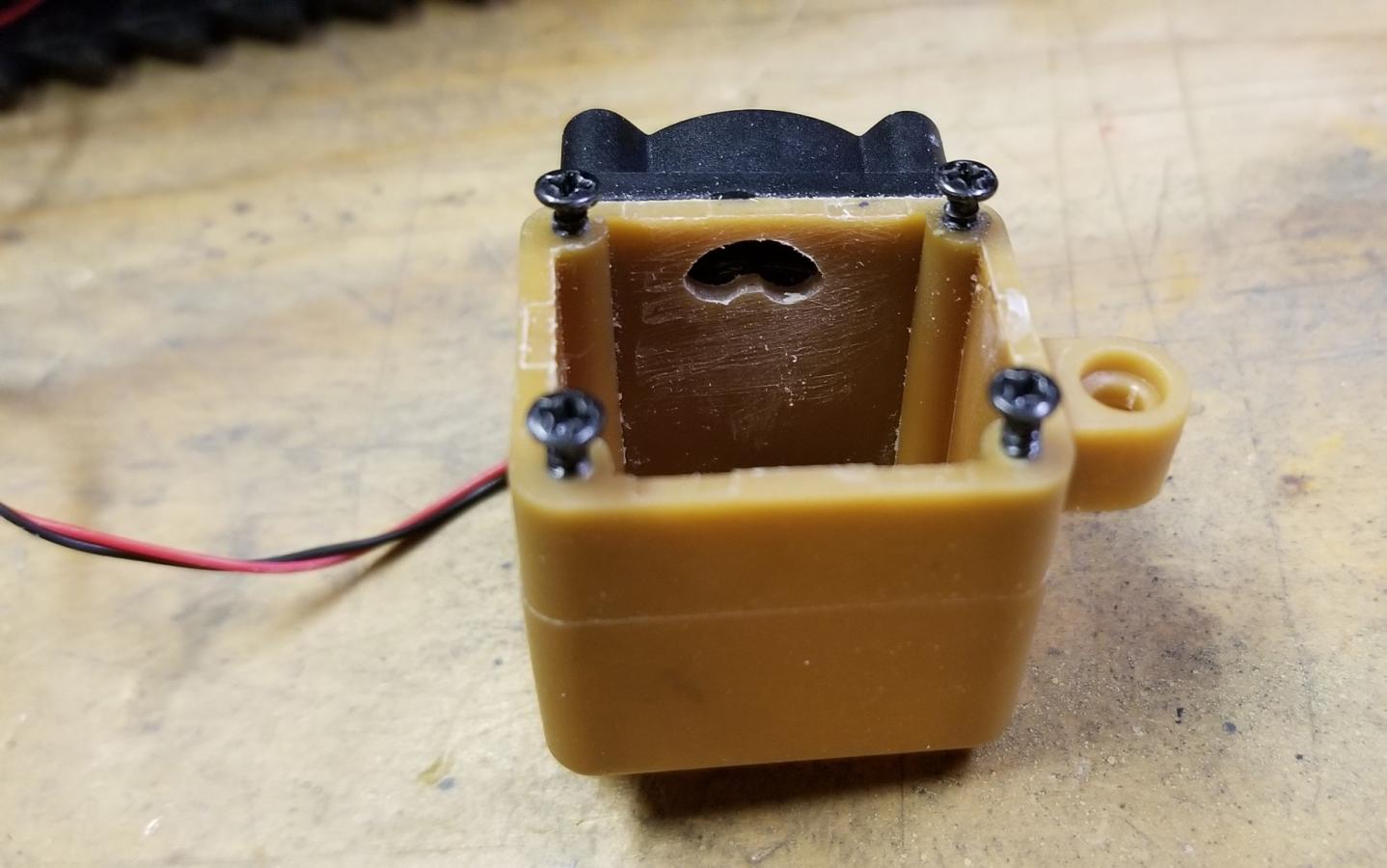

            Then I cut the nipple off, and sanded that side smooth, after which I used a dremel to open up the tiny air intake hole. I tried to make the hole conform somewhat to the curvature of the fan
            The fan was then superglued to the side of the smoke tank....
            Click image for larger version  Name:	20210508_145936.jpg Views:	0 Size:	100.4 KB ID:	312046
            I soldered the JST plug from the original blower onto the brushless fan. The fan would not run in the stock port CN12 (6v) due to the voltage requirement. So it was plugged into unused port CN2 (radiator fan-Battery voltage) instead.
            Now the Walker Bulldog bellows smoke like nobody's business....and its whisper quiet:

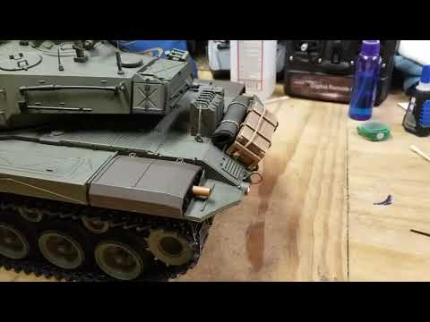

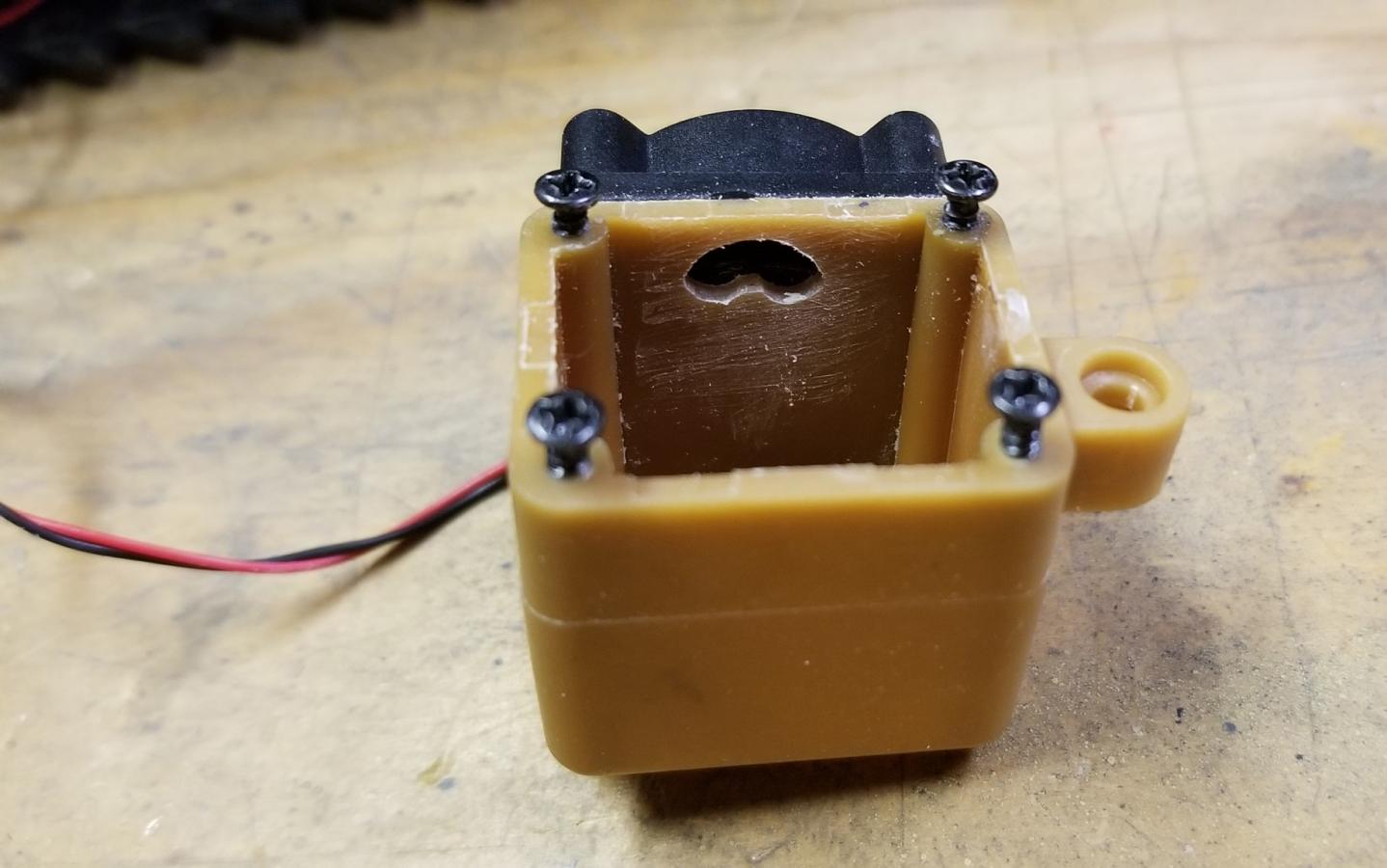

                      The M1A2 Abrams couldn't be neglected...Installed Smoke unit-Love the compactness:
                      And it blows....

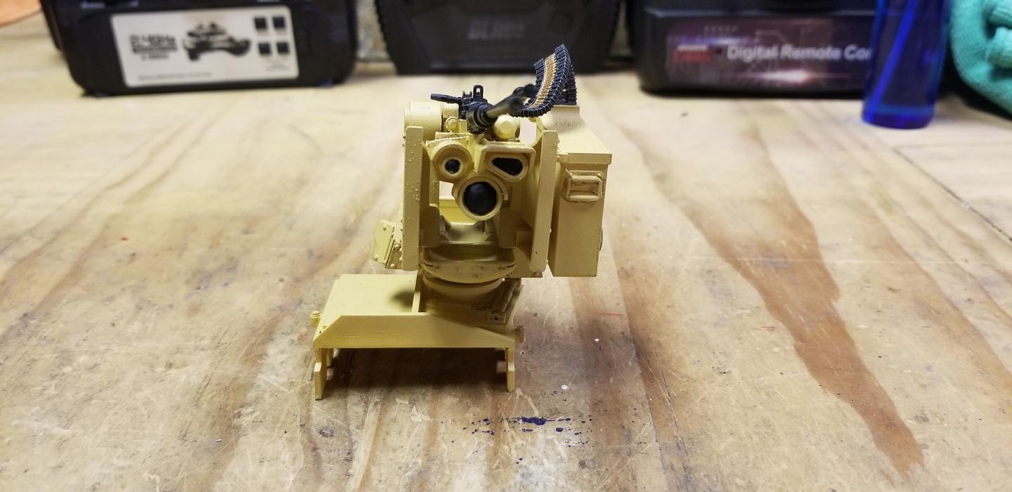

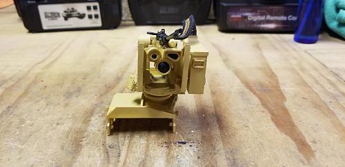

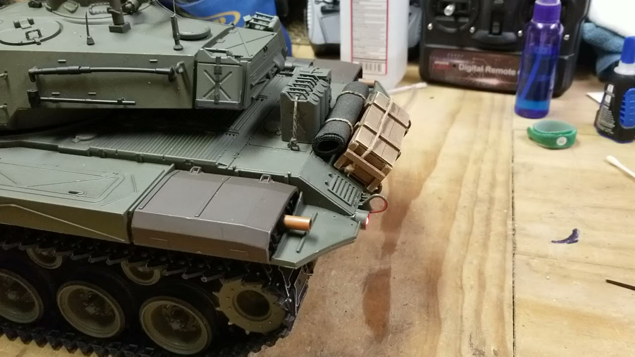

                          I don't own an airbrush, and can't justify buying the whole setup. Like yourself the factory paint on the Abrams was totally way off base, so I opted for this:
                          Its close enough for me.
                          DKLM used Hong Kong Express to ship, and it pissed me off. It literally sat in China for 3 weeks before it even left the country. Ali Express on the other hand got here in 3 weeks.

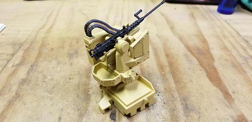

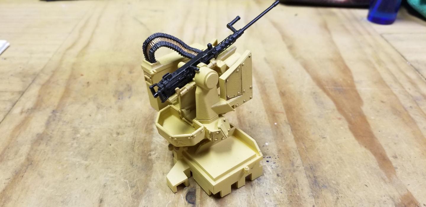

                          Th CROWS was wasted money, as I don't intend to mount it now..

                            The CROWS looks really nice, 10x better than the 2 MG's HL shipped with.

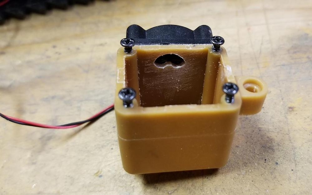

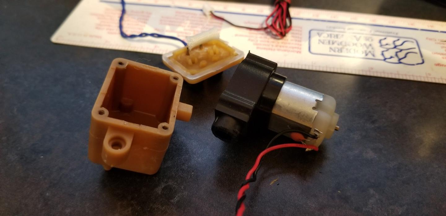

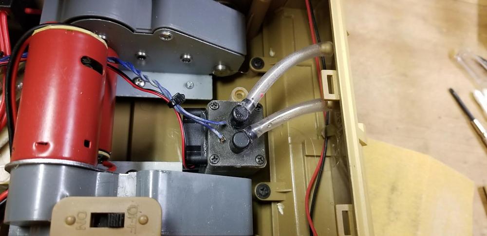

                                      Please forgive my absenteeism. All my Henglong tanks that I retrofitted with the 25mm fan conversion have been working flawless. Yes, on Henglong tanks, the smoke is activated by the toggle switch. Smoke oil that came with the tank is used primarily as its thinner than vaping propylene glycol or vegetable glycerin. My Taigen tank however turned out to be an utter failure. I will be posting a question on that topic right now.
