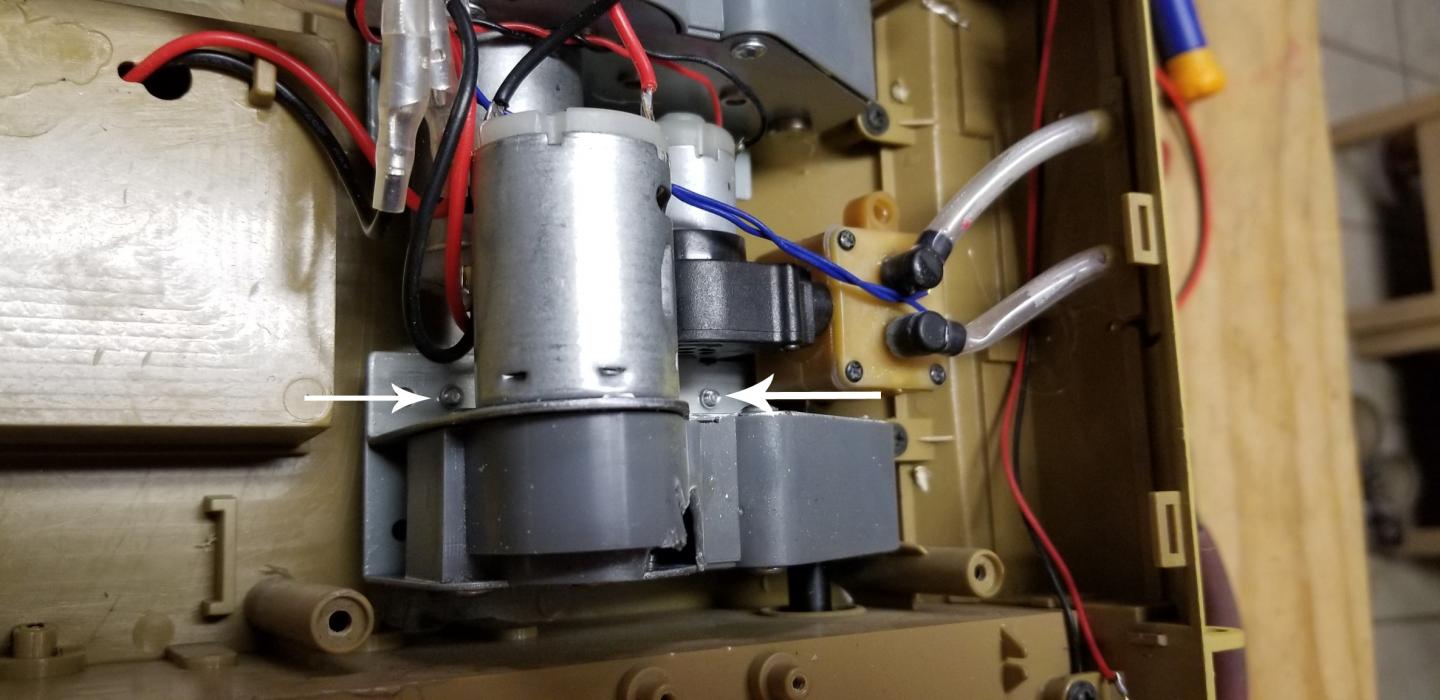

                                Rubicon, went to put motors in, and this is the strangest thing.... Took the drive sprocket off, removed the on/off switch. got it out of the way. The gearbox is in 2 pieces, Right & Left. Starting with the left (upper motor) first, there are 3 phillips screws holding the gearbox/motor in place. One in the center (which is hidden by the motor in this view) and I removed that, easy enough. However, these two screws are screwed from underneath...
                                Ok, no problem, I then turned the tank over and there is NO WAY to access these 2 screws. The bottom of the hull is blank...no holes at all in this location. 8 screws take the upper hull off, and the one remaining screw that's accessed from underneath is to remove the smoke unit...that's it. No floor plate, nothing. How in the hell is the gearbox mounted at the factory? I'm confused as normal.
                                I don't see how the drive shaft is removed from the gearbox either ? I gave it a gentle tug, and it ain't moving. Forgive me for being ignorant. I can usually figure things out on my own, but this has me perplexed and I must tame my Neanderthal instincts on this one, so I don't screw something up beyond my abilities to fix. (FUBAR)

                                    I don't think so, as the screw holes are not slotted. Its almost as if the gearboxes were screwed down, and then molded into the lower hull. Logic would suggest that cannot possibly be the case.
                                    It looks as though the gearboxes were screwed down, then the heads of the screws were sheared off. I find that hard to swallow as well. This is the damndest thing I have ever seen-doesn't make any sense. The screws are too tiny to use an easy out...

                                      All three screws that hold the gearboxes go in from above. Keep looking and you will see them.You will most likely have to remove those covers over the gears to see them. The ones from below hold the gearbox halves together and do not need to come out to remove the gearbox from the tank.
                                      Steve

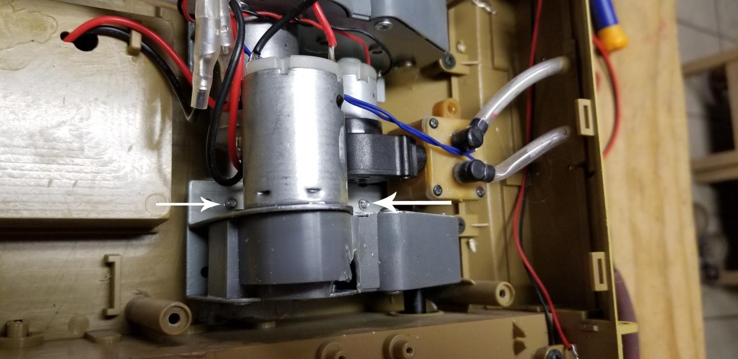

                                        Click image for larger version  Name:	20210407_003202.jpg Views:	0 Size:	100.7 KB ID:	307753
                                        Remove the plastic shield and you will see the other two screws that you have to remove.
                                        Also you will have to remove your smoke unit. You have one of the tanks where the smoke units is attached to the lower hull not the upper.
                                        The drive axles can’t be removed from the gearbox until the gearbox is removed and then you have to disassemble the gearbox. This does begs the question as to why you want to remove the axles if they are working? To do so is not hard just but I recommend taking a few photos of it to remind you as to where everything goes back.

                                          I wasn't sure if the drive axel had to be removed or not. Thank for clarifying that !!
