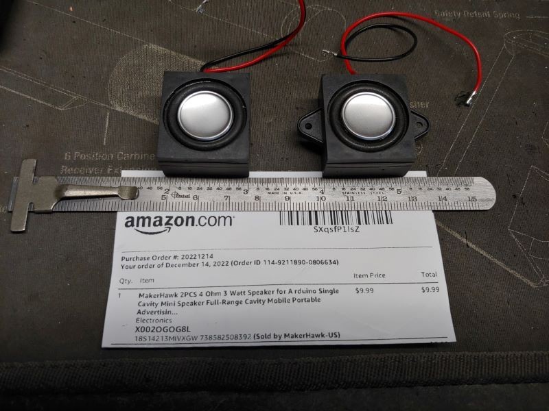

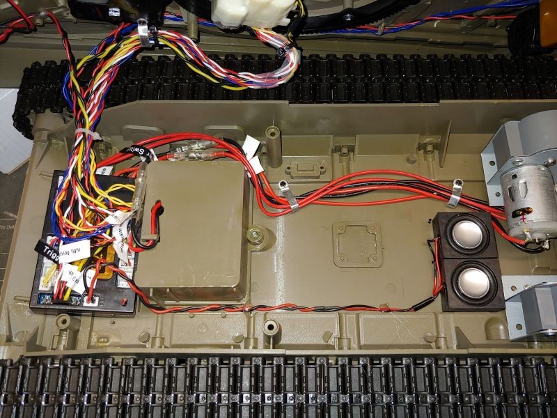

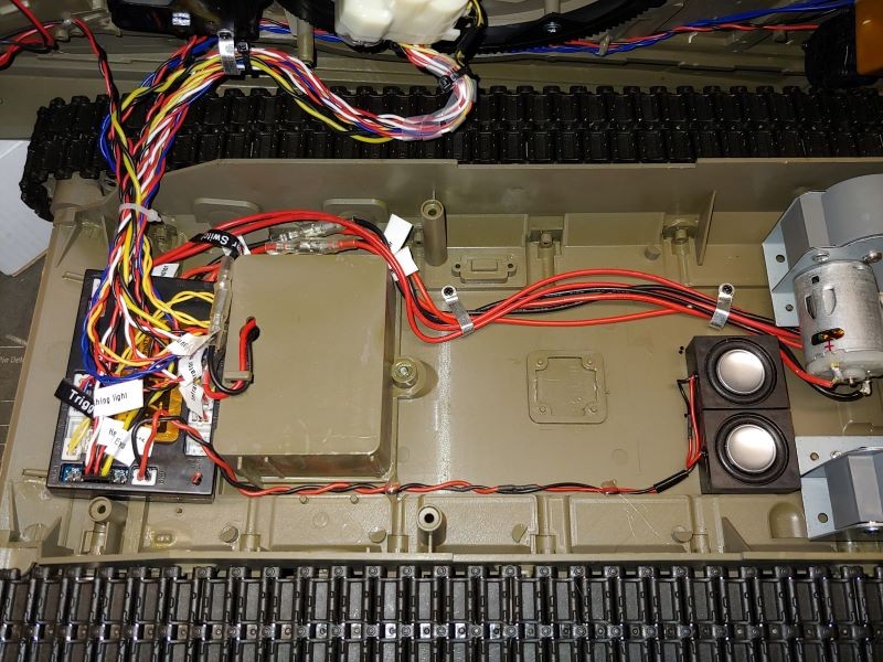

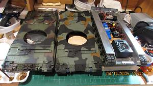

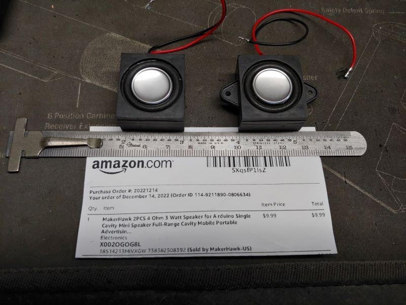

                          Well I ordered and installed the two MakerHawk 4 ohm 3watt speakers I got through Amazon in my T90 with the TK-7.0 board. I trimmed off the two mounting tabs on each one, hot glued them together, wired them in series and hot glued them in place at the rear. They are louder on full volume than the OEM speaker that came with the tank. The low profile of the speakers was excellent for clearing the wiring harness & turret rotation. I'll keep you all informed how they hold up under constant full volume applied.

                            Good deal. Im in the process of cutting out a box for a single HG speaker. I did find out this one was wired in phase as opposed to two others that werent. I also did a Ohm check with my multimeter, and it Ohm'd out at 3ohm. I wonder if thats the reason why folks are burning out their speakers......

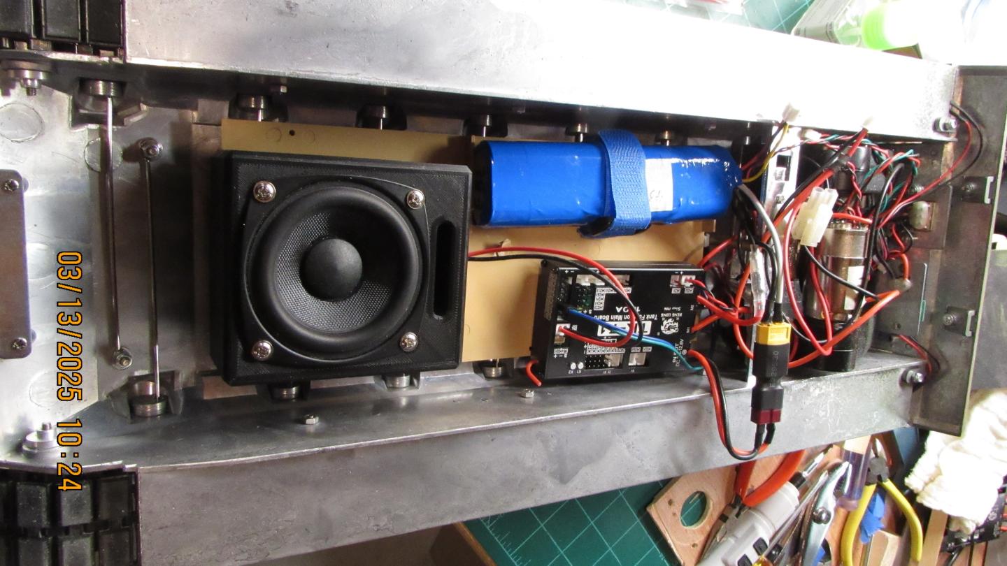

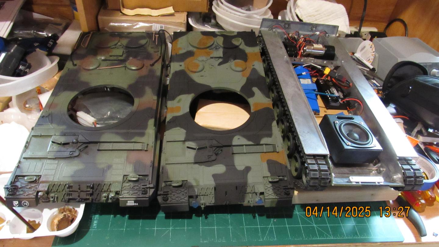

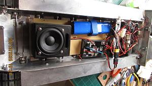

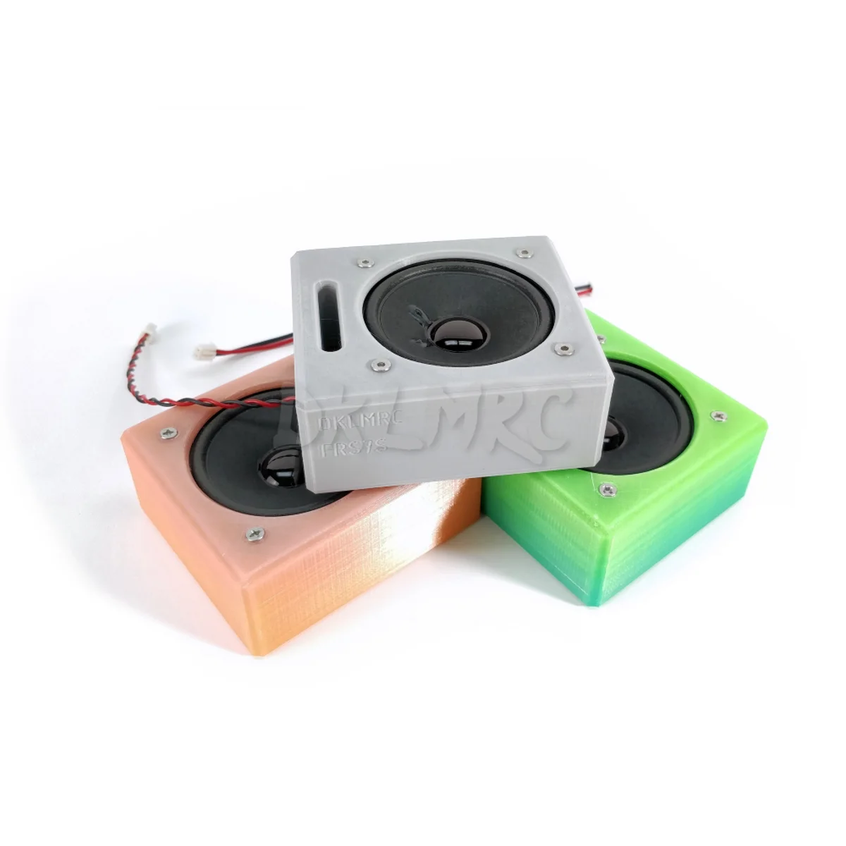

                                        The DKLMRC speaker is highly recommended. More realistic sound for both the diesel (high bass) and turbine (low treble).
                                        3D Print Speaker unit with VISATON FRS7S speaker # Custom speaker box size avaliable! Contact us for Details # New design speaker box with nice sound speaker from Germany! We choose to use VISATON Full Range System speaker (FRS7S). The bass from the speaker is far better than regular FRS7. You will not just heard loudly tank sounds mixed together! Speaker Unit show as pic. Dimension : approx. 8x9x3.7 (cm) Pre-assemblied and soldered with regular HX2.54 plug that fit most tank board on the market. We print in different colors, speaker box ship with random colors.
                                        ​I built mine using plastic project box and lined the inside with elastic damping liner (3M). I used Dayton Audio 2.5" with larger magnet and higher efficiency. I like it a lot.​
                                        Click image for larger version  Name:	IMG_5487.jpg Views:	43 Size:	157.1 KB ID:	449212 Click image for larger version
