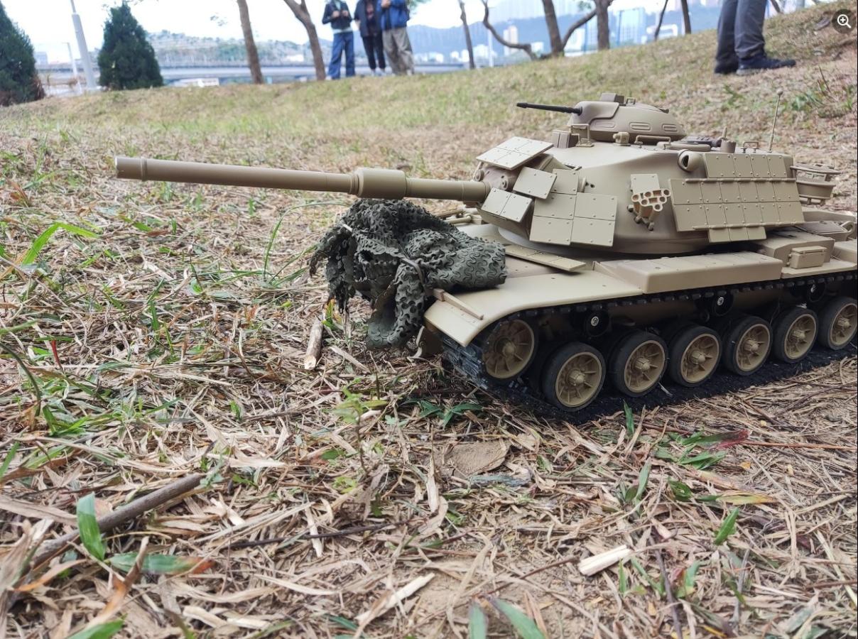

        No, not mine! I subscribe to the Hong Kong Tank Club. This showed up there. Not vaporware!
Name:	Screenshot 2023-01-08 082923.jpg
        Hmm, maybe I should paint the ERA panels silver for IR battles, so the beams get deflected!

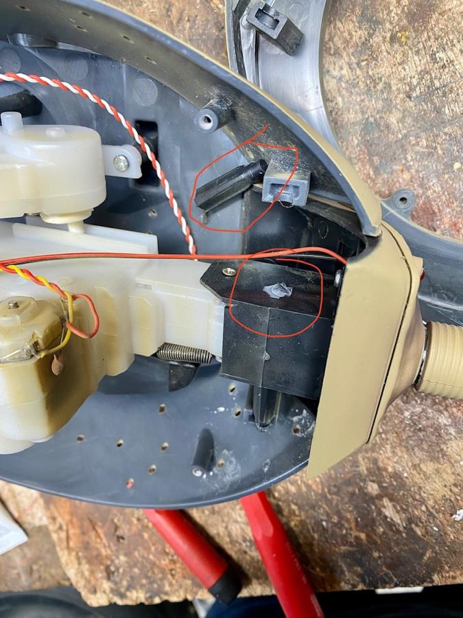

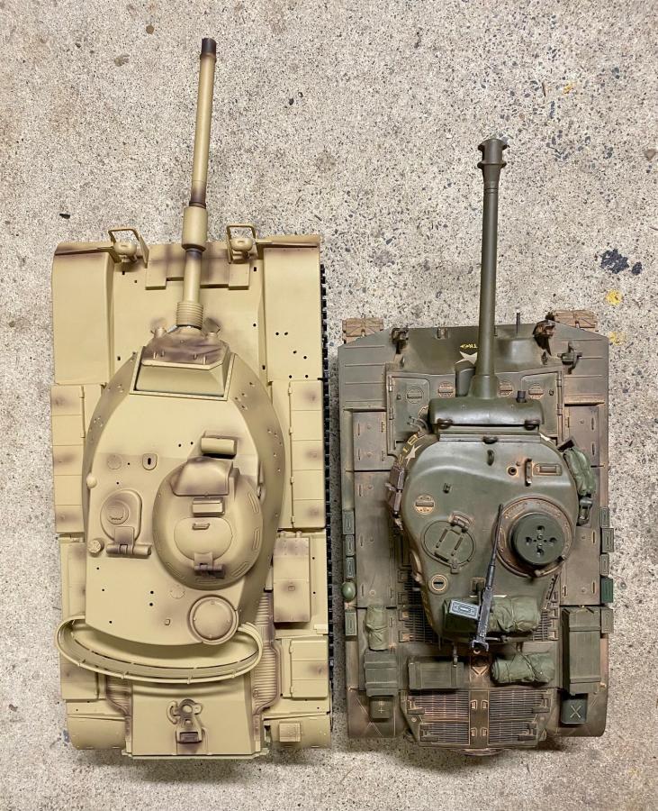

                Ok, mine arrived today. 8 days from Hong Kong to California.
                I'll have to give it a red light for now. I'll be looking at it more in the daylight.
                It's packed like a standard HL type product. That's good.
                First thing I checked was the interior. It doesn't come with a battery since it's shipped air freight. I had one ready to go.

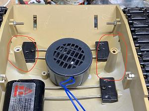

                The MFU, speaker and my battery are not fastened down to anything, just sitting loose. I expected that from the early pictures, and I plan to mount a plate inside to hold these components.
                Now the bad stuff:
                One gearbox isn't working, our greatest fear. Slipping and grinding, and finally quit. I'll be disassembling it tomorrow.
                The plastic isn't as robust as HL. Two of the four posts to mate the top and bottom hulls were broken. I intended to use magnets anyway to hold it together to make battery replacement easier, but the plastic looks cheaper, but not 3DP as far as I can tell.
                The main gun pintle broke after a few elevation cycles. Again, cheaper plastic.
                Other observations:
                Controller is 95% similar to HL, just some cosmetic differences. It uses four batteries, not six like HL. Buttons have the same basic functions.
                The tank is painted tan overall with darker highlights, a la HL. The actual plastic is white.
                It has headlights and taillights that flash until the start button on the controller is pressed, also like HL
                Lots of accessory parts.
                The smoker is bolted to the hull (!) I haven't activated it yet.
                The turret traverse & gun elevation motors look to be the same as HL.
                The
                Acceleration and braking (before it "tanked") has momentum. I don't know if that is programmable.

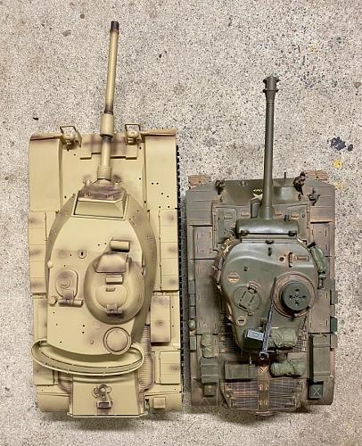

                One photo for now, a size comparison with my M26 Pershing.
                Looks like I have a project on my hands!

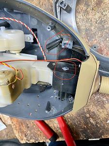

                        Update, "the morning after":
                        Oldwolf, I looked at the manual (!) and acceleration and braking momentum are programmable, including eliminating it.
                        I emailed DKLM RC last night and already got a reply, saying there'd be no problem replacing the gear box.

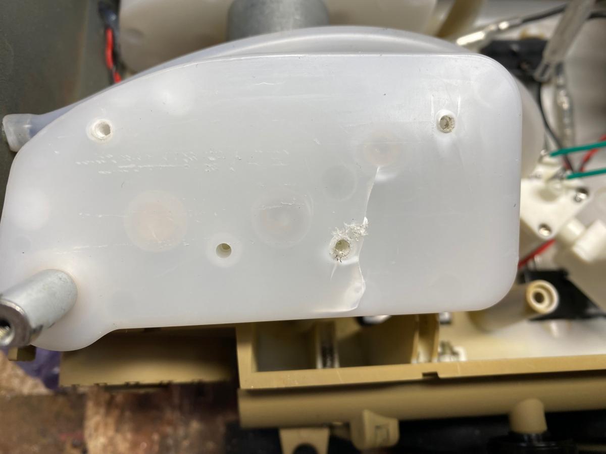

                        To the meat of the matter. I took the gear box out. Broken case, but not fatal. Opened it up. The reduction gears are seated in bushings, and one was out. I reseated it, secured the bushings with a touch of glue, reassembled it and it runs.....at least for now. We'll see how it lasts. I'll still get a replacement. Looking at the possibility of substituting HL gearboxes, there are mounting holes in the chassis that match HL's. However, the TD drive shaft is much longer that HL's, so that would be a problem.
                        The smoker works. No smoke oil, also probably due to international shipping constraints. I got lots! The airsoft launcher works. I haven't opened up the turret to see if the pintle is repairable.
                        Broken mounting posts, glued back.

                        Cracked gearbox. (There are rumors of metal replacements, show up on Banggood, don't know if they will be available.
                        Click image for larger version  Name:	IMG_3181.jpg Views:	0 Size:	63.5 KB ID:	366915

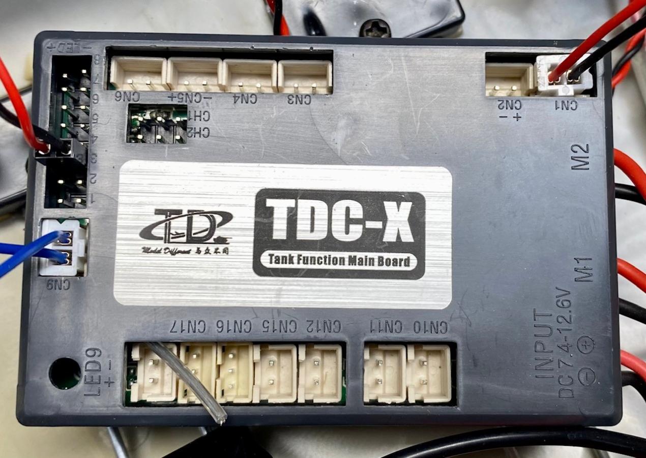

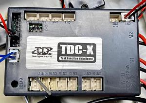

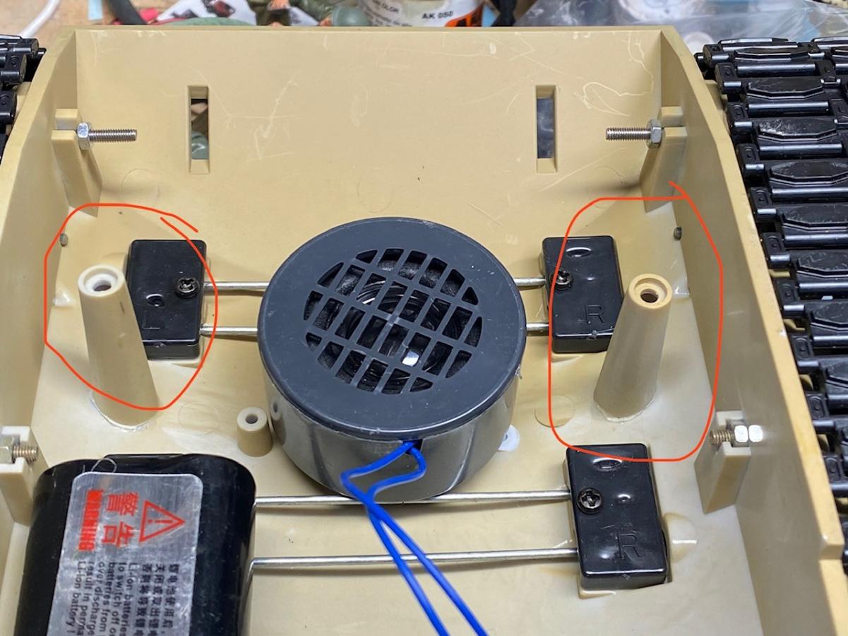

                        The TD MFU. Slots are identical to HL's. Haven't checked if there are multiple soundtracks, but the stock one is pretty cool on startup.
                        Click image for larger version  Name:	IMG_3180.jpg Views:	0 Size:	151.7 KB ID:	366914

                                  #17
                                  I'm pretty much done troubleshooting for now. I'll use it for a time to see how well it lasts. I'll bring it for the show & tell on 1/22. I'm beginning to add the external detail, but I don't expect to have it all pretty by then. I'm going to spray it with an overall "iraqi sand", which will lighten it up to simulate sun bleaching. Question for the 1:1 scale tankers out there: what are the ERA brick surfaces made of? Do they rust?
                                  Some more random points; the tracks are double pinned. The suspension arms are plastic. The wheels are bolted in from the inboard side of the suspension arms. Hubs will conceal the bolt heads outboard.
                                  The worst of the three defects is the broken pintle. I've glued it and it works for now.
