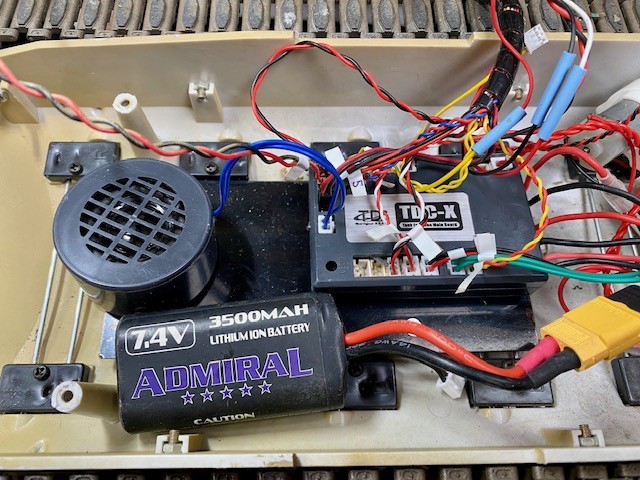

One more set of questions Bob. If I plan to convert this M60 to an IR battle tank, does the Tongde board work with the LegoDEI receiver? Or do I need to replace it with the HL board? The IR unit that came with the tank isn't compatible with our battle setting, correct? Thank you!Originally posted by SoCalBobS View PostYou can have the most fun doing your own paint job with that one. Lots of camo schemes out there.SoCal RC Tank Club Facebook Group

The IR circuitry is compatible with HL and Lego. The receiver is like the stock HL. With TD Tx & Rx, the emitter and receiver activates HL & Lego. I got about 30' emitter range on a Lego in shade. Of course you will want to upgrade both for IR battles.Originally posted by DavidN View Post
I don't think you can interchange the Tongde Tx or Rx with HL, but I didn't try every combination, TD Tx w/HL 6.0 or 7.0 Rx or HL 6.0 0r 7.0 Tx with TD Rx. The instructions make appear to be similar to a 7.0. I installed a HL 7.0 Rx at the L.A. battle, but mainly to eliminate carrying an extra Tx. I'll be switching back sometime.
___________________________
I did a couple of modifications you might consider. I replaced the hull screws with magnets so I could access the battery for replacement. There are some screw sockets on the bottom hull that leads me to believe they were going to put a plate over the torsion rods for the board and speaker. I made my own and secured it with screws.

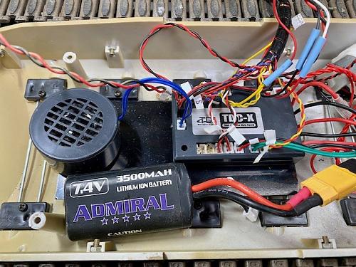

Just a little update; I decided to keep the HL 7.0 board, purely for cosmetic reasons. My taillight LED circuit goes to my Lego light. I plug my taillights into the brakelight circuit, and I plug my blue beacon into the gun aiming circuit. I couldn't get the brake and aiming lights to work on TD. Not sure why.Originally posted by DavidN View PostThank you Bob for the clarification!The more screws it takes to reassemble a tank, the more likely it is you left something out!

Gosh, I never changed it from what it came with. It's a diesel startup, no bells or buzzers, then settles down to a diesel like idle. If I get a chance, I'll hook up a speaker to it and do some fiddling.Originally posted by tank_me View PostBob,
What sound set is loaded on the TD control board? Are they just using like the Leopard one?
Derek
edit: Ok, I checked; two sounds, a rackety diesel, and a smoother engine maybe gas.The more screws it takes to reassemble a tank, the more likely it is you left something out!
