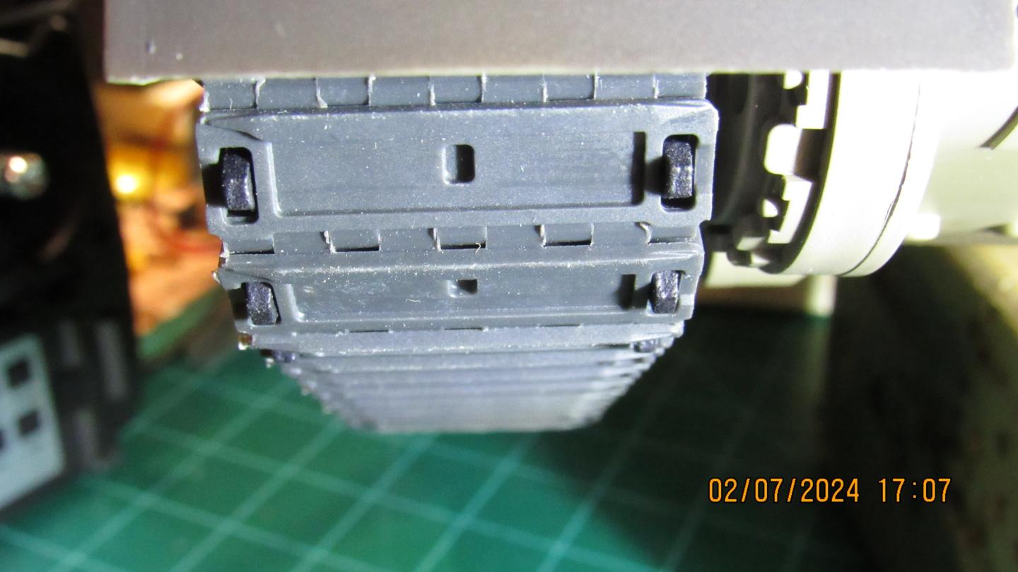

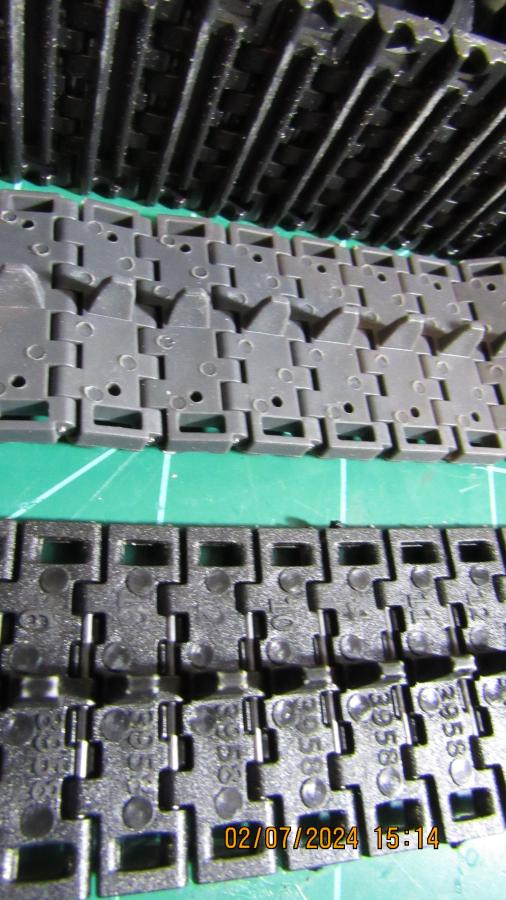

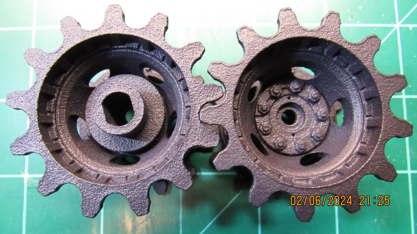

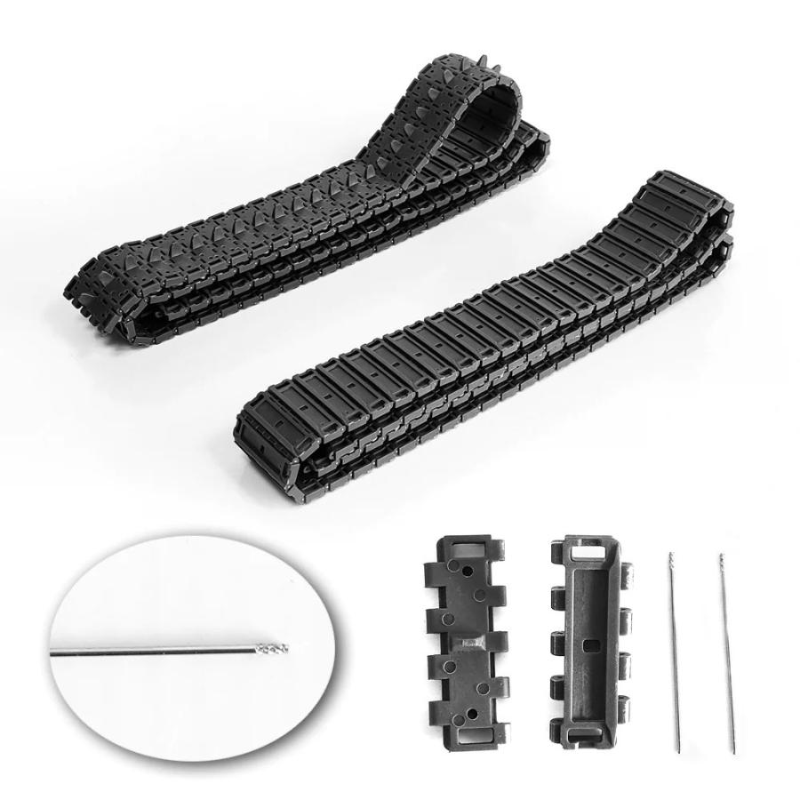

    I ended up upgrading to the Hooben nylon track and spocket. For the Heng Long track, the wear and stretching comes from its open pin design. The completely enclosed Hooben track is much higher quality.

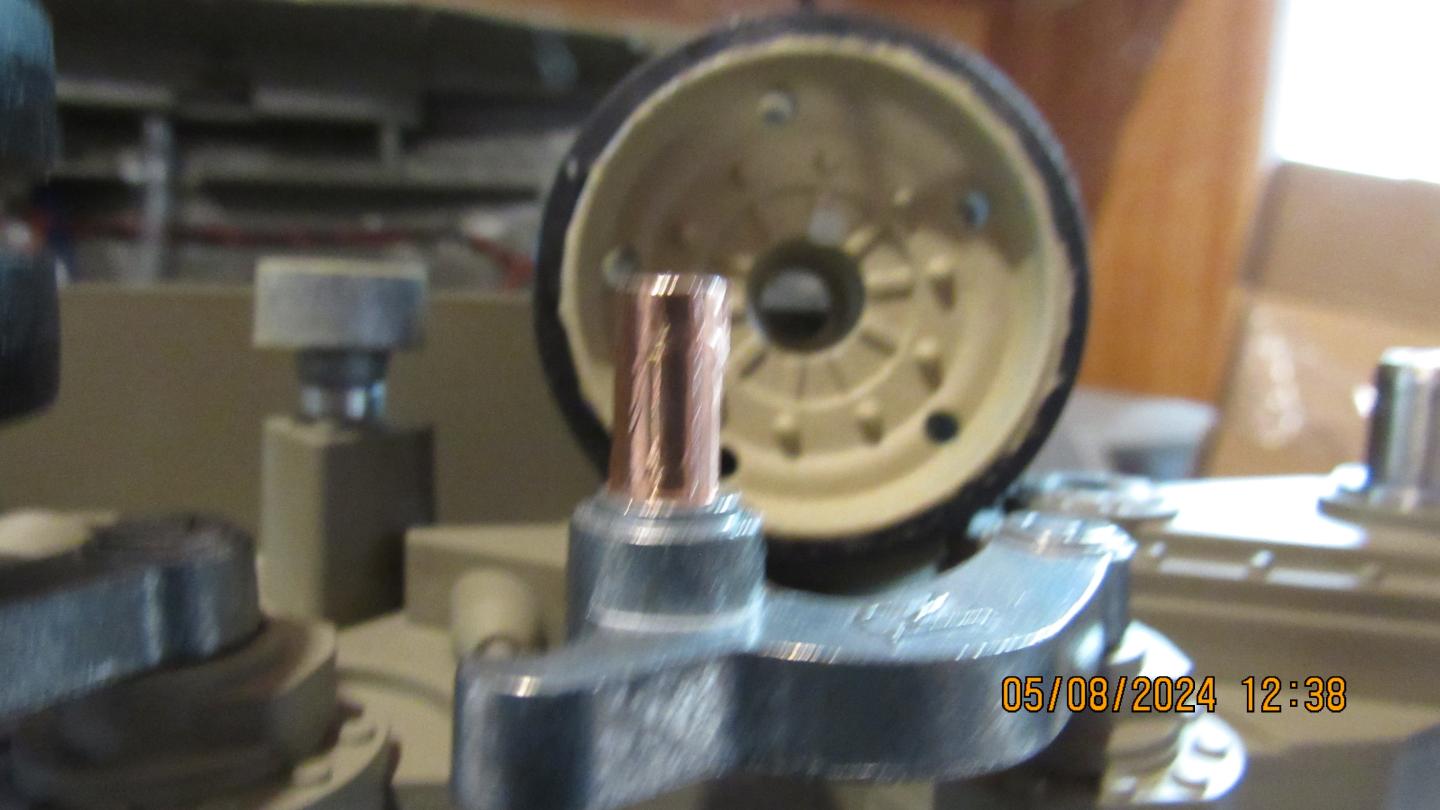

    Use the robogrip piler instead of an arbo press for light job is a widely used practice in machine shops, research lab and model shops world wide. I do not take an video, but that's how I fit the metal road wheels onto the suspension arms of the HL Merkava, thanks for your brass foil suggestion to fix the under sized arm axles.
