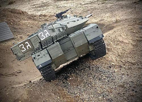

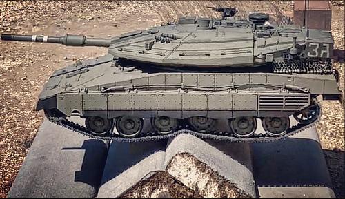

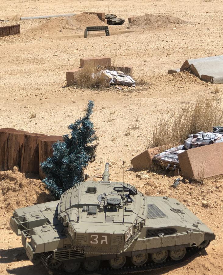

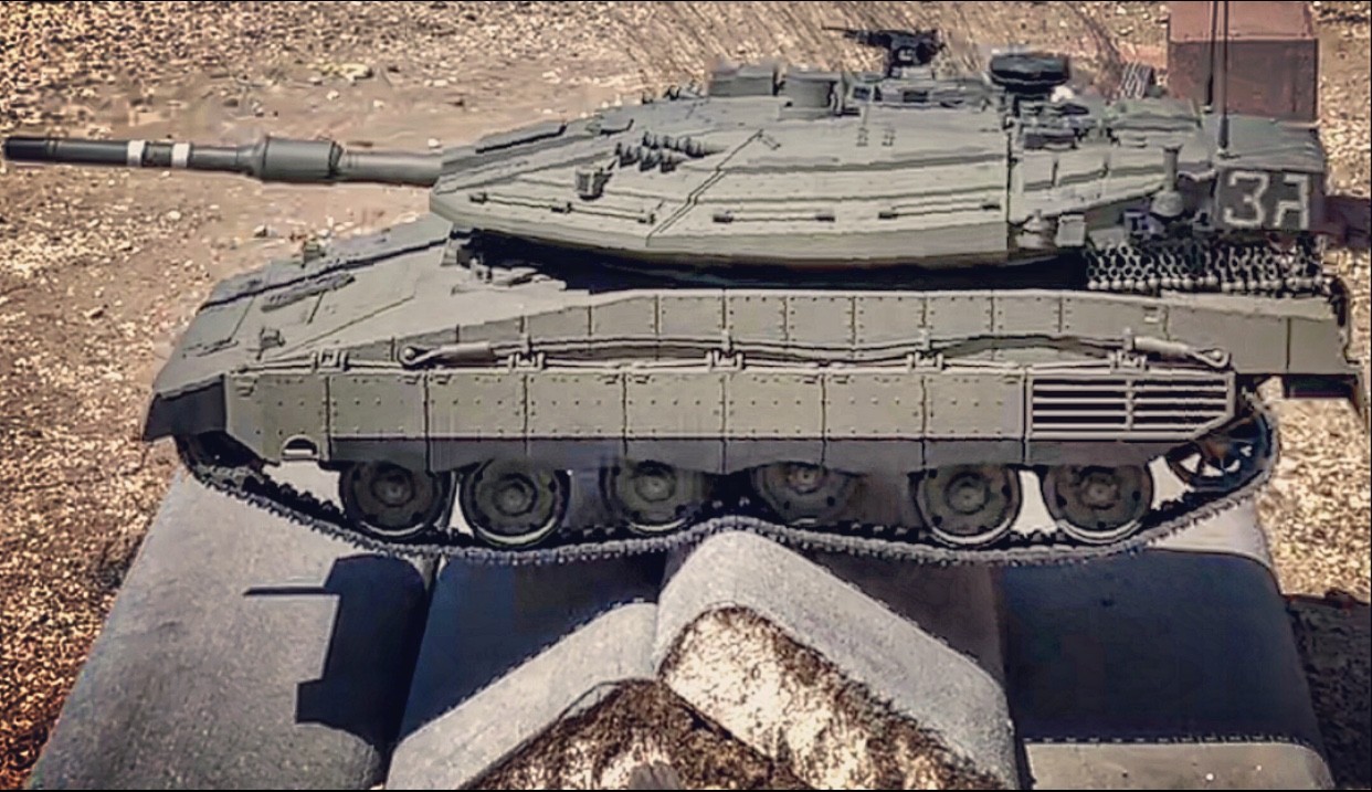

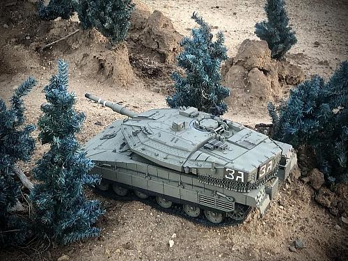

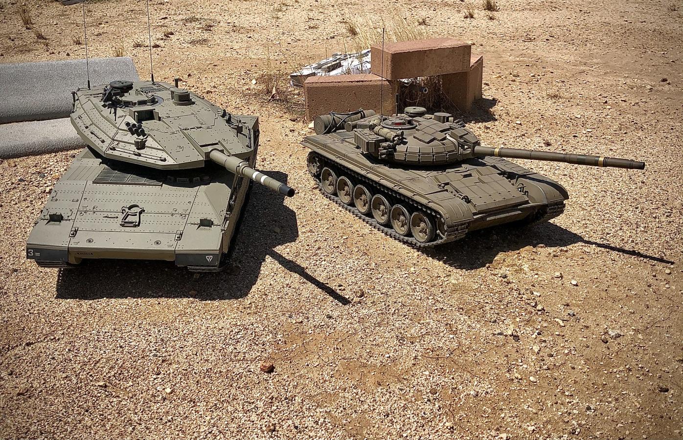

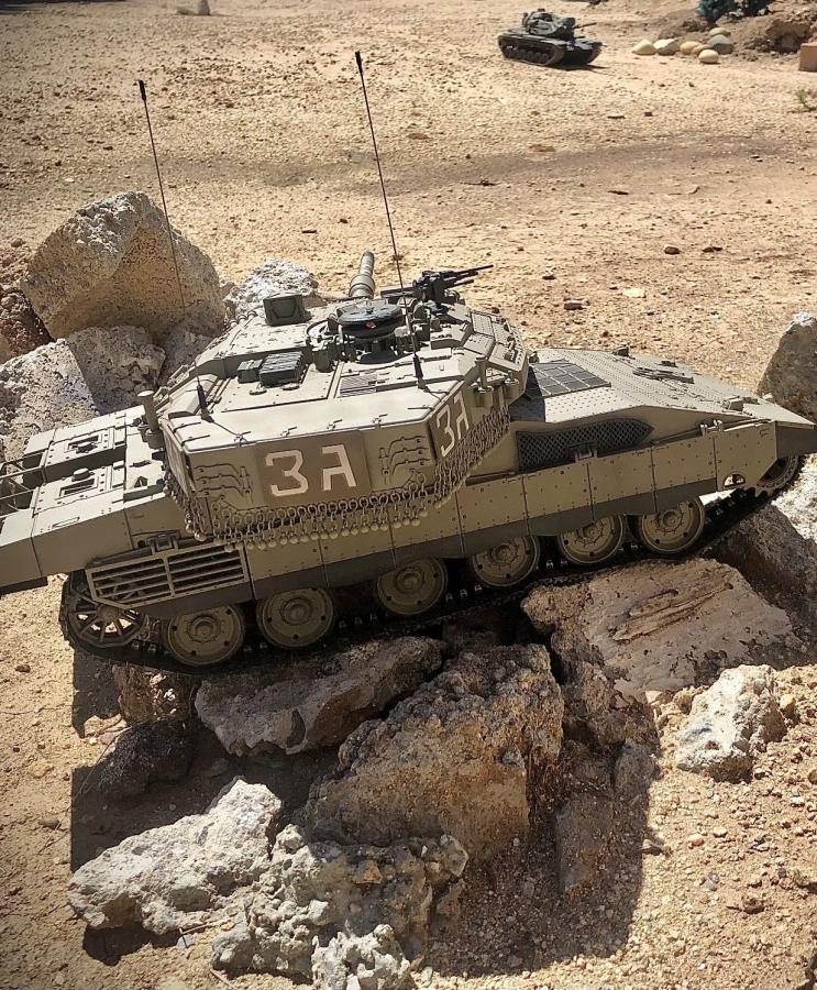

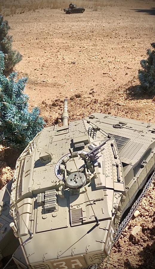

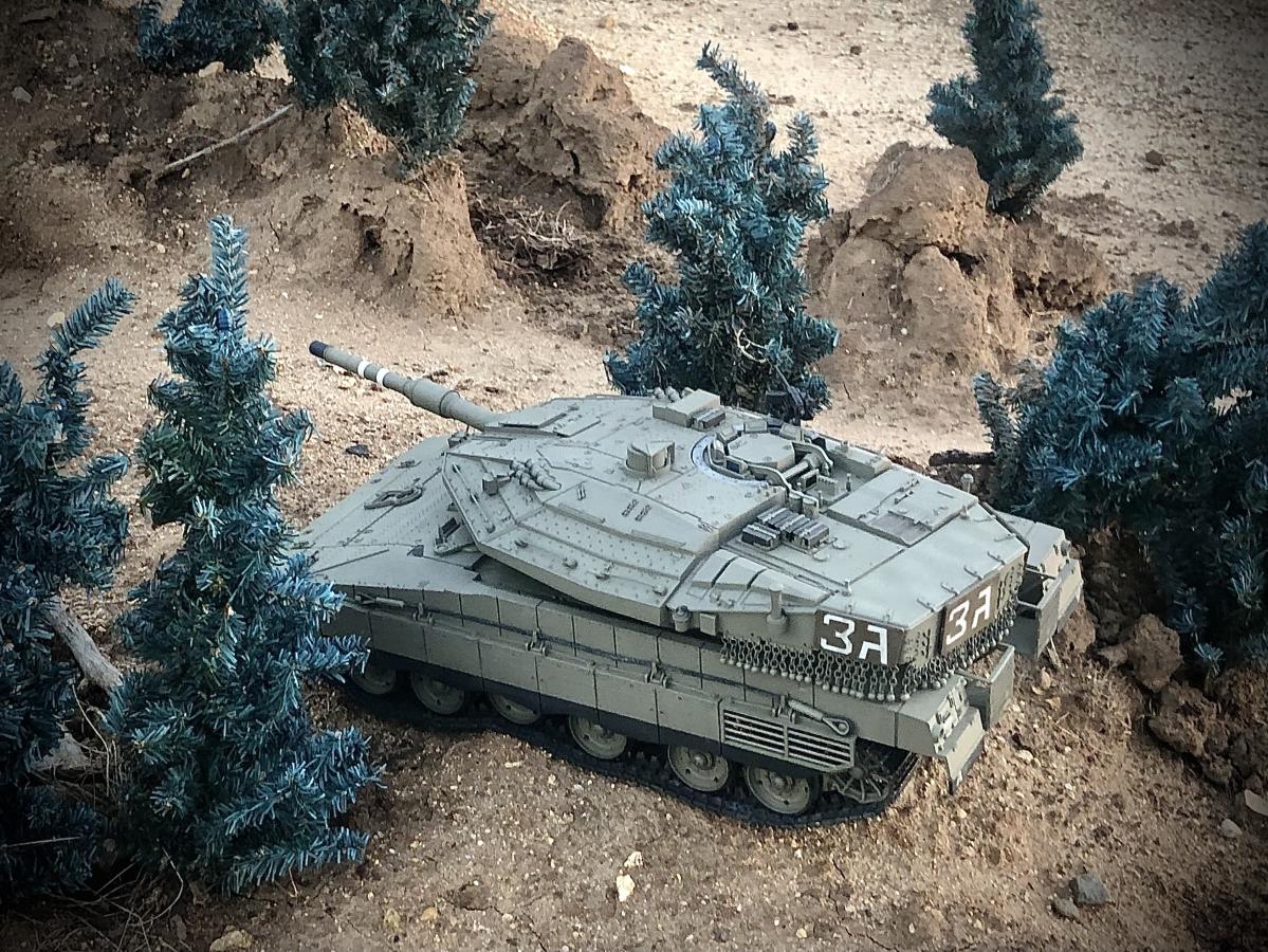

    A few of mine in testing and combat practice.

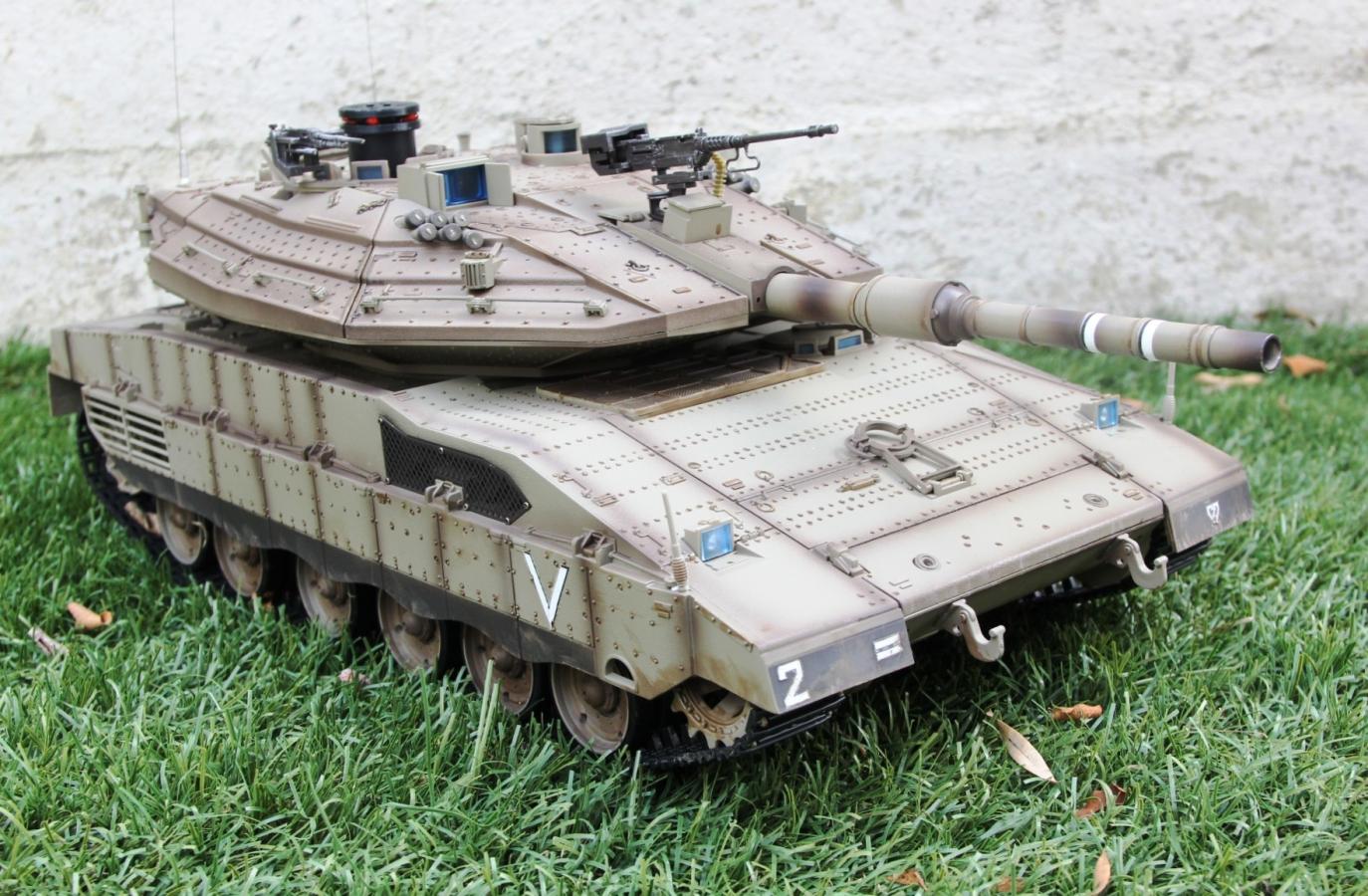

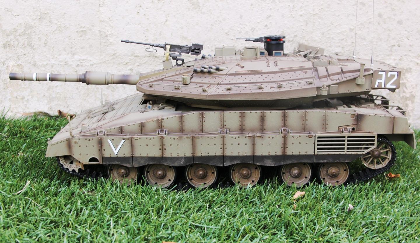

  • DavidN

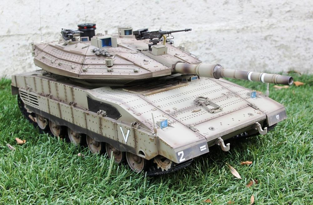

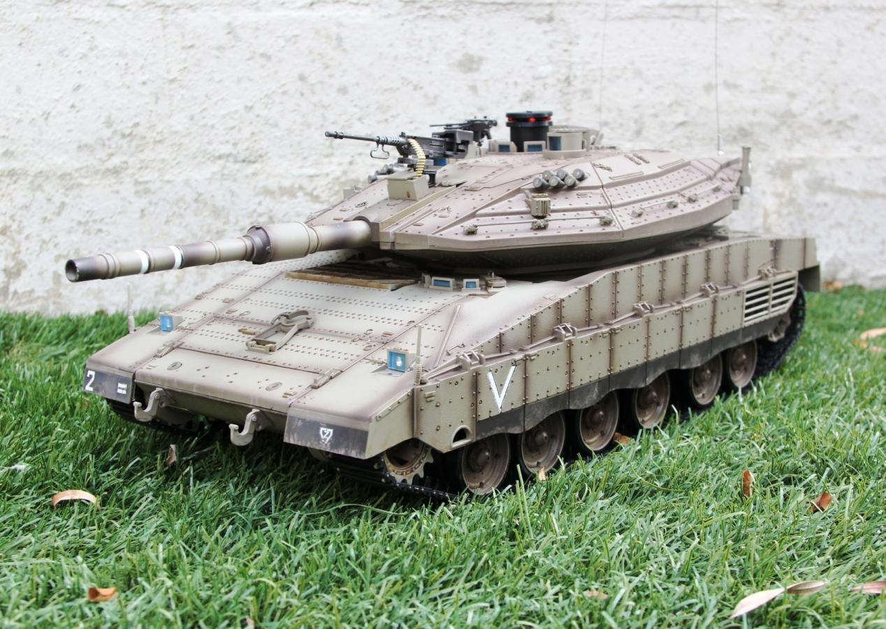

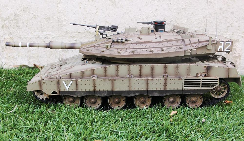

    Here is my Merkava straight out of the box. I only upgraded it to IR battle and switched the barrel recoil unit with the servo converter from Germany. I also did some weathering. I don't like those chains and balls so I did not install them.

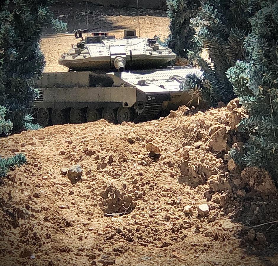

  • Rubicon99

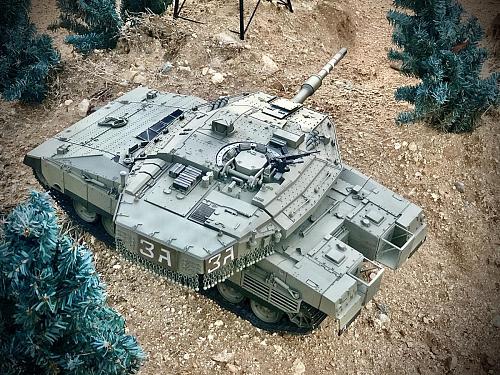

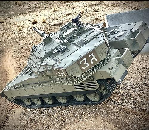

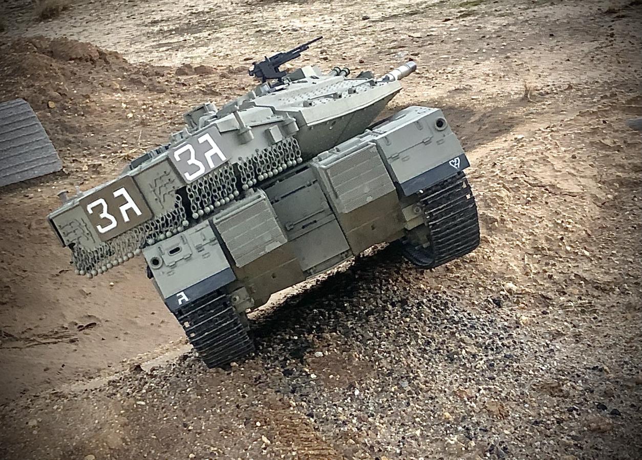

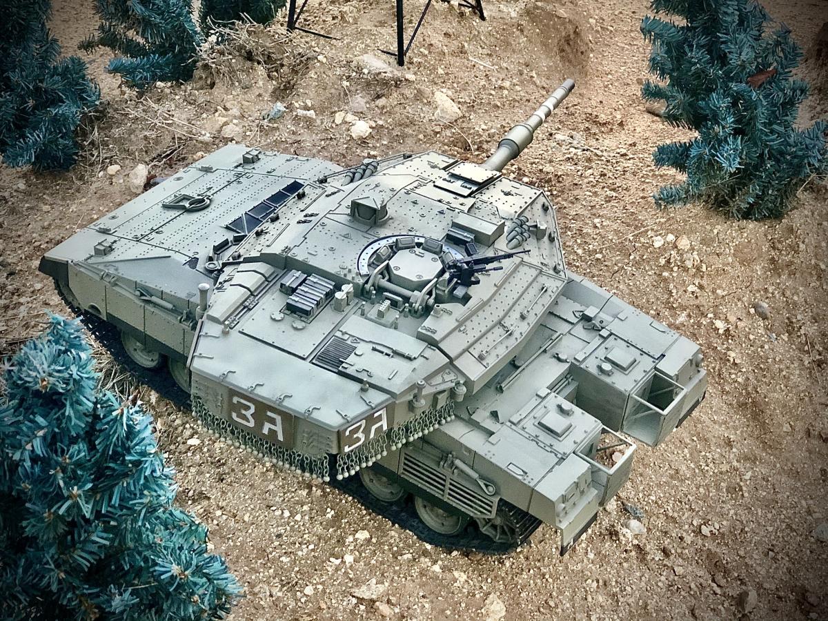

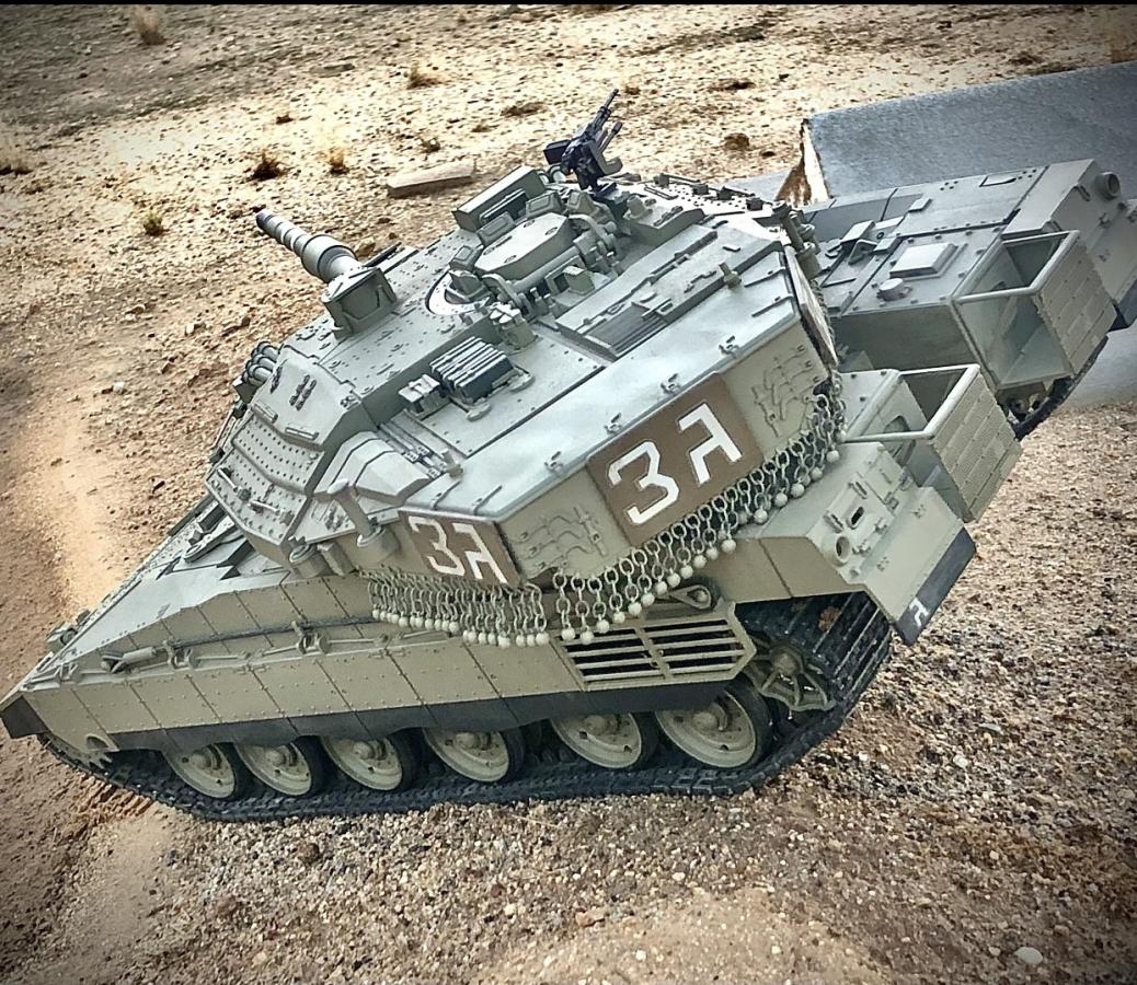

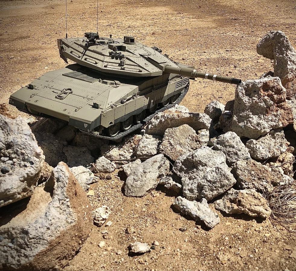

    Merkava is DONE!! Now onto putting it through it paces, so off the trials course and combat range.
    Videos of Merkava testing are going up on my Instagram @ fsttanks Click image for larger version

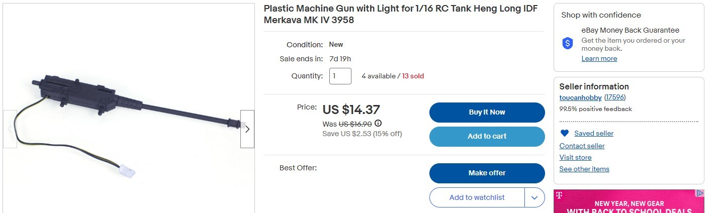

  • SoCalBobS
    FYI for those working on Merkavas, I saw this on eBay. It's a screen capture, not live.

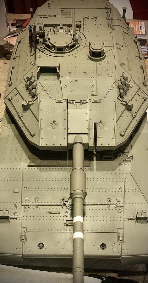

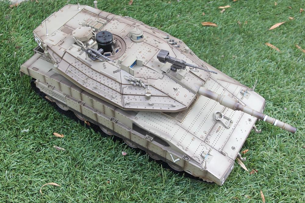

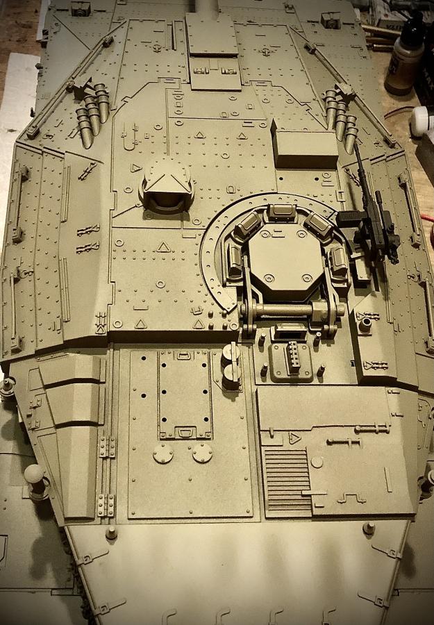

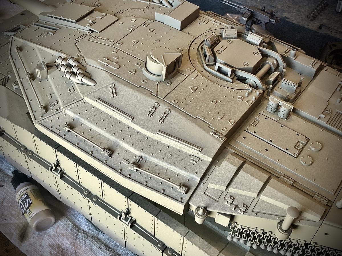

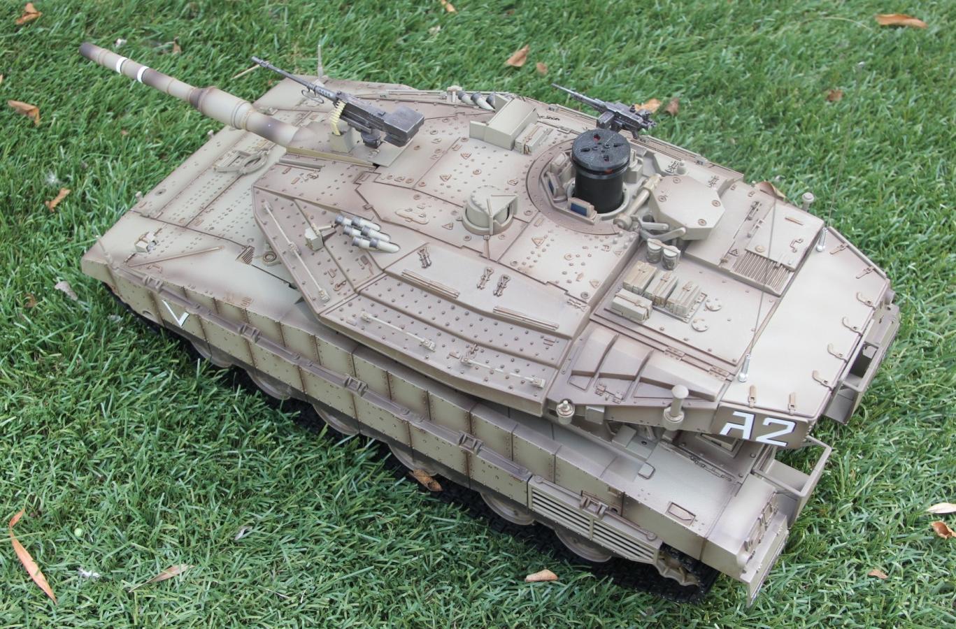

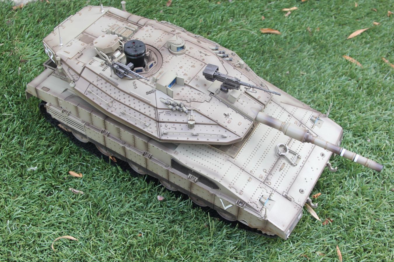

    PART 6: Basic paint and weathering.
    After some long thought and a few conversations with RichJohnson the paint color "guru" I decided to go with a Vallejo "Tan Green Hemp" FS34201 color. It's the color several IDF modelers in Israel recommended as the closest color to the Merkava MKIV and other current IDF equipment.
    Below is the new color. Please note that this is just the basic coat NO detail paint or weathering has yet been added. That is coming shortly.

ID:	384787 In this photo the color looks more desert tan with almost no green tint. Similar to what is seek in many reference photos of the MKIV out in the desert on maneuvers.

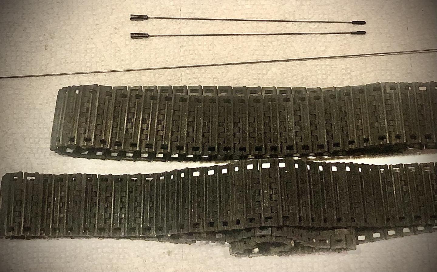

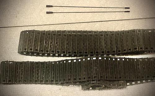

    Some miscellaneous work.
    Two of the four antennas have their modifications done and the tracks have been "dirty blued".
    Still waiting for the "special order" paint to arrive so I have slowed down the build process a bit.

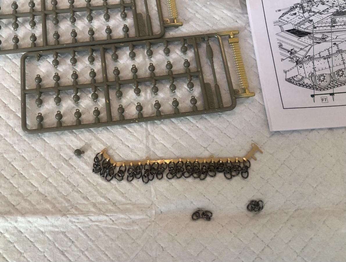

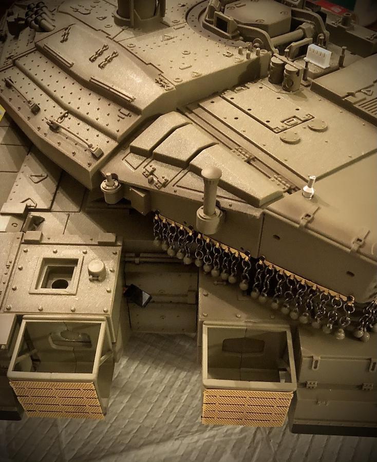

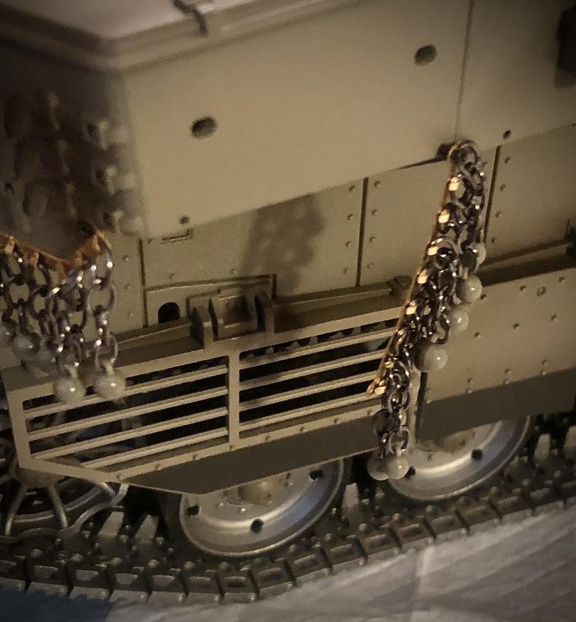

    PART 5: Hull and turret details.

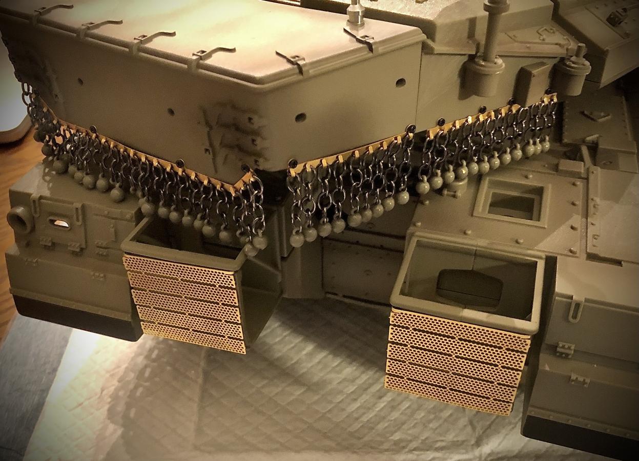

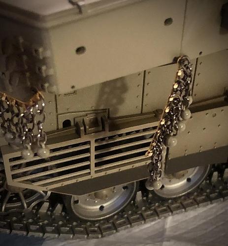

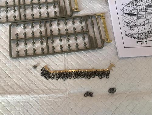

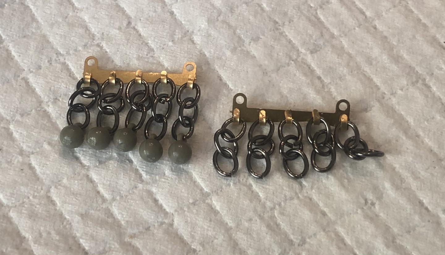

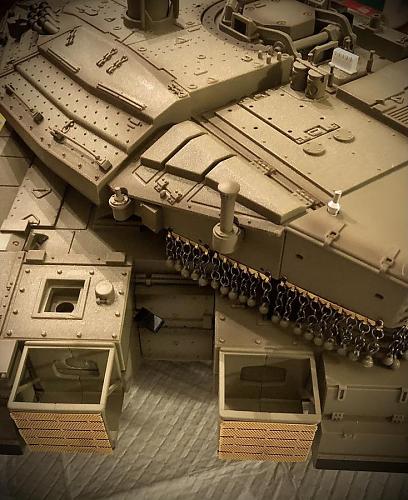

    Spent the evening adding the turret "chain & balls" and other small details parts. The "chain & balls" do require a bit of focus and time to install so plan accordingly for them. Also HL provides ample extra chain and several spare "balls". In retrospect if I was to install the "chain & balls" again I would use slightly smaller chain links. The ones provided ate a bit out of scale.
    As for the other small details accessory they all went on easily. But I do have one complaint and heads up to anyone thinking about a Merkava. The instructions are not in order or clear and jump around a bit. By far the worst I have seen from Heng Long.
    Photos of the "chain & balls" installation.

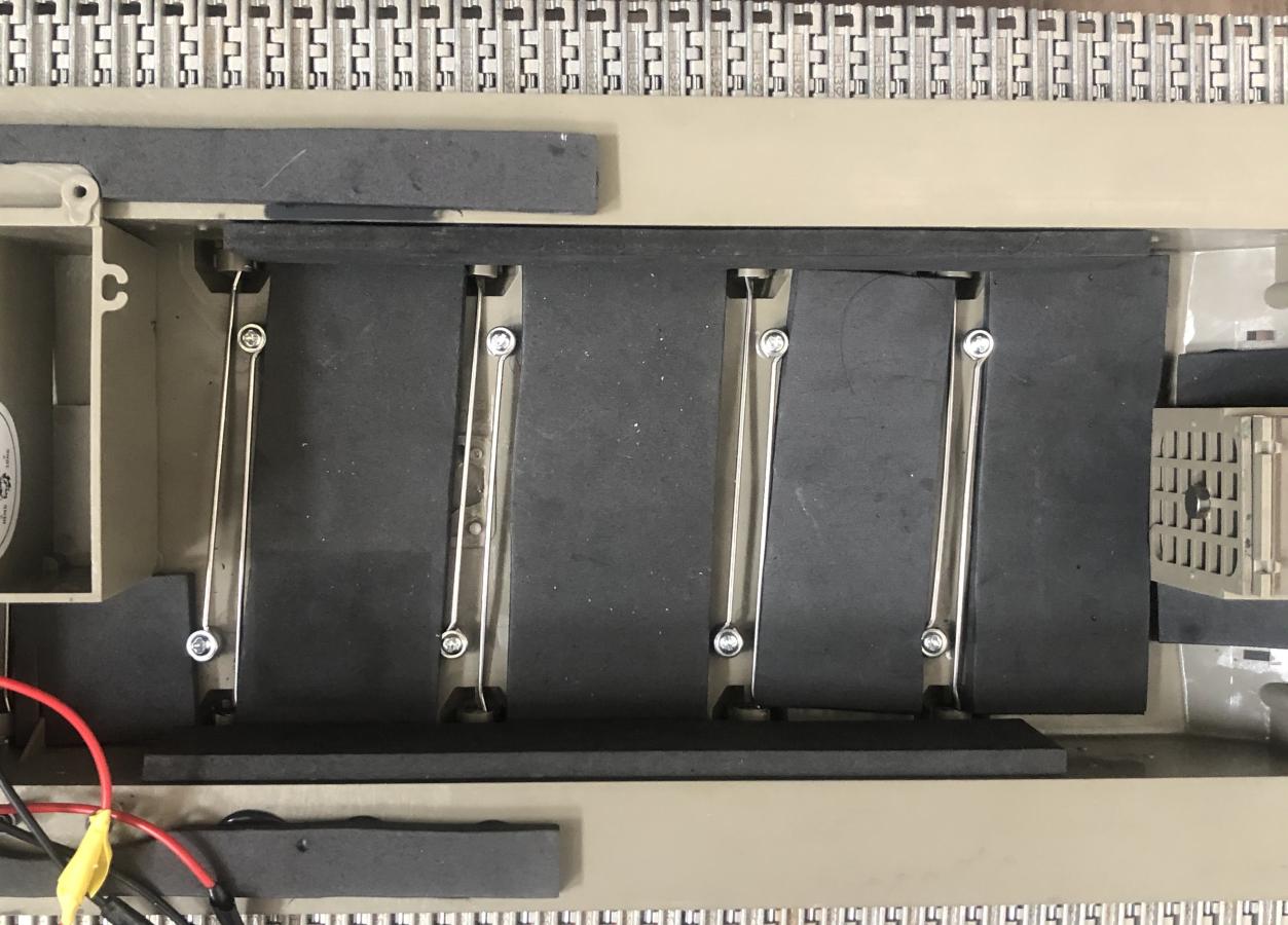

    PART 4 : Lower hull modification.

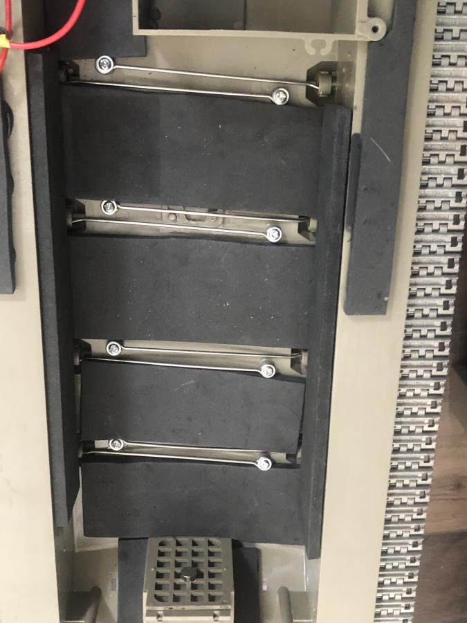

    Well here there is not much to say. I wanted a flat surface to mount the larger battery and MFU to but the floor of the lower hull has torsion bars which mean I had to add a platform / material to raise the floor even with the tops of the torsion bars.
    For this I used sound dampening foam which just happened to be the correct thickness to make a level floor even with the torsion bars. Kinda killing two birds with on stone approach. Now I have the level surface for the battery and MFU plus the added benefit of some sound/vibration dampening. While I was at it and since I had a little foam left I through some one the inner hull sides. Doesn't hurt the tank and will help with a measure of sound vibration reduction.
    Just to be clear adding sound foam is something I do not do with all my tanks and only sparingly to those that I do. I went a little "Mad Hatter" with Merkava because it is a very noisy tank.
    Click image for larger version  Name:	34FDEB3A-0486-43A3-B1F0-49916BDA85E5.jpg Views:	0 Size:	129.0 KB ID:	384408
