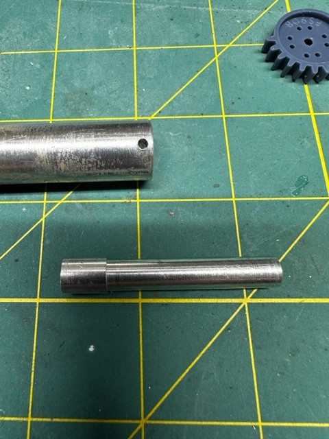

    Rich, I tried that and here is what I found (forgive me, I am not mechanically inclined).
    Both ends of the BB tube are different sides. The end that is inside the airsoft gun is 8.4mm (OD) and the end that slides in the tank barrel is 7.3mm (OD). The BB tube fits into the barrel with .6mm slop. The barrel is moved by a metal bracket that connects the barrel to a slide on the airsoft mechanism. There is not real "connection" between the BB metal tube and the barrel.
    The barrel ID is 7.9mm
    The ID of the recoil unit carriage is 8.4mm.
    Only one end of the BB tube can slide in the tank barrel with approximately 6mm slop. The other end of the BB tube cannot fit into the barrel opening.
    Both ends of the BB tube slide freely in the recoil carriage. I really don't see how this setup will work since it appears to depend on a compression fit between the barrel and tube & tube and recoil unit.
    Here is a pic of the BB tube.

    I have installed four of the Mod 1B recoils into Merkavas and at least a dozen into other HL and TD tanks without any issues. All of them work great.
    For the Merkava all you need to do is re-install the stock HL extension tube into the stock HL barrel as it came out of the tank. The extension should have been attached to the stock barrel with a set screw. The fact that the two HL parts are loose it not the fault of the Mod 1B recoil unit.
    The HL extension tube used on the Merkava is loose in the Mod 1B recoil unit because the tube is designed to be held in place with a tight fitting rubber "O ring" seal in the stock HL BB unit. The extension is slightly smaller in diameter then the usual "machined in" extension normally present on HL barrels. A such you will need to "mimic" the "O ring" by simply adding a thin tape (such as electrical tape) around the part of the extension that goes into the recoil.
    Don't try to overthink the installation and make it harder on yourself. It really is as simple as I just said.

    Mike, you use the bb tube that is stuck inside the airsoft gun. It is held in by an O ring and feels tight but just give it a yank and it will pull free. Then you attach that back to the breech of the main gun and stick the tube into the recoil shuttle.

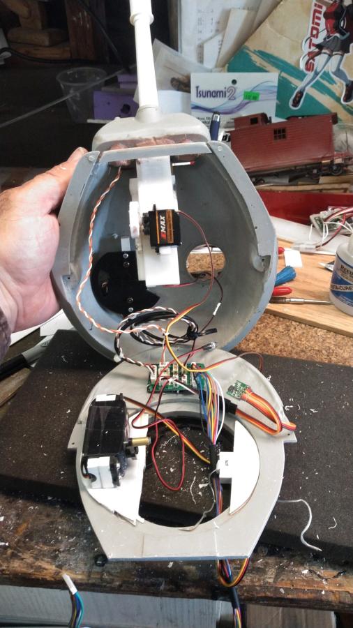

    PART 3: Turret mechanical rework has begun.
    Since I am upgrading the Merkava to a 7.1 system I decided to ad in a servo recoil system. I am using a JVM3Dconcepts servo recoil system (available through RichJohnson who can be reached via a PM on this site) but will be maintaining the HL stock elevation system for now.

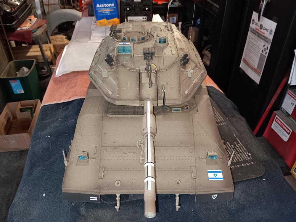

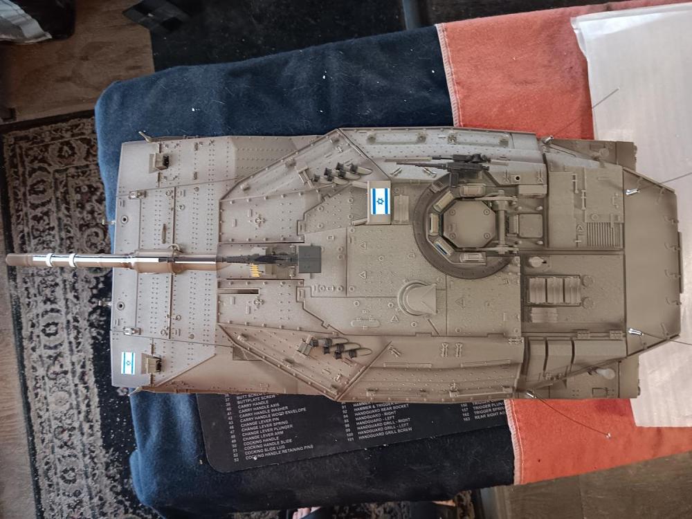

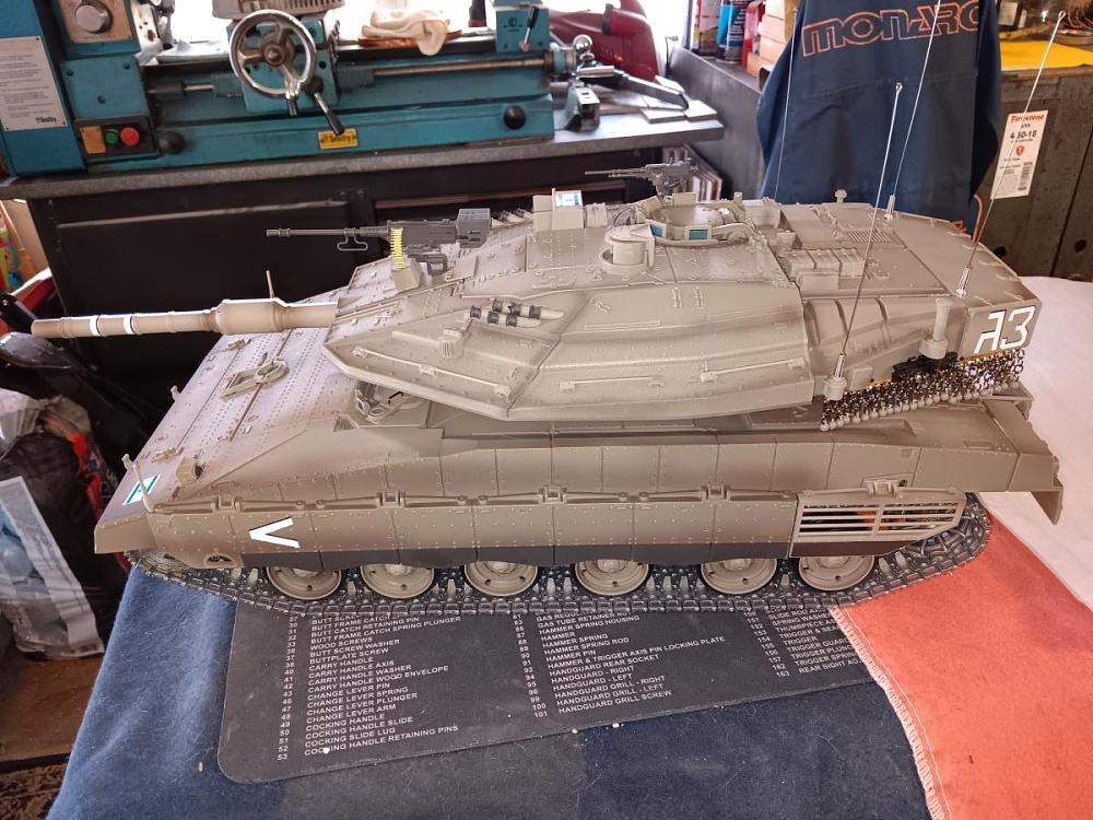

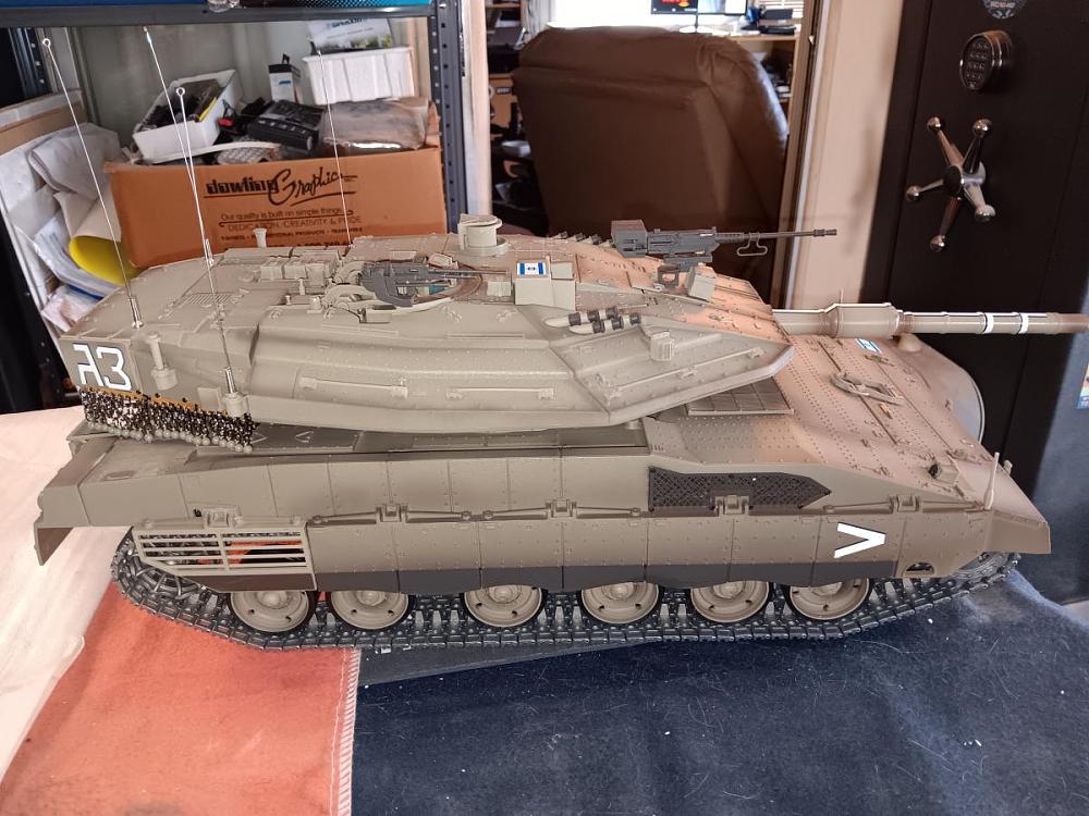

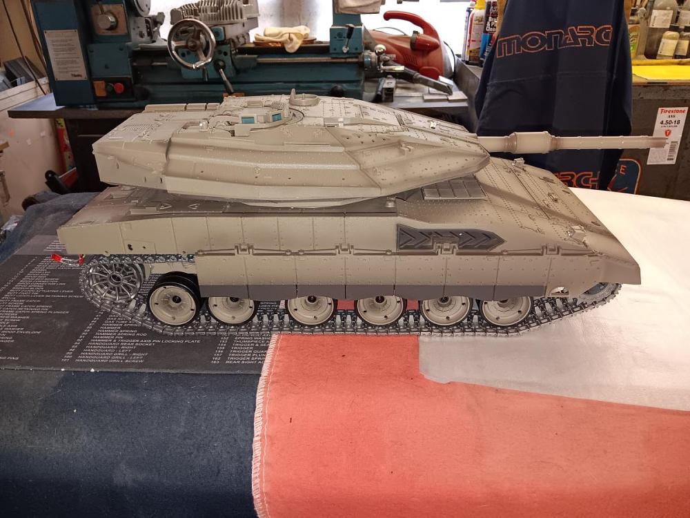

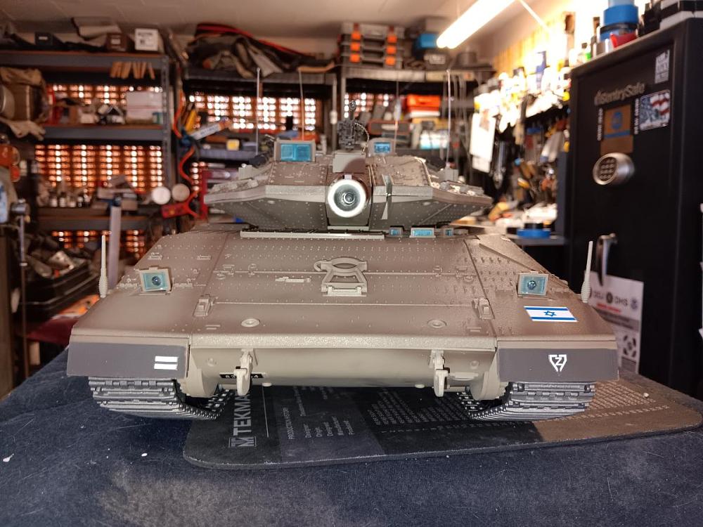

    Okay, I've got it done to the point where it's ready to put in the field. There was one appendant part missing and I also want to install the optional machine gun w/flash in place of the non-functional machine gun above the barrel. Contacted Toucan about the missing part and getting the flashing machine gun. They replied back very quickly and those parts are on the way to me. Great customer service from Toucan!
    ​​​​​​ Click image for larger version
ID:	392091 Click image for larger version
ID:	392092 Click image for larger version
ID:	392093 Click image for larger version
ID:	392094 Click image for larger version
ID:	392095 Click image for larger version

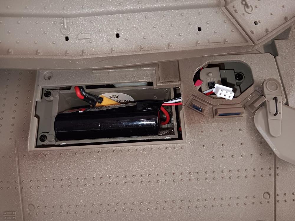

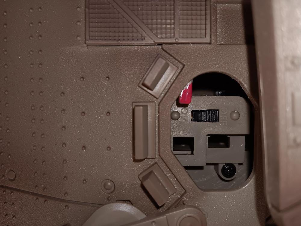

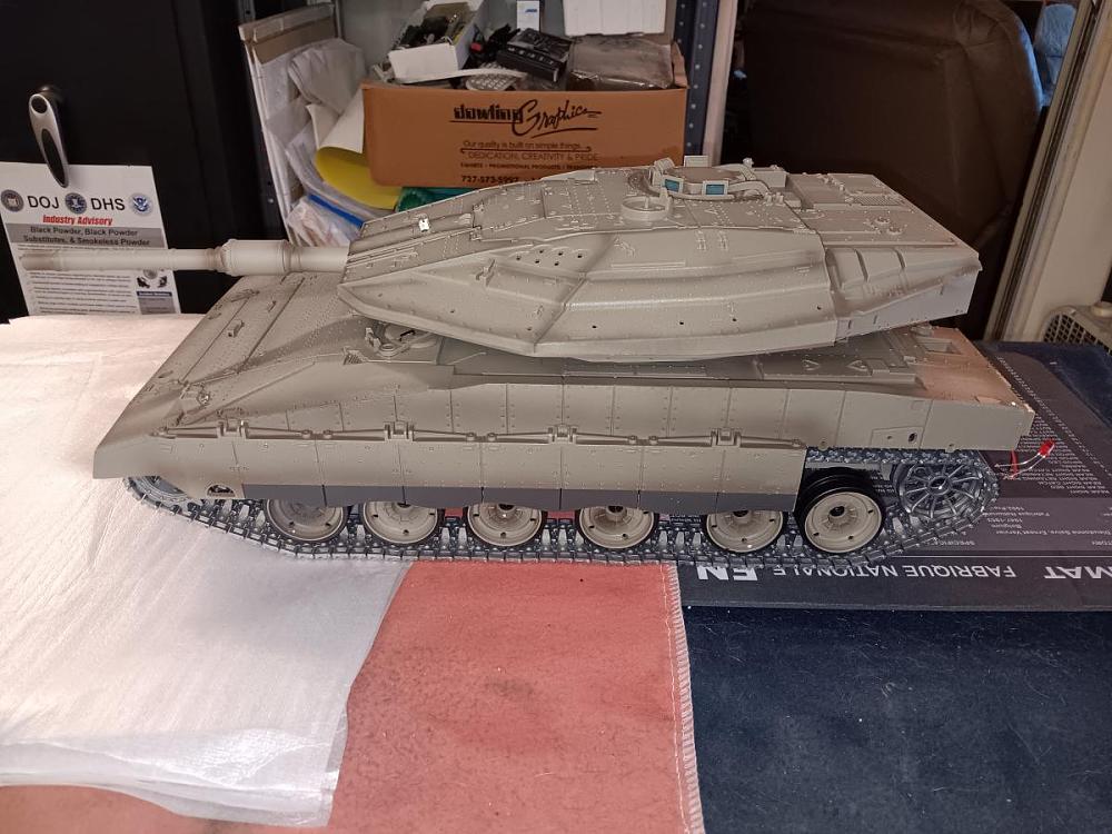

    It arrived yesterday and I unboxed it this morning. WOW!, This has the largest turret I've seen in all the HL 1/16 RC tanks. Be aware that the instructions don't show the little latch you need to move to remove the battery hatch (In photo painted red). The turret motor/gear assembly is the smoothest of all the HL tanks. It doesn't make a bunch of clicking noises like the other do by the gear skipping on the turret gear ring. Which is nice because the turret needs to be moved to a 90 degree location to access both the power switch under the driver's hatch and to remove the battery cover. Will start today to install the add-on parts.
ID:	392024 Click image for larger version
ID:	392025 Click image for larger version
ID:	392026 Click image for larger version

    As I said it’s quite easy to install your own servo on my recoil unit without buying one that uses the cog gears to elevate.
    I usually do the servo elevation conversion with a larger hitec servo so it has more power for elevating and supporting the barrel against bouncing while driving, though my newer 3d barrels are much lighter than the turned aluminum ones I first marketed and the early resin mould cast ones I made.
    I put a screw with a flat head and a small tube around it as support and screw it to the last post on the servo arm and then eyeball the placing of the servo in the turret so the servo arm gives the maximum amount of movement of the barrel with the screw post in th track on the side of the elevation unit.
    I have also added a tiny 2mm ball bearing on the end of the arm in the channel ( I supply those tiny ball bearings in my Sherman hvss kit for the return rollers)
    Diong this I can create maximum elevation and depression which is optimum for IR battling a tank.​
    You can see this kind of install in my Tamiya leopard 1 with an older Clark recoil unit below.
