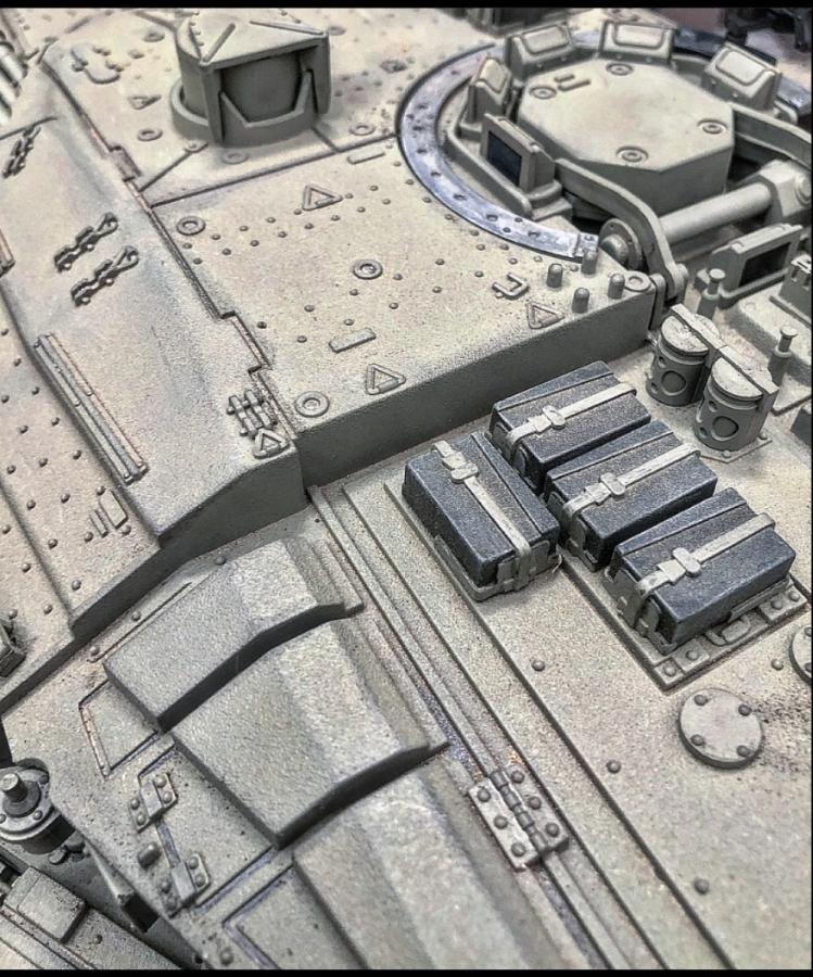

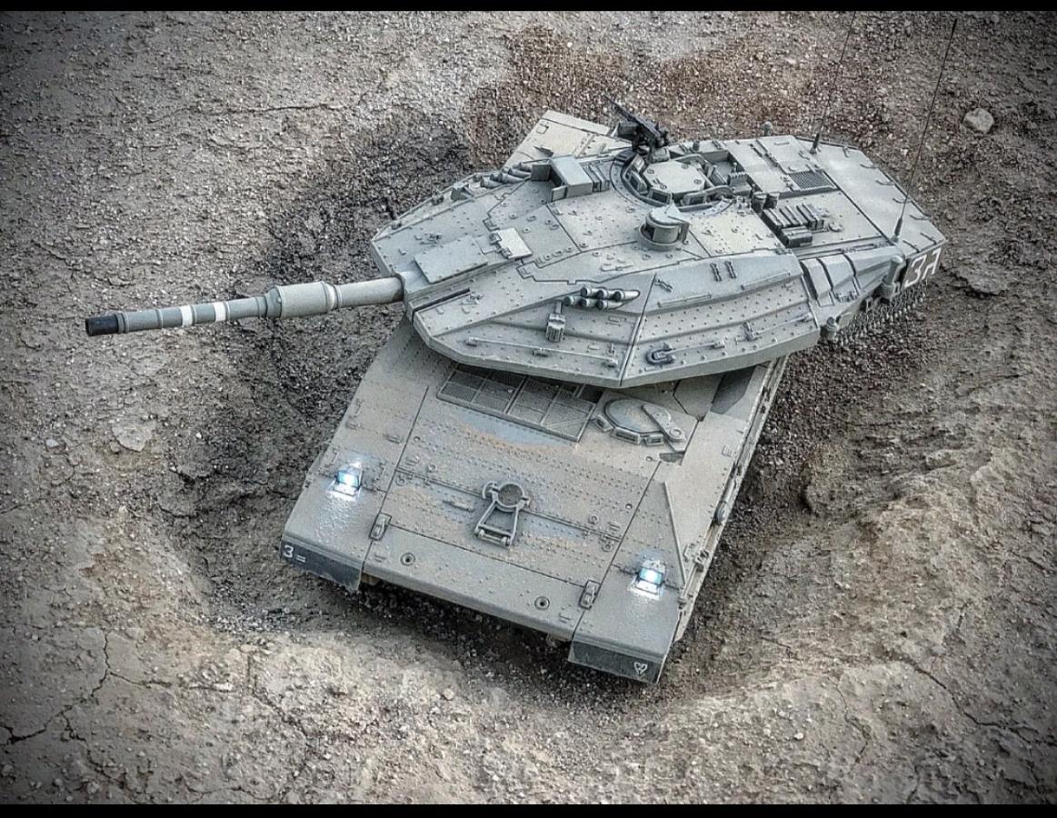

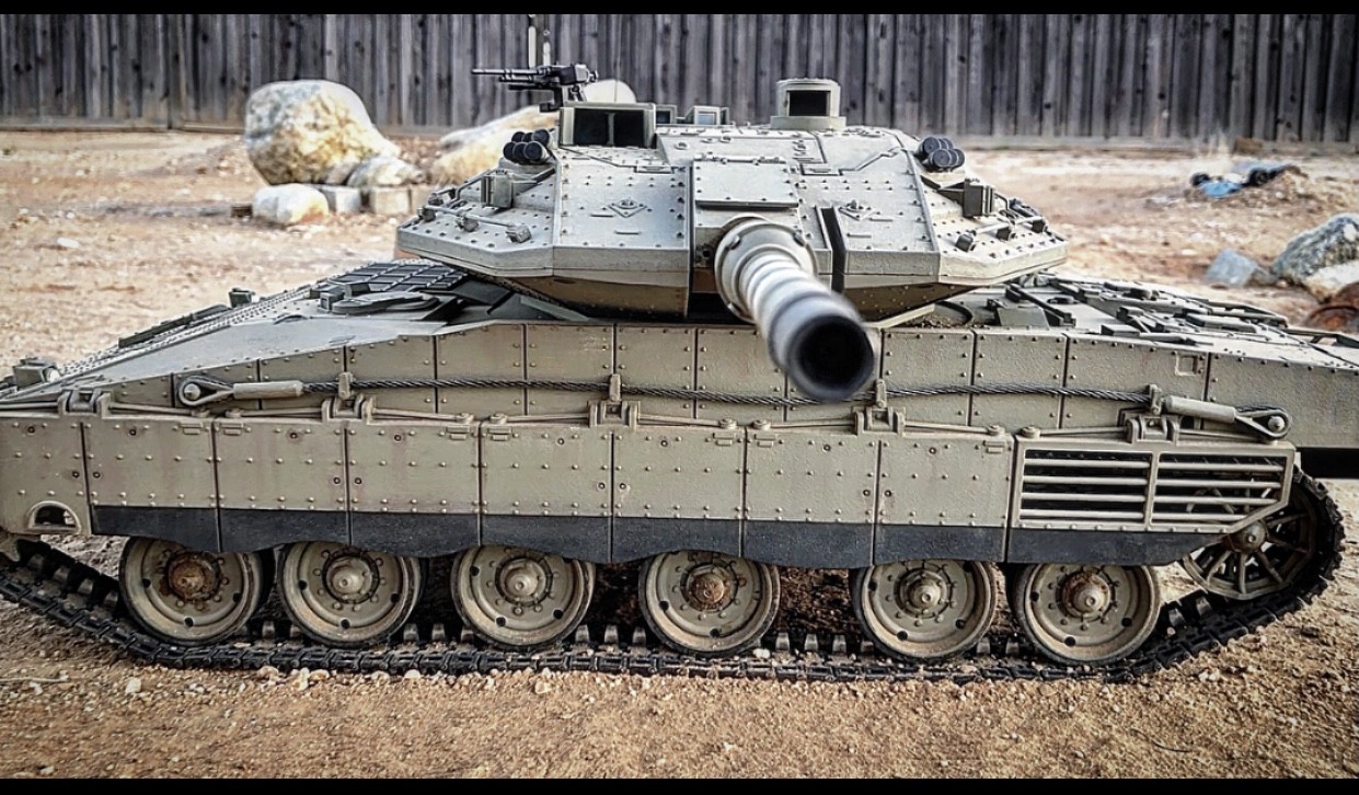

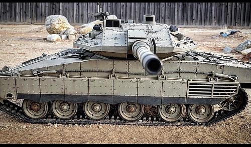

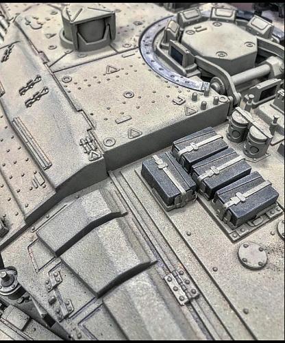

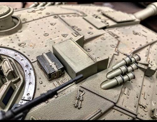

    A little update on the Heng Long Merkava. Mechanically the tank has been running flawlessly. It has about 40 hrs of run time on it which includes three official RC tank club battle days.
    The overall look of the tank is improving as natural weathering and heavy dust have started building up on the tank giving it a used field look.
    Here are a few of the latest photos showing the current state of natural weathering.

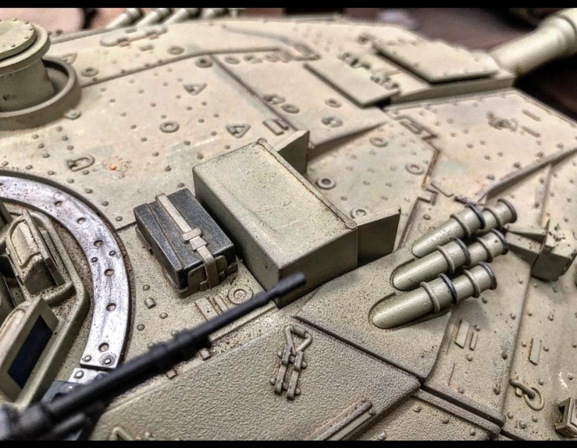

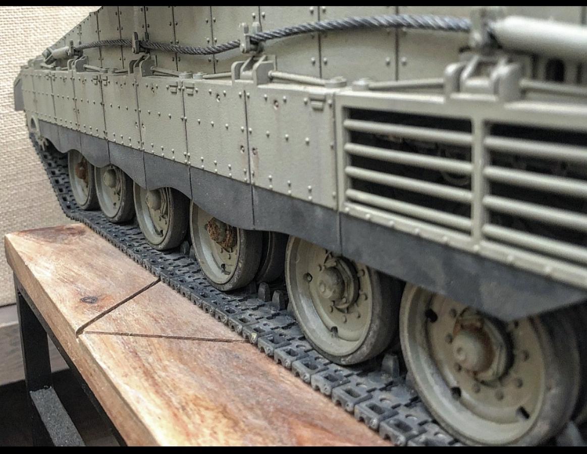

ID:	389162^^^^^ Heavy dust build up. It really adds to the field used look. The textured turret and hull really like to hold onto the dust. vvvvv
ID:	389161 Click image for larger version
ID:	389160 Click image for larger version

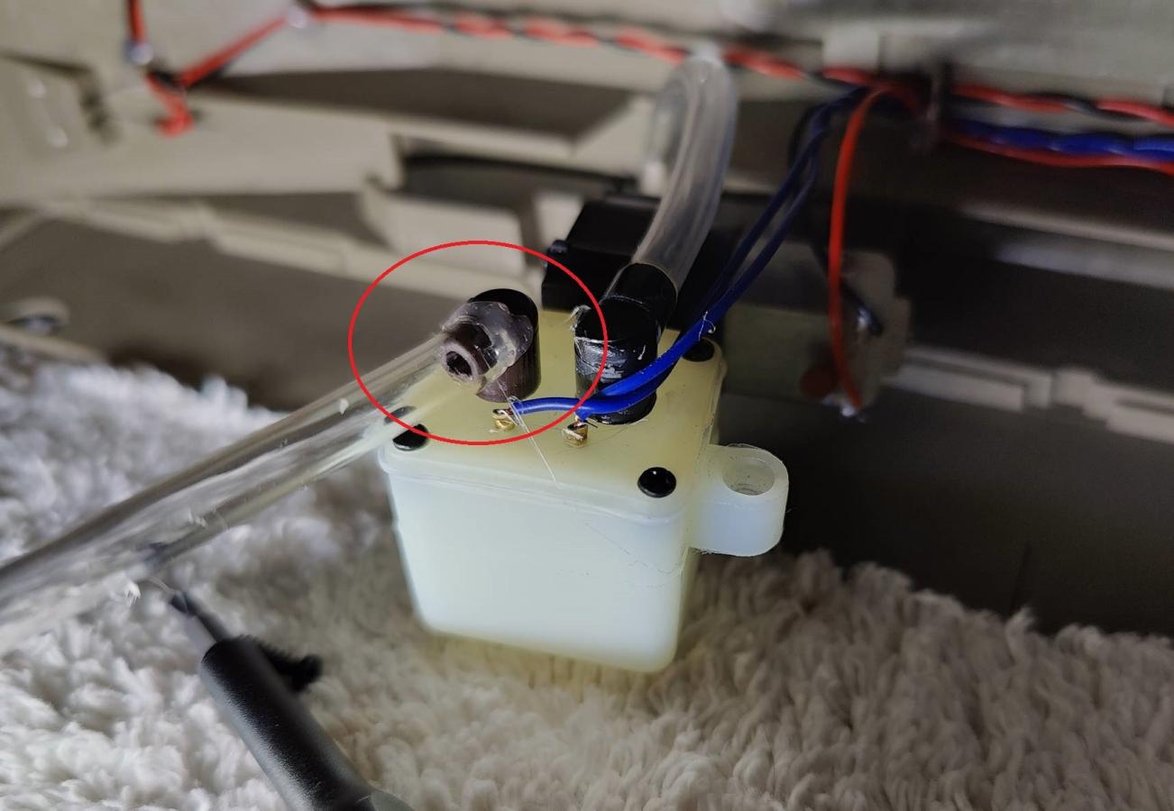

  • sclui56
    I mentioned the smoke oil input is limited to dropping through the right exhaust screen from the factory. One can also run a secondary tube to a "blocked" vent on top of the smoker heating unit (this one is blocked at the factory using hot glue). This added tube can be routed to either the ON/OFF
    switch hatch or battery hatch with a plug to use as a filler tube. Just need to find an extra 90-degree elbow + a plug.

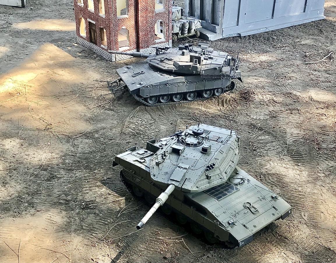

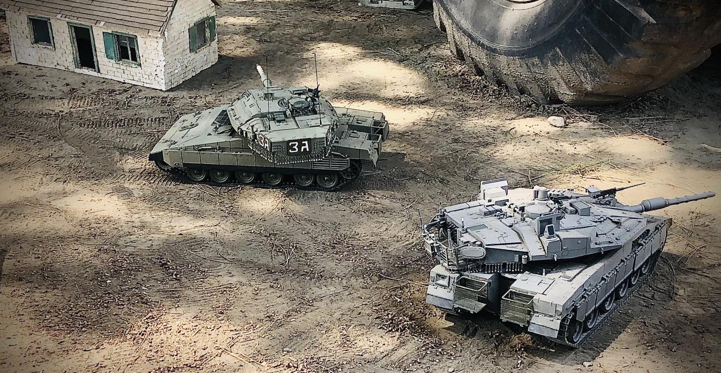

    Took the Merkava to its first official club battle day. I suspected it would do well as all my prebattle testing had good results. But it actually exceeded my expectations for a large modern tank. Usually on the small LA Tank Clubs field big tanks are at a huge disadvantage. Not so with the Merkava. It's short barrel overhang, fast turret and front drive really made it perform more like a medium sized tank like a T72 or M26.
    Here are a few photo of it during a "team up" with a Hooben Merkava.
