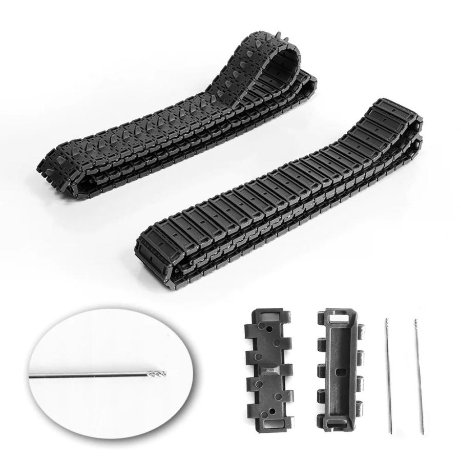

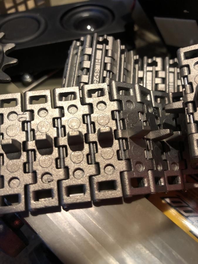

    I test fit the henglong track on my hooben sprocket. It fit onto the sprocket in hand tightly. I suspect the hooben would fit the henglong sprocket but I make no guarantee if if will we’ll enough to be used.
    Now, I suggest that you just buy henglong metal track, blacken it and be dine with it. Us scale models have had to live with non scale looking track since this hobby started. Like taigen Sherman’s that are supposed to have rubber chevron track pads. Tiagen makes them metal and no amount of painting will keep them black. It’s just something you have to live with.
    @RichJohnson​, thank you for the very helpful information. Based on what you said, I will get a Hooben nylon track for the Merkava. If the Hooben track runs well with the HL Merkava, it will be a big bonus for me. If not, I will revert back to the HL plastic track for running the tank.
    The Hooben nylon track looks very good in picture. It may just need a little dust to look realistic.

    I continue to search for a better track. I fully understand that the Heng Long open pin design runs fine with the tank. But I don't like the open pin look on my display bench. It comes from the bias of a plastic modeler.

    I found the Hooben nylon track for the Merkava. Everything looks good on paper. It is only $85, less than the Tamiya track for the Leopard. The big question is whether it is compatible with the Heng Long sprocket and wheels? While the look is important, I want the track to run well on the HL Merkava too.
