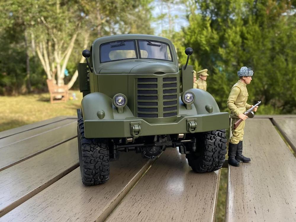

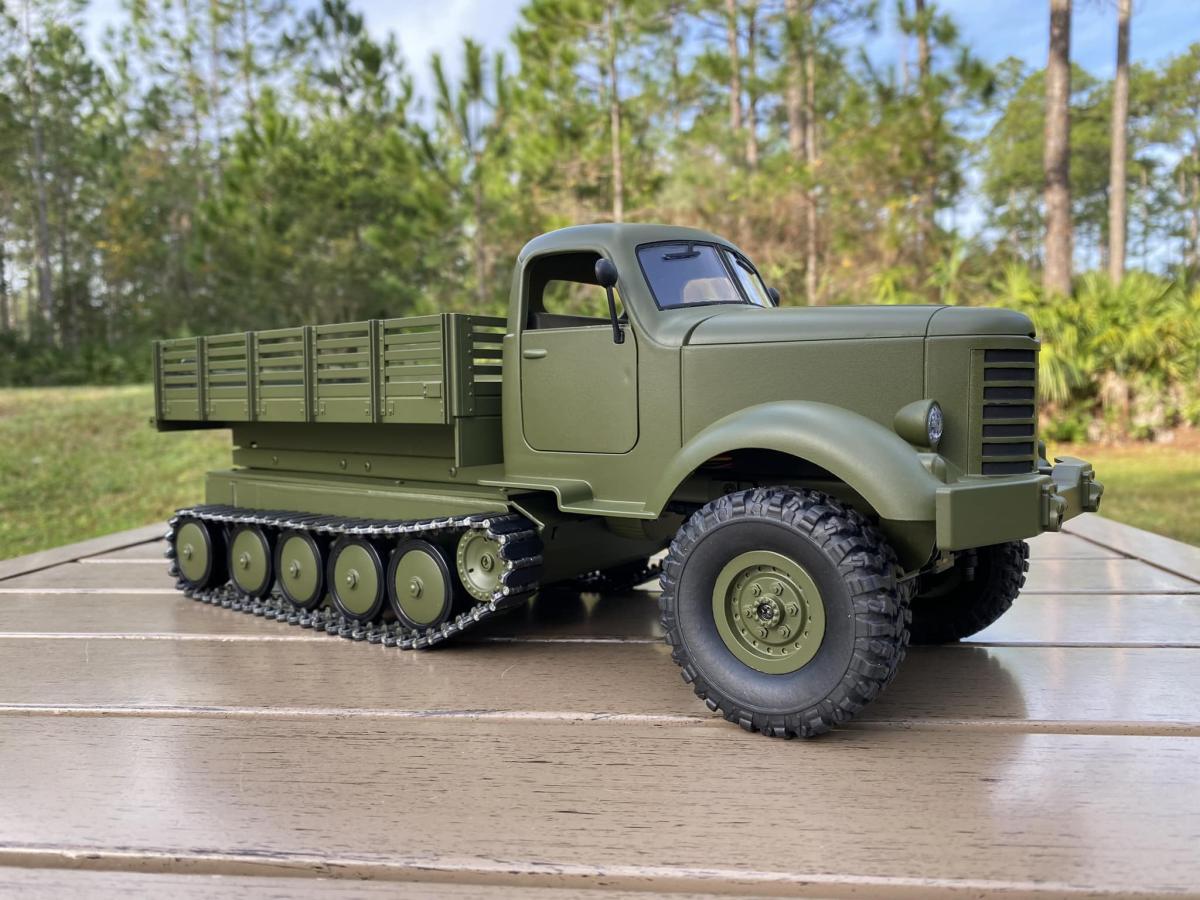

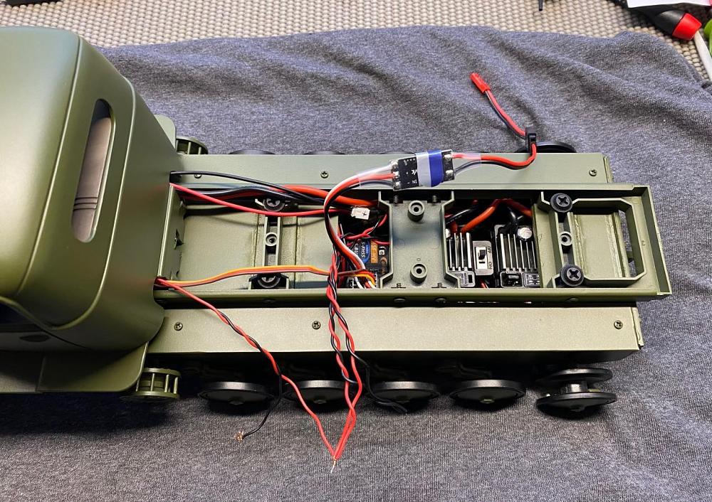

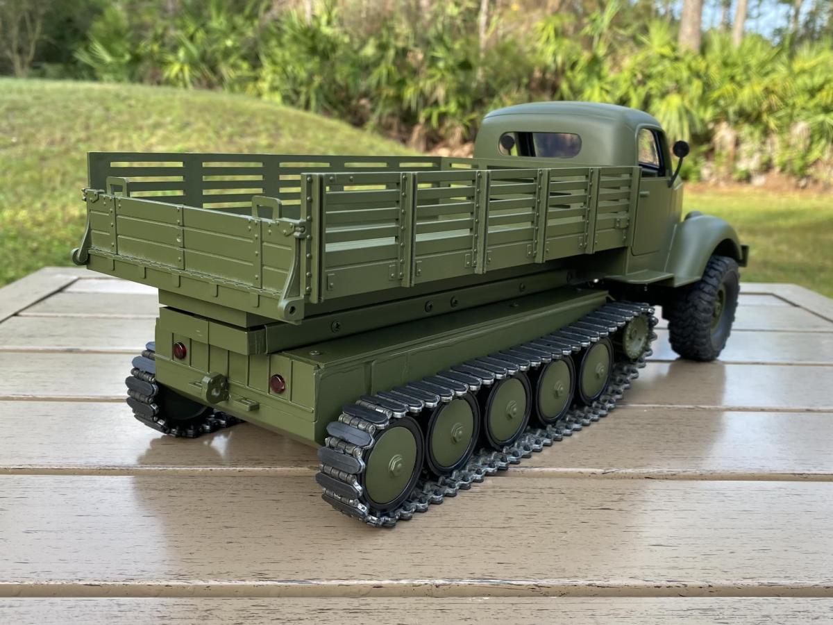

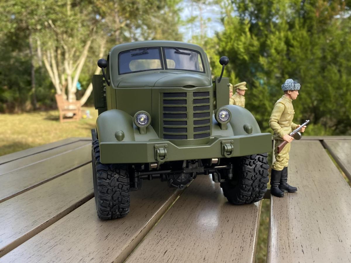

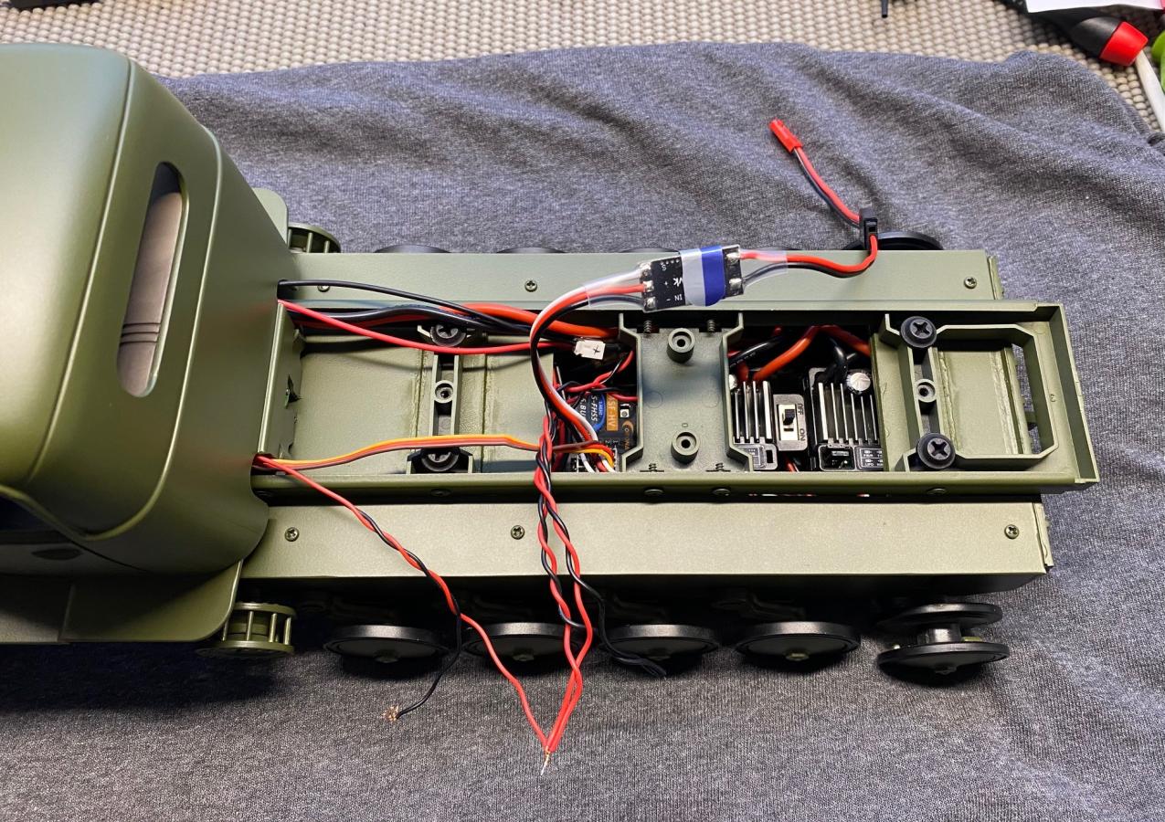

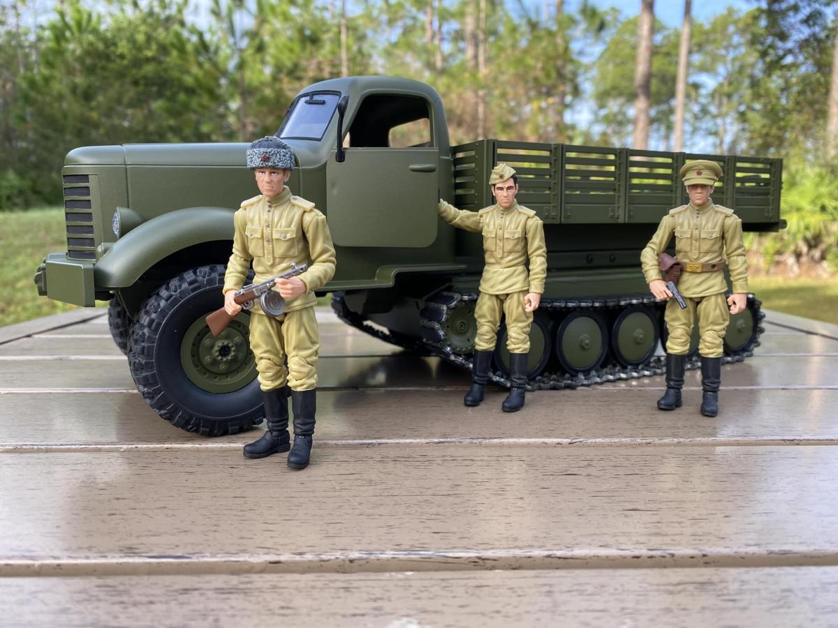

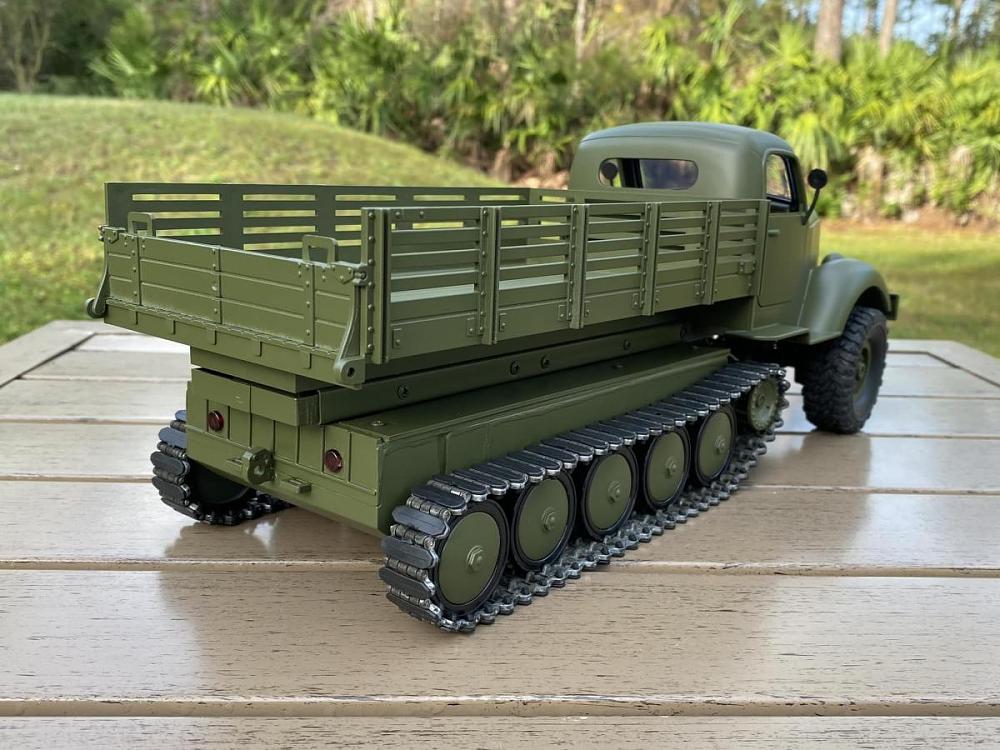

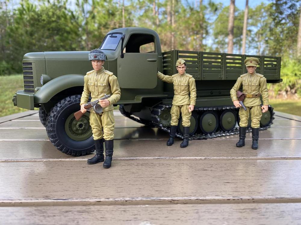

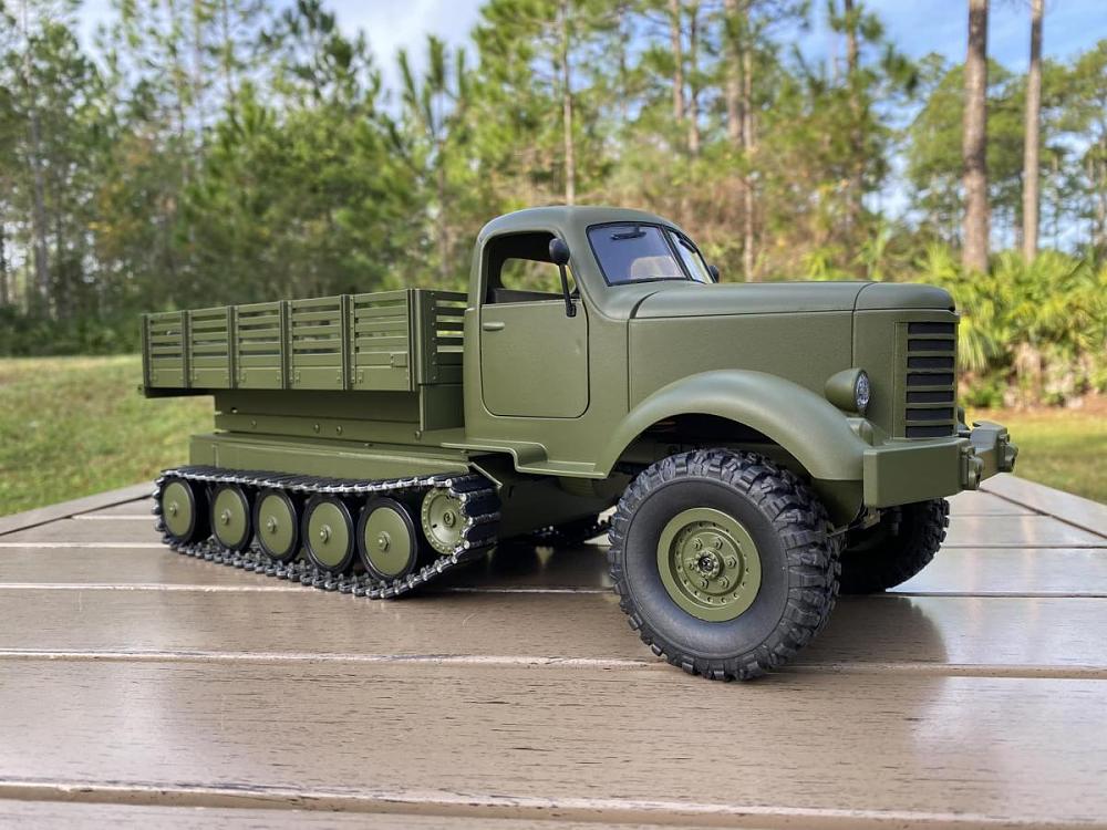

              Custom Russian Half Track I finished up recently. Going to add a few decals, that's about it. I built it using a JJRC Q60 truck for the frame, cab, front drive axle and transmission and a WPL E1 tracked vehicle for the traced portion. I shortened the E1 by about 1-1/4", used WPL metal track set (shortened), dual hobbywing 1060 esc's mixed with my Futaba 4PM radio, steering converted to servo, tail lights added and did a little dremel work to fit in a 3500 mah battery under the hood (to help put some more weight over the front axle), added a rear window into the cab, etc. A lot of trial and error and scratch building went into this project, but it came out pretty decent and drives well.
              Click image for larger version  Name:	414201051_122117866514098443_2021473805335121803_n.jpg Views:	0 Size:	145.1 KB ID:	395169
              Click image for larger version  Name:	413967804_122117867114098443_6640379731817809970_n.jpg Views:	0 Size:	136.4 KB ID:	395168
              Click image for larger version  Name:	414620283_122117867210098443_782174605039362816_n.jpg Views:	0 Size:	145.9 KB ID:	395167
              Click image for larger version  Name:	414438746_122117867156098443_2569071264053799495_n.jpg Views:	0 Size:	149.2 KB ID:	395170

                #67
                Fantastic job. Just need to weather her up.
                • MrChef
                  • Jan 2023
                  • 510
                  • New York, Not the city
                  #68
                  Yes Excellent work Dan. My wife is sitting next to me and even said it's cool. But, green.

                      #70
                      Do the tracks help the steering? Brilliant work.

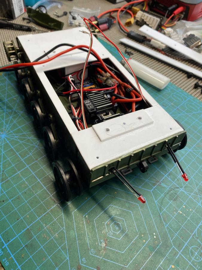

                        #71
                        Thank You. The steering is all done via the front axle, with the front axle being driven and using dual ESC's I can mix the ratio's between the track drive and front axle drive to adjust for the difference in final drive ratios. By doing this, I have the front axle set slightly faster, like overdrive in a rock crawler, this helps it to steer much better. Also which helps is that the JJRC front axle has a differential instead of being locked, this also aids in steering. Although there are MFU's, like Clark that have a half track mode, there was no way to account for the different final drive ratios between the front and rea, so dual ESC mixing was really the best way to get this done. Actually was a lot cheaper than buying aftermarket MFU as well. I have about $200 total into this entire project.

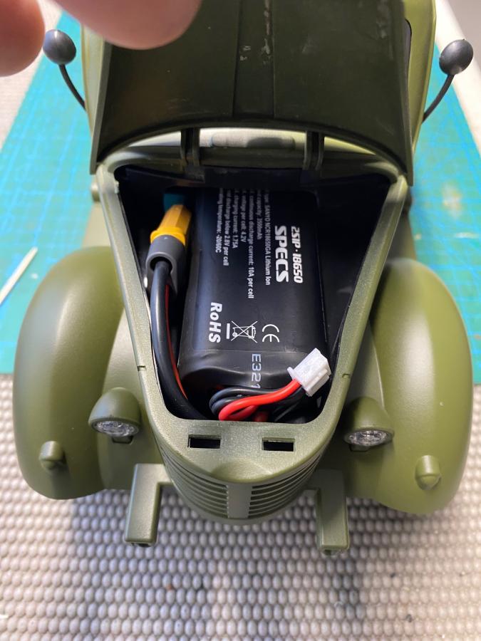

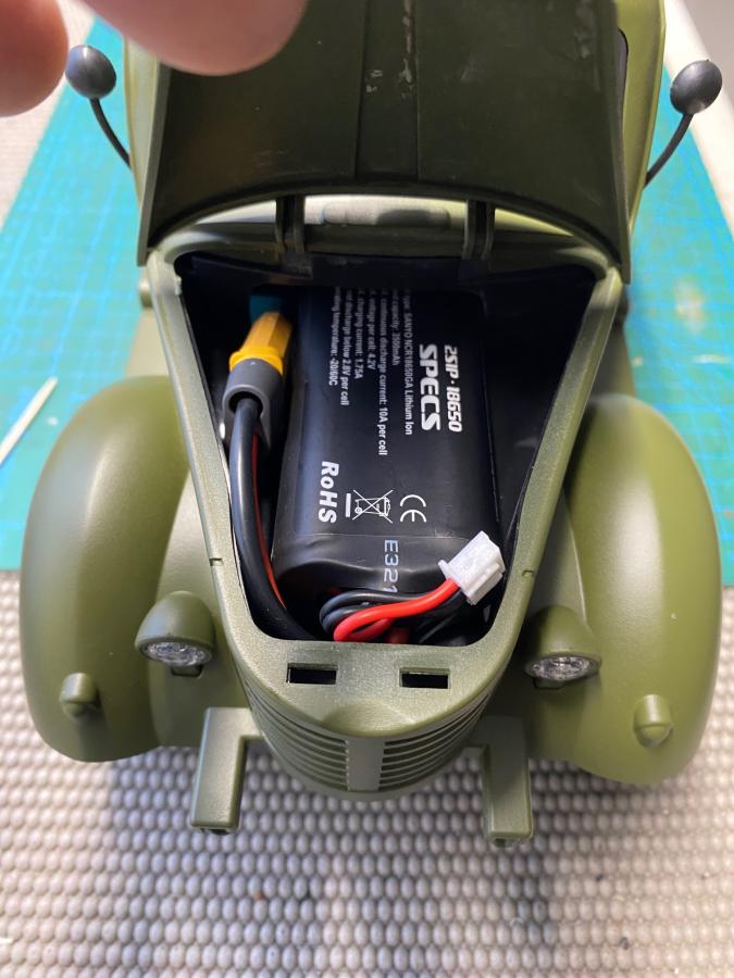

                          #72
                          Can you provide the parts list for the ESC you purchased? Sorry if it is an inconvenience. I like what you did very much

                            #73
                            Thank you for the reply.
                            If I read this right, you have an esc for the front axel and motor? And an esc for the rear motor drive? Like an electric differential between the two. I presume that both rear tracks drive at the same speed, and you cannot use them, like a tank to assist in the steering? Hence, why you said about half track boards.

                              #74
                              Correct, one HW ESC controls the front motor / transmission to power the front axle, the second HW ESC powers the 2 track motors in parallel. The tracks don't assist in steering. Technically a halftrack doesn't quite work the way a tank does, they use a differential to drive the tracks and then use a brake to slow one down to assist in steering (US half tracks anyways). I wanted to try and use a spare truck differential to drive the tracks, but there just wasn't enough room and still have the proportions decent.

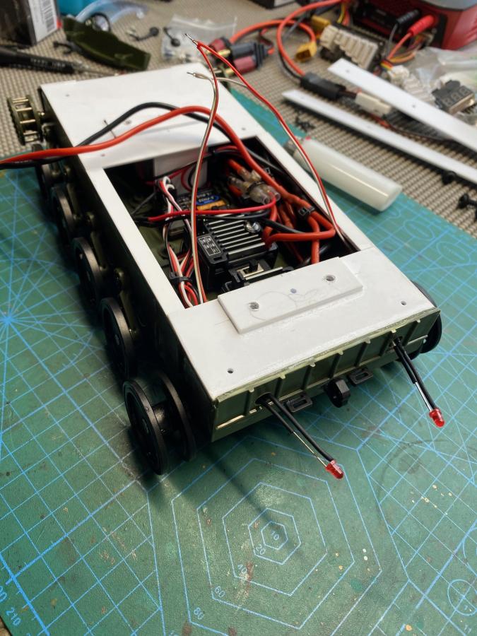

                                #75
                                I used (2) Hobbywing Quicrun 1060 ESC's, can get them on Amazon for about $22 each. I had one on hand, so just needed to pick up a second one to do this project. Tried to keep this very budget friendly. Also running one of the Amazon aux lighting control switch to turn the ights on and off via a spare channel on the transmitter.

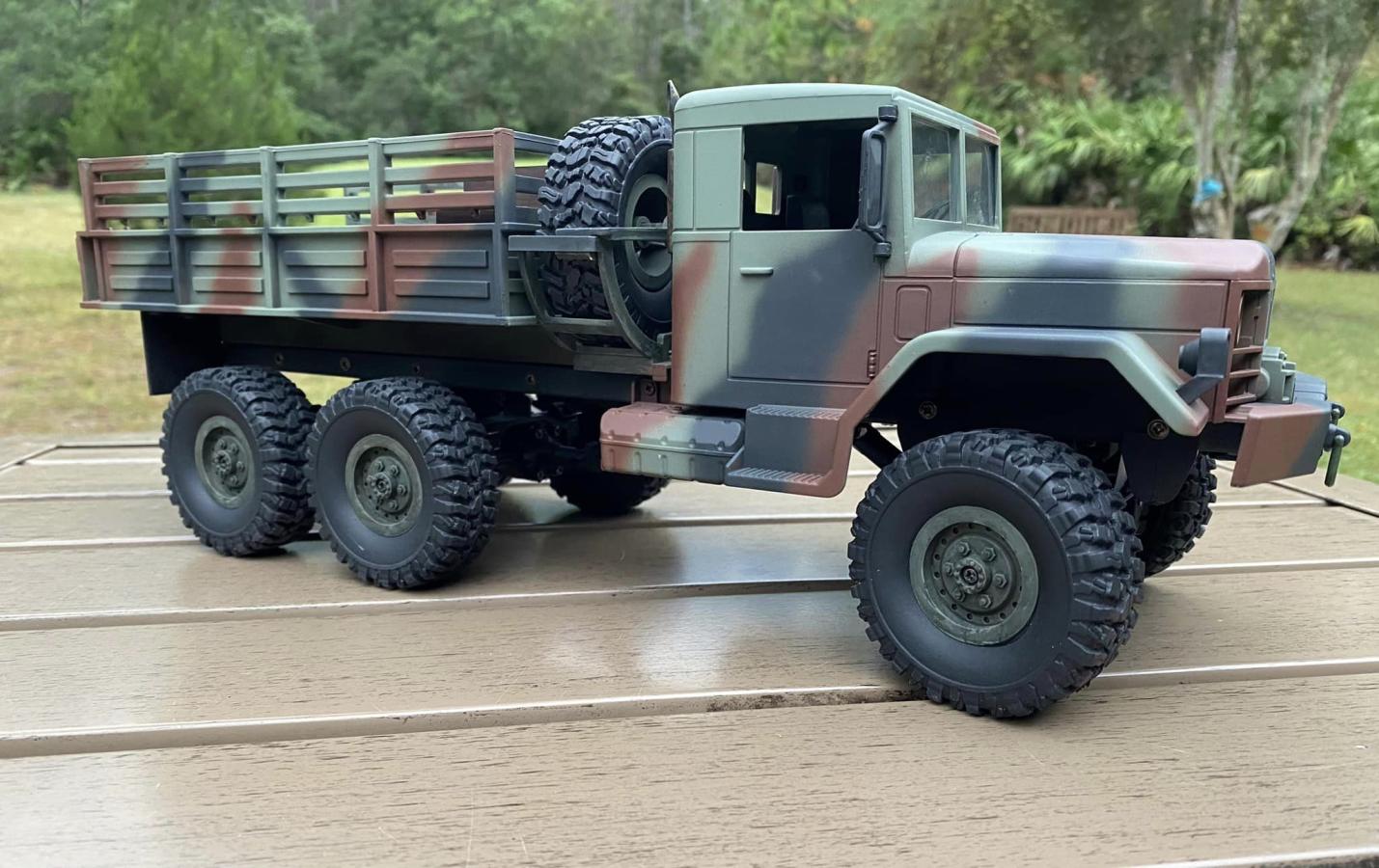

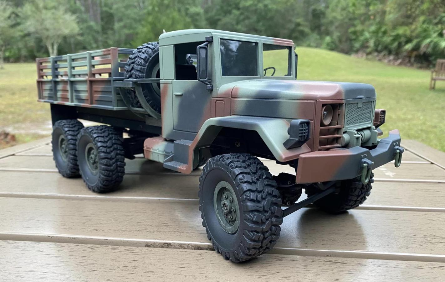

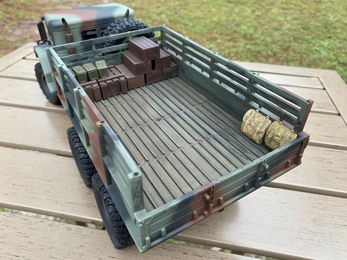

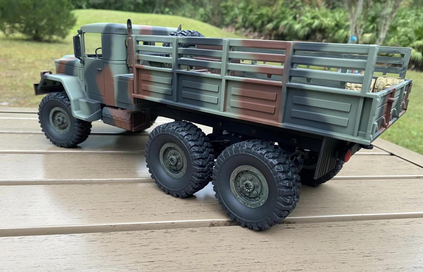

                                        A few better pics of the 6x6. I've done a little detail painting, some weathering, flat clear, the lexan windshield pieces and some cargo. Calling it done for the most part, should compliment the M60A3 nicely. Might add some dust effects pigment, here and there, that's about it.
                                        Click image for larger version Name:	400484657_373518568664689_3654283407322643881_n.jpg Views:	0 Size:	156.7 KB ID:	390579
                                        Click image for larger version Name:	401497673_373518608664685_239143516690606341_n.jpg Views:	0 Size:	173.7 KB ID:	390581
                                        Click image for larger version Name:	400604302_373518635331349_286536394084260783_n.jpg Views:	0 Size:	144.0 KB ID:	390580
                                        Click image for larger version Name:	401655384_373518618664684_6734997338718860551_n.jpg Views:	0 Size:	173.1 KB ID:	390578
                                        Click image for larger version Name:	400774665_373518581998021_1562953619101171726_n.jpg Views:	0 Size:	162.4 KB ID:	390582
                                        Great job on that M35 6x6. Turns out this is a timely bump to this thread. I'm currently working on an upgrade to my M35 to make it look more like the actual one. Maybe I will start a thread in the RC truck section.
