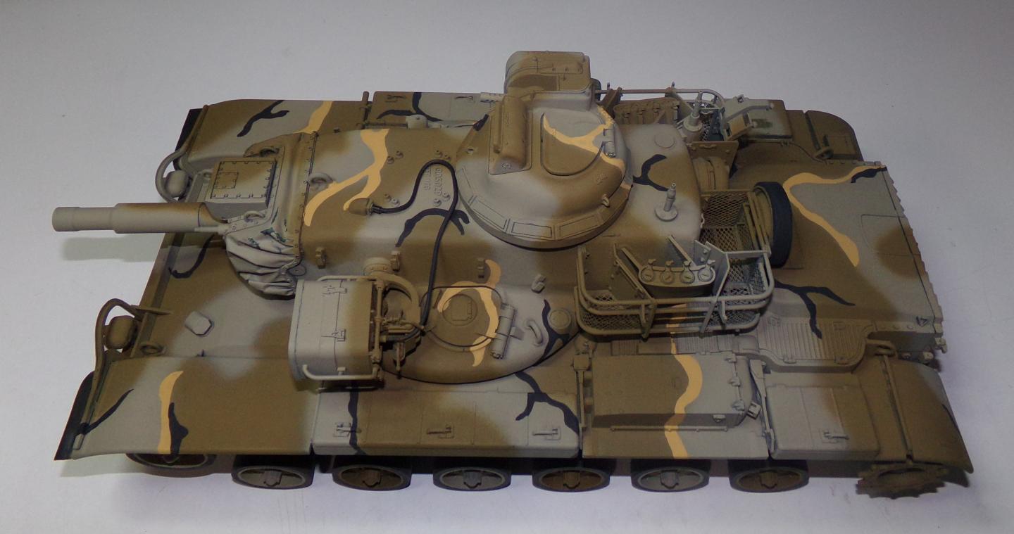

            It is amazing what some detail parts and a paint job can do for a TongDE M60. I initially passed on buying one because it was toyish, but then I built this after seeing all the nice TongDE builds:

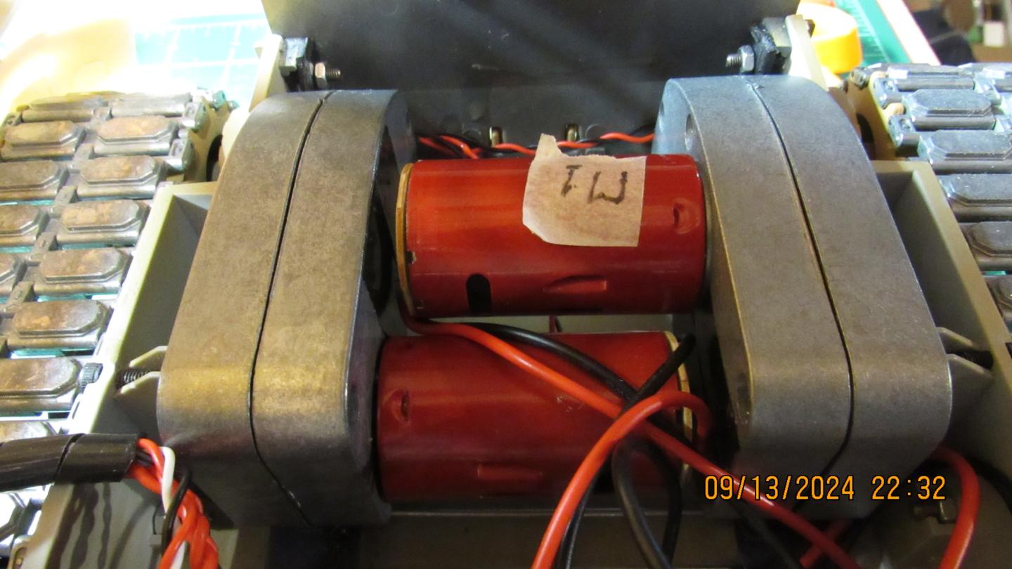

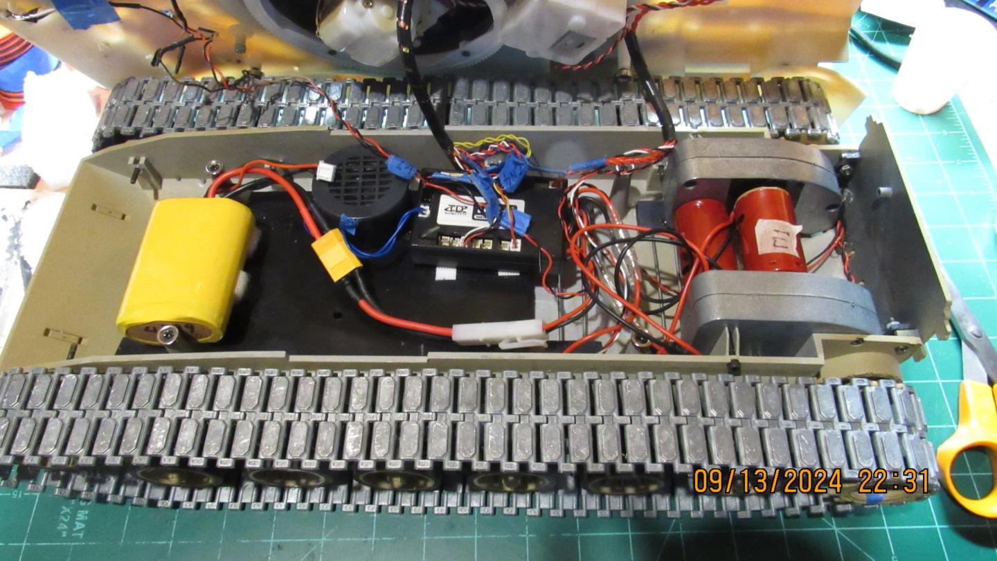

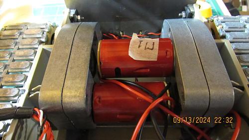

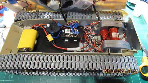

                                  The Tongde metal tracks are the best all round performer for the TD M60 and the only one that can run well on grass lawn. It is heavy but NOT TOO heavy. You just need to pair it with the correct gearbox and drive motor. @Robincon99 had detail description of it in his M60 review.
                                  # Existing stock all sold, we are making the new batch now and targeting back in stock in Nov. You are welcome to place a preorder for reservation. # # NEW # in full metal! No more plastic housing versions! # Same design as the plastic version but now in full metal CNC housing! The plastic housing version has been stopped production due to tooling issues. The newPropulsion dynamics steel gearbox (we called: PDSGB) is Now available for your RC tanks! come with powerful torque and desired speed for your RC tanks! Dimension : Approx W=95, L=110, H=45 (mm), not count the shaft length. Features; 1. Straight running - as moving forward and backward are driving from 1 motor, both sides of the output shaft are rotated synchronously, there will be no speed difference and it will keep the tank running straight, and will not cause by the resistance of different gearbox, and track then made the tank cannot run straight in traditional dual mixing gearbox system. 2. Good steering linearity, it wi...
                                  If you are mechanically handy, you can also do what I did at 1/3 of the cost pairing the 390 motor with the TD metal gearbox.

                                    Your actual upgrade cost is only $15 for the 390 motor since you already have the TD metal gearbox. Toucan Hobby direct website has the lowest price for the pair of 390.

                                      So just keep the metal and buy a pair of RED motors? And the Admiral 7000 mAh will fit inside the hull? This apply to BOTH the M60A3 and M60 ERA Israel? Dai

                                        Yes and yes. I PM you @Robicon99 comment on that.
                                        However, if your pocket allows and you want the ultimate in performance, the PDSGB gearbox from DKLMRC is the way to go.
