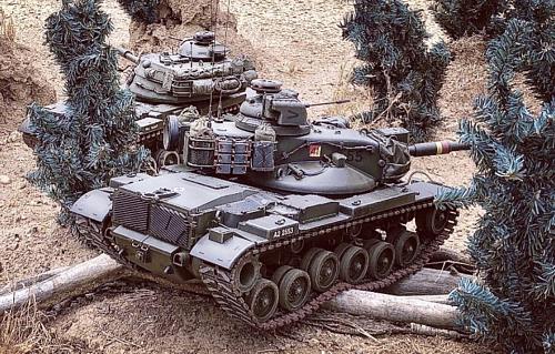

    I have built the DKlM okmo M60a3 7 or more years ago when it was released. It’s a very nice kit but took a while of tweaking to make it run well.
    I have many DKlM kits, and am sort of in the middle of building the A2 starship turret kit for my next m60, although I had to pause the project to work on customer models this summer.
    I will warn you, if you think installing my recoil and scale gun barrel is a job, the A2 turret is a much more involved modeling project. Rubicon has built one amd there are a few glitches in the turret kit, I have taken his feedback and made some modifications to my turret kit as I build it and I provided feedback to DKlM as well just as ways to improve the turret for maintenance and repairs etc as well as assembly.

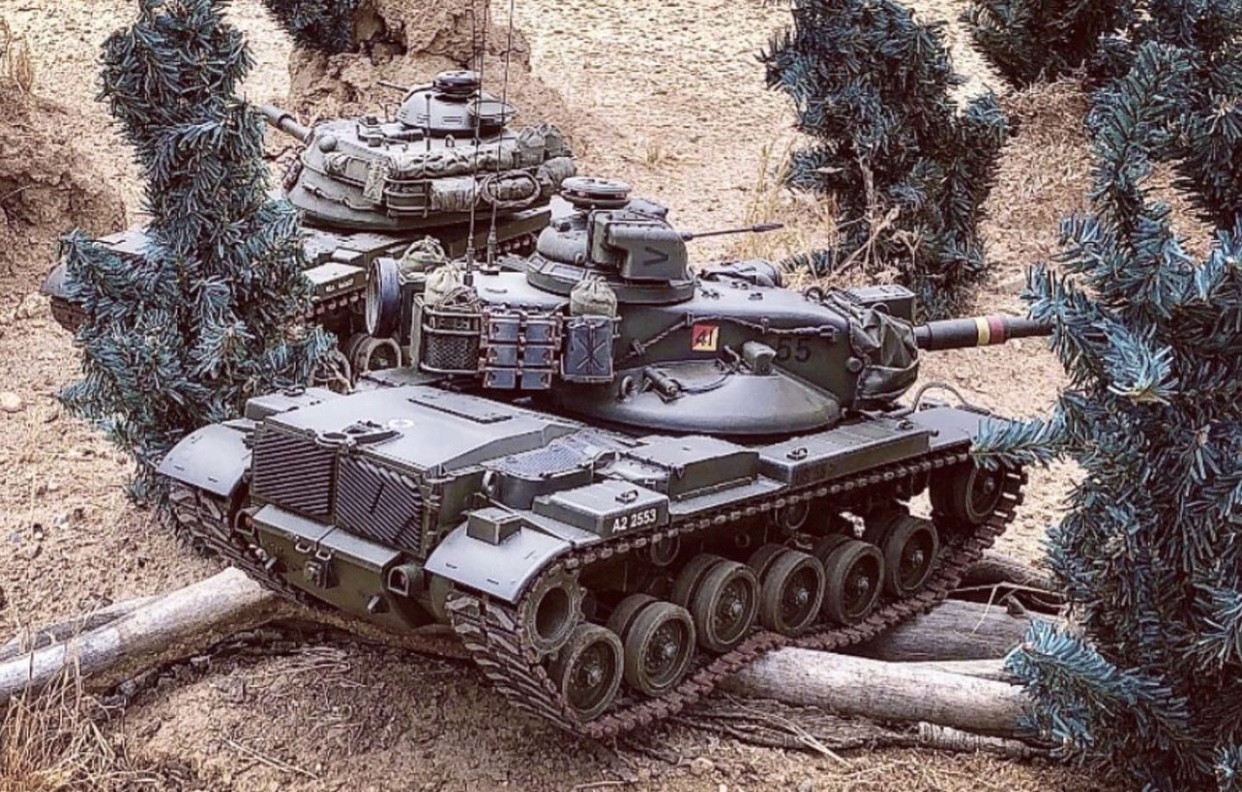

      Originally posted by dai phan
      Ok gang,

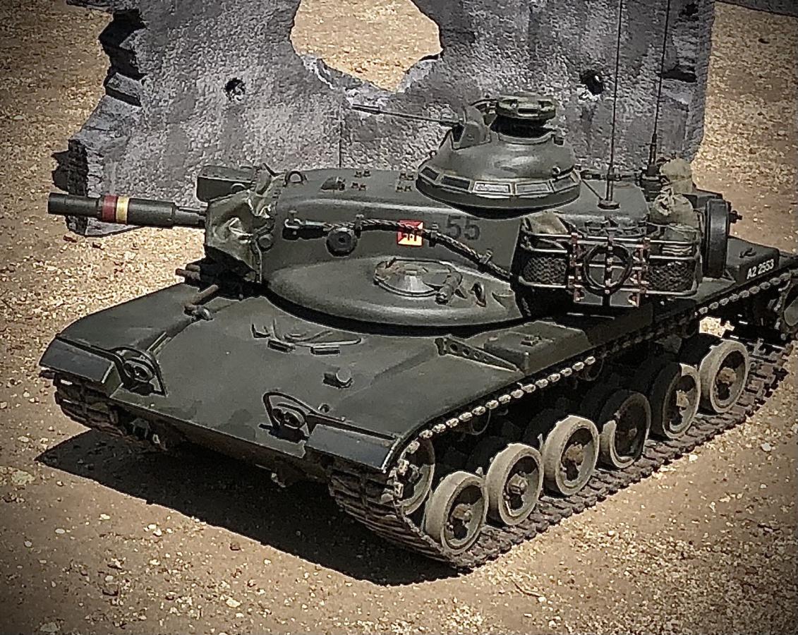

      I need your input here. DLKMRC has the turret kits for the A2 as well as the A3. They look so cool and this will allow me to solve the issue of missing parts as well as upgrading the tank. I emailed DLKMRC and was advised the A2 turret is designed for the Tongde M60A3 chassis. I like the A2 turret kit. I want to confirm with you all before I place the order. I know TD puts out 3 types of M60 chassis (A1, A3 and A3 ERA) so I need to make sure. This order is not cheap. Thanks all. Dai
      Honestly it is absolutely more then you can handle right now if you are having pause installing a simple recoil system. I have the DKLM A2 turret and so does RichJohnson.
      Its a great looking turret but it is very much a hands on build with NO instruction.
      A few photos of mine. Click image for larger version  Name:	IMG_1125.jpg Views:	0 Size:	373.9 KB ID:	411331 Click image for larger version  Name:	IMG_0821.jpg Views:	0 Size:	259.0 KB ID:	411332

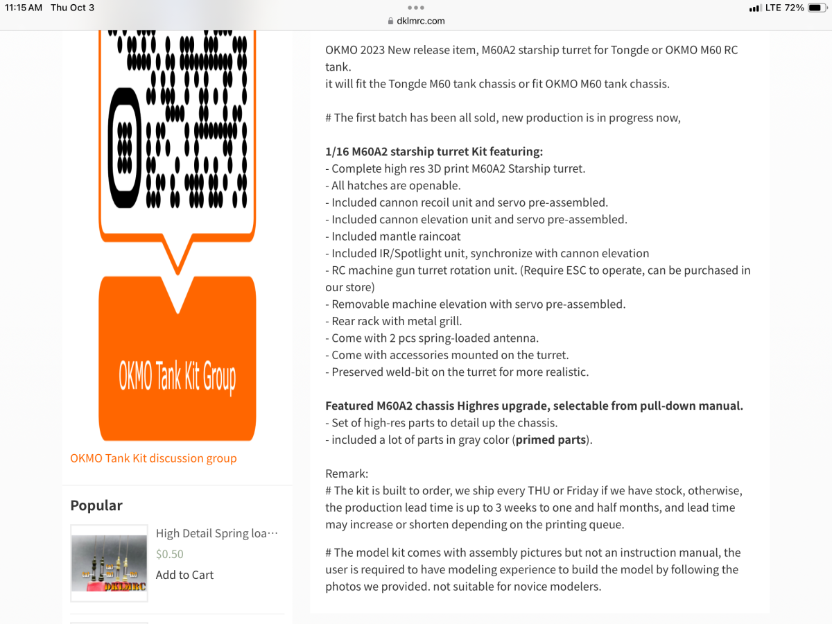

        Hi all,
        I also build and fly scale R/C planes so I have some experience with mechanical stuff. The kit comes with photos so I think that will help me through. Dai

          Ok,
          So I need these parts. The only place I see it offered is from MRC but out of stock. No where else in the world has for sale. I contacted Tongde but yet to have an answer. Any where else where I can look? Dai

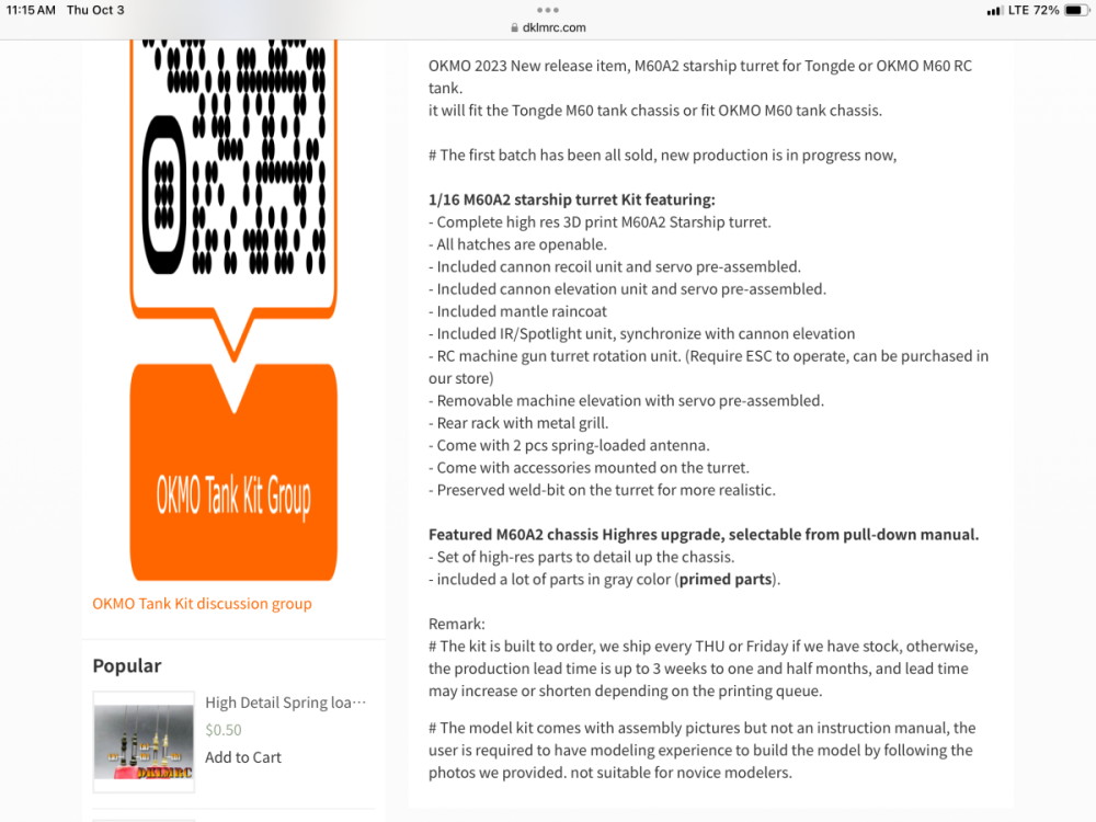

              I saw this on their website and that is why I ordered. I will check with them and if there is NO photos then I will cancel the order. Dai
              # The model kit comes with assembly pictures but not an instruction manual, the user is required to have modeling experience to build the model by following the photos we provided. not suitable for novice modelers.
                They say that but in all four turrets conversion kits I have (T23 , A2, Leopard 2, and Centurion) purchased from DKLM and those other have purchased, photos of assembly are almost nonexistent.
                You can press DKLM for photos, but don't expect a quick response or a guarantee they will come in the box with the turret.
                DKLM make great stuff, but it is made for those with a lot of scratch and or hands off building experience. You have time to gain the experience by working on your current tanks installing servo recoils and servo elevation units. With that knowledge you will have an easier time building the A2 turret and installing installing it on your tank.

                                        Carson sent me an email saying the recoil and elevation unit are ALREADY installed in the turret. That is good to hear. Dai
                                        • Rubicon99
                                          • 3311
                                          #160
                                          Yes and NO. But you will see during the assembly. Also I highly recommend upgrading the supplied Emax recoil servo as they have a long history of burning out. To do this you will have to remove the recoil until. You can do this during the build which is easier then doing it afterwards when the servo burns out. Trust me it will burn out.
                                          Also you will need to set the recoil stroke so the barrel fume extractor does not slam into the mantlet. This will cause stress on the Emax servo and is what causes it to burn out. The servo cannot be changed easily without removing the recoil until. You will understand the complexity of what I am say when you see the assembly process.
                                          I pointed the issues out to RichJohnson before he started building his A2 and he has "reworked" the record servo mounting method to make it serviceable without the need to completely disassemble the turret and remove the barrel . This was passed onto DKLMRC and they said they would look at a possible redesign in later production runs. Unfortunately that was only fairly recent and any redesign has not been implemented as of yet.
                                          I write all this as a heads up warning as to what you might expect to see. I was one of the very first to acquire a DKLM A2 turret and had to discover all the little nuances that popped up without any fore warning.
