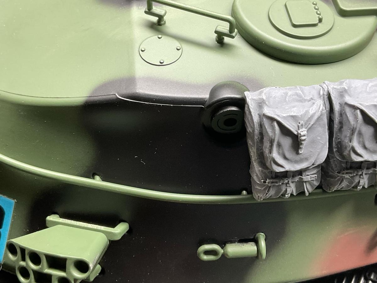

You can thank Cool Banks for the oversized holes and "dumbed down" details. Fortunately he had less influence in the suspension. To expensive to change the M60 molds now. Fortunately moving forward TDs new products are getting more details and much better parts fitment.Originally posted by dai phan View PostHi all,
I do not understand why the attachment holes are so oversized making the parts wobble and VERY un-scale !!! On HL tanks, parts fits precisely and you do not see these over scale holes. Hard to believe QC did not pick this up? Dai
Comparing TD to HL in parts fitment is like comparing HL to Tamiya in parts fitment. If you had ever built a 1/16 Tamiya tank you would not say HL has good part fitment.

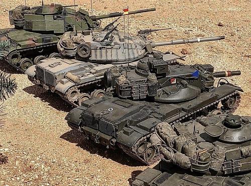

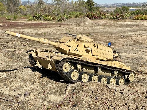

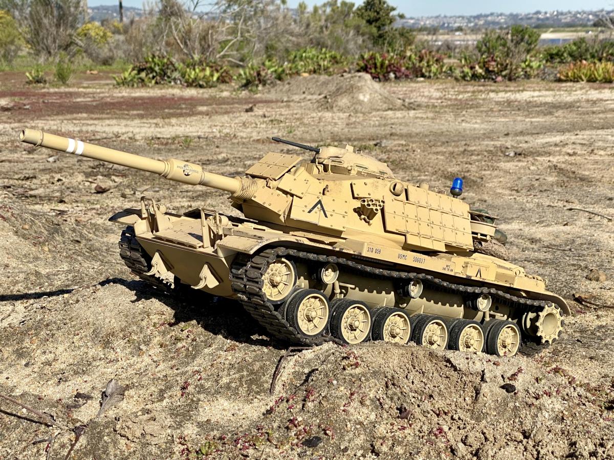

To echo Rich's comment about potential; here are two examples: the former is an early all-plastic model and the latter is a metal version, but substituted with plastic tracks. The first was pure stock with only repainting and a beacon. The second has a Heng Long 7.1 board, the searchlight, a beacon, barrrel recoil and a rotating commander's cupola. The HL 7.1 transmitter has an added function controlled by a trim tab that actually works. I used it to rotate the cupola. The 7.1 transmitter is otherwise identical and completely compatible with the 7.0.

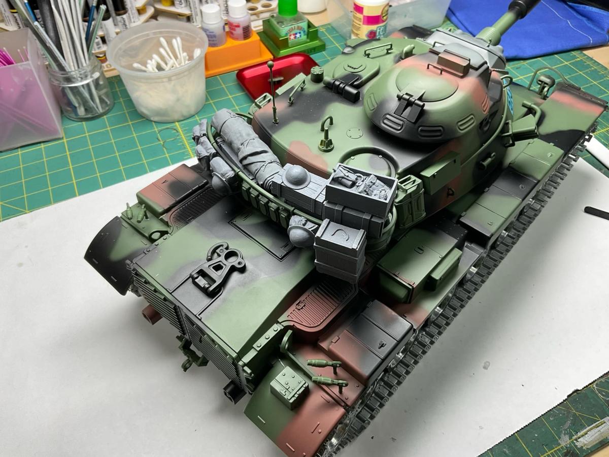

Hi all,
Assembled the M60A3 tonight. A few things are missing. They are one B2, one B3, machine gun and the two round things on the turret. These 2 round things are not shown in the sprues so I have no idea what parts to label them. Rubicon 99 I see your has these 2 and where are they in the sprues? The square thing is not shown on the sprues/instruction so I have no idea where it goes to? Dai
The sight ranging covers (round things) are usually packed with the TX control sticks. But sometimes they are also found in the parts box with the hub caps.Originally posted by dai phan View PostHi all,
Assembled the M60A3 tonight. A few things are missing. They are one B2, one B3, machine gun and the two round things on the turret. These 2 round things are not shown in the sprues so I have no idea what parts to label them. The square thing is not shown on the sprues/instruction so I have no idea where it goes to? Dai
The square thing is a part for the USMC "RISE" M60. It's an armor "block" that goes on the front of the tank. You will not use it on the A3. The two tanks share a parts spur.
Since I do not have the machine gun, the control sticks likely these round things were in that bag too. I have sent to MRC requesting replacement parts. If they are a hassle to deal with I just buy a new detail set. I hope they will come through. DaiOriginally posted by Rubicon99 View Post

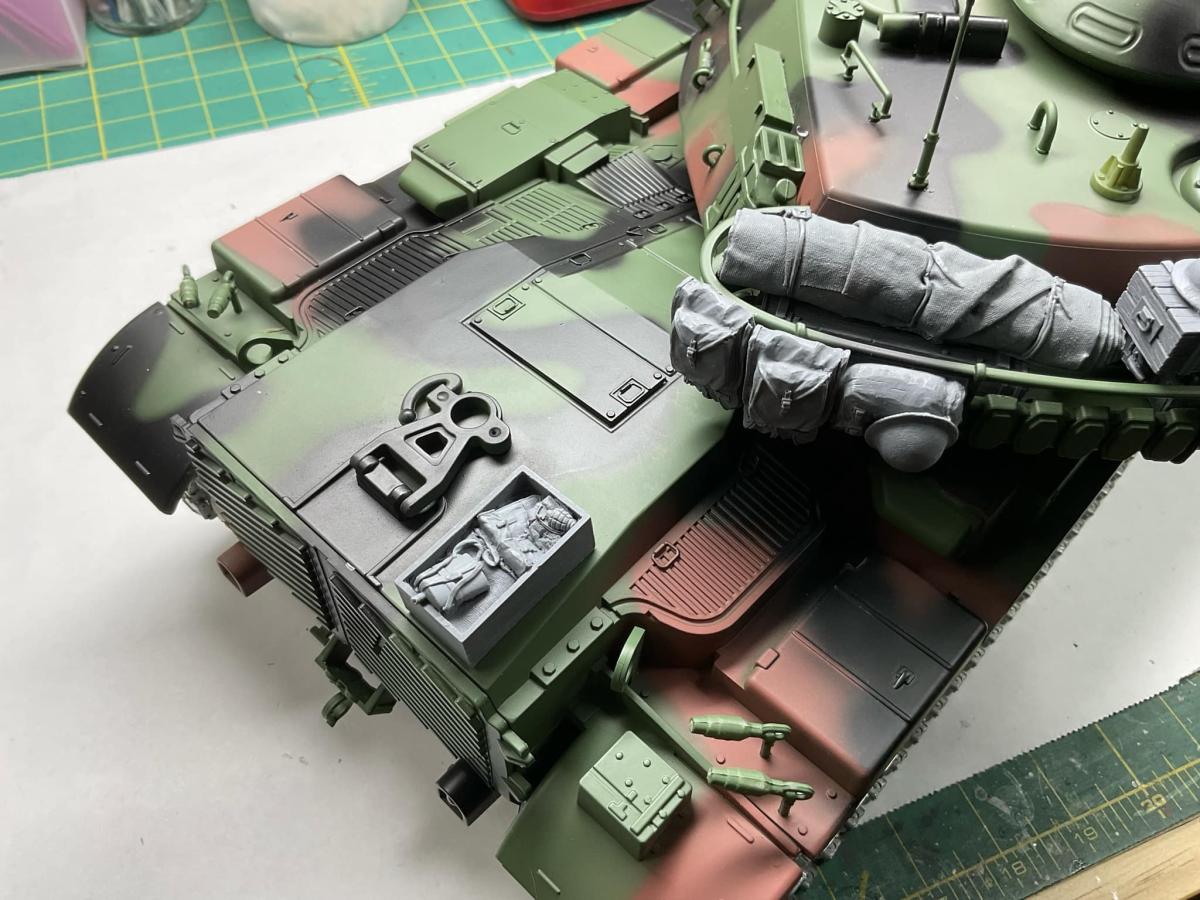

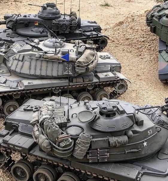

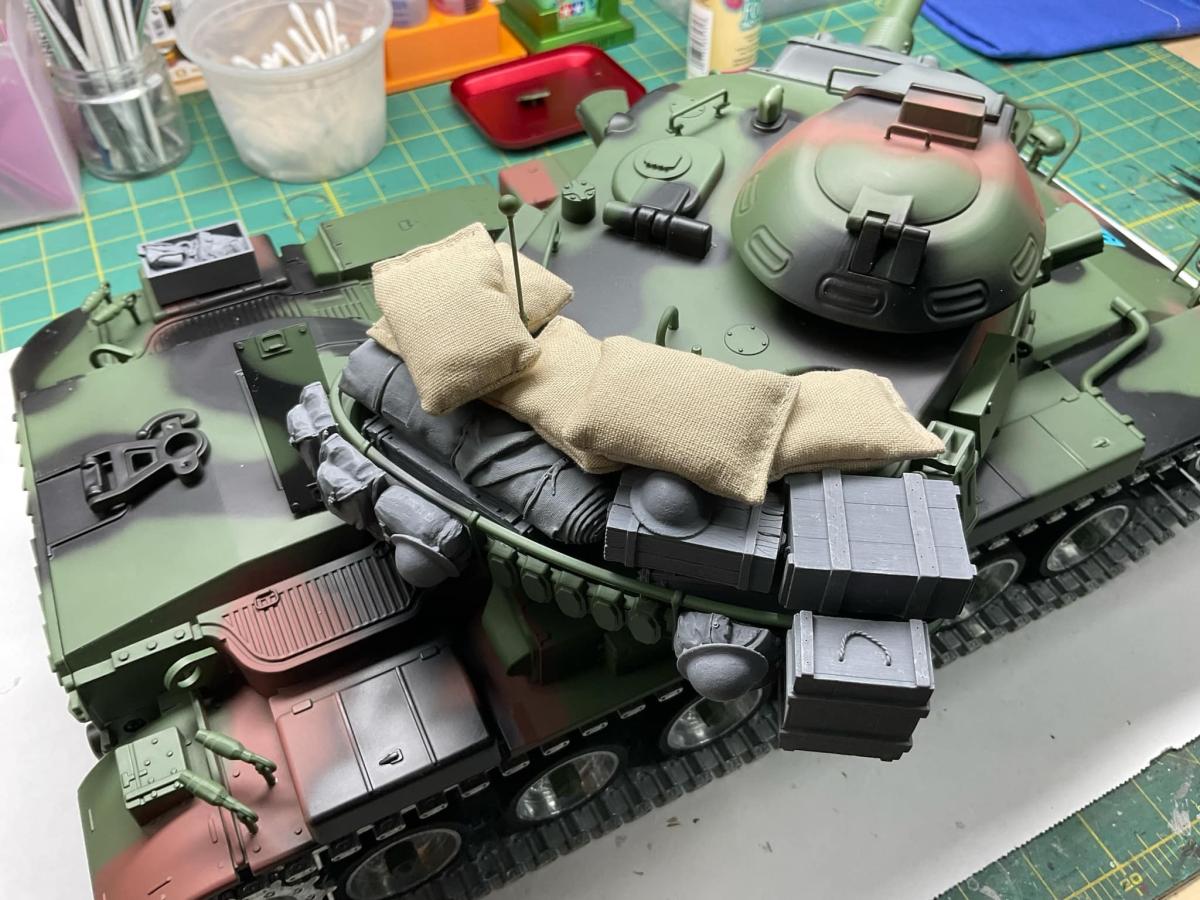

Since you asked, get rid of the crate on the turret. Move the satchel bags from the turret side to hanging on the handrails.
no stowage on the side fenders, get rid of the stuff on the sides in front.
Try to pile as much stuff into and stacked on top of the turret basket.
some stuff tied to the glacis (the front slope armor) is ok, but that is how the crew boards the tank so can’t have too much stuff there, also make sure the driver can see over it.
stuff on the back would have to be minimal, maybe some tarps but turret must spin all the way around without fouling. It’s not wwii, crews did not have massive piles of stuff on the backs of their tanks. Most everything was piled up in the basket, tarps tied to the rear of the basket, spare stuff tied to the basket, tarps and such tied to the side hand rails in the turret, and only that much was carried when they went out for long exercises like Reforger in Germany or for a few weeks at NTC in Southern California. Otherwise most of their stuff was left at a brigade TOC during training exercises.RC tank parts and accessories I make

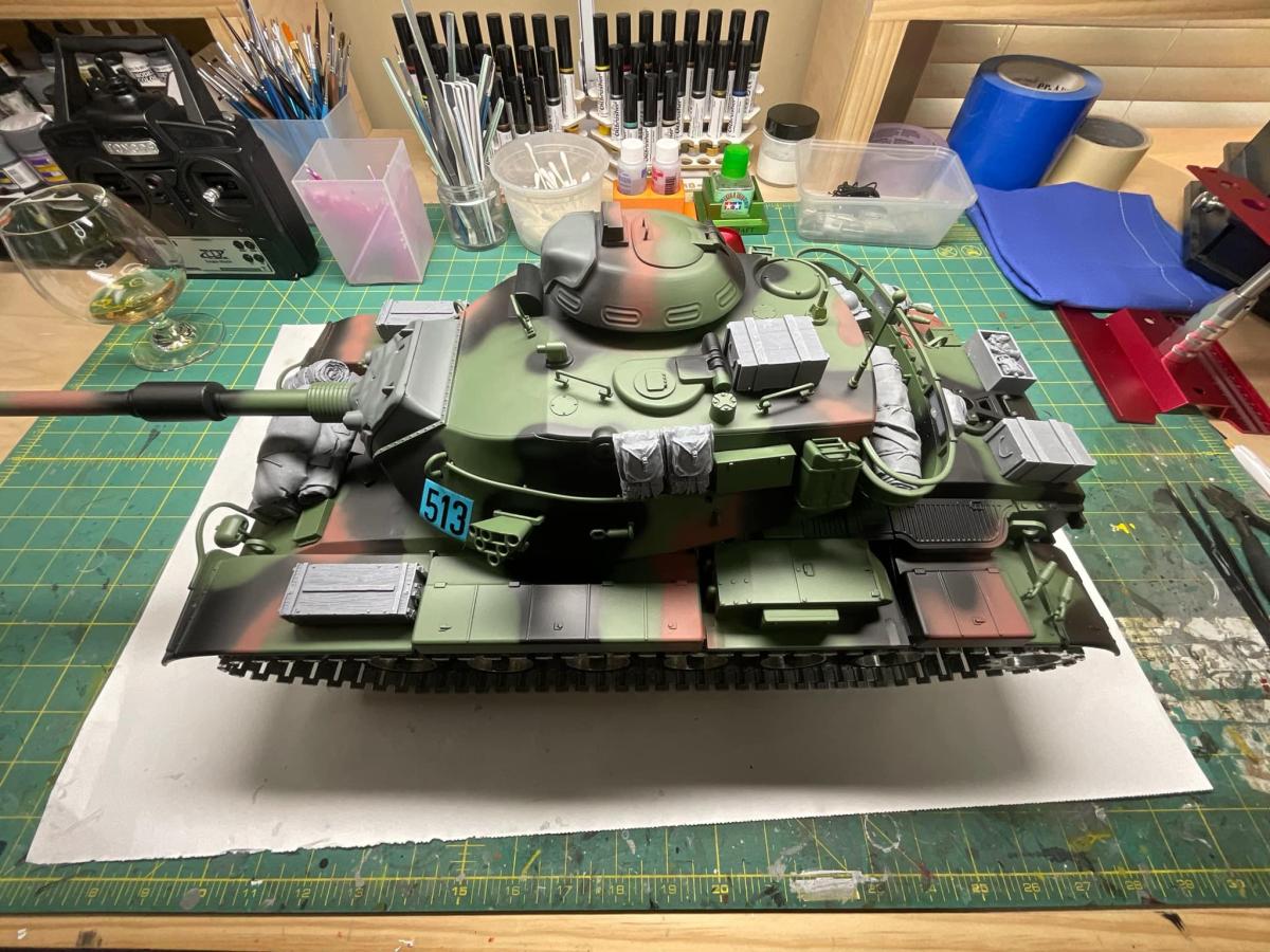

Thank you for your guidance. As a model airplane guy I am clueless on tank's arrangements. DaiOriginally posted by RichJohnson View PostSince you asked, get rid of the crate on the turret. Move the satchel bags from the turret side to hanging on the handrails.

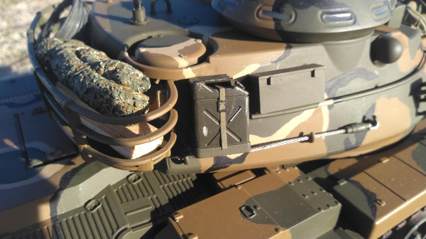

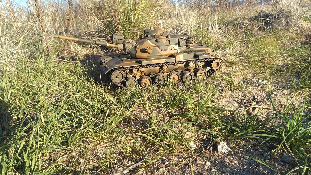

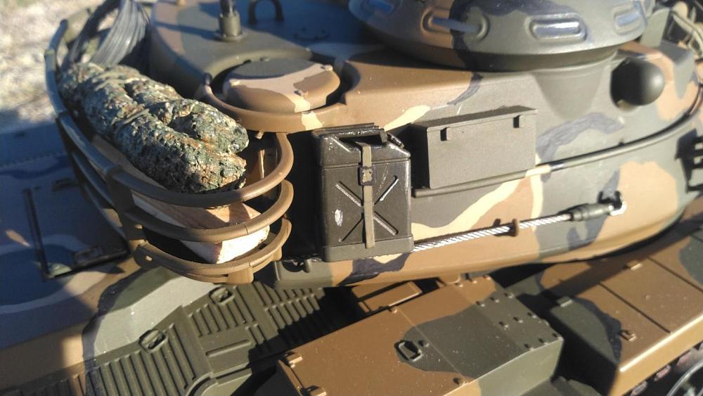

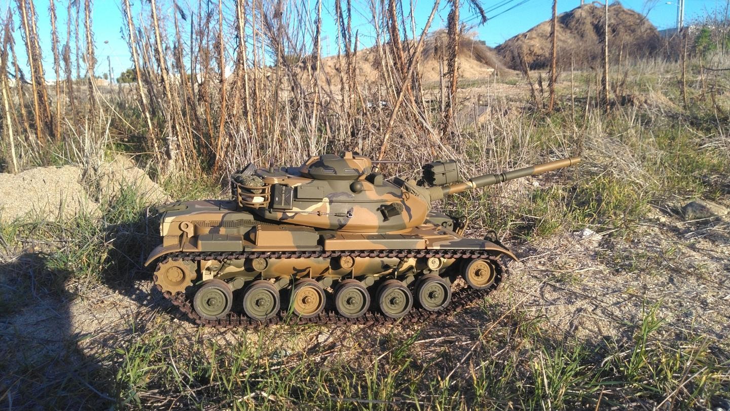

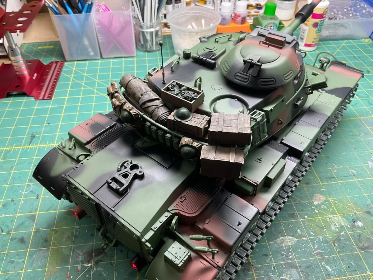

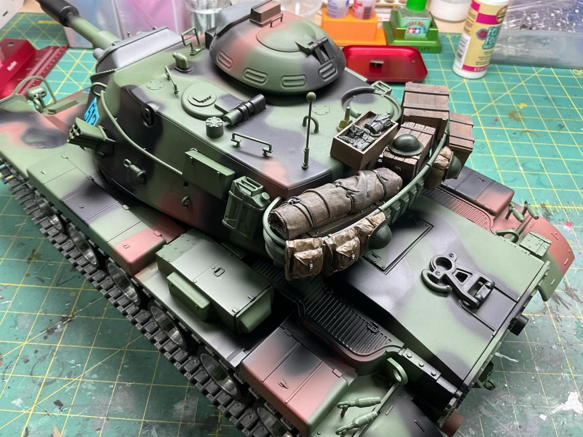

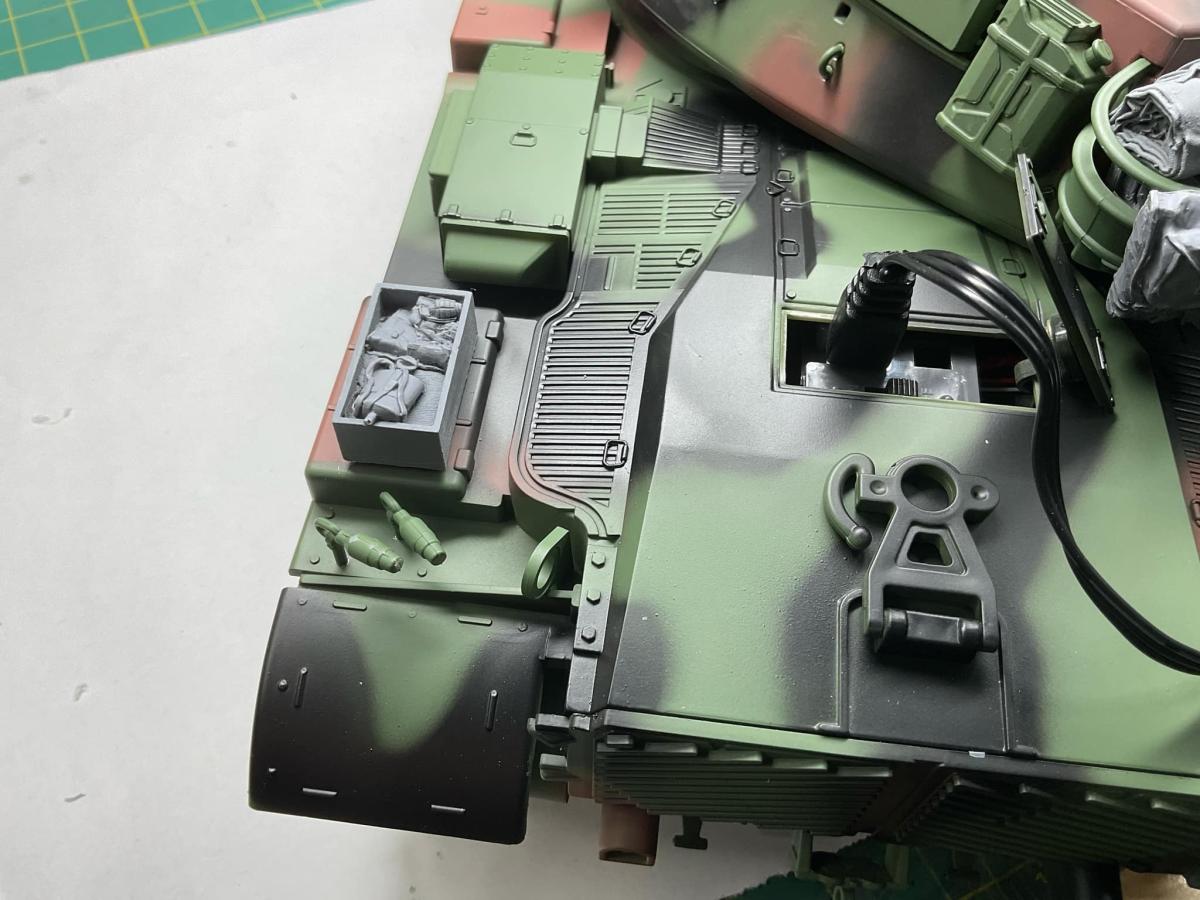

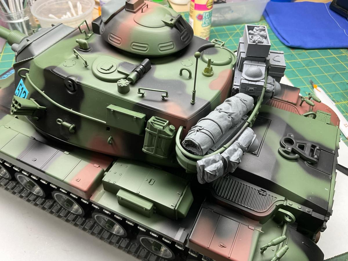

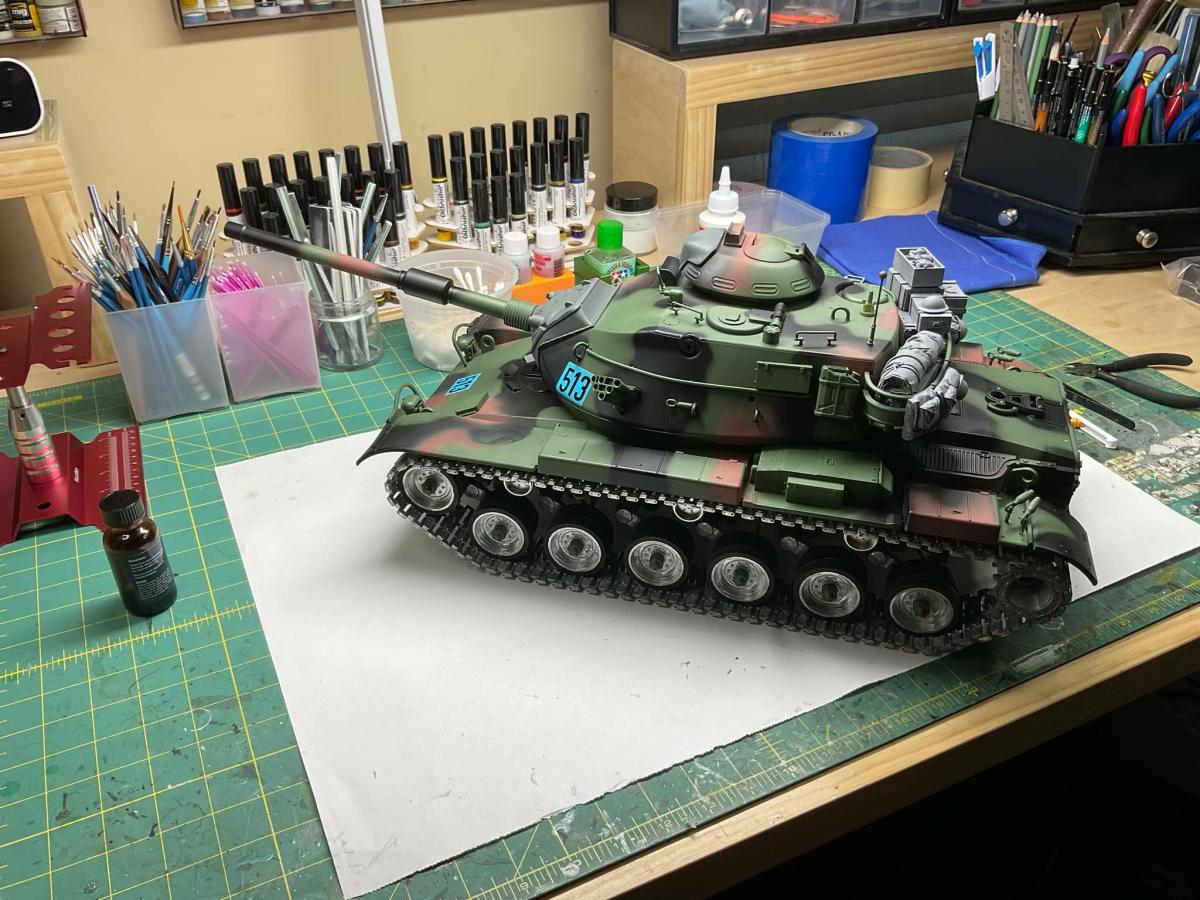

Nothing on the forward upper hull glances. The kit you have there would block the drivers view.Originally posted by dai phan View PostI tentatively place some detail items on the tank and please let me know if they are in correct locations. Dai

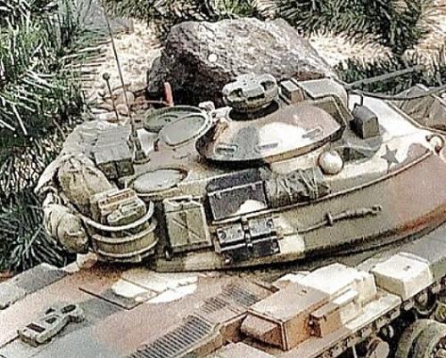

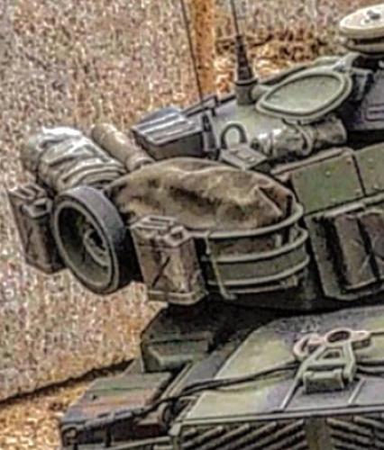

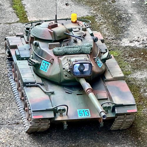

The M60 crews would "usually" pack the bustle rack and top of rear turret section full of kit and gear, sometimes they even used the forward portion of the turret top as long as it did not block any gun sights. . They used the side of the turret most often for things like large tarps/camo netting or spare tracks sections. Other than that there is no real right or wrong.
Some of how I did mine. Not to much as to hide the "lines" of the turret but enough to say heading out into the field for more then a day of practice.
That is so true and I did wonder about the helmet style. I have ordered almost 200 dollar of resin accessories and will correct when they arrive. DaiOriginally posted by Rubicon99 View Post
Try to use more time period correct kit or kit that is not so recognizable. You have WW1 infantry helmets hanging on a 1980s era tank. Otherwise it's starting to take shape.
