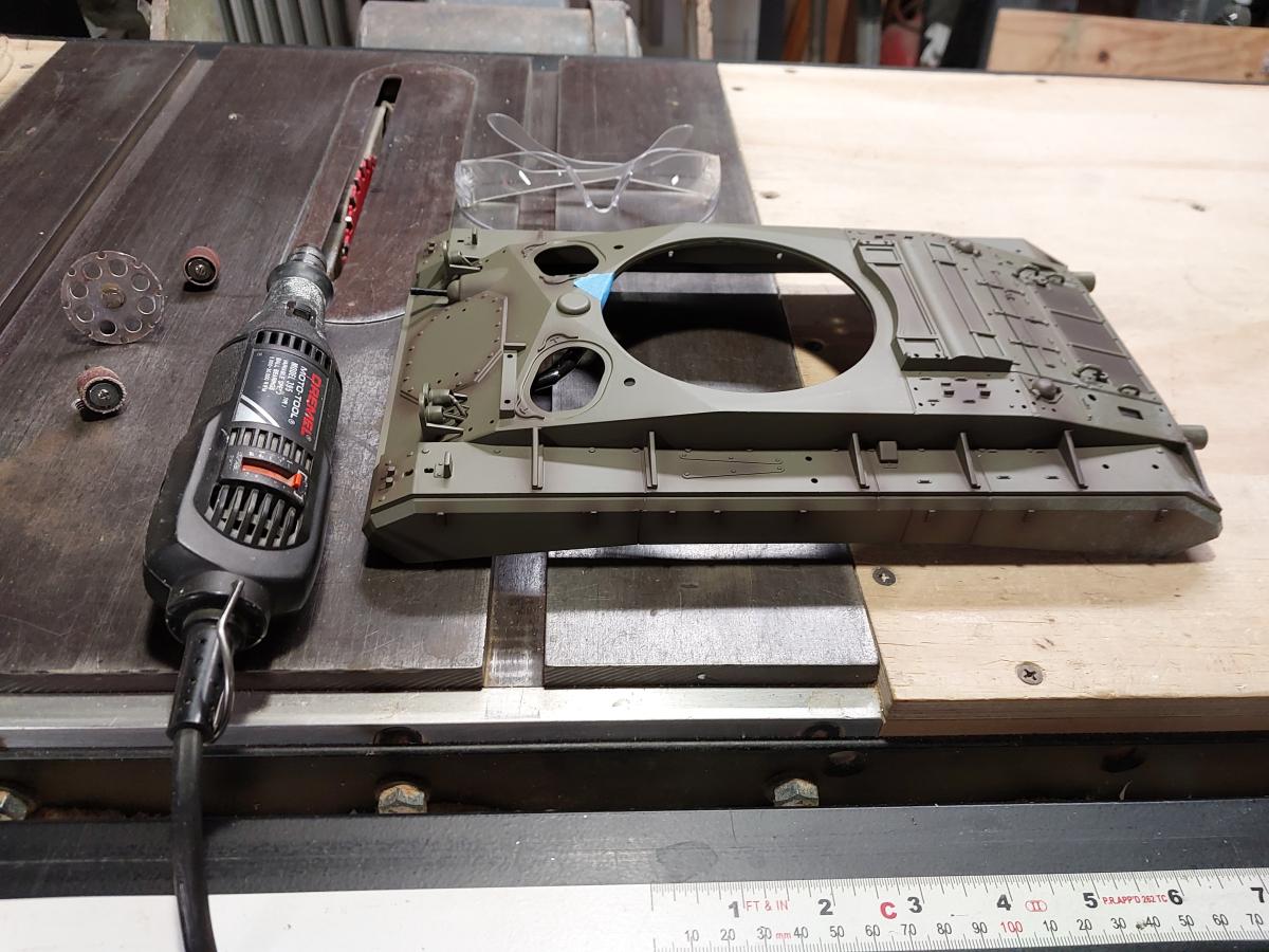

    I carefully decided where to cut the upper hull to make an easily removable cover to remove the battery. I used my DeWalt scroll saw to make the cut out. I drilled a couple of 1/32" holes to insert the scroll saw blade. Then I clamped a piece of 1/4" plywood onto the scroll saw table because the upper hull would hang over the edge to the table.
    A picture is worth a thousand words, so here come the photos!!!

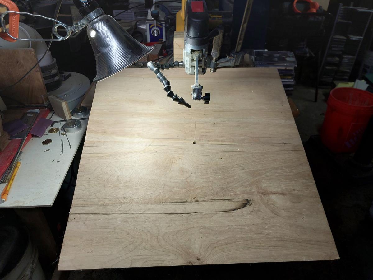

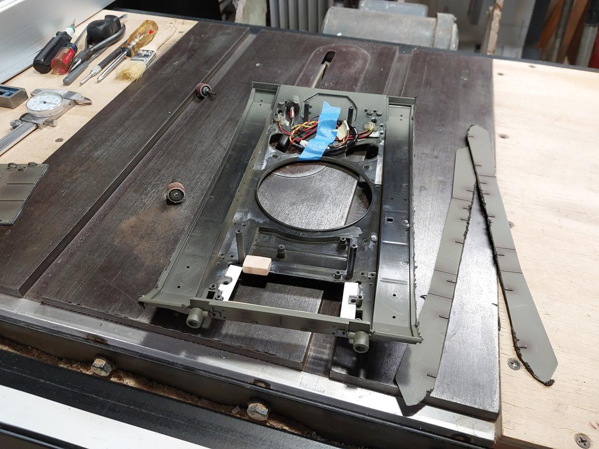

    Here's the plywood on my scroll saw table.

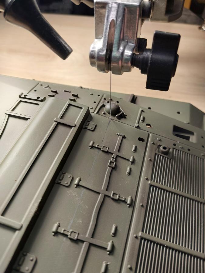

    Here's the scroll saw blade going through the hull so I can make the cutout.

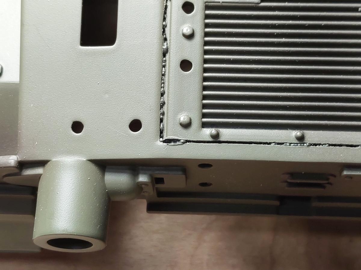

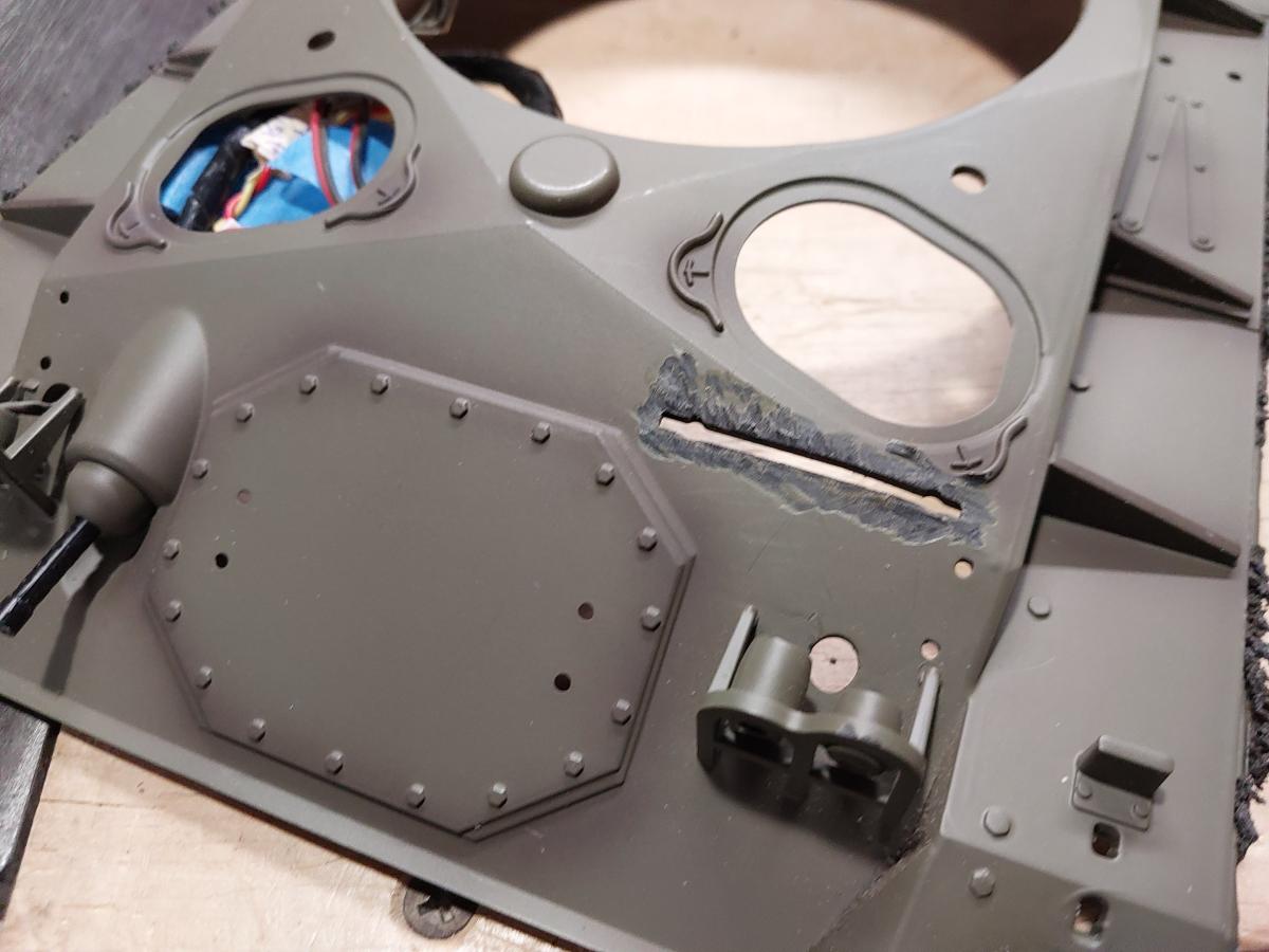

    The first cut is across the hull on the pencil line, and down the side, and across the rear edge, and up the other side. Anyone whose ever cut this type of plastic, or ever styrene, knows the friction from the blade causes the removed plastic tends to fuse the cut, but it usually is easily separated afterward. The same fusing phenomenon also happens if an abrasive cutting disc is used. It takes a bit of getting used to, but it's not as bad as it sounds.
    This image shows the fused plastic in the cut.

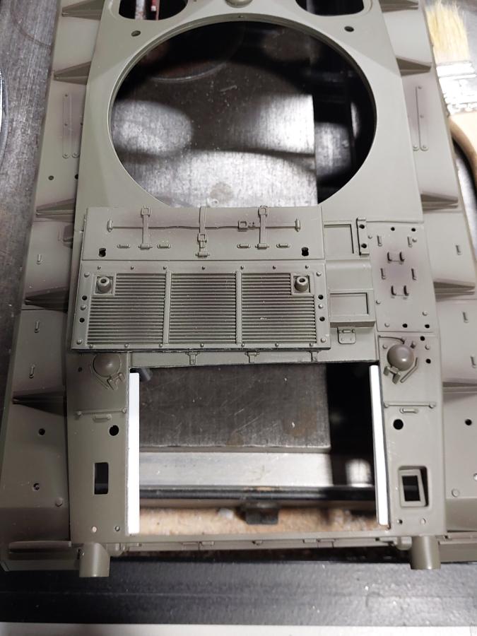

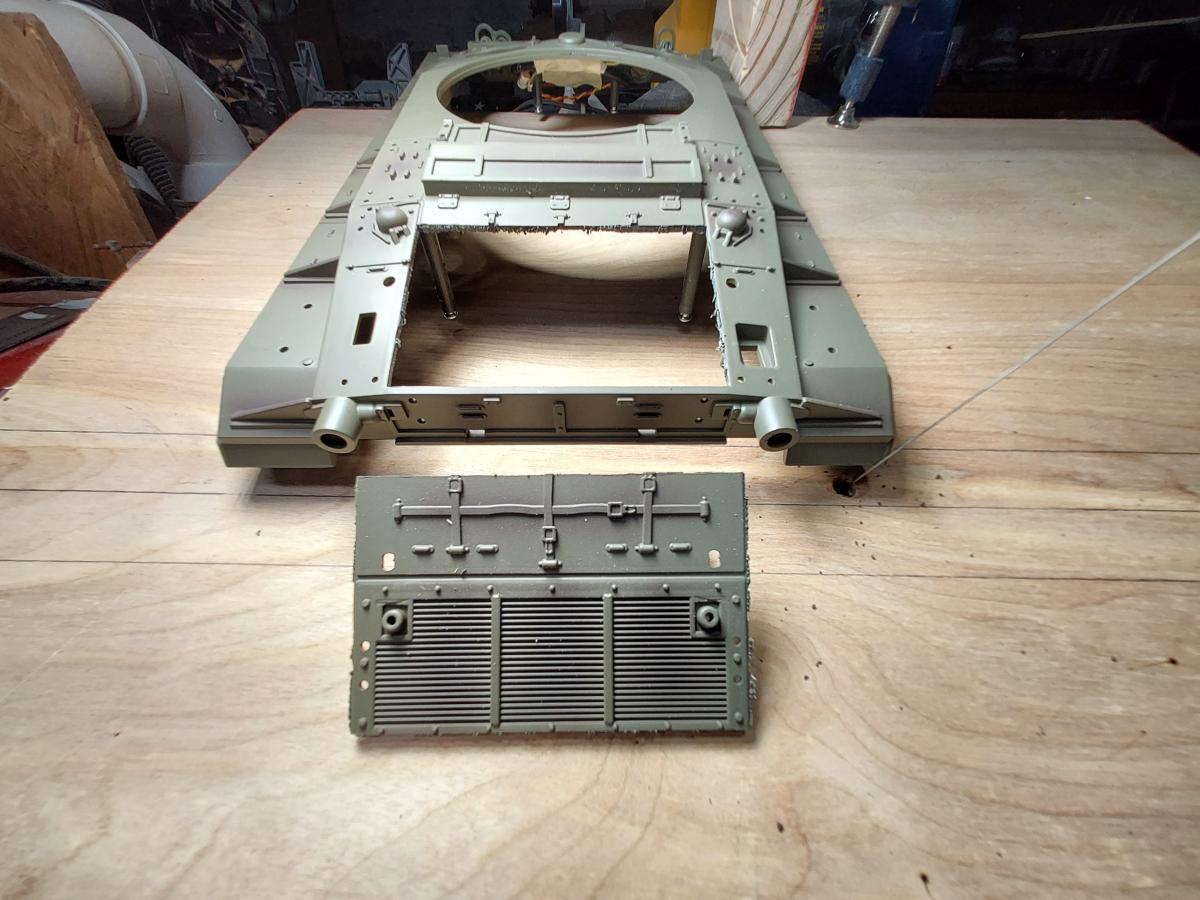

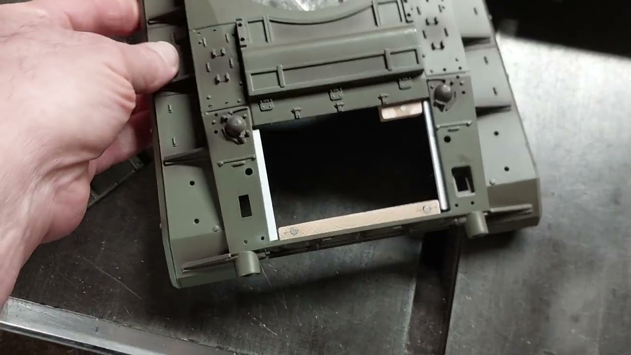

    Next, we have the new battery opening cut, and then comes a bit of filing the edges, and so on.

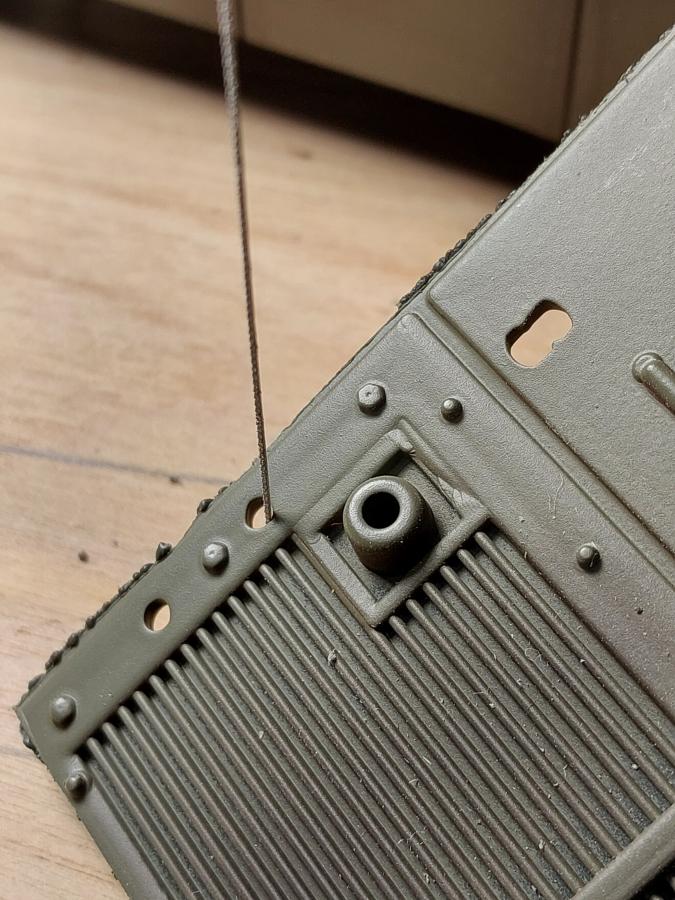

      It's amazing how small the blade is I used to cut out this opening. This image shows the blade passing through one of the holes a lifting handle will be glued into.

        The last thing I did yesterday was to cut a couple strips of 1/16" thick styrene sheet to glue to the upper hull at the sides of the opening the new cover would sit on.

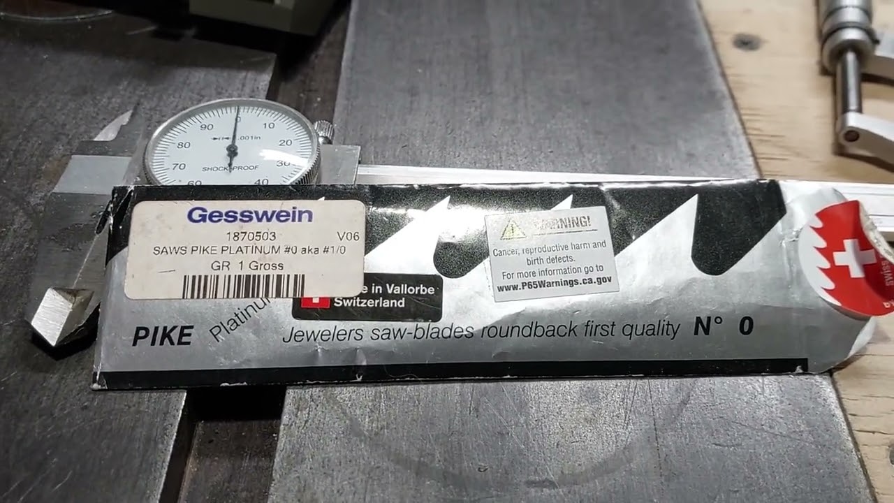

            Great idea and workmanship! Do you recall the blade size?

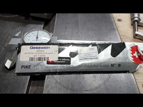

                Good morning Bob, BTW, it was basically your idea, I liked it and I ran with it. Thank you for taking an interest in my build thread, I really appreciate it!!!
                Here's an image of the metal cutting scroll saw blades I use. They are almost .012" thick x .022 wide. Watch the short video for more information.
                Roger
                Click image for larger version  Name:	1000038579.jpg Views:	0 Size:	183.7 KB ID:	448675

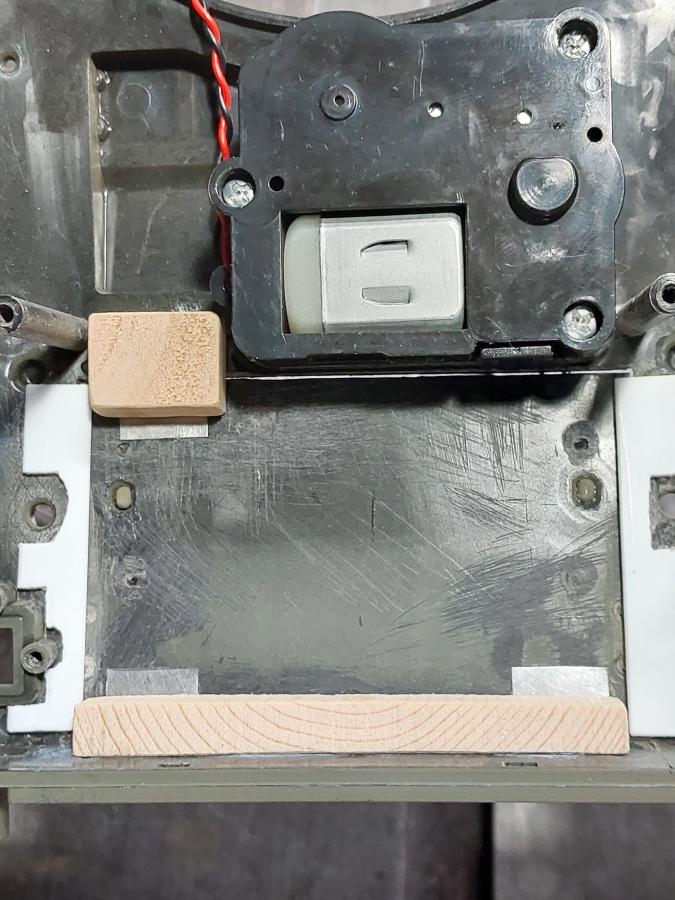

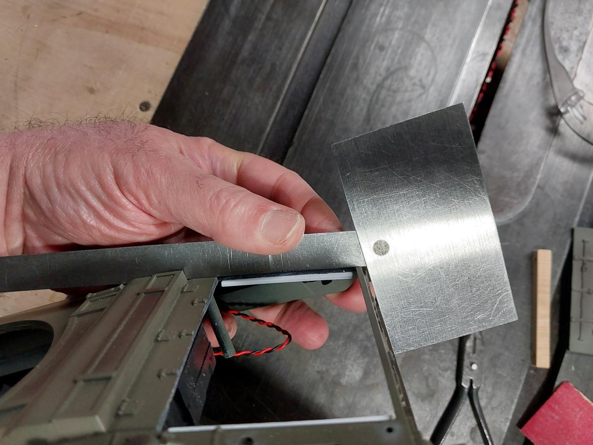

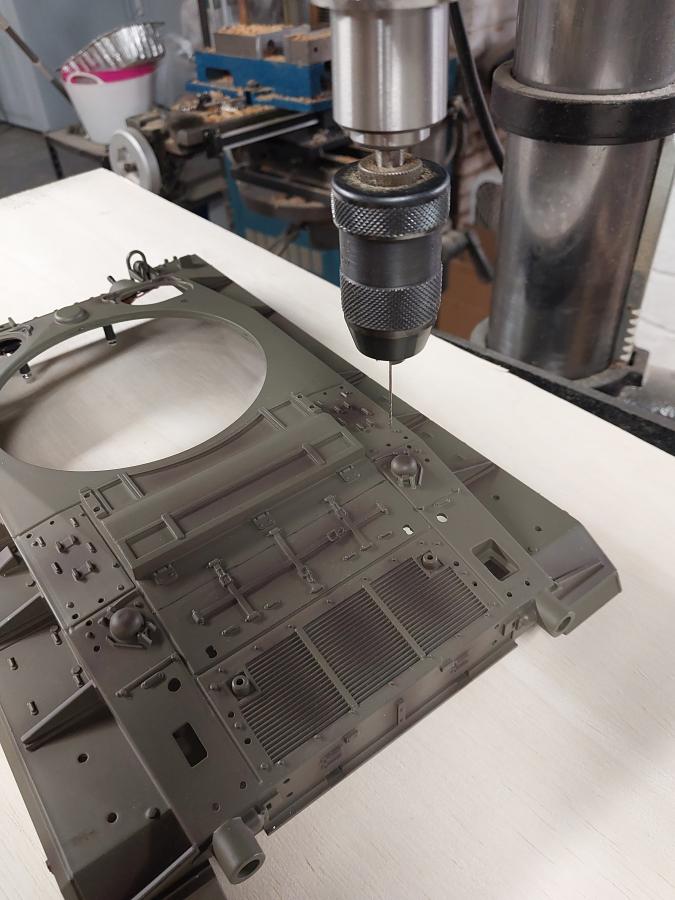

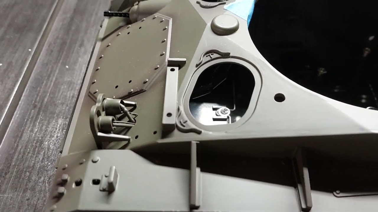

                    Next, I measured the angle on the rear of the upper hull, so I could make a block to support the rear edge of the new battery hatch.
                    It's a 13 degree incline.

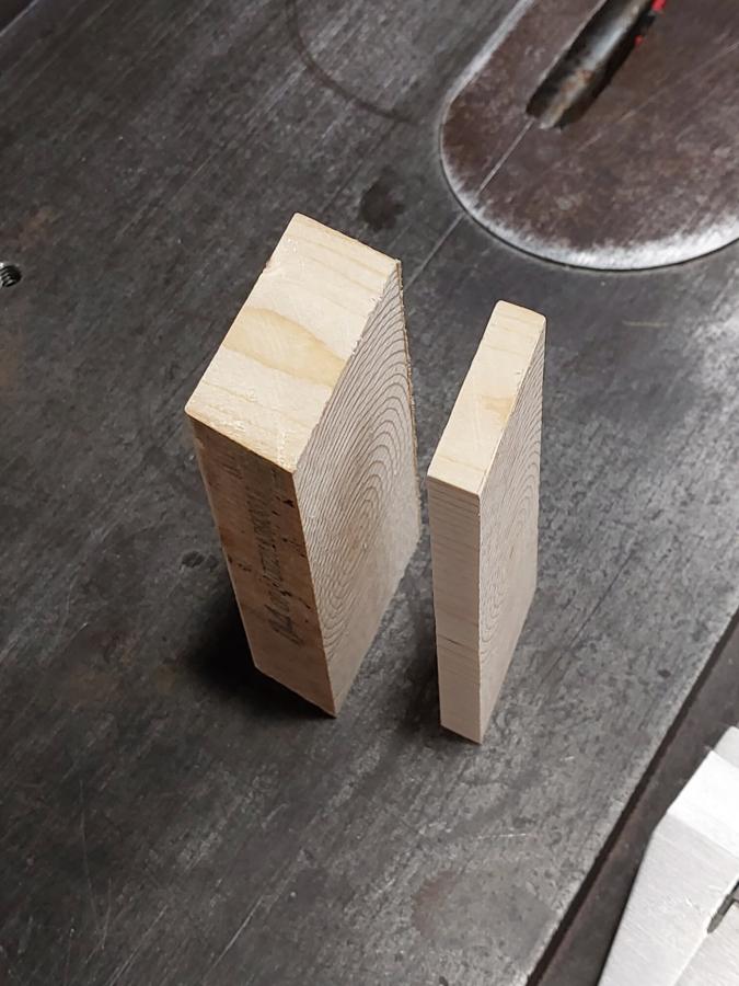

                    Next, I set the miter saw at 13 degrees, and I cut an inch long piece of 2 x 4, and then I ripped off a 1/4" piece on the band saw.
                    Then I laid out where I would drill two 1/8" holes an 1/8" deep using a spade drill so I had a flat bottom holes. After drilling the holes, I ripped off a 1/4" wide piece, glued the magnets in so they were flush with the surface of the wood block.

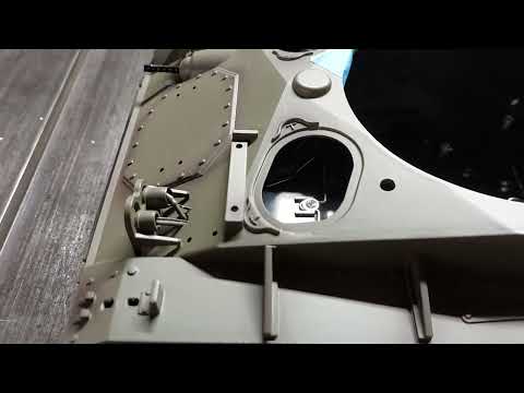

                      I wasn't able to attach a couple of tabs to the front of the hatch, so I made another small block of wood with another magnet that was mounted next to the turret traverse motor. Here's the wood blocks and magnets that will hold the hatch on, and allow easy access to the battery. The thin steel pieces can be seen glued onto the bottom of the hatch.
                      Here's a short video that says it all!!!

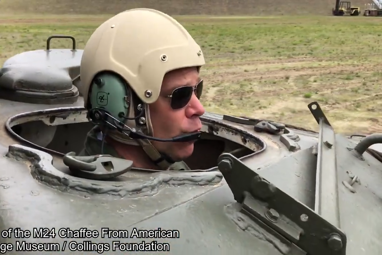

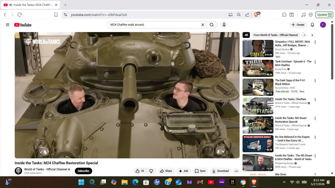

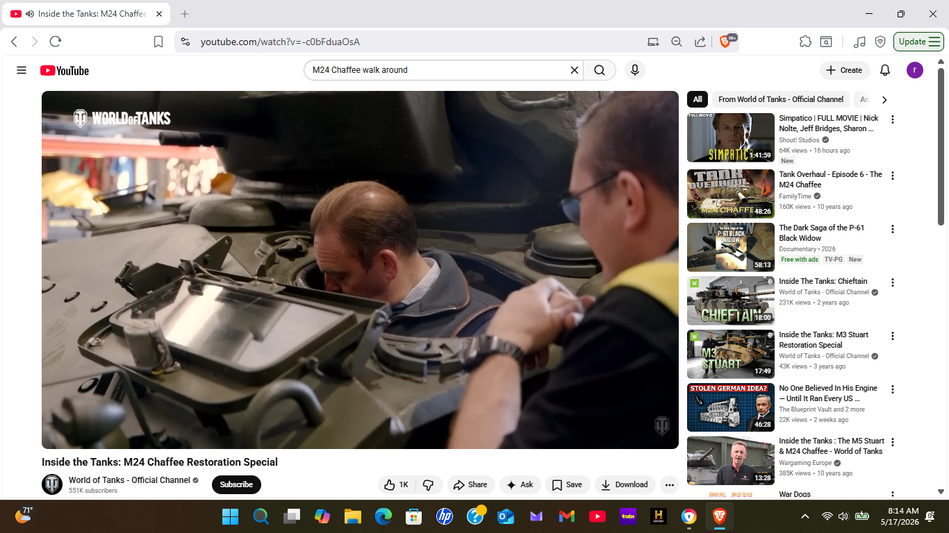

                              OK, so I went through some screen shots, and here are some good images of what I'll call windshield delete M24's!!!!! First, here's two great images of the windshield folded down, and one has only the brackets remaining.
Name:	Screenshot 2026-05-17 081250.png
Name:	Screenshot 2026-05-17 081406.png
Name:	Screenshot 2026-05-18 165433.png
                              OK, now just 3 mounting blocks. Yes, I said there were 4, but I was wrong!!! LOL!!!
Name:	Screenshot 2026-05-17 090506.png
Name:	Screenshot 2026-05-18 165714.png
Name:	Screenshot 2026-05-18 170156.png
                              Last image, the Norwegians moved the Ma Deuce up front; it looks outta place!!!
Name:	Screenshot 2026-05-18 170410.png
