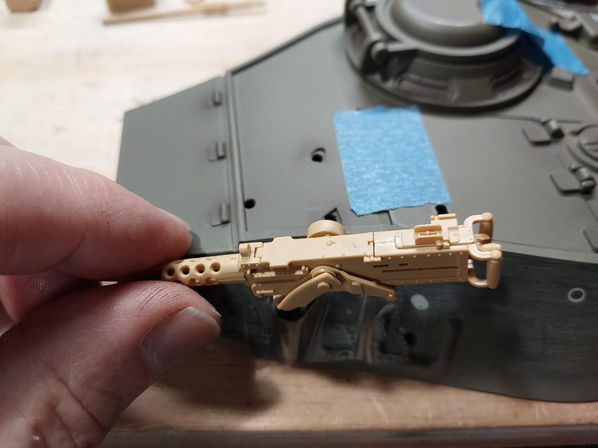

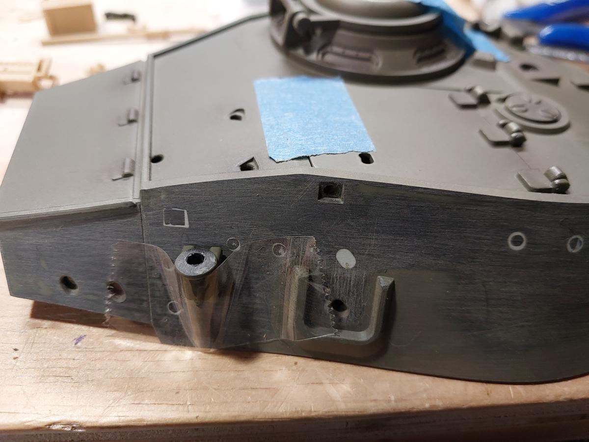

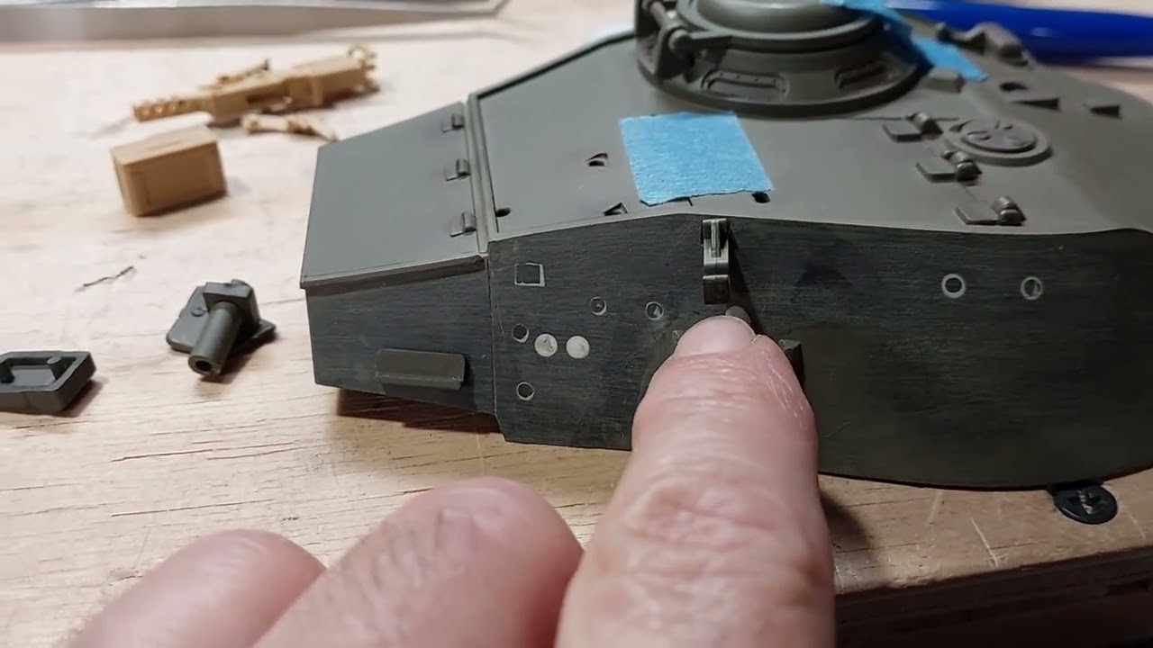

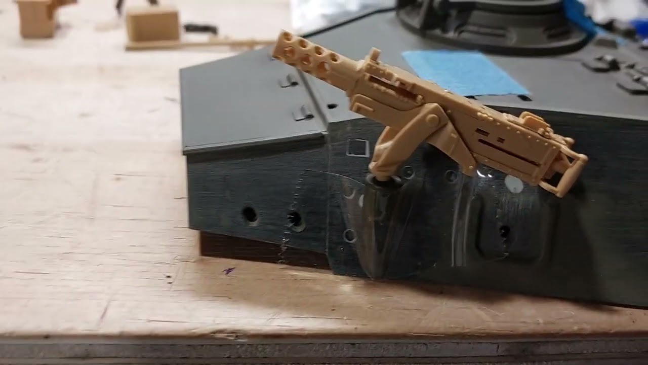

    Then I decided to use the Tongde BMG stowage mount as a test to choose the correct location to attach it, and to check for the proper clearance between the side of the turret, the stowed 50cal ammo box, and the pistol port hatch. I center punched it and drilled a small hole to start with. Then I sanded the dome shaped top off so it was flat, and I opened up the hole to fit the gun mount yoke. I taped the part onto the turret roughly in the location it was to be attached.
    Click image for larger version  Name:	20260630_163718.jpg Views:	0 Size:	108.4 KB ID:	450269
    Then the M2 BMG was placed into the mount to check the clearance.
    Click image for larger version  Name:	20260630_163916.jpg Views:	0 Size:	74.1 KB ID:	450270
    An overhead image shows the Tongde rear M2 support bracket location is OK.
    Click image for larger version  Name:	20260630_163922.jpg Views:	0 Size:	97.9 KB ID:	450271

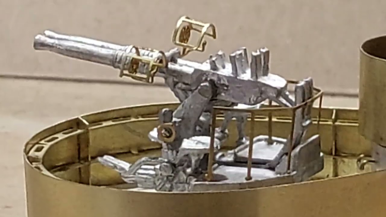

          OK, here's about a 16 minute long video showing a small glimpse of the 1/125th, and 1/96th scale Fletchers I'm building. The 1/125th is the DD555 USS Haggard that was Kamikazed on my birth day 15 years before I was born. The 1/96 scale Fletcher is the DD 473 USS Bennett that was built at the Boston Navy Yard where my Grand Father worked during WW-II as a ship fitter. Yes, the Bennett was also Kamikazed and survived the war as an AA upgraded Fletcher.
          Enjoy!!!

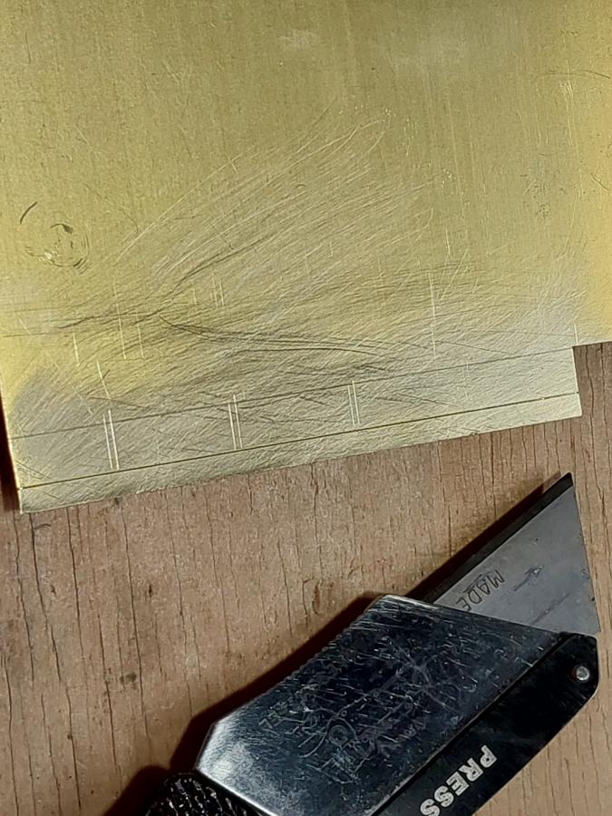

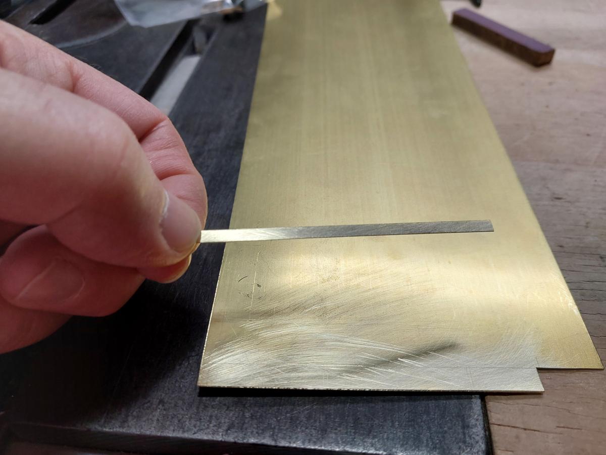

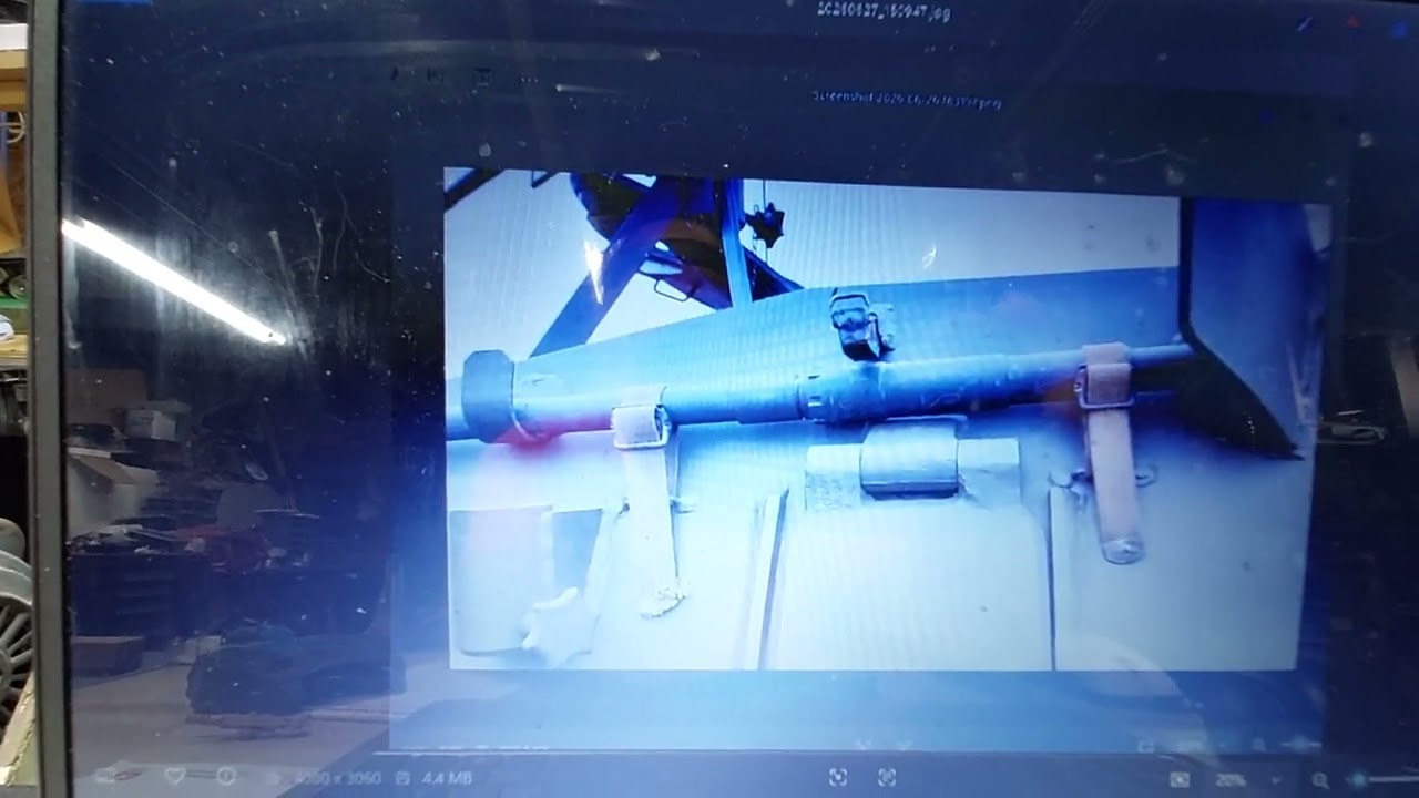

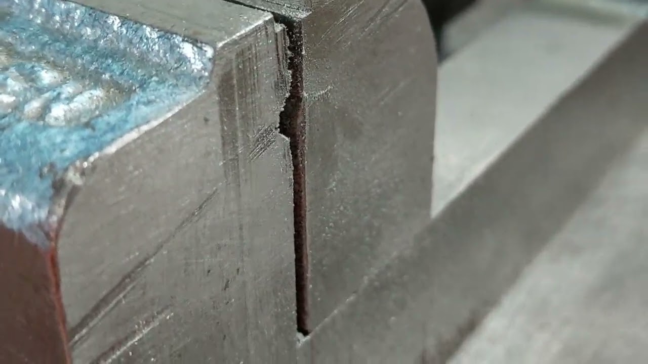

              OK Finally here's the turret mods small scratch built parts, and how I made them. First, I reviewed what I want to do as I looked at some images on my Laptop.
              OK, this is a sheet of .015 thousands thick brass sheet. I need to cut off a 1/8" wide strip to make the 50cal turret mounting brackets. I could've used sheers, but the strip would coil up as its cut. So, what I did to cut the strip off is just like cutting a sheet of dry wall, we measure where to make the cut, and we score it a few times with a utility knife, then we bent it on the score line; it breaks off, and then the paper on the back side is cut, and the piece is separated for use. The brass sheet was scored, and then I clamped it in a bench vise with soft jaws (aluminum angle) on the score line, and I bend it back with a small piece of wood, or a piece of aluminum. I only bend it back a small amount, then I bend it back and forth a couple times, and the strip is free of the sheet. Then sand the edge, and it's ready for use!!!

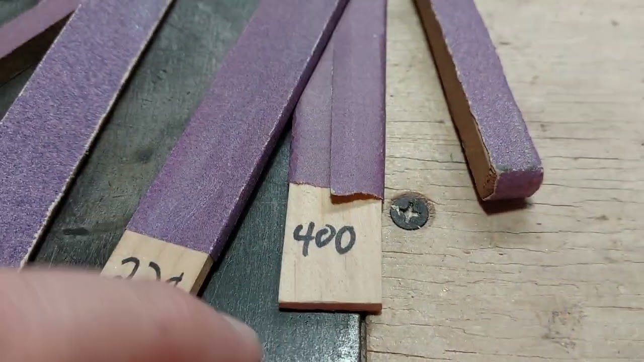

                    Here's a video of how I make sanding blocks of various sizes and shapes.

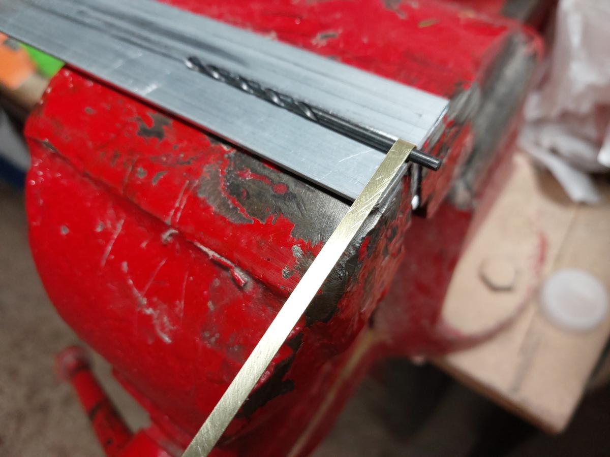

                      Let's continue to make the 50 BMG gun barrel mounting tabs.

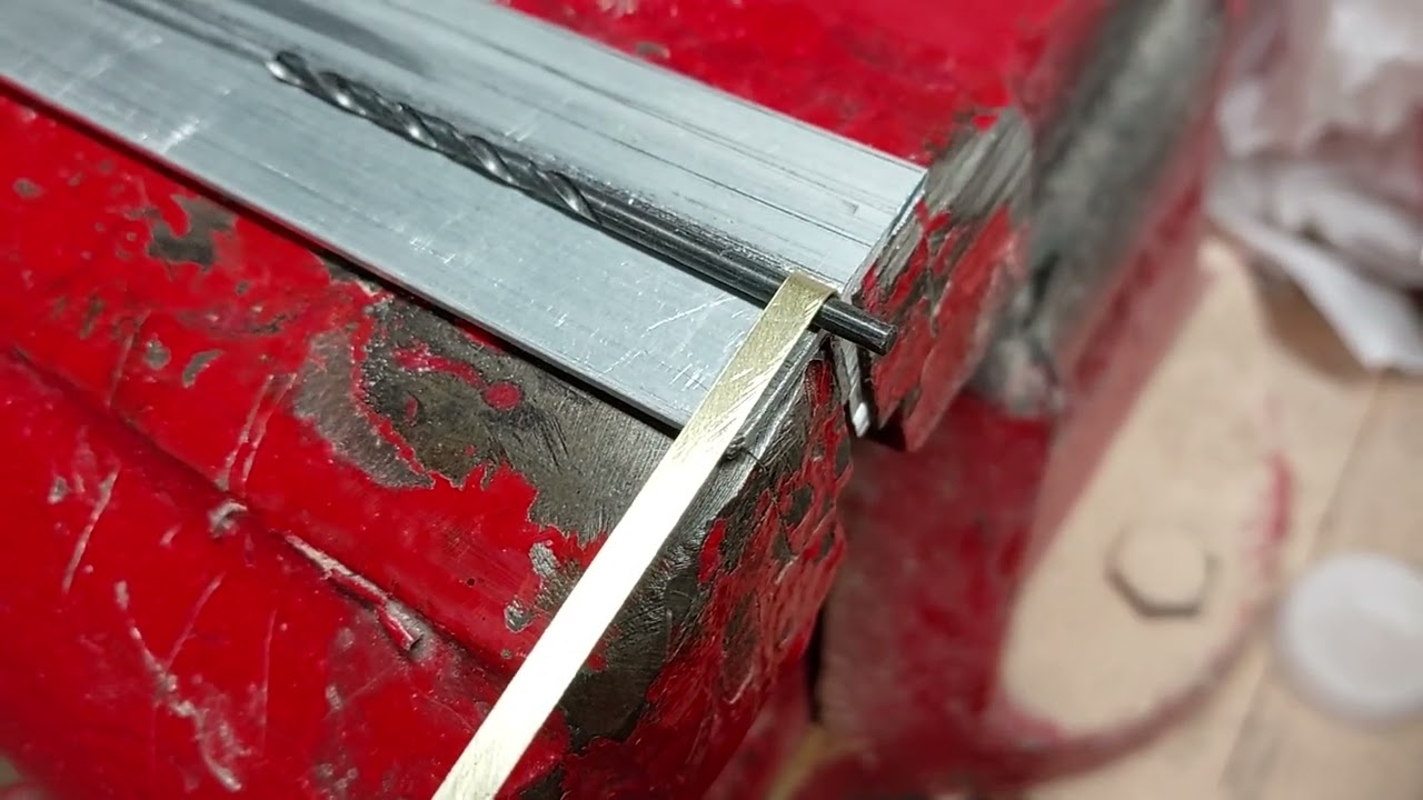

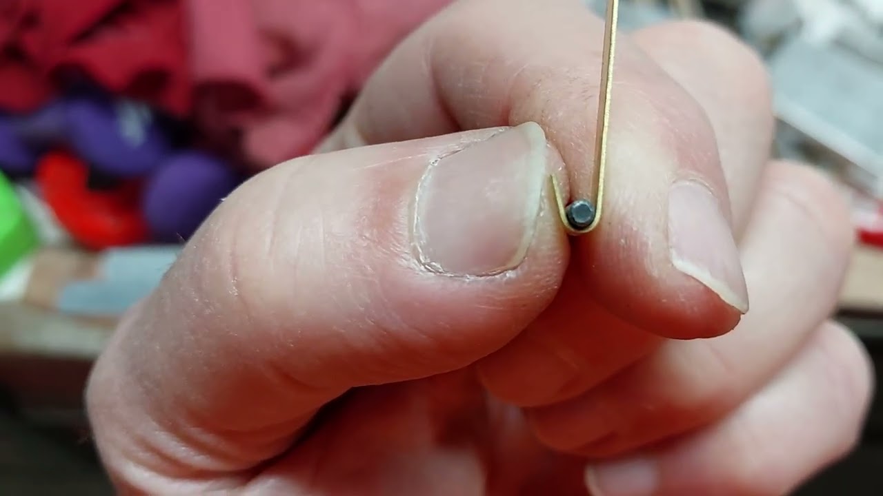

                      So, I took the strip and clamped it in the vise, and I rolled it over a drill bit shank to begin making the 1st mounting tab.
                      Short video

                        To finish bending the bracket, I open the vise a bit, and holding the drill bit against the partially bent part, I push it into the open vise to almost complete the U shaped bend.
                        Then take it out of the vise and finish the bend with a gentle squeeze.

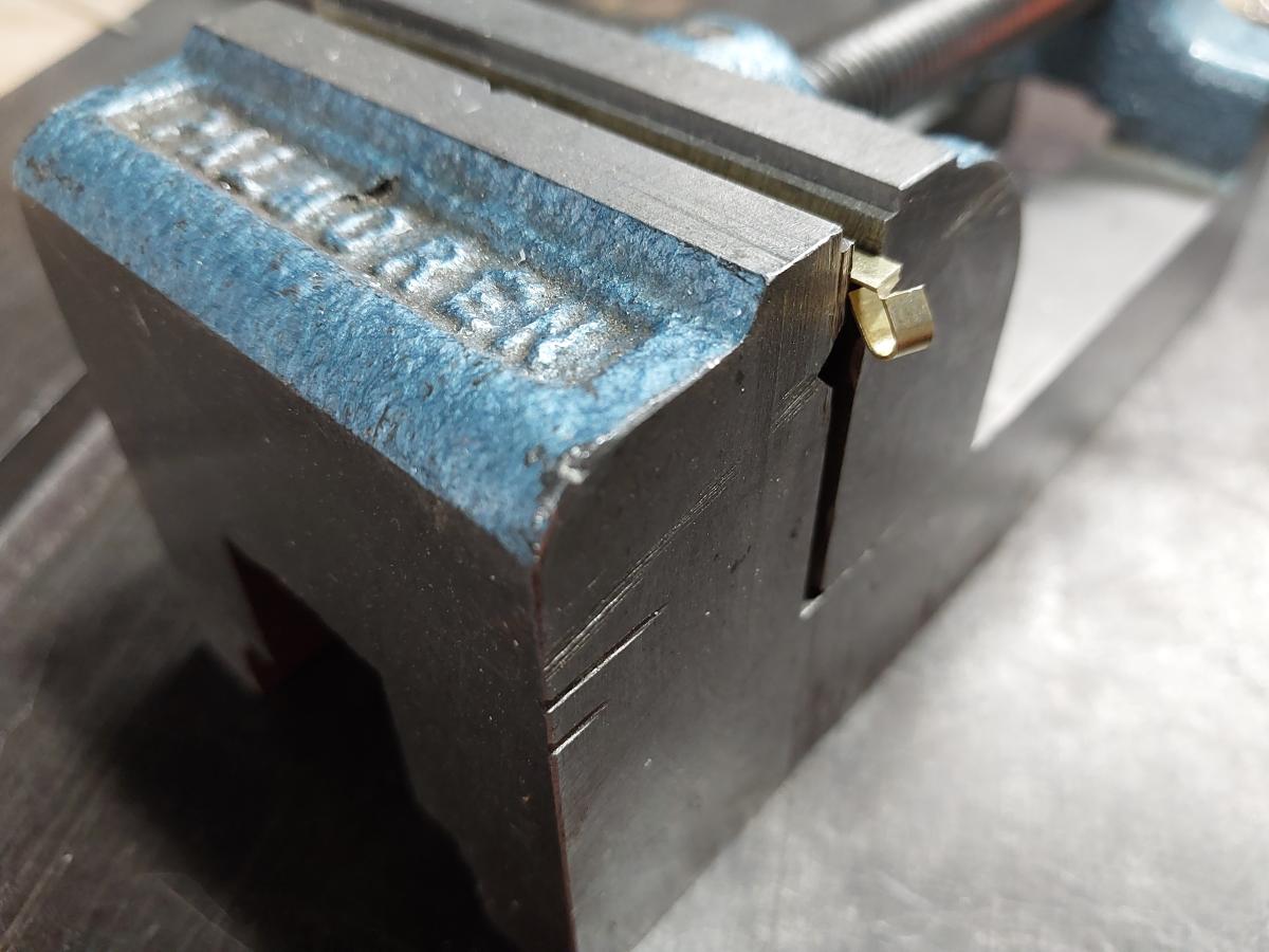

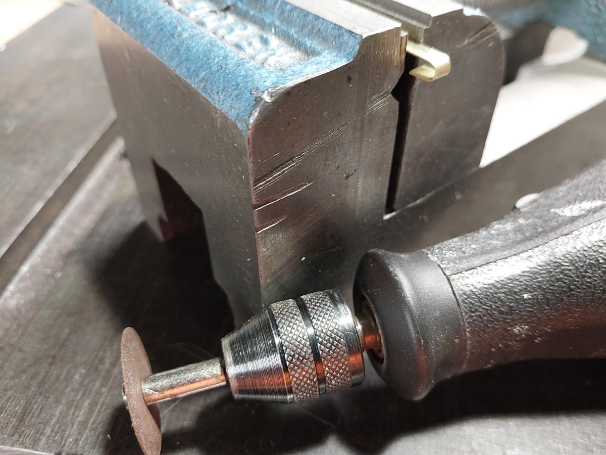

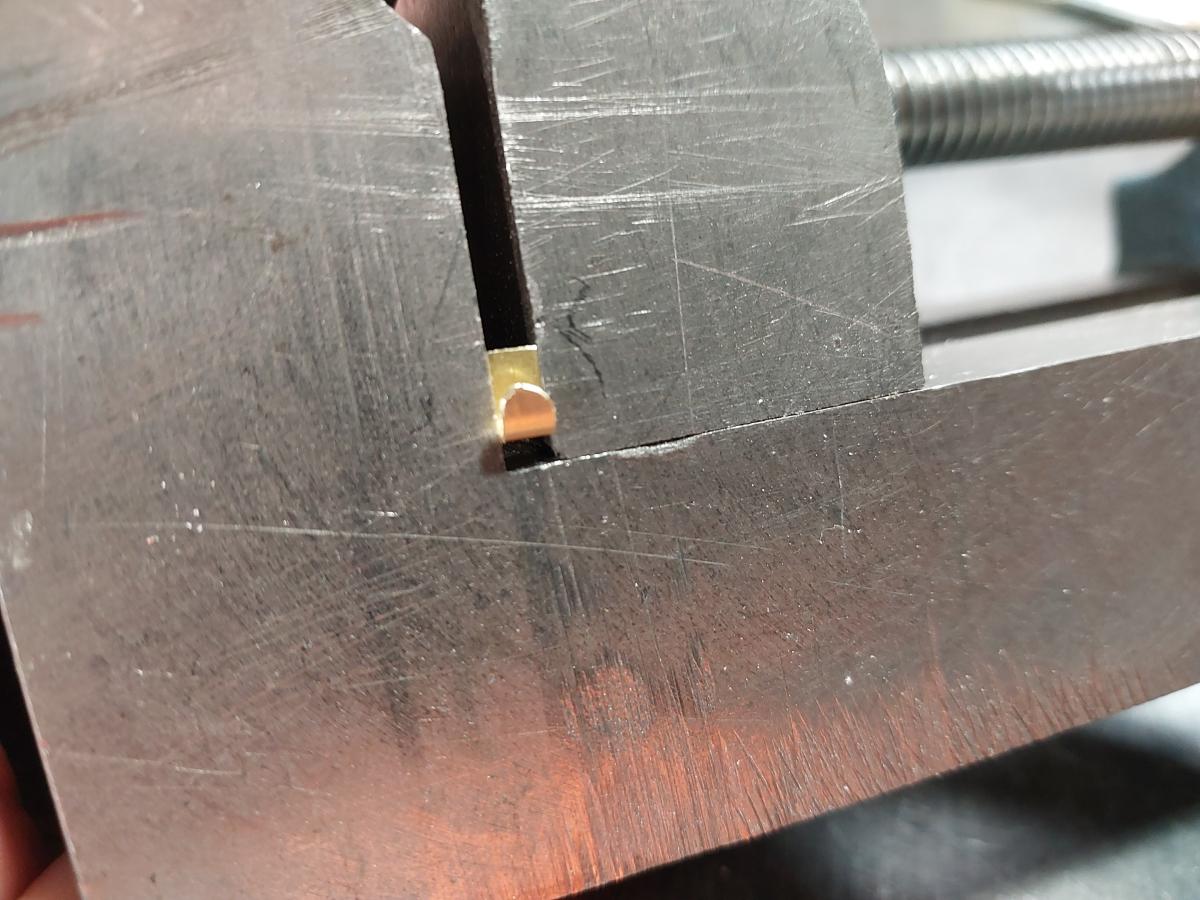

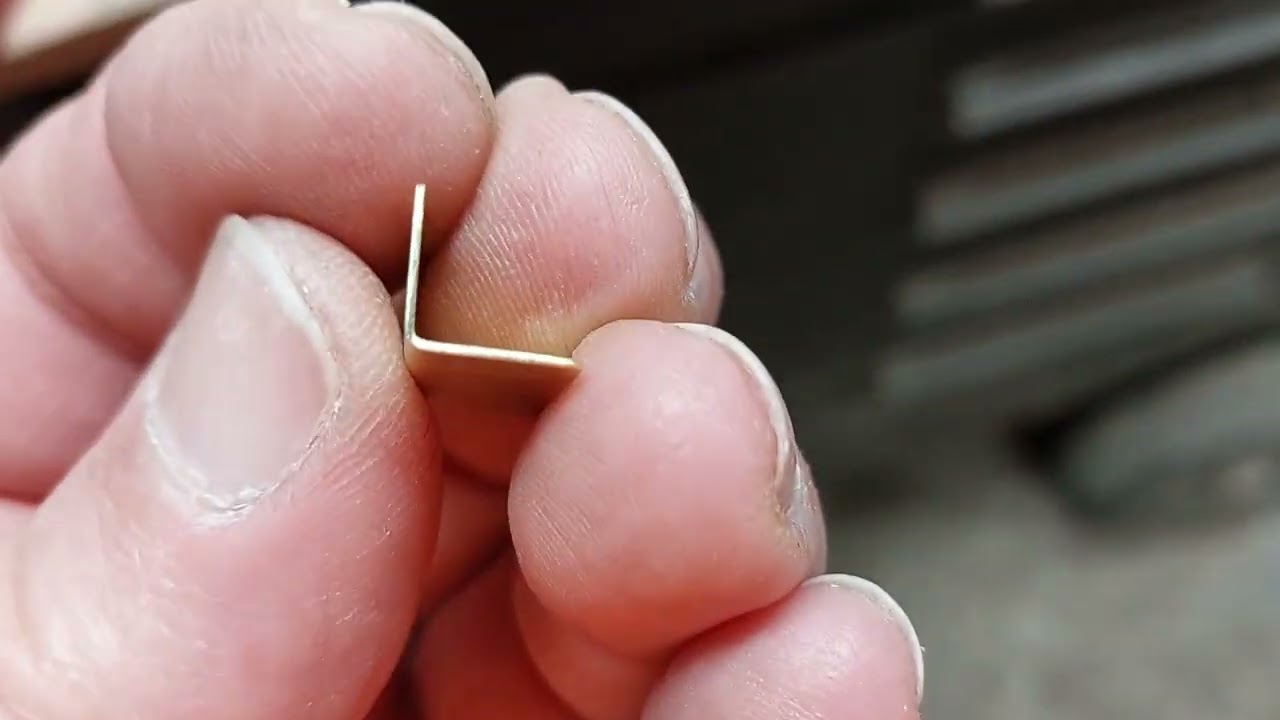

                          Next, it's held in a small vise and it's cut off of the brass strip. Then I held it on the side of the vise, and rounded the short end of the bracket. After finishing the first bracket, I made the second one.
                          I used a drum sanding bit in the Dremel to round the corner of the bracket.
                          Short video of the finished bracket.
                          Now as I mentioned, repeat, and now there's two!!!
                          How sweet is that???

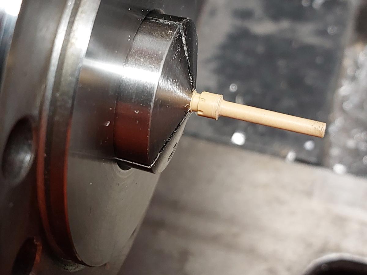

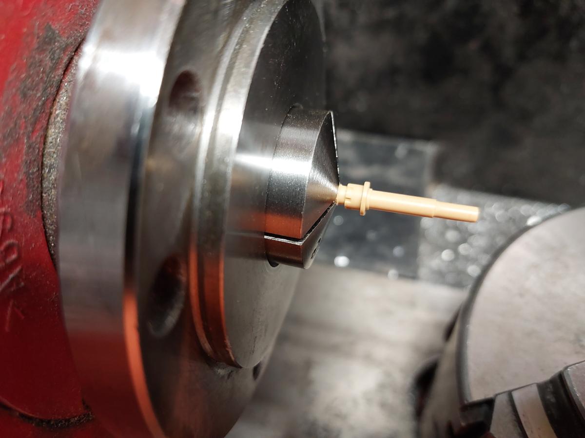

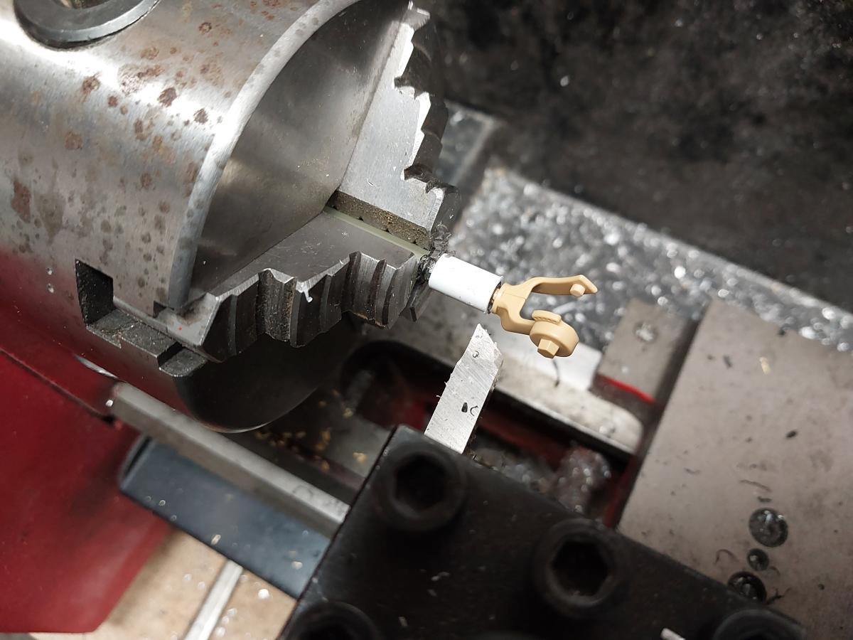

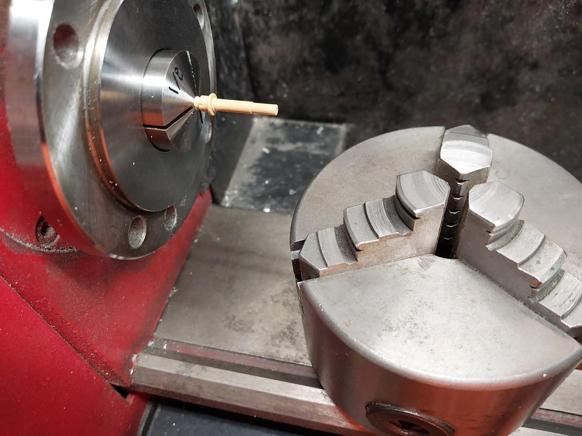

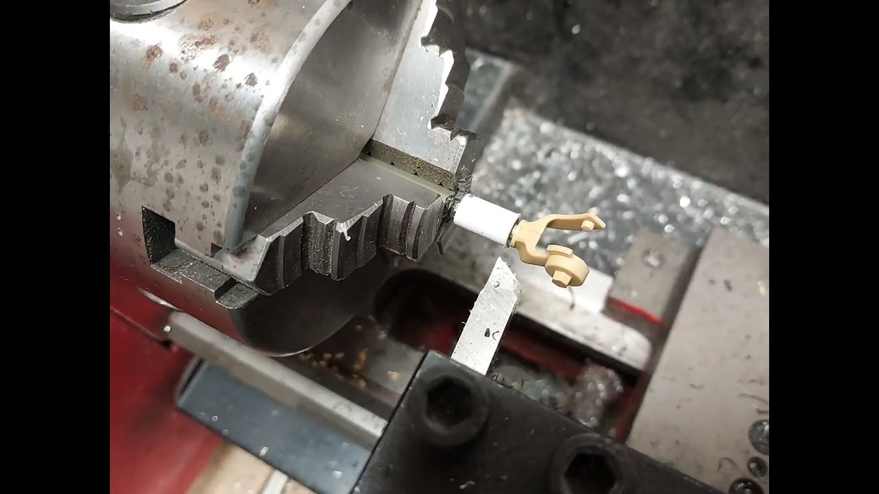

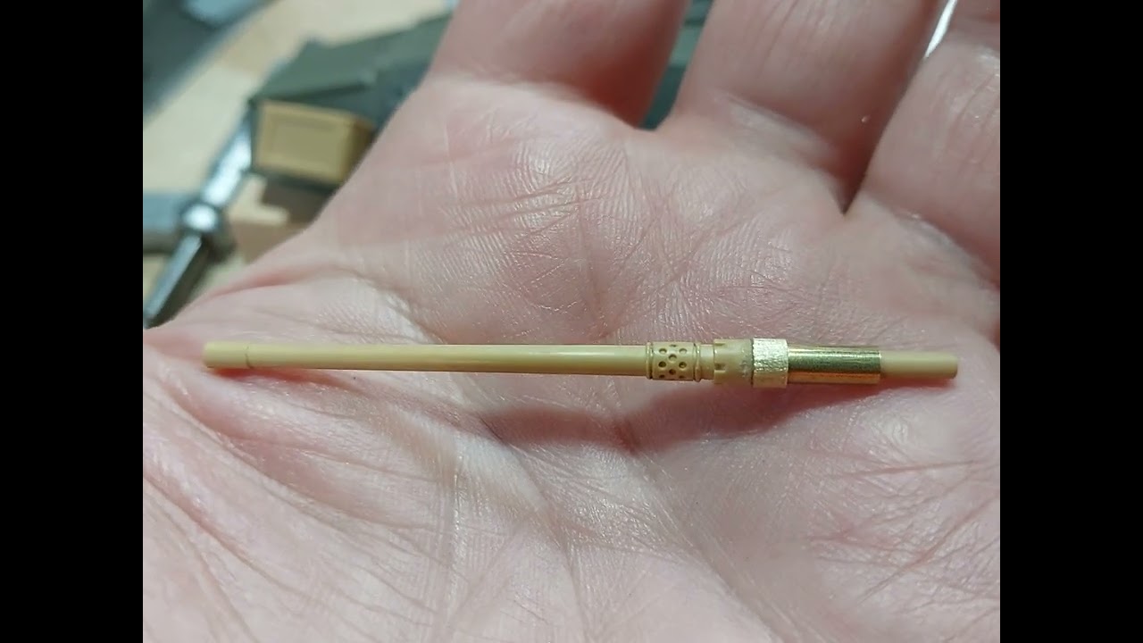

                                  Here are a few mods I performed on the Tamiya 50cal gun barrel. I removed the 3 jaw chuck from my Harbor Freight Hobby sized Lathe, and I used a 1/8" collet to hold the barrel to turn off the flange, and file/sand down the end that fits into the gun body, so I can build it up with two pieces of brass tubing.
                                  Short video.

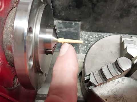

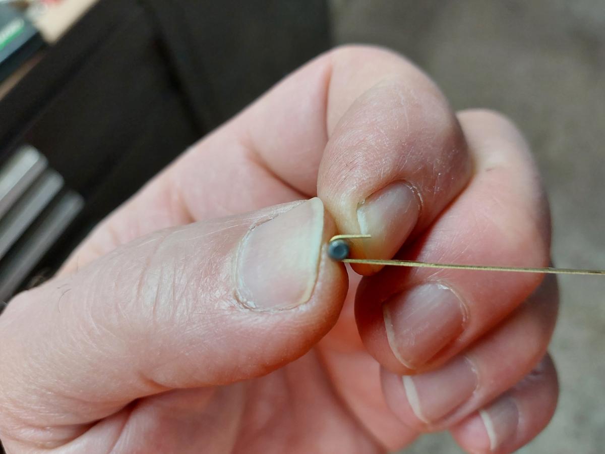

                                  Here the flange removed, and the end diameter has been reduced to 3/32" to add a short piece of 1/8" OD brass tube, and then a shorter piece of 5/32 OD brass tube.

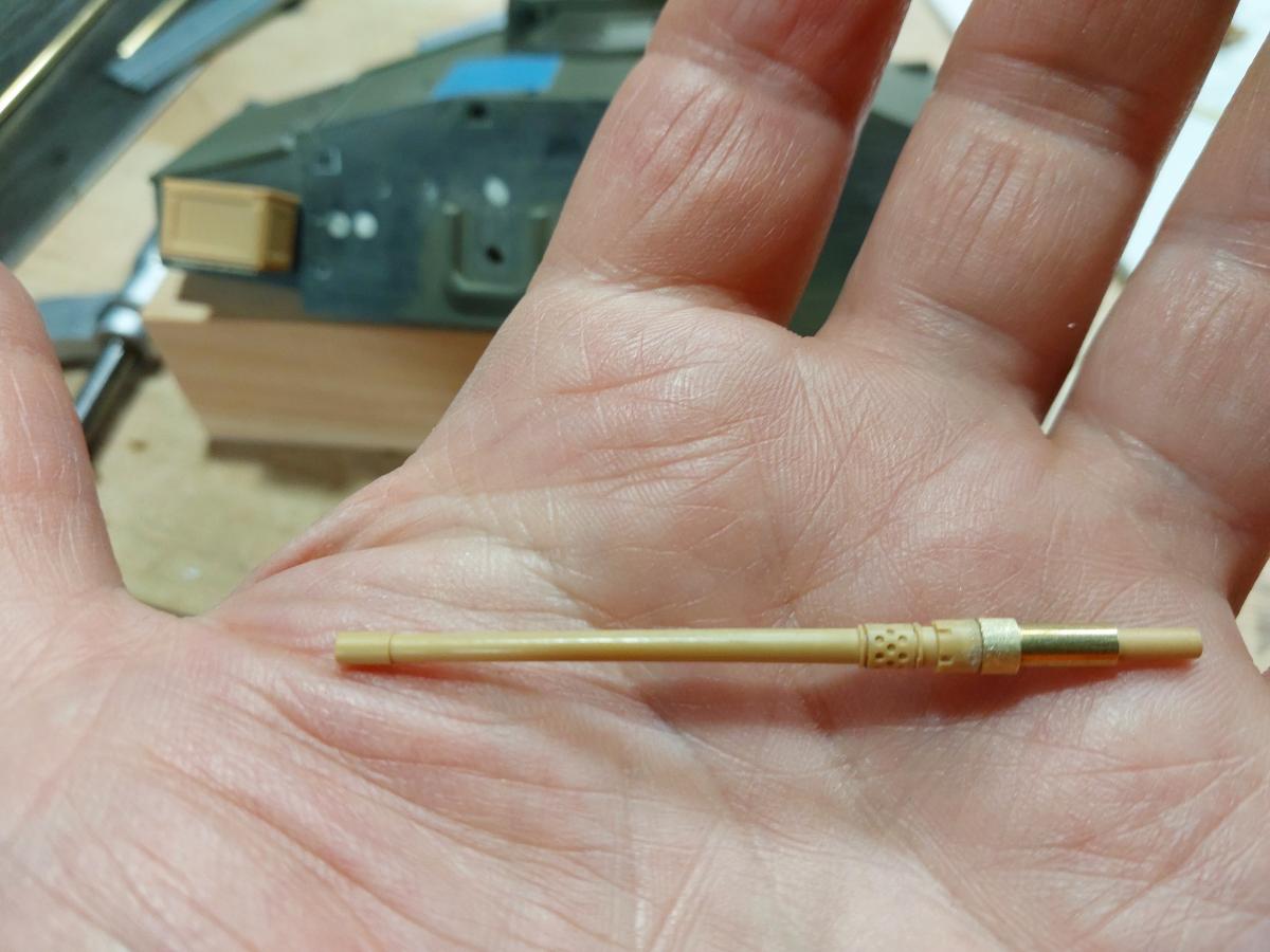

                                  Here's the 50cal gun barrel mod completed.
                                  Short video.

                                    Next, finally after reviewing images, I decided to plug the hole of the Tongde part that supports the 50 BMG gun body in stowage mode, and to relocate where the modified part will be attached to the side of the turret.

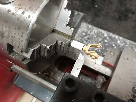

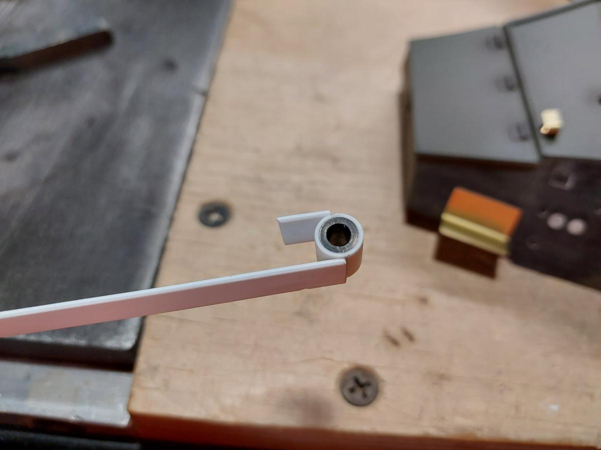

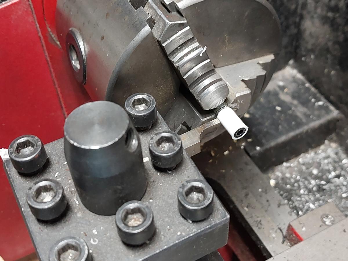

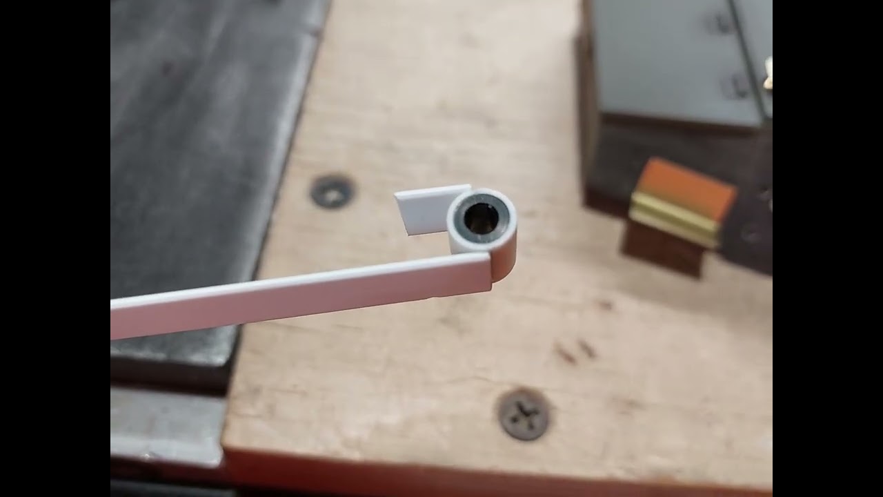

                                      Next up, I began to scratch build the part the 50 BMG Yoke fits into in stowage mode. I wanted the OD of the new part to be the same size as the tripod gun mount. I turned down a piece of sprue, so I can attach a piece of 1/4' OD styrene tube. Then I drilled the hole for the yoke.
                                      Short video, but after I drilled the hole the piece of styrene to my surprise melted because of the friction at the speed I chose to run the spindle. I wish I could've caught that on video!!! Sometimes things don't go as we hoped, or thought they would!!! LOLLLLL!!!!!!!!!
                                      OK, here's an image and a video with the styrene tube glued onto the second try of making this part. Also the yoke is fitted into the hole.
                                      Now I can cut off the part.
                                      Short video, which part looks best to you?

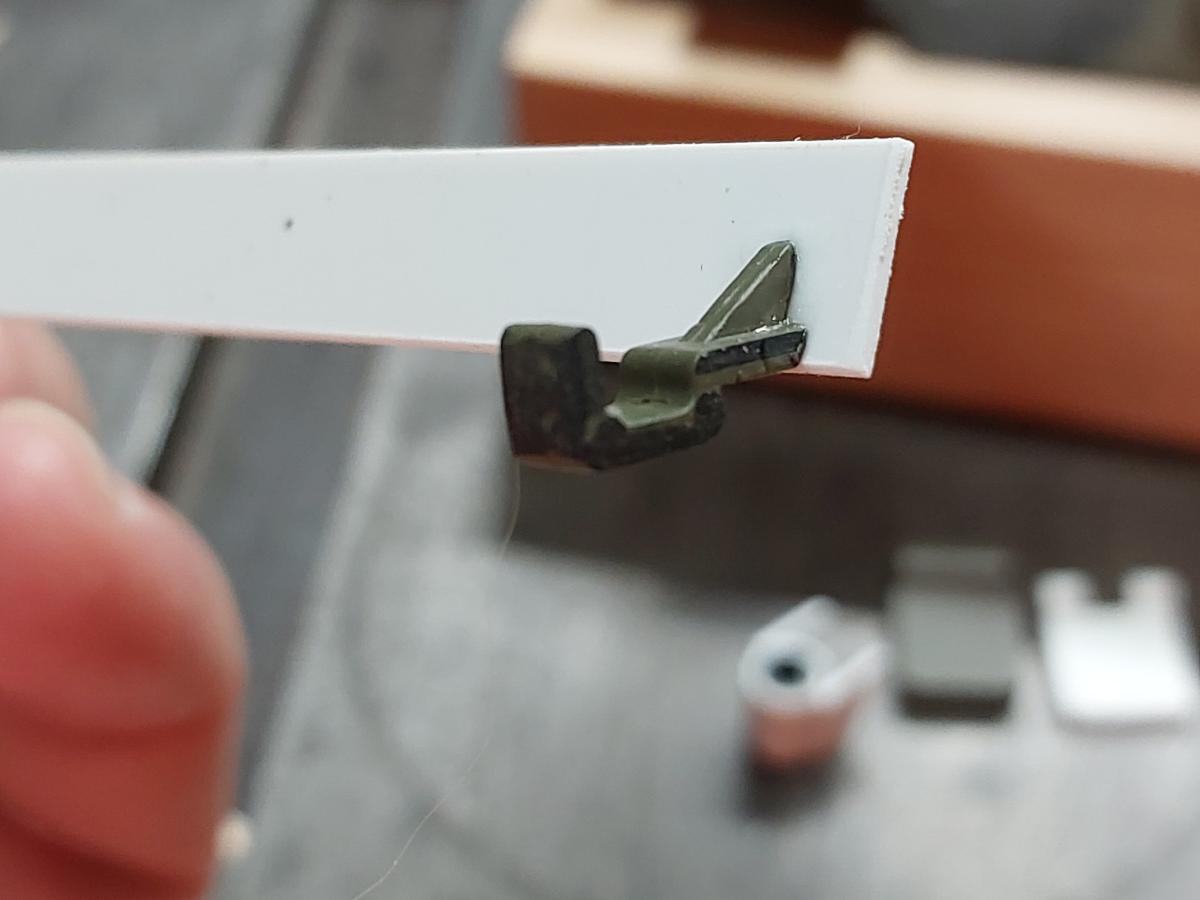

                                        These next few posts are from the 4th of July after our cookout and between the fireworks while I had some time to wait!!! I started to finish the part I made in the lathe in the last post.
                                        Short video:

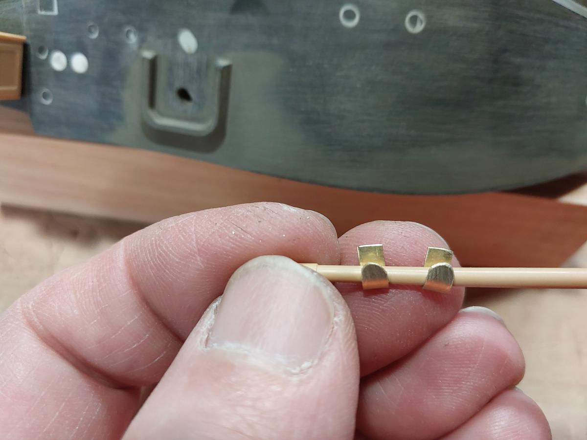

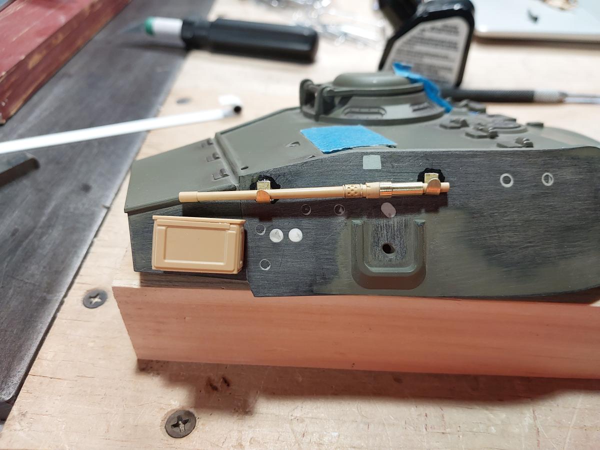

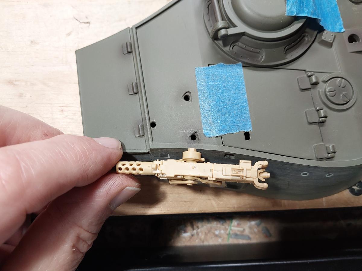

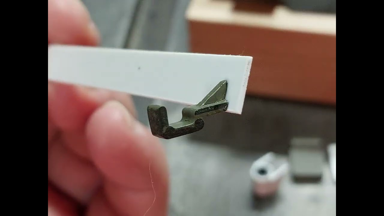

                                        While the glue dried on that part, I glued on the two brass gun barrel brackets I made a couple of days ago. The images shows the room between the muzzle of the 50cal barrel, and the ammo box.
                                        • rb67mustang

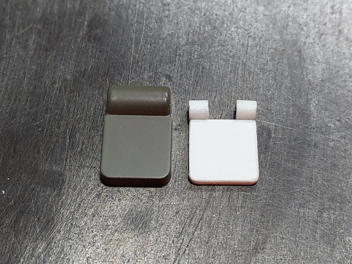

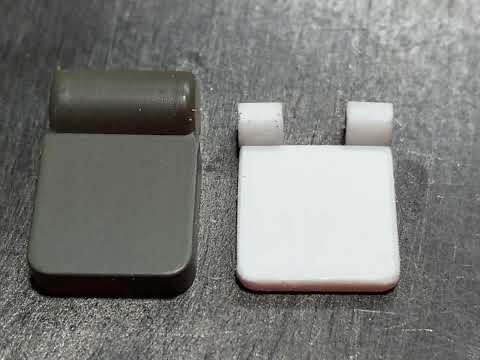

                                          Next, I began to scratch build a new Pistol Port Door out of 1/16" sheet styrene, and a few short pieces of 1/8" OD styrene rod.
                                          Short video:
                                          Here's another video explaining the trouble I had cutting the three short pieces of 1/8" styrene rod.
                                          Yes, I was bouncing around a bit last night as I was working on these parts!!! LOLLLLL!!!!!

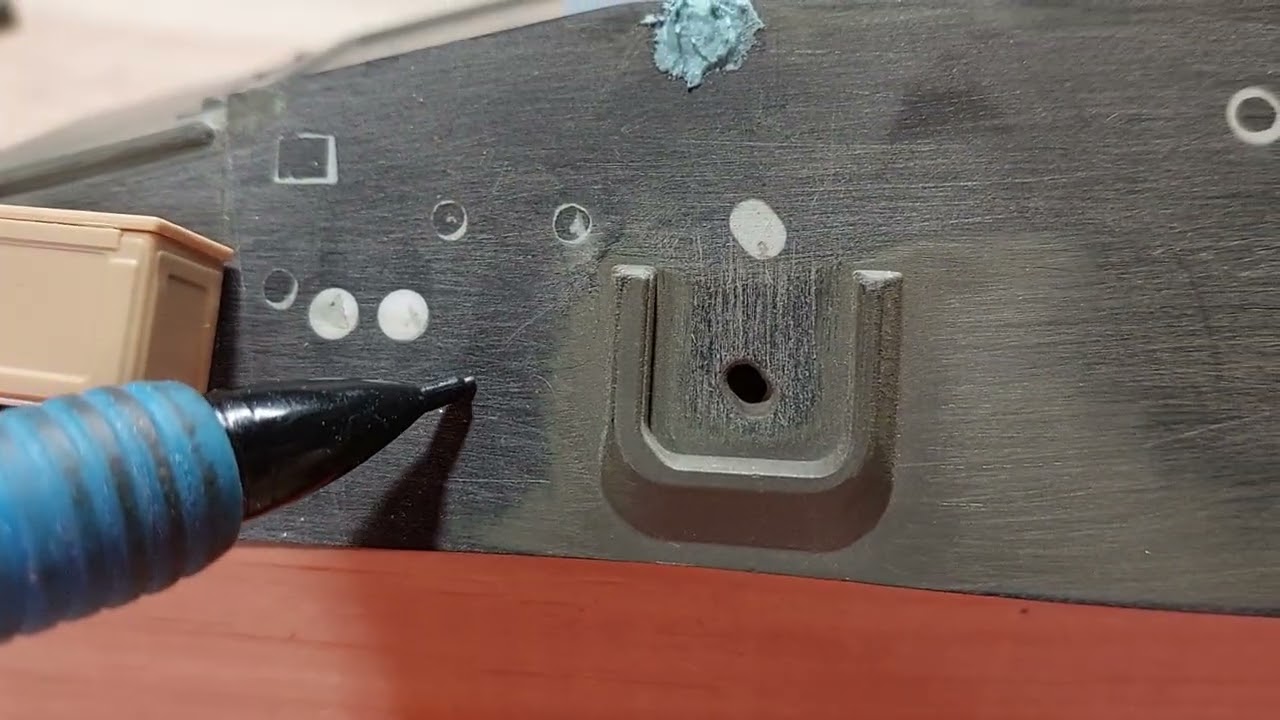

                                          Finally, I started to modify the 50 BMG support bracket. I sanded the mounting surface of the angle of the turret, and I glued it onto a strip of .020" thick styrene sheet.
                                          Short video:
