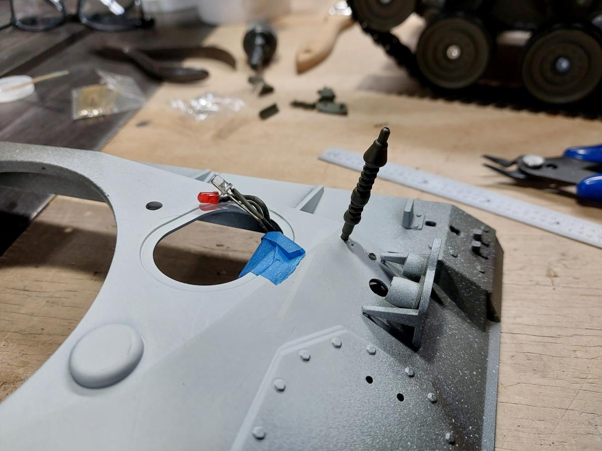

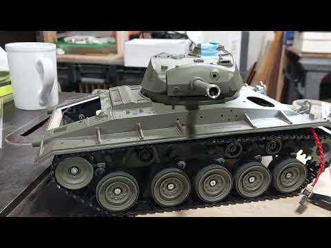

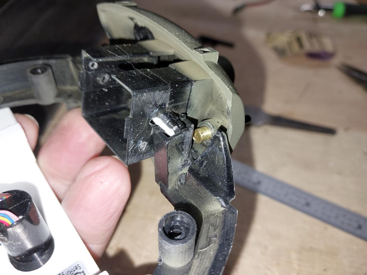

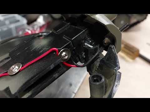

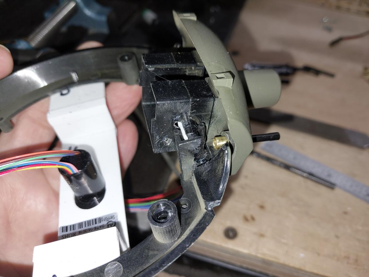

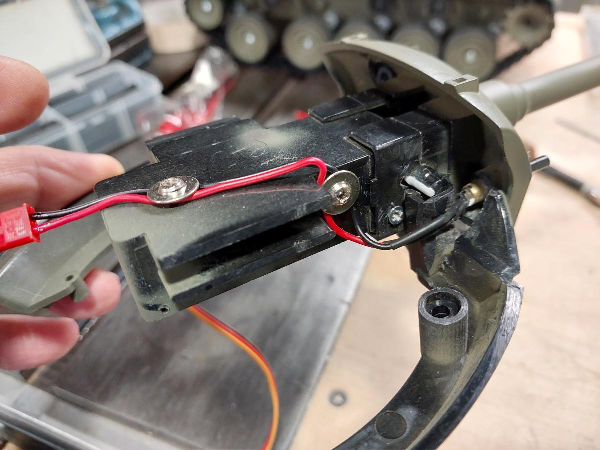

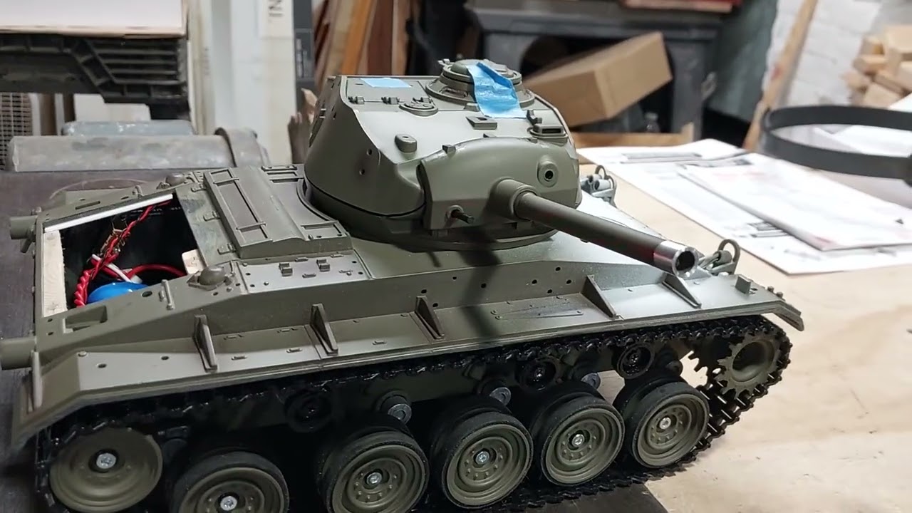

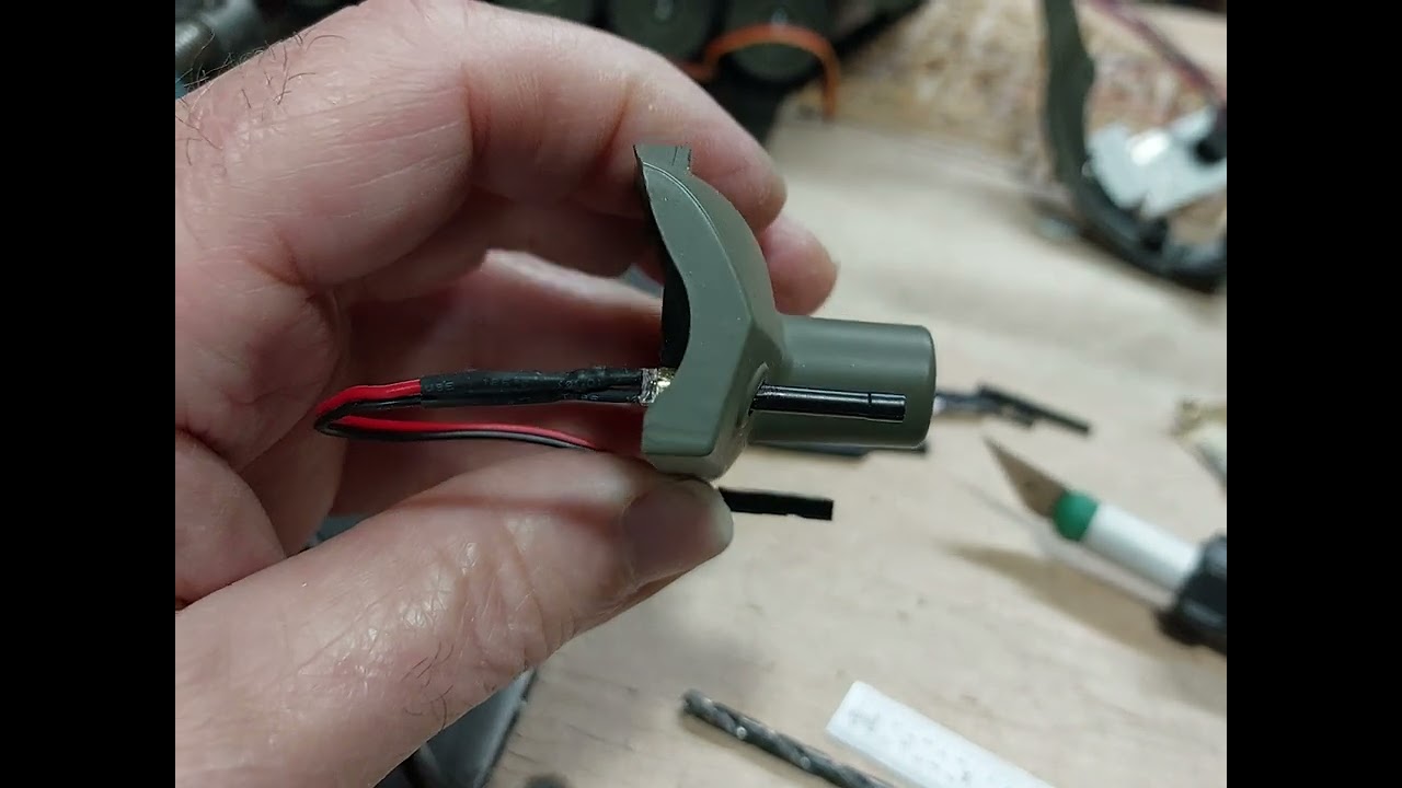

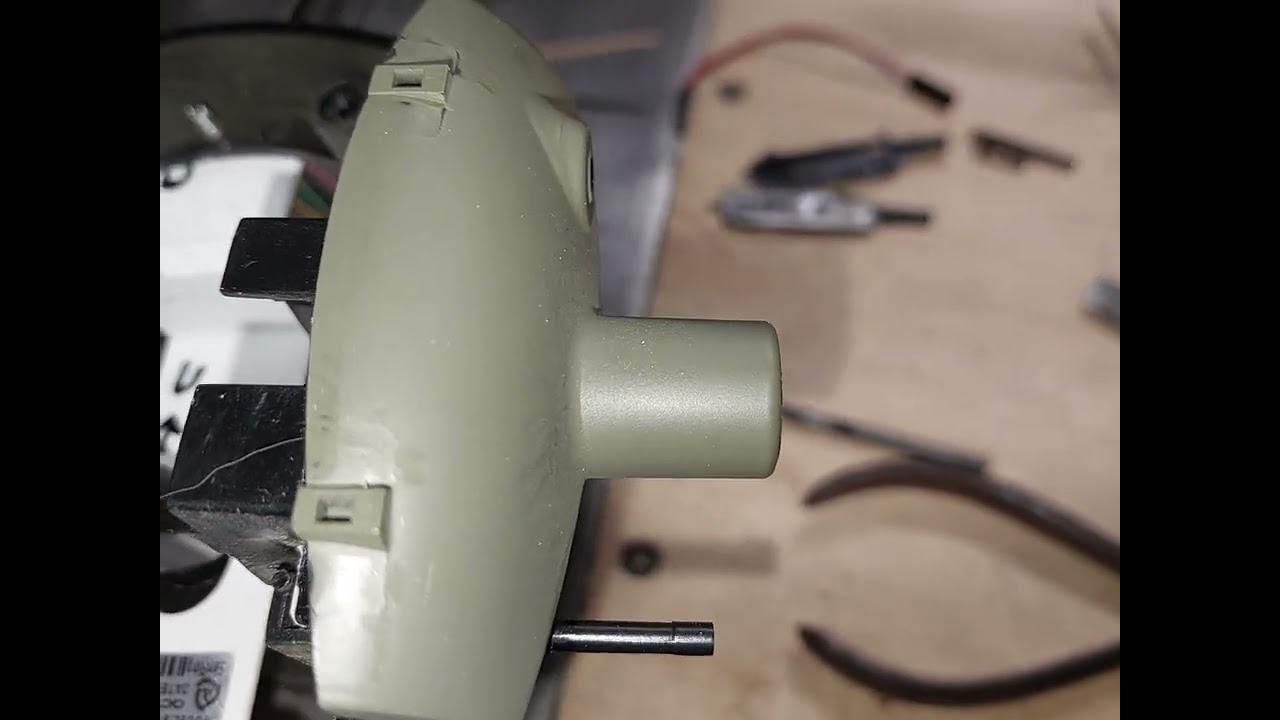

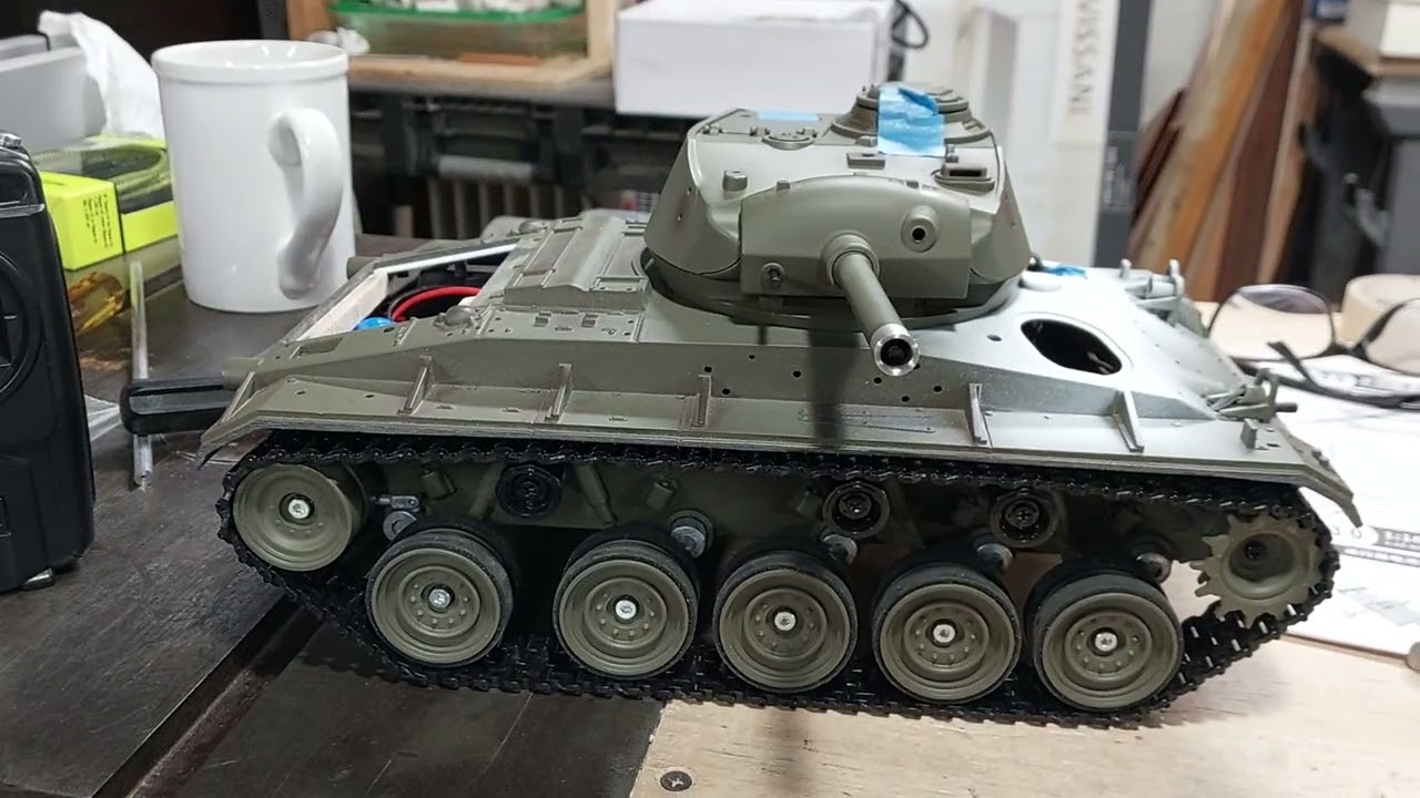

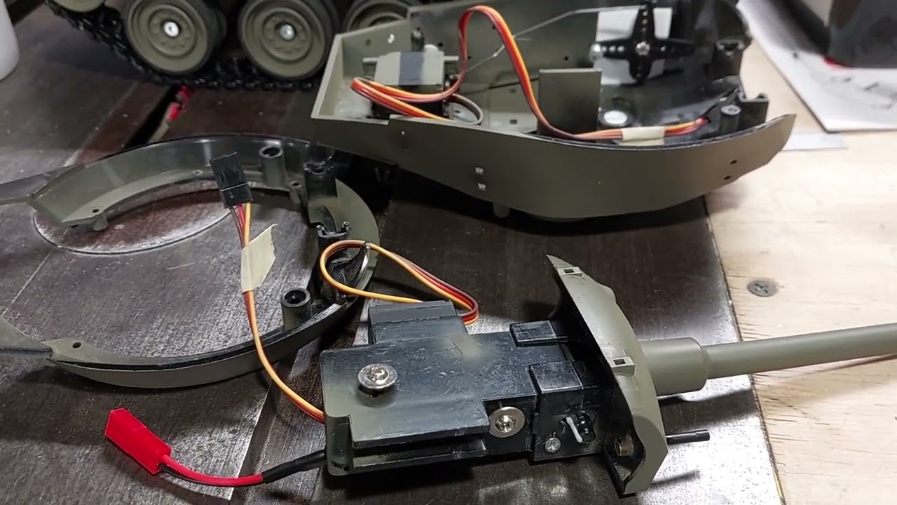

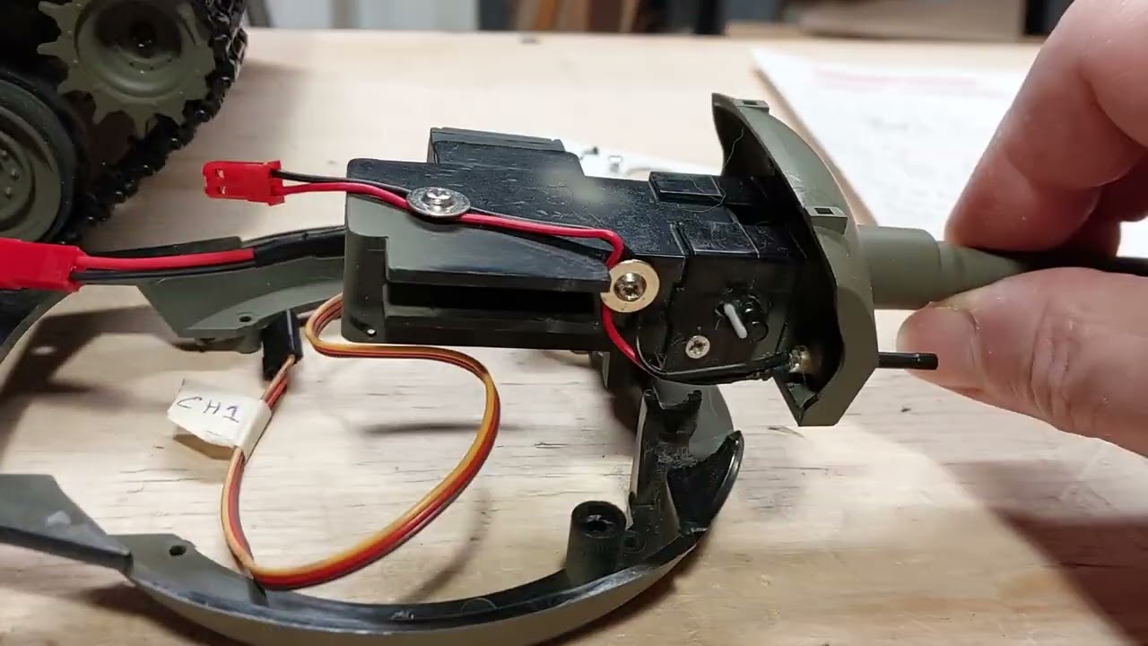

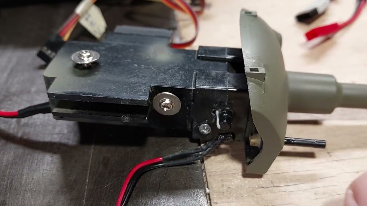

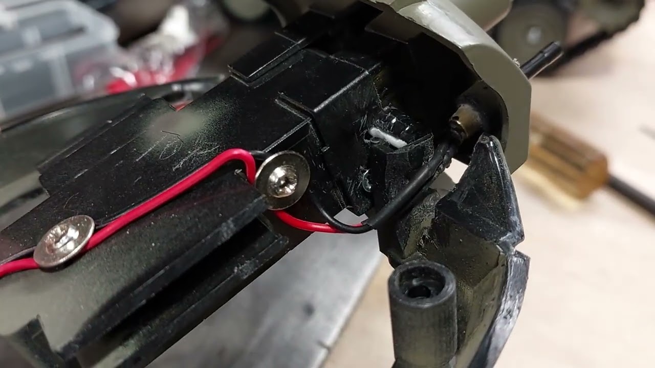

    I shortened the tube & gun barrel, and here's a short video.
    I still didn't have much room for the LED wires. So, I removed the corner from the gun pivot post, and I widened the slit where the wires will be routed, and I even used a round needle file to make a groove on the side of the gun pivot post. I'm happy that there's room for the machine gun modification to work.

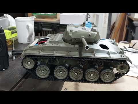

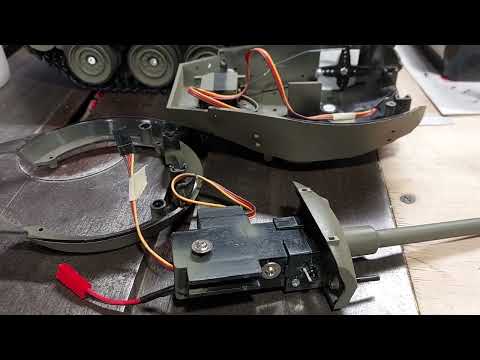

      I glued the mantlet machine gun assembly into place, and it looks straight and parallel with the main gun. All I have to do now is to glue the LED in Place and route the wire so it's not in the way of anything, and maybe even attach the wire onto the side of the gun body. That will get gone after all the wires from the slipring are connected to the LED's and servos in the turret.
      Here's the second video I mentioned.
      More progress to follow!!!

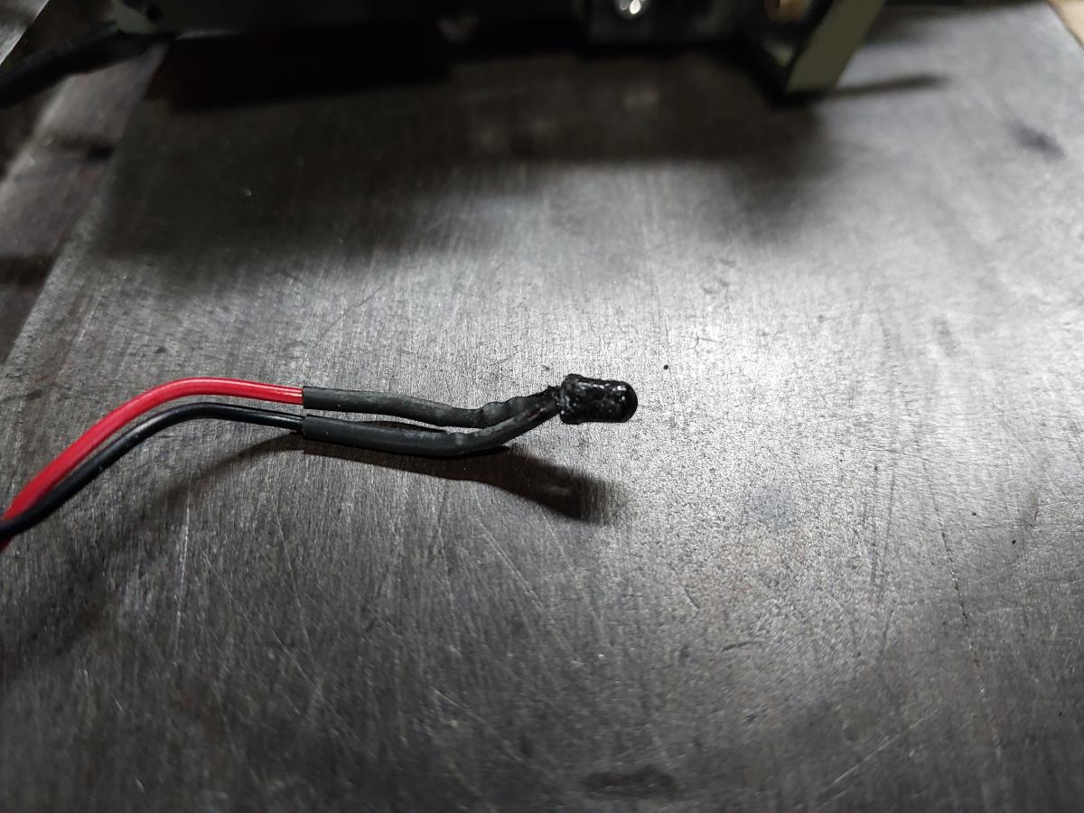

              Today was a do nothing day. I paid the bills and went food shopping. I had destroyed the main gun flash LED as I tried to remove it. I planned to turn down the oversized muzzle ring, and I didn't want the wire in the gun barrel. And like most RC Tanks, the M24's LED's were painted over. It was easy enough to clean the paint off of the head light and tail lights, but the gun flash LED was tough to clean.
              So, I looked on Motion RC thinking to find the flash LED with the cord, but all they had were replacement LED bulbs. So, knowing I'm not going to do IR Battle, I searched Evil Bay, and I found what I wanted at a good price, so I ordered two of them for less than the cost of one LED at Motion RC. I also got some short servo extensions so I can solder female ends on the turret end of the slip ring. The two LED's in my turret will also have male connectors soldered to them with the female connector soldered to the slip ring wires.

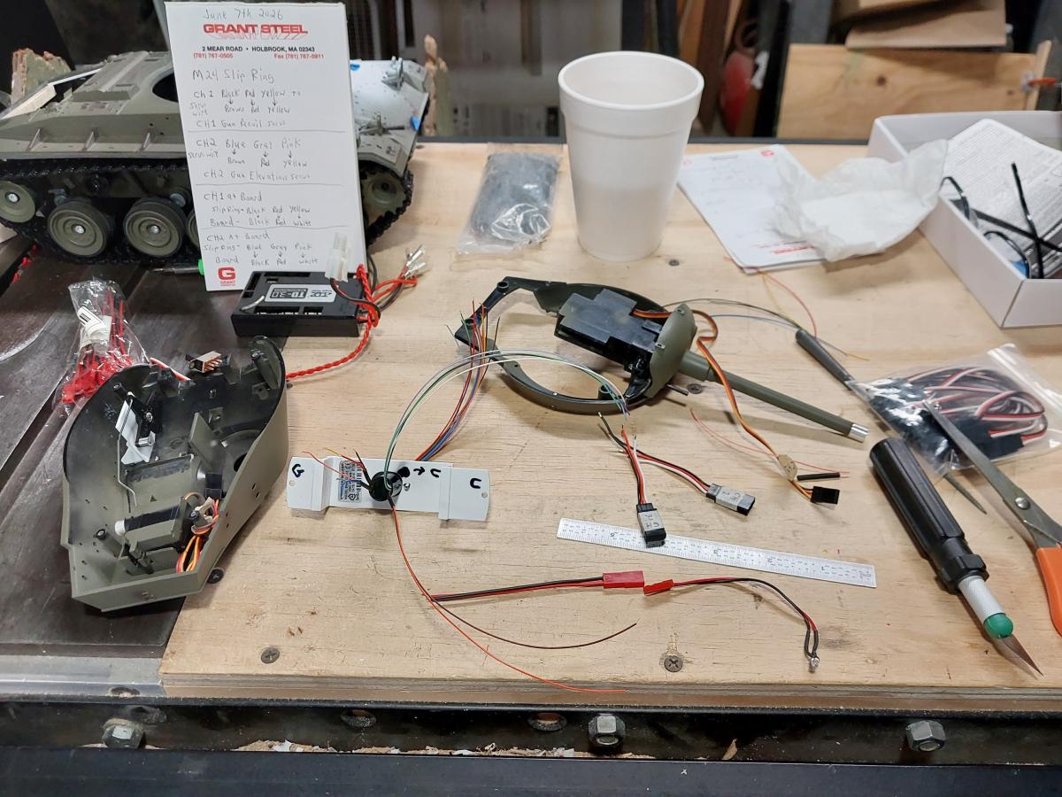

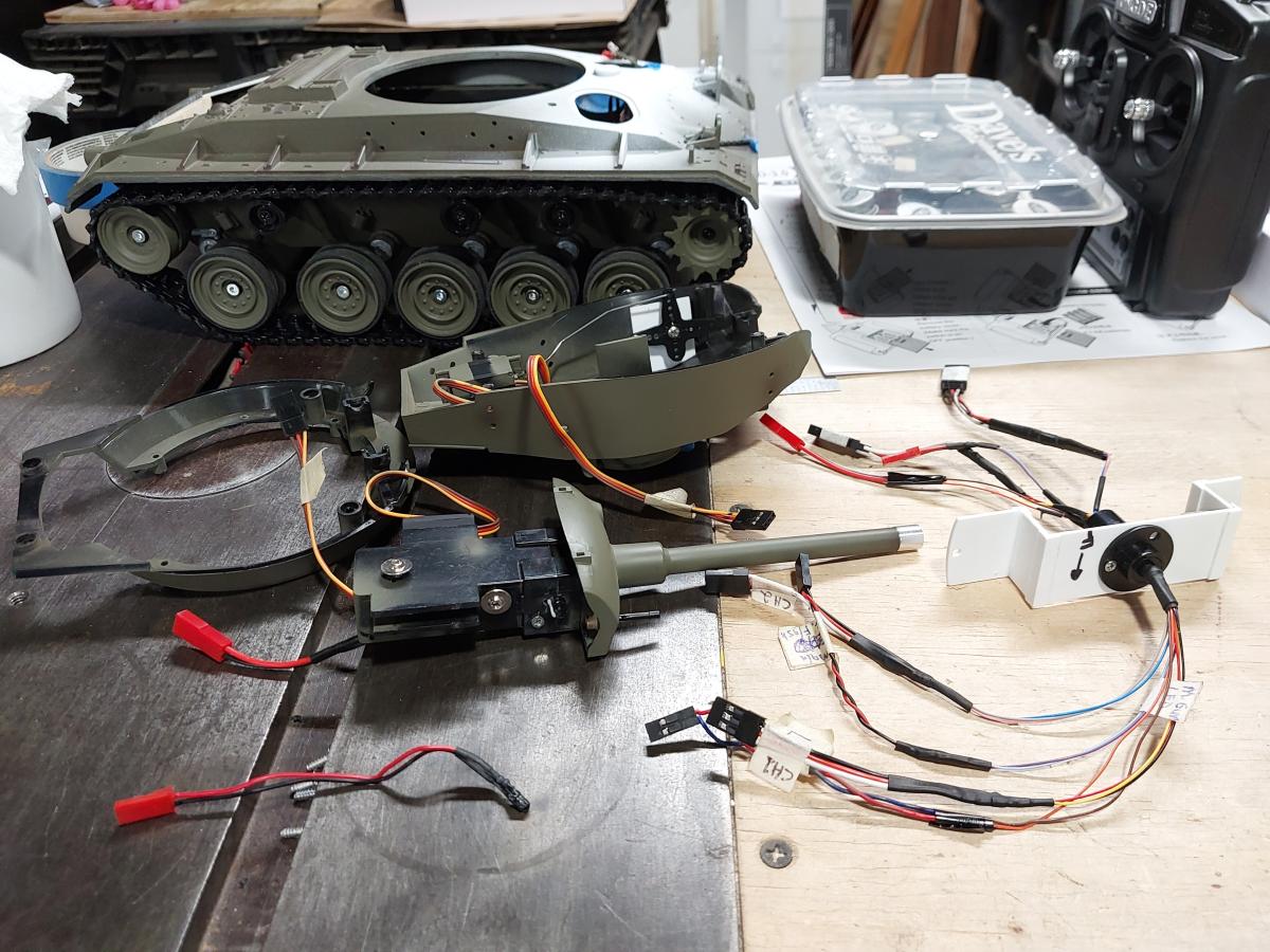

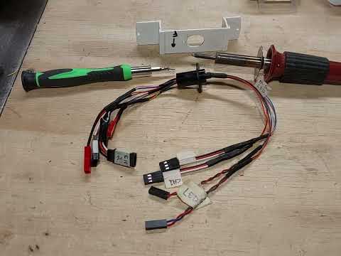

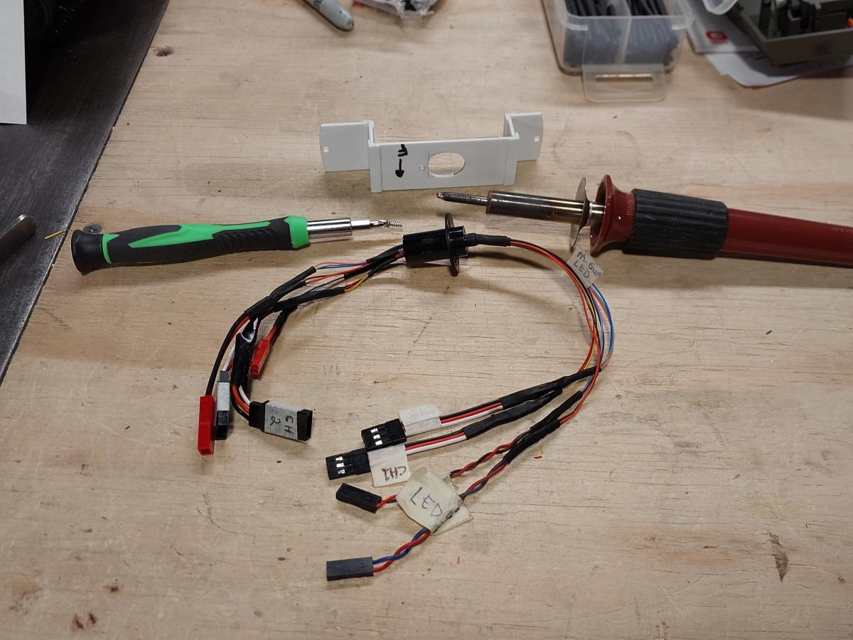

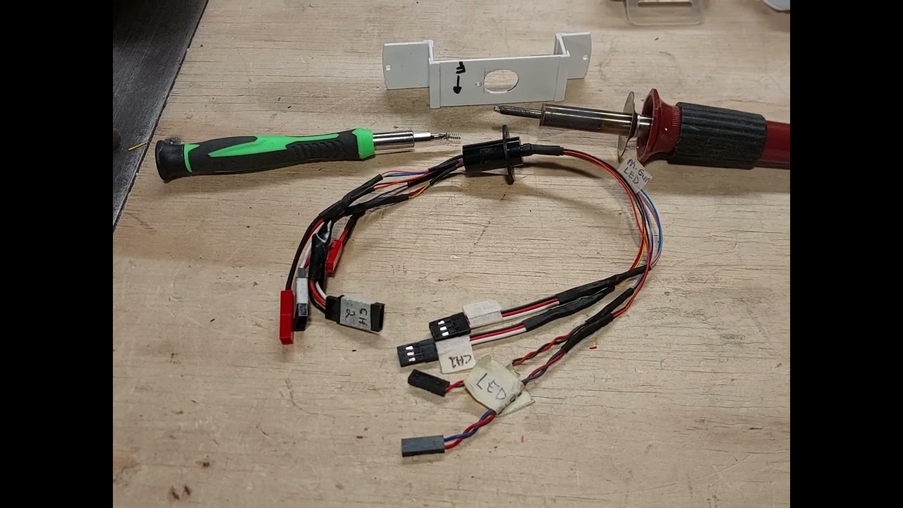

                It's been a while since I posted some progress on my build. I'm not geared up to do soldering especially on small wires. I took my time, and the slipring wiring harness came out ok except I crossed two wires on the turret side of CH2 (Gun Elevation), it was an easy fix. The Mantlet LED is temperamental, sometimes it works and sometimes it doesn't. After the two issues I ran into, I realize that continuity testing should be done instead of traditional assembled/wired testing; it's quick & easy, and possible mistakes are found and corrected. But, the Mantlet MG LED's continuity test was OK, and the LED tests OK as well, yet sometimes it doesn't work!!! OK, enough talk!!!
                Click image for larger version  Name:	20260607_120847.jpg Views:	0 Size:	160.9 KB ID:	449984
                I was able to switch the wire connector end with the type I had in stock; it saved me from soldering a new end onto the wire making it a neater fix.
                Click image for larger version  Name:	20260607_133939.jpg Views:	0 Size:	112.4 KB ID:	449985
                Here's a short video of the beginning of the slipring wiring job. This wiring progress took place on June 7th.

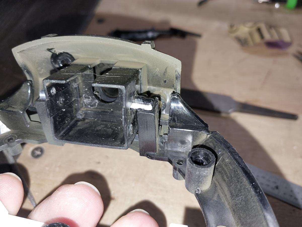

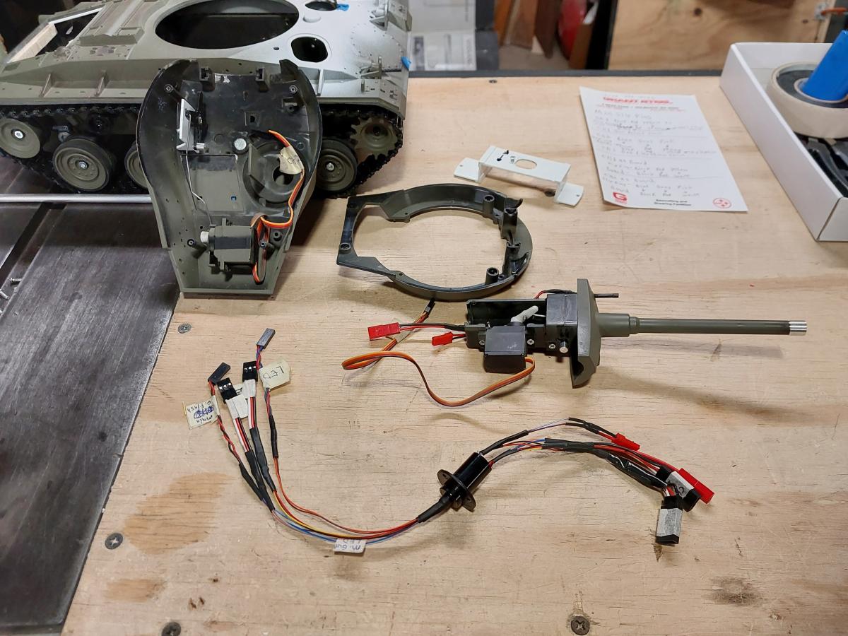

                  The slipring wiring progress progressed slowly as I mentioned. The slipring wiring harness was completed on June 11th.
                  Click image for larger version  Name:	20260611_135350.jpg Views:	0 Size:	132.3 KB ID:	449987
                  Here's a video about the slipring, and what I'll be doing to the turret after everything is working properly. At this point, I didn't know I had a couple miss matched wires on servo CH2.

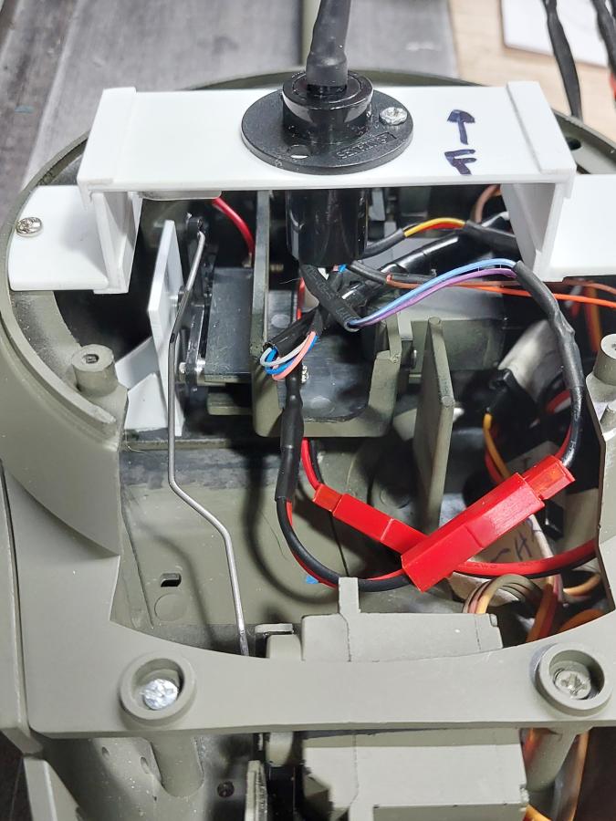

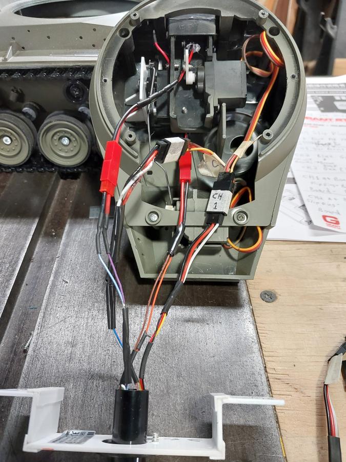

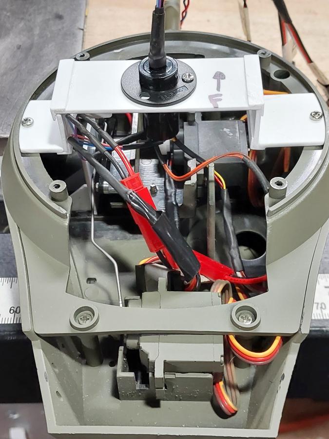

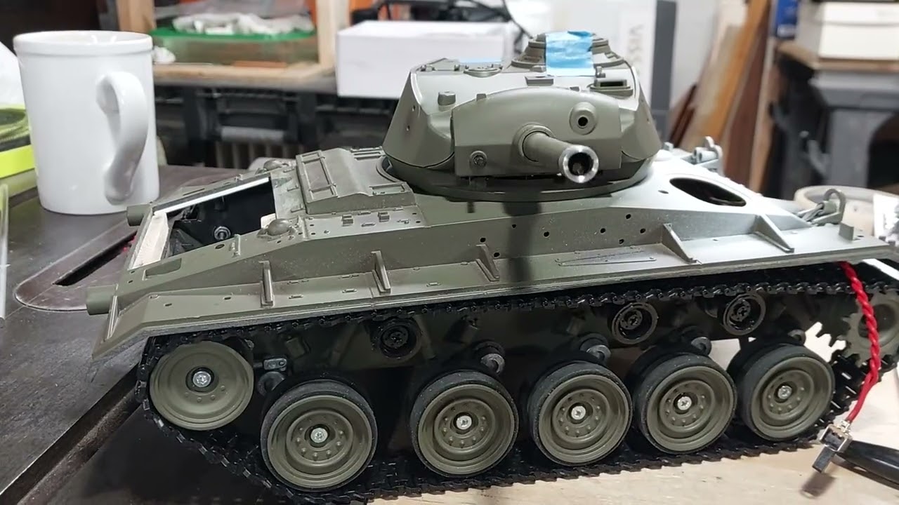

                    Next up was live testing of all the turret functions. This is when I realized I had a couple of issues with the wiring. CH2 Servo wire was an easy fix. The testing was performed on June 16th.
                    Click image for larger version  Name:	20260616_114039.jpg Views:	0 Size:	156.0 KB ID:	449990
                    There a lot of wires inside this small turret, but everything fits without any difficulty to the proper functions of the turret.
                    Click image for larger version  Name:	20260616_132349.jpg Views:	0 Size:	88.2 KB ID:	449991

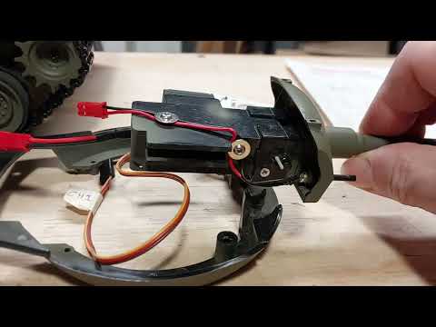

                        OK, I reassembled the turret for another round of live testing. I'm happy to say, everything is working as it should, and I'm very happy!!!
                        Shielded LED MG flash using black paint.

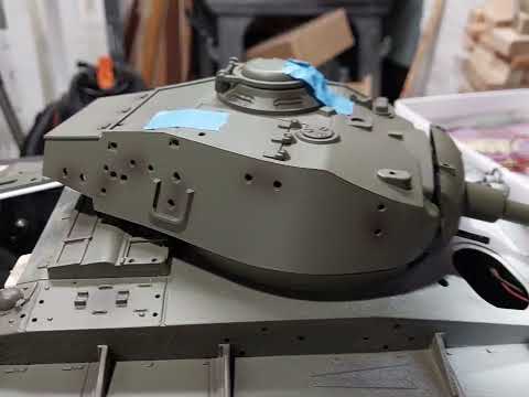

                                    OK, I've been busy the past two days. I couldn't find detailed M24 images I needed to modify the Turret. I watched a short walk around video that I was able to get some screen shots from. And then I watched a Restoration Walk Around video that gave me all the screen shots I needed!!!!!!! I'm a happy Guy!!! Here's the video I'm talking about, BTW, it's the same M24 as the short walk around video I watched.
                                    • rb67mustang
                                      • May 2026
                                      • 290
                                      • People's Republic of Rhode Island
                                      #78

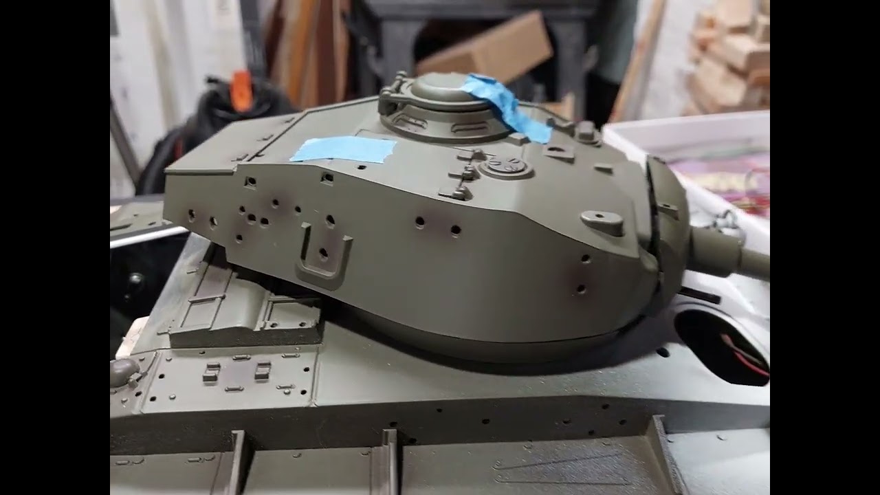

                                      Friday, I plugged almost all of the holes in the turret getting ready for the Mods I decided to do. The antenna that Tongde expects to be attached in front of the gunners position was perfect to plug most of the holes!!! LOLLLLLL!!!!!!!!!!!!!!
                                      Short Video

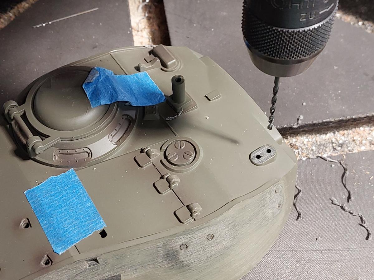

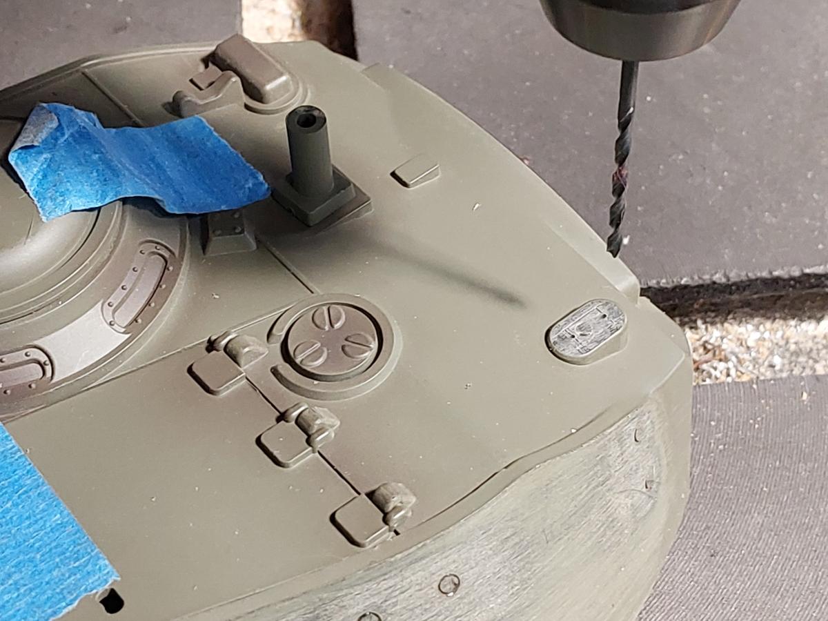

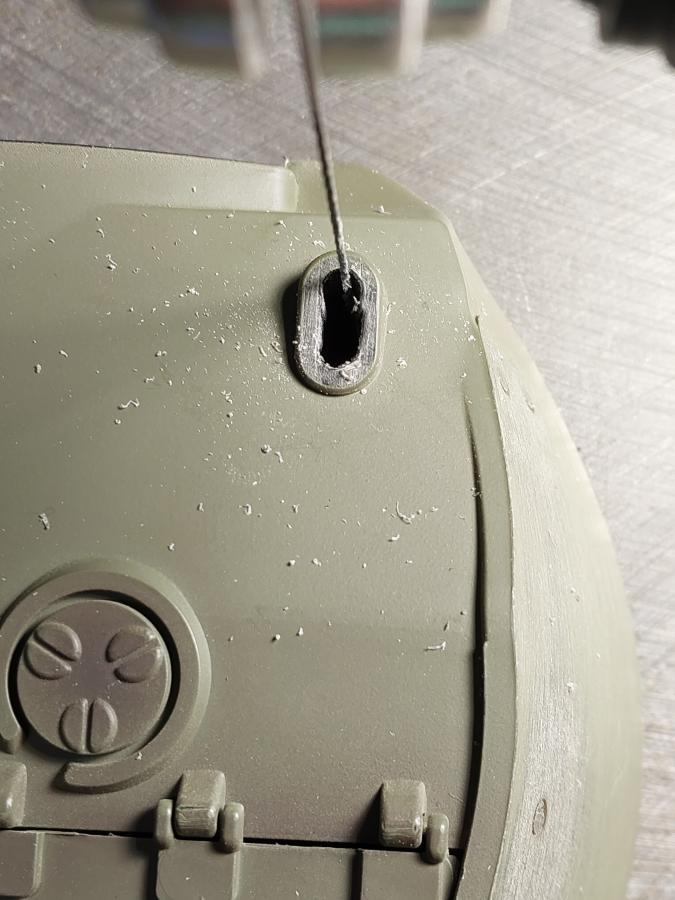

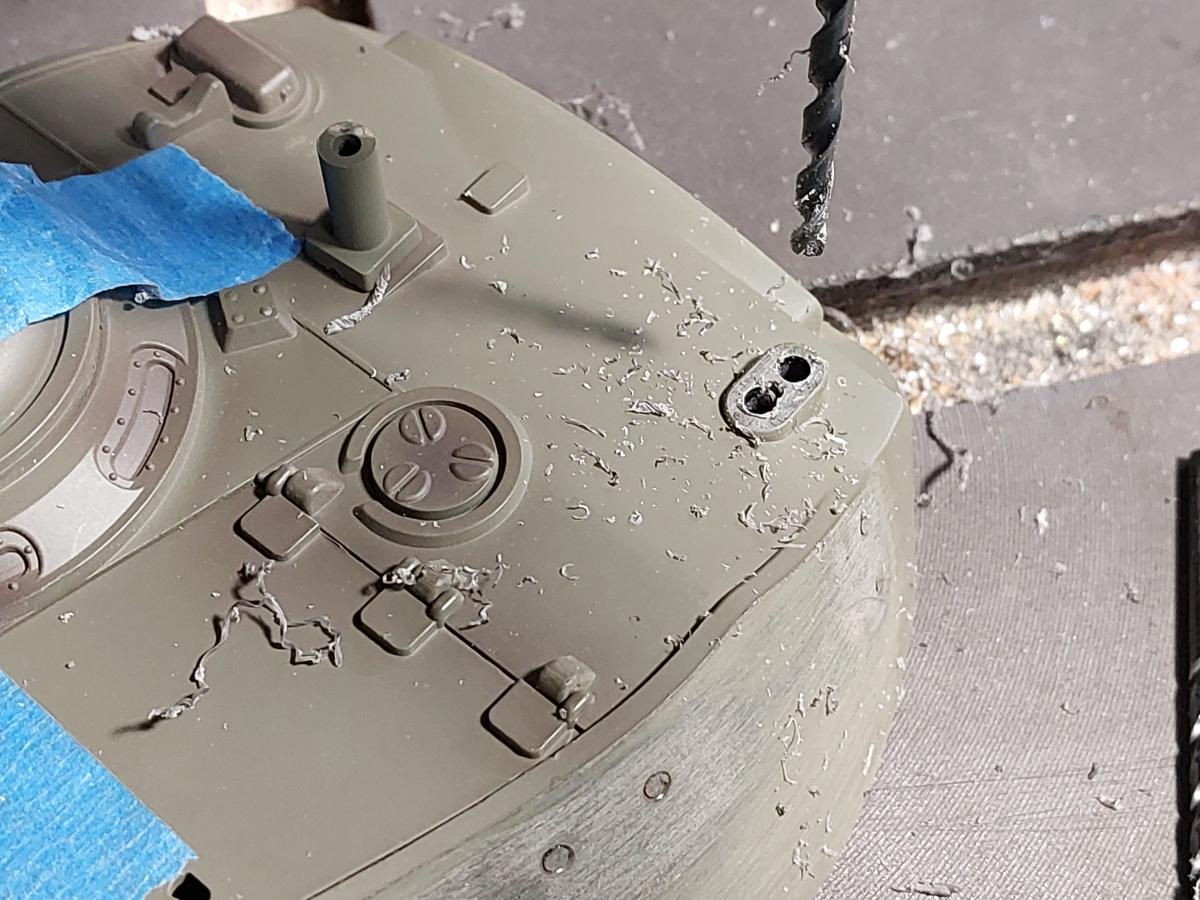

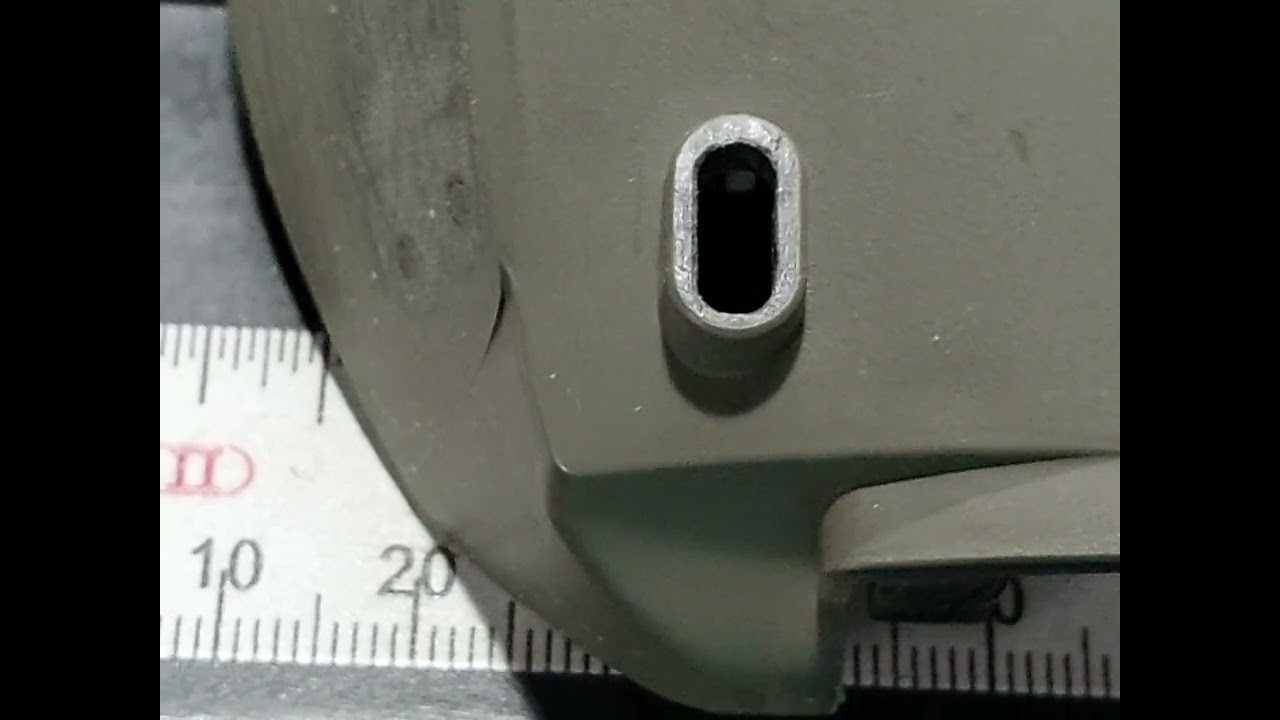

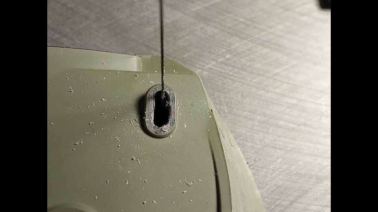

                                        Today, I reviewed the screen shots and I sanded the glued in plugs, and I cut an elongated hole in the turret.
                                        Finished size hole for the slot.
                                        The slot was cut using my Dewalt Scroll Saw.

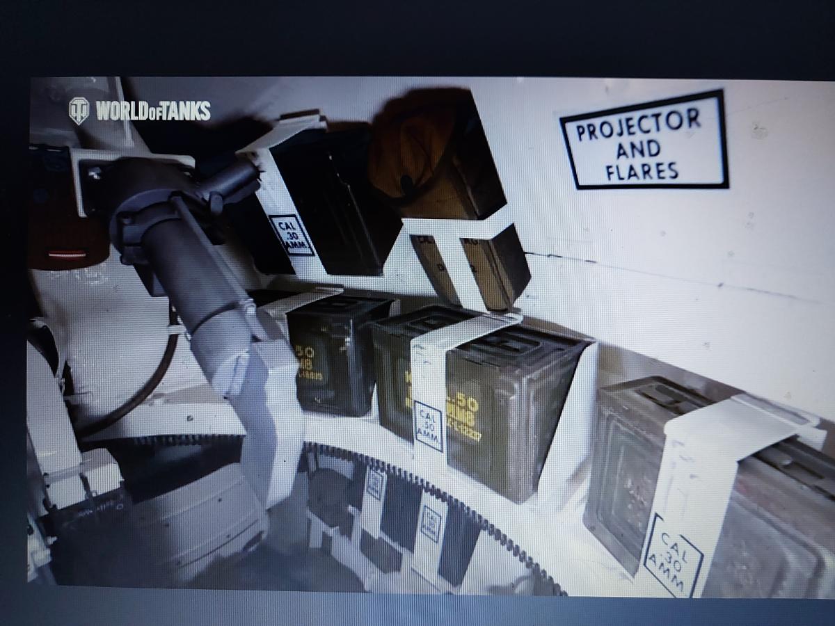

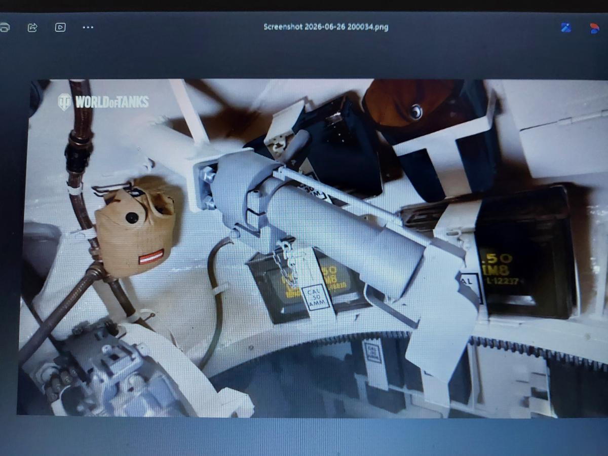

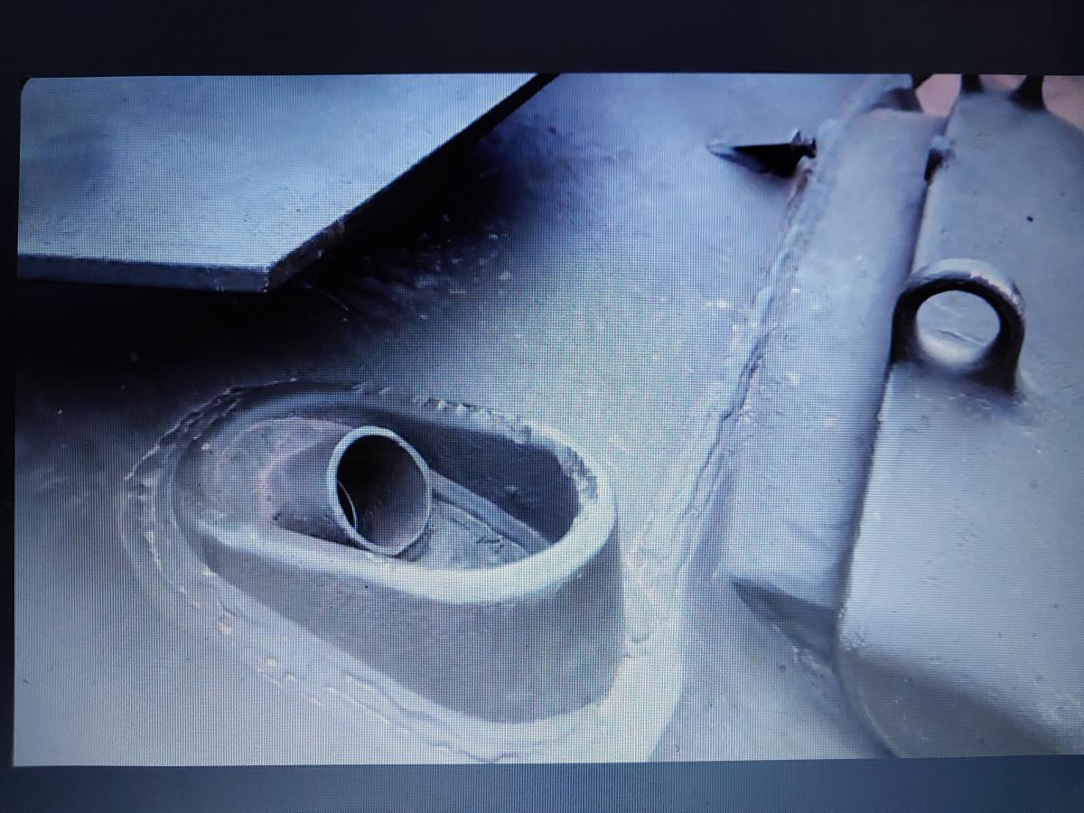

                                          OK, you're thinking what's the slot for??? Well, here's a few screen shots from the World of Tanks Video!!! I knew this boss on the turret had a better purpose that another antenna!!!!!!!!!!!
                                          Here's a couple images from inside the turret.
                                          A lot of tanks were able to fire smoke canisters or flares.
