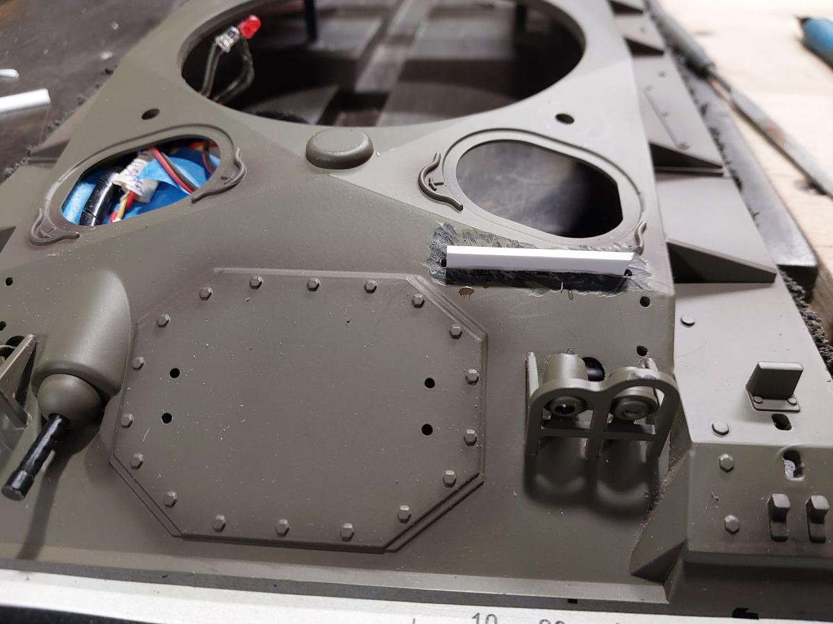

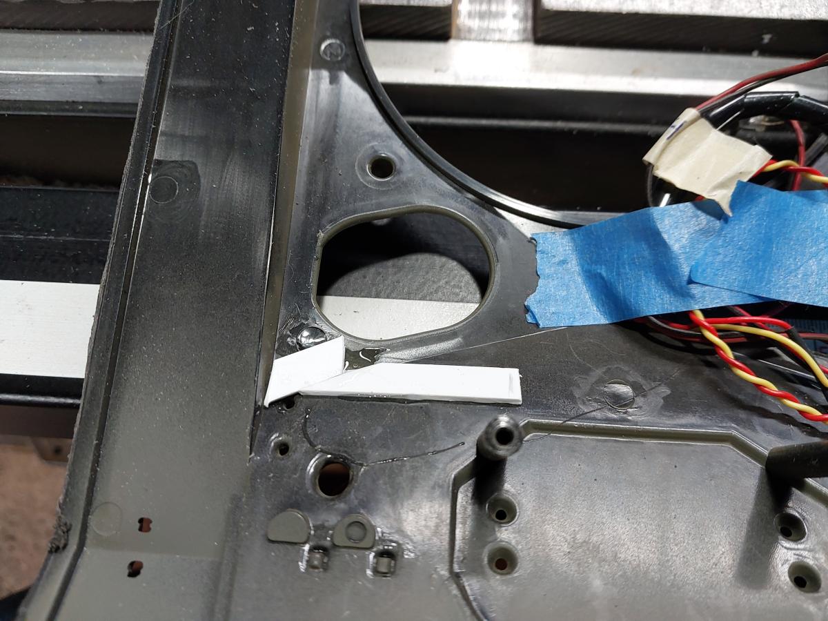

      Here's an image showing the styrene pieces filling the hole.
      The inside

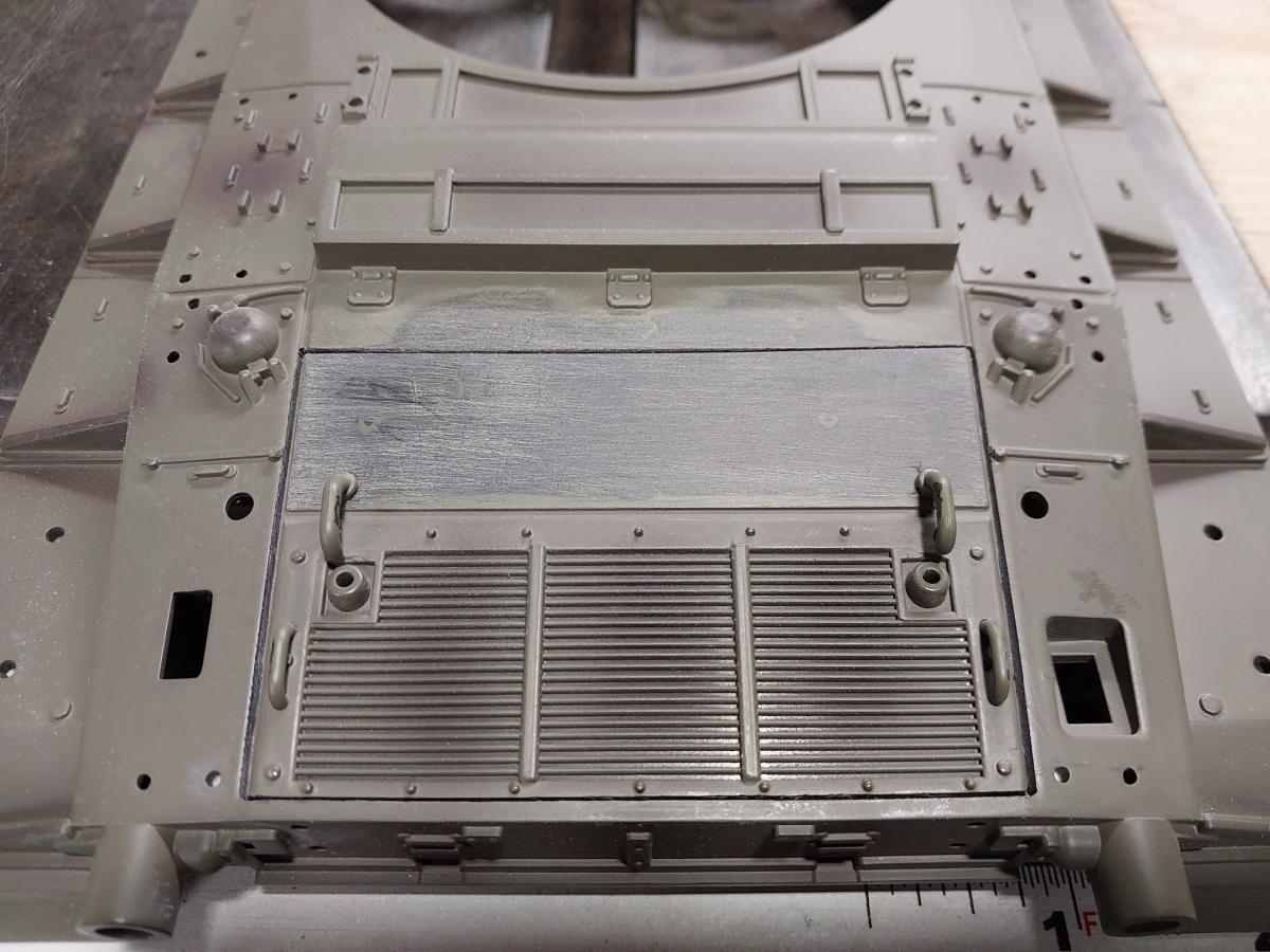

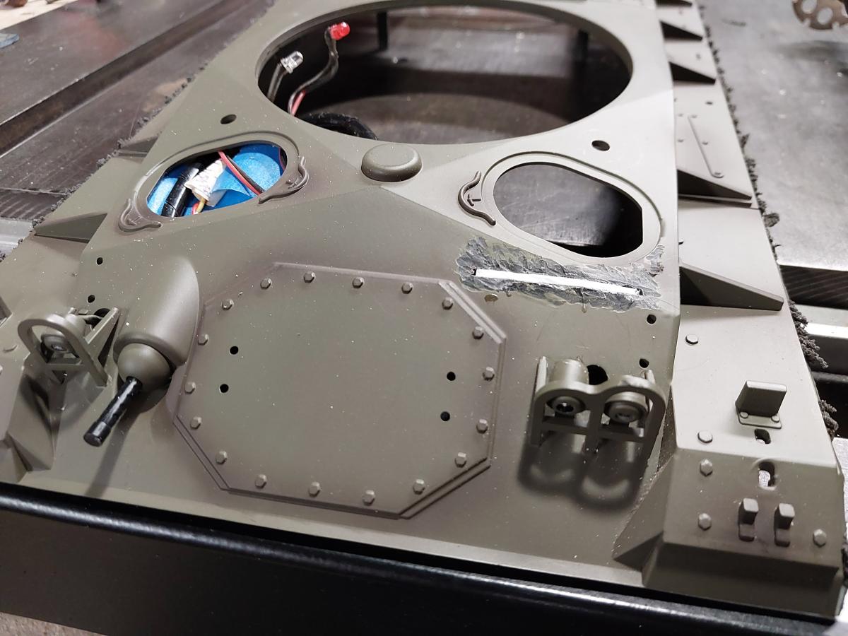

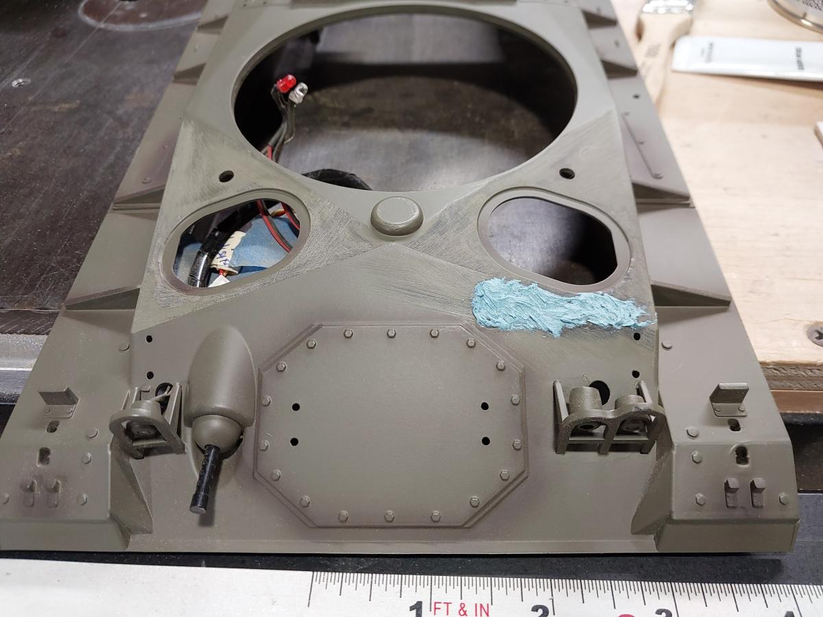

        After the glue dried, the excess styrene was cut off, and is was ground and sanded. Then a small amount of Bondo was applied and sanded. It looks great. But in the process, I decided to sand off the bullet guards on both of the hatches. One of the guards was partially ground away as the windshield mount was removed. It was easier to sand the Bondo.
        This images shows the bullet guard at the right side of the windshield completely ground off.
        Click image for larger version  Name:	20260519_124842.jpg Views:	0 Size:	107.4 KB ID:	448770
        Bondo goes on, and sanded.
        Click image for larger version  Name:	20260519_144005.jpg Views:	0 Size:	113.8 KB ID:	448771

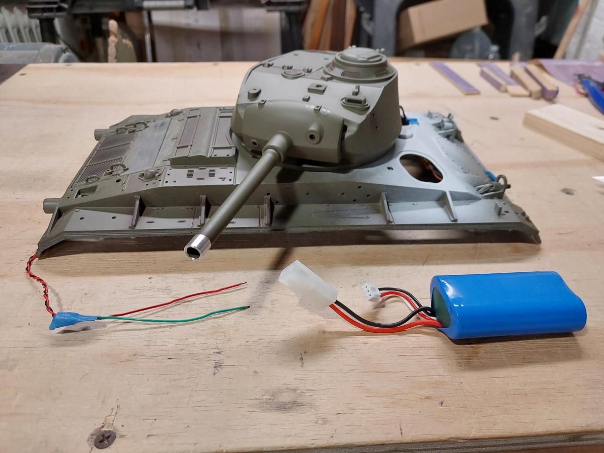

        While I waited for the Bondo to dry, I sanded off the strap detail from the new battery cover. It took a while, but I think it looks better than seeing the saw cut going through it.
        Click image for larger version  Name:	20260519_151757.jpg Views:	0 Size:	133.4 KB ID:	448772

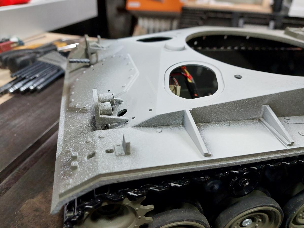

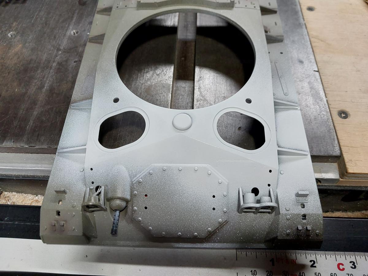

          The Bondo was sanded, and shot with primer. What do you think about the removed bullet guards???
          Click image for larger version  Name:	20260519_200809.jpg Views:	0 Size:	141.3 KB ID:	448774
          A different angle of view.
          Click image for larger version  Name:	20260519_201532.jpg Views:	0 Size:	113.6 KB ID:	448775

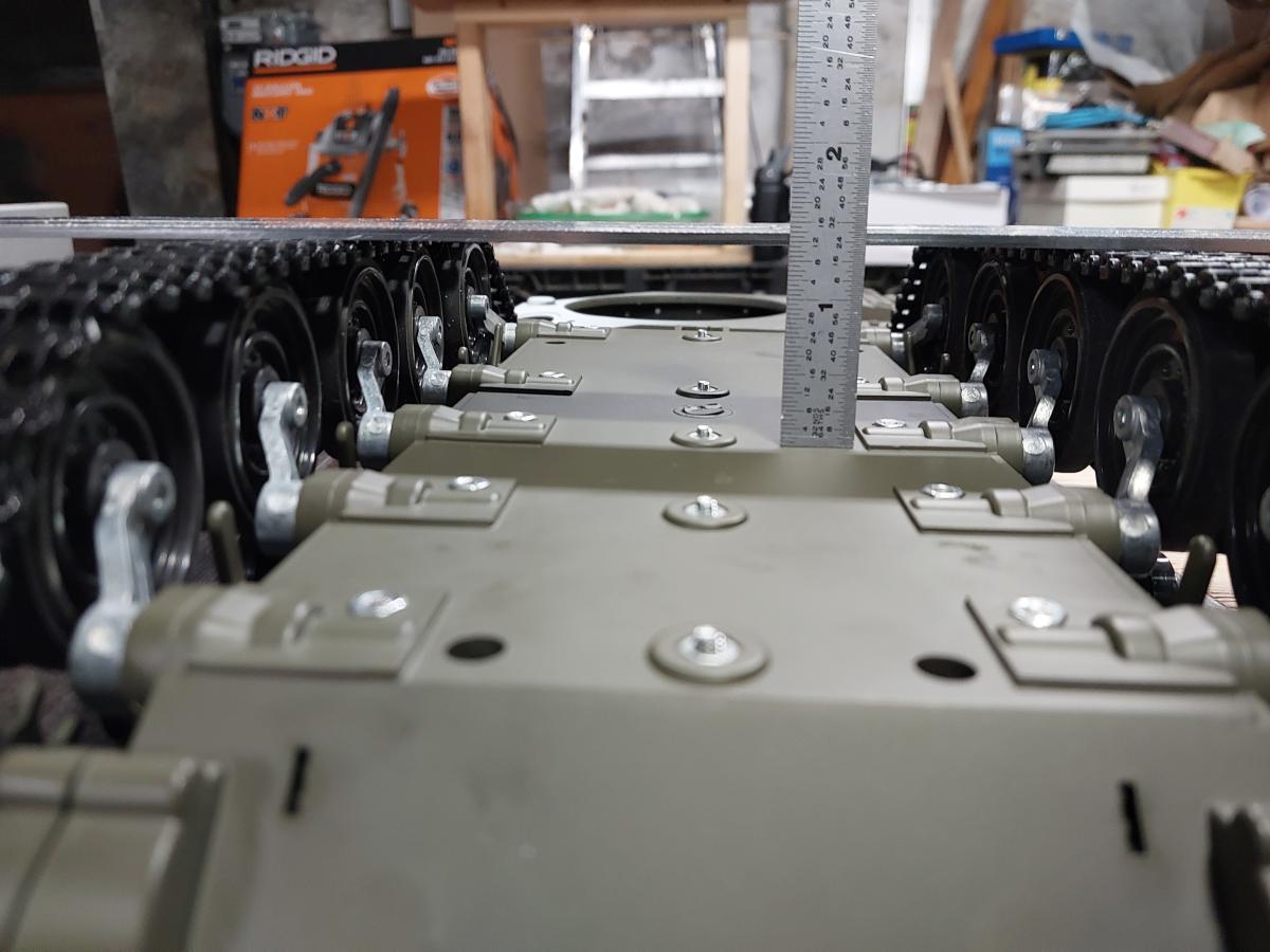

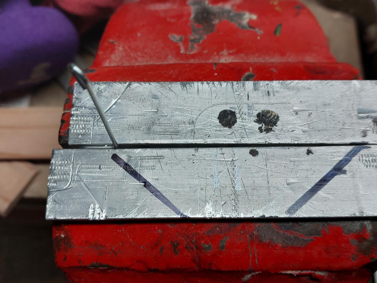

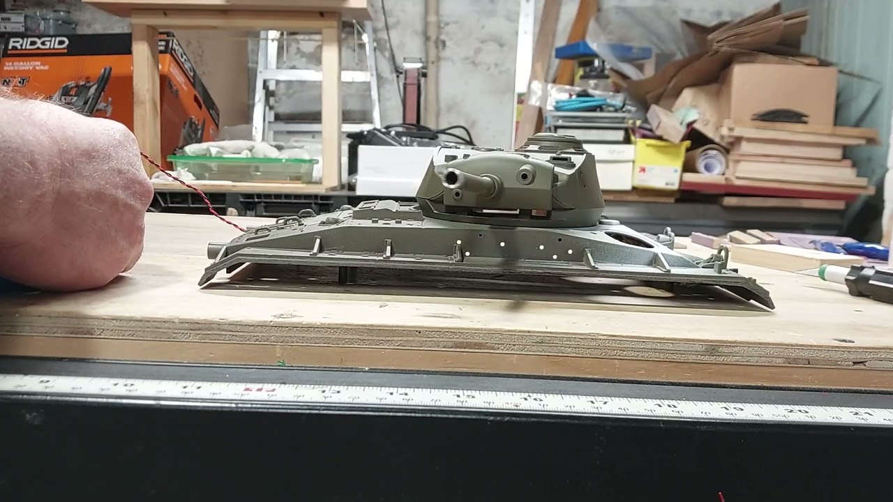

            Next, I tweaked the torsion bars to give the M24 more ground clearance. I'm not sure if I lifted it up too much. With the tracks on, it has 1 11/32" ground clearance (1/32" less than 1 3/8"). I had to add one track link to the tracks.
            I've always used aluminum angle to cover the jaws of my bench vise. I drew the angle (40 degrees) with a sharpie, so each side of the torsion bar would be twisted the same amount.
            It's an easy modification to do, except the lower hull must be gutted to have access to the 5 torsion bars.

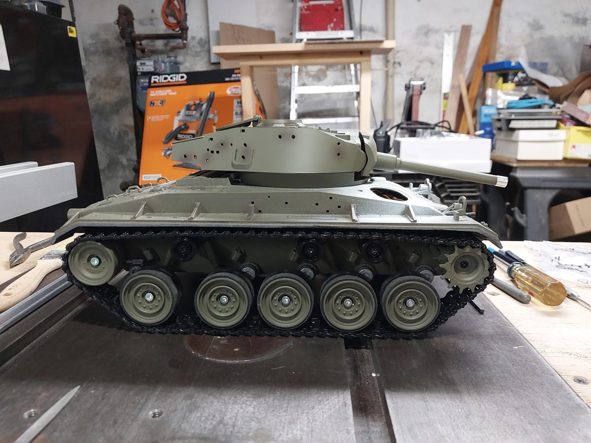

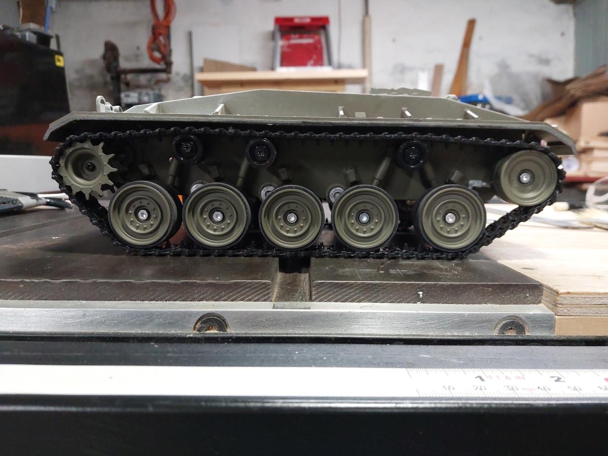

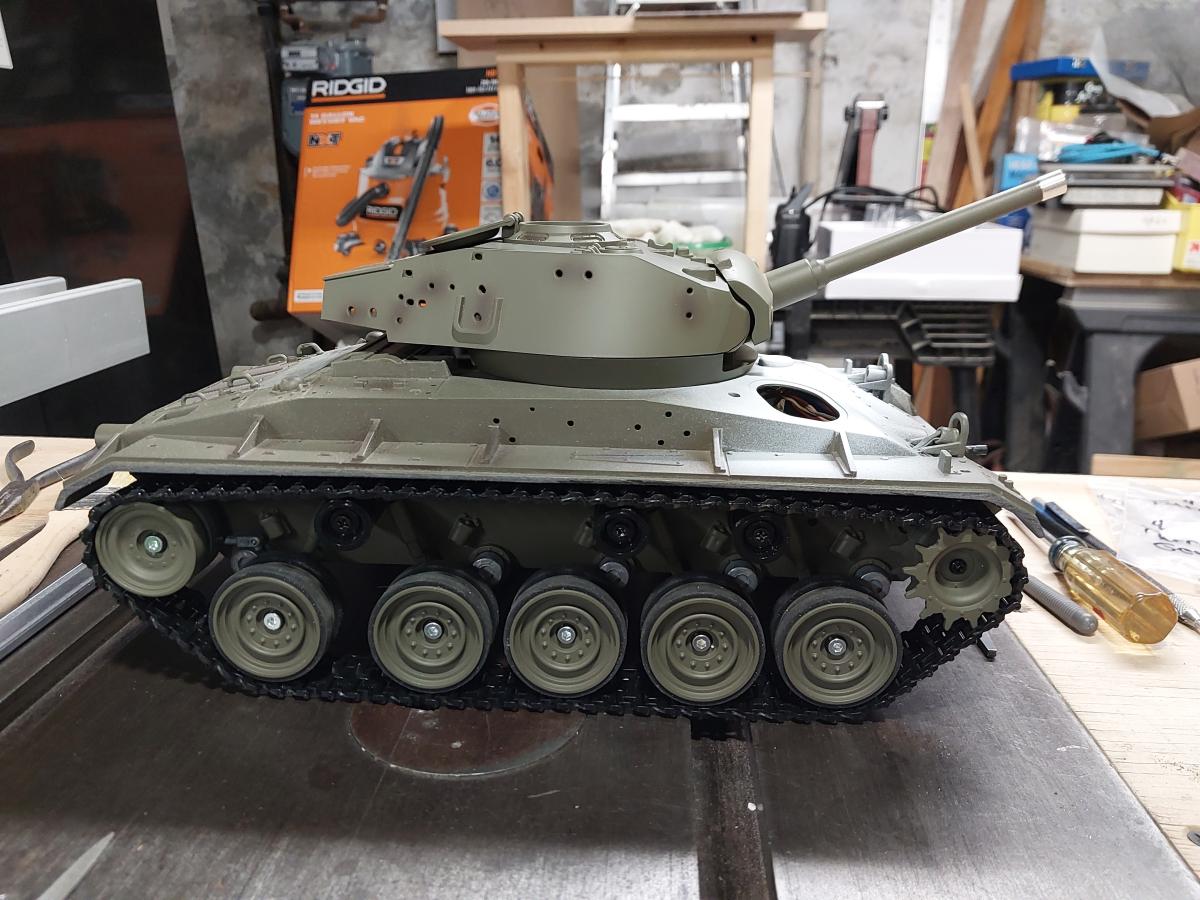

              Here's the side view with the fender skirt delete upper hull, and the ground clearance measured.
              Clearance measured.

                Much nicer more realistically stance. You will also find it actually drives better with the higher stance then with the factory one.
                  Thank you, Rubicon99, after all, I read what you had done to your M24, I liked it, and I copied it. Thanks for sharing your modification!!!

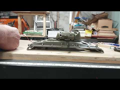

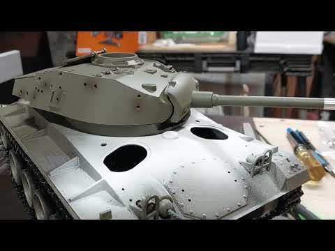

                      So here's a 5 minute video explaining the M24's Turret problems, and what I'm planning to do to solve them.
                      Actually, there are only 10 wires going into my M24's turret because it's not going to be used in IR battIes.

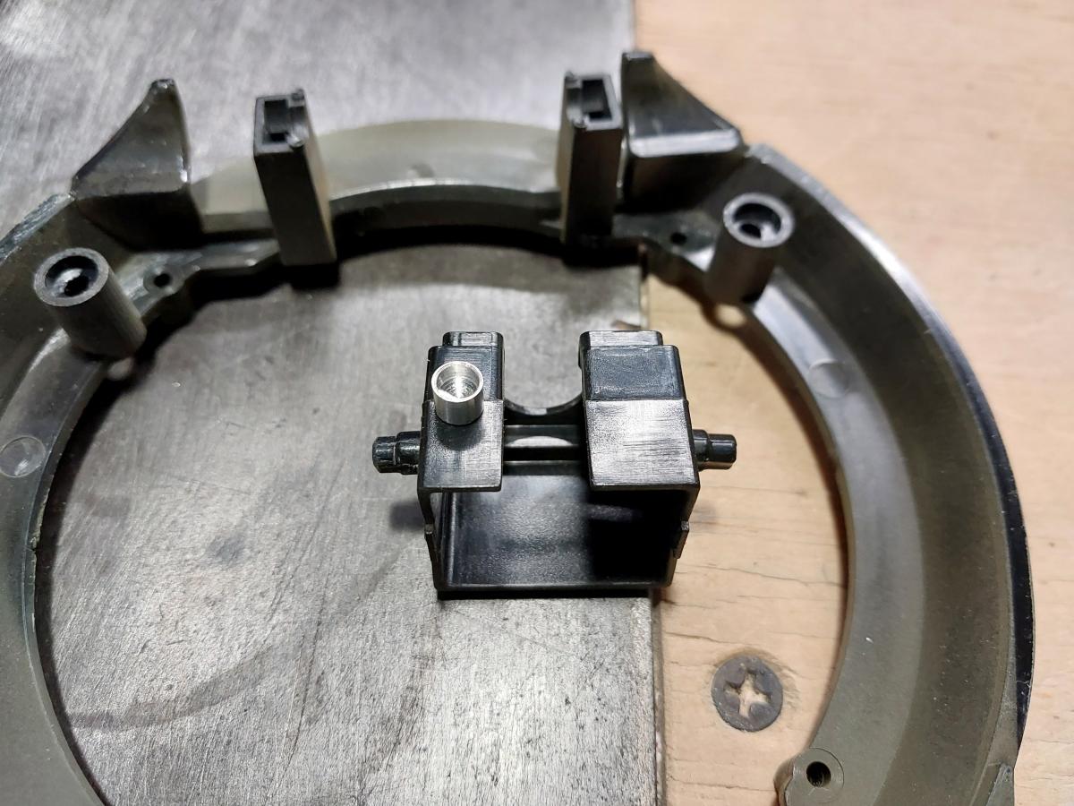

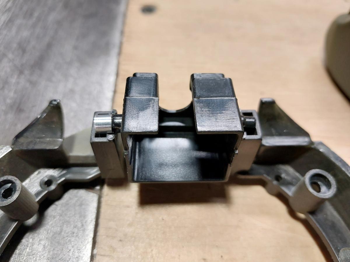

                        First, I repaired the gun pivot points.

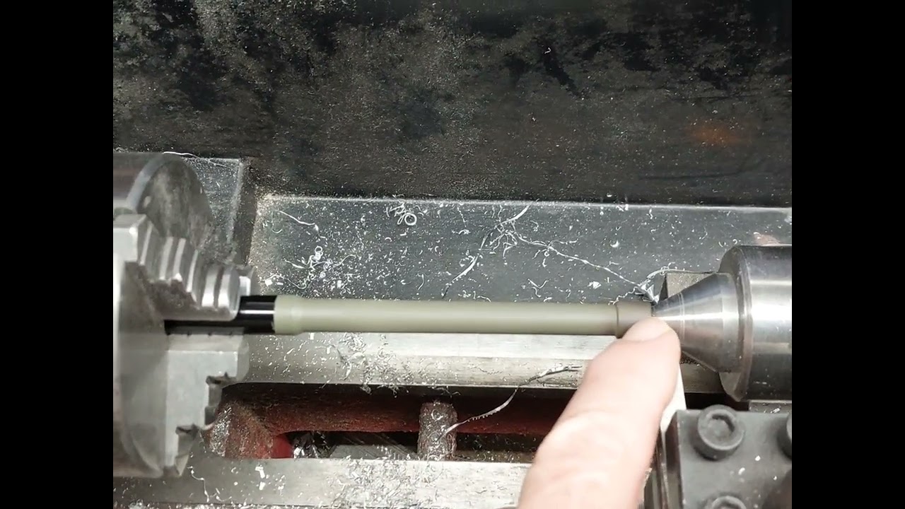

                          #32

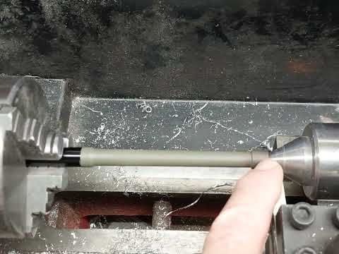

                          While I was using my lathe, I decided to turn down the muzzle end of the gun barrel due to it being oversize.

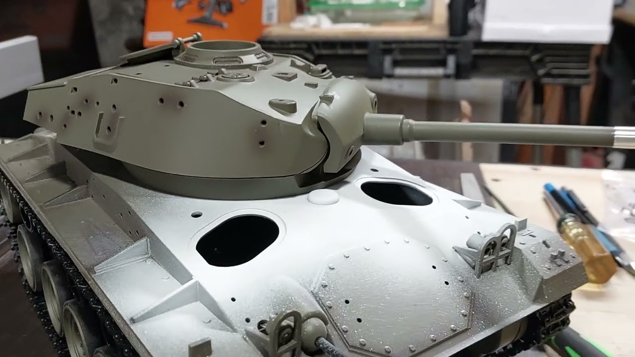

                              #34

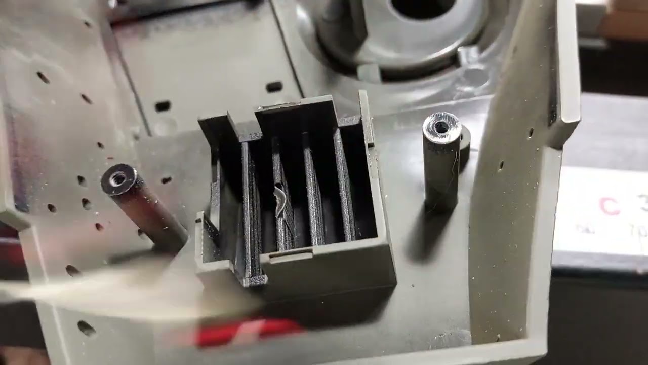

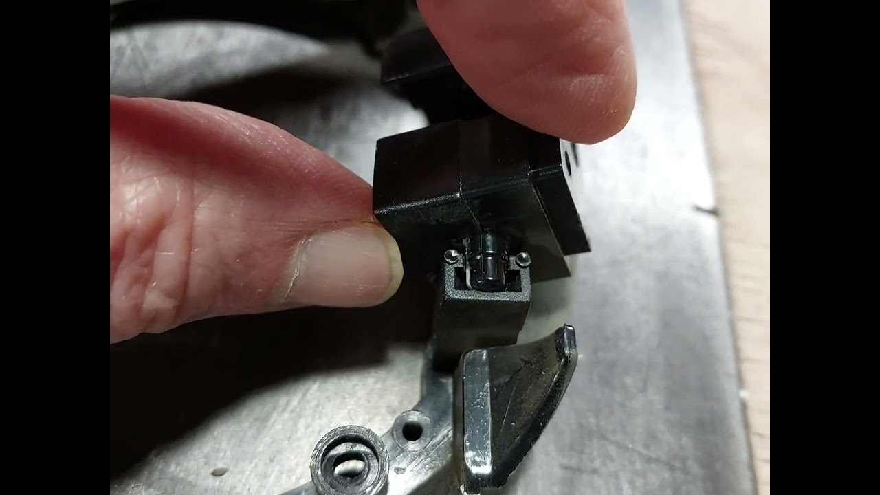

                              Next, I reassembled the gun, and I drilled new holes to attach the rear portion of the gun body. Then I checked the fit and movement of the gun with the turret assembled.

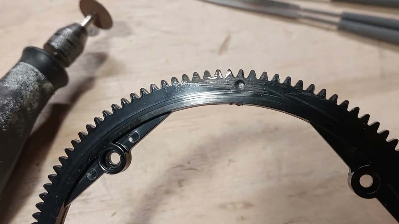

                                  #36

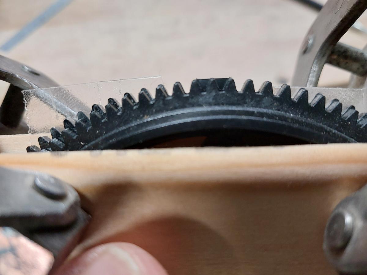

                                  Cutting the new, or missing teeth from a turret gear is an easy modification. There are videos on Commietube (Youtube) showing how it's done. The few times I've done it, I usually have another gear that's either the same size, or a little bit smaller. I line up the two gears, and clamp them together, and I scribe the shape of the missing teeth. If you don't have a gear to trace, measure the width of the uncut tab, and draw a line in the middle. Then measure between two teeth to get the center distance. Then draw a line on each side of the center of the tab to represent the middle of the three teeth. Free hand draw the rough shape of the teeth to be cut.
                                  Put a cutoff disc in your Dremel, and hold it in your left hand so the rotation of the cutoff wheel is turning away from you. Don't hold the Dremel in your right hand because all the melted plastic will hide the lines of the teeth. First cut in the middle of the teeth, and then cut the angles leaving some material. Hold it up to the gear in the turret traverse unit to check your progress. Then cut away more material and check it again, until the newly cut teeth roll freely over the traverse drive gear.
                                  The scribed lines can be seen in this image.
                                  Then the teeth are cut, and filed a bit, and it's finished!!!

                                    Here's an image before testing the modified turret gear.
