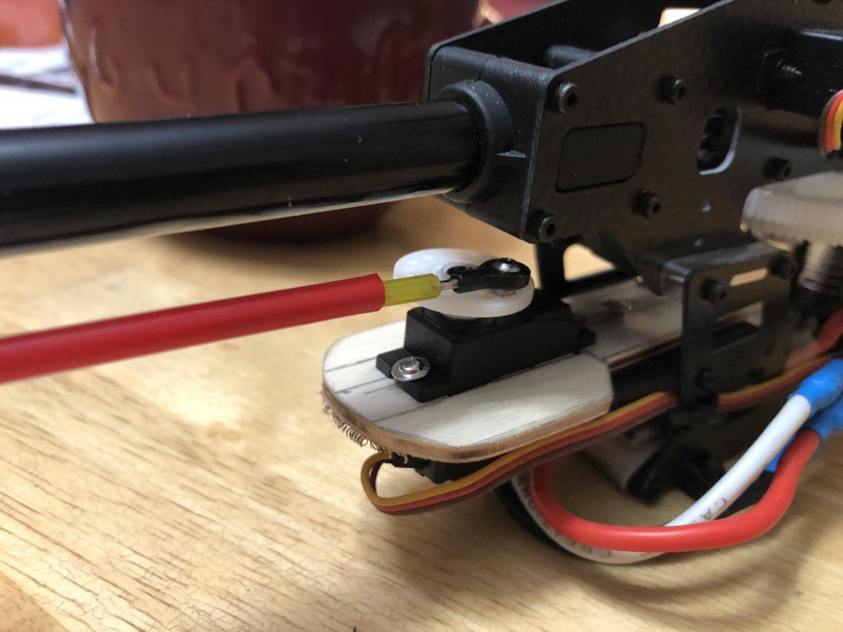

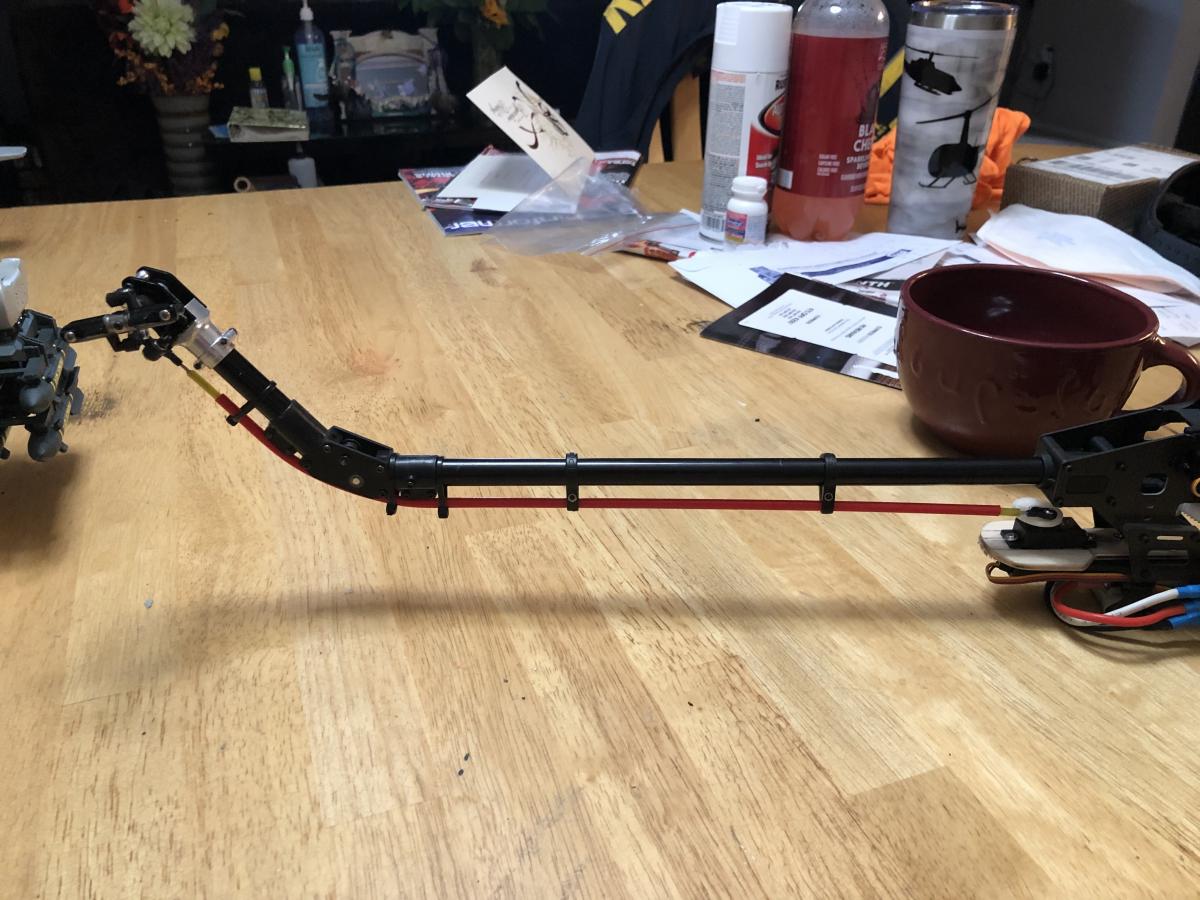

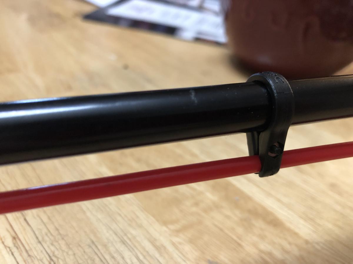

  • Gravythe clown
    Yeah it definitely helps with the fit into the fuse.
    mom still getting tail bounce, so I’ll pull it out again and see what I can do to fix that. I might make my own pivot joint so I can use two straight rods like in my cobra and Apache use instead of golden rod.
    I’ll up date later with how that goes.
    everything is fixed and I’m finishing up the touch up paint now. Besides the missing window you can’t tell it was scene in a crash. I wish they would sell the window set. It don’t even come with a new canopy.
    oh also added in 1.5 oz of lead to the front canopy to get it to CG even with the battery.
    Gravy
  • CM_Aero
    Gravy thats an interesting servo mount for the Tail. Ive been having issue of interference between the fuse and the servo - but that looks like a great way to fix the issue.
  • Gravythe clown
    After my crash I decided to make some changes to my tail rotor drive setup. Fits better and seams to control better, smother. I’m waiting for some new blades and epoxy to dry on the fuse. Once the epoxy is dry really good I’ll sand and paint. Besides the missing lower left window, won’t be able to tell it crashed.
    Gravy
