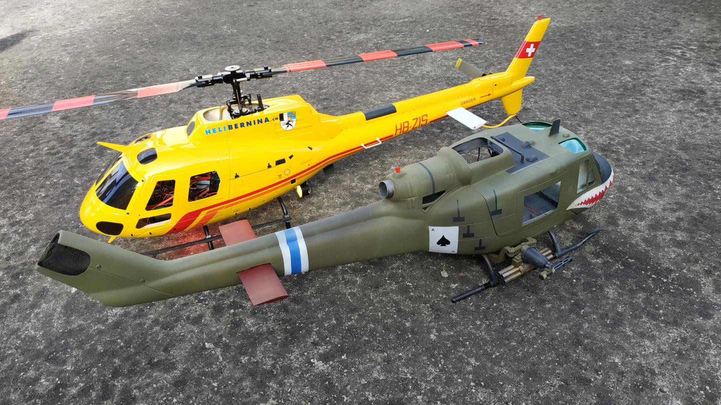

    Greetings!
    I just stumbled over Alpha's pictures of his modifications. Good job, especially with that not at all scale landing gear. I also like the weapons. They are scratch built, right? There is one more thing that you really must do: Get rid of that ugly front window and the wide brim it is mounted on. It looks like the helicopter is wearing thick horn glasses.
    How do I know? I have the same fuselage and spent some time with modifying it. Here it is, but please be merciful. It's my first scale helicopter.
    And I like the ammo belts. My experiments look similar, but I don't quite trust them to stay where they are when actually flying the model.
