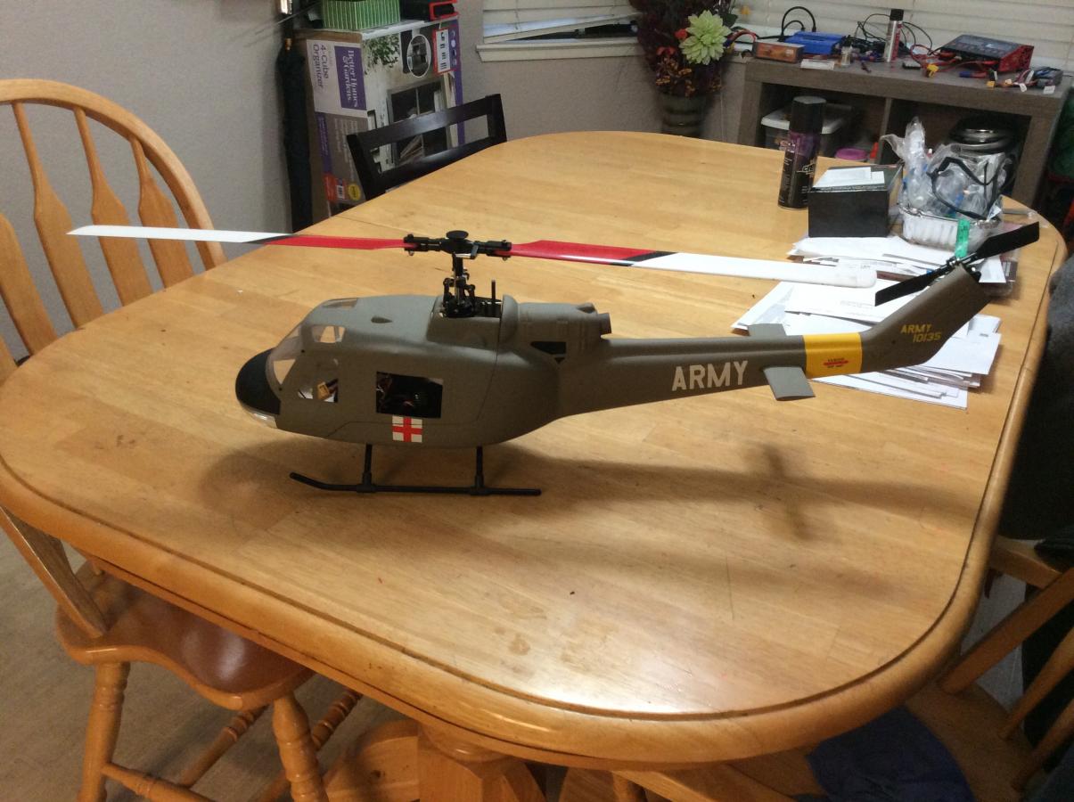

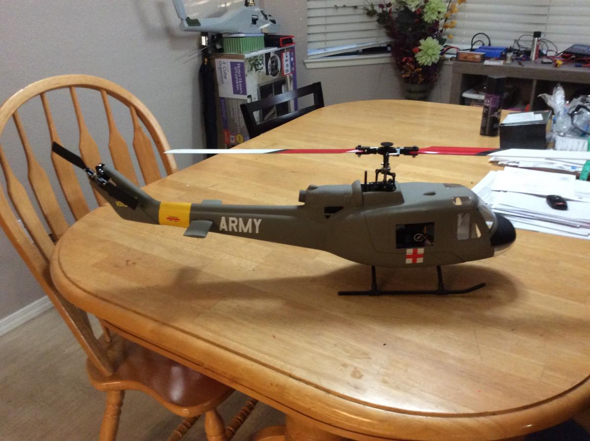

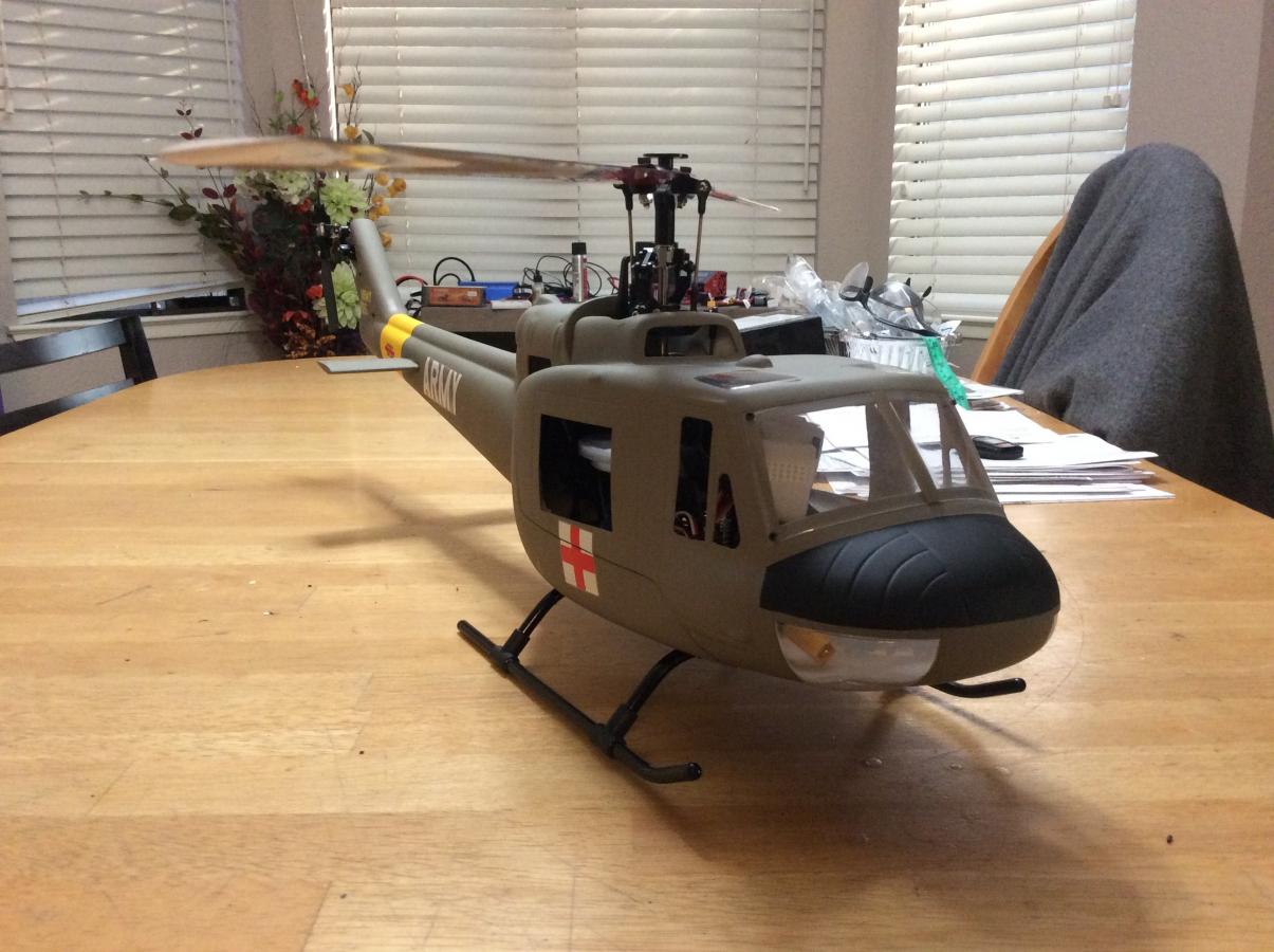

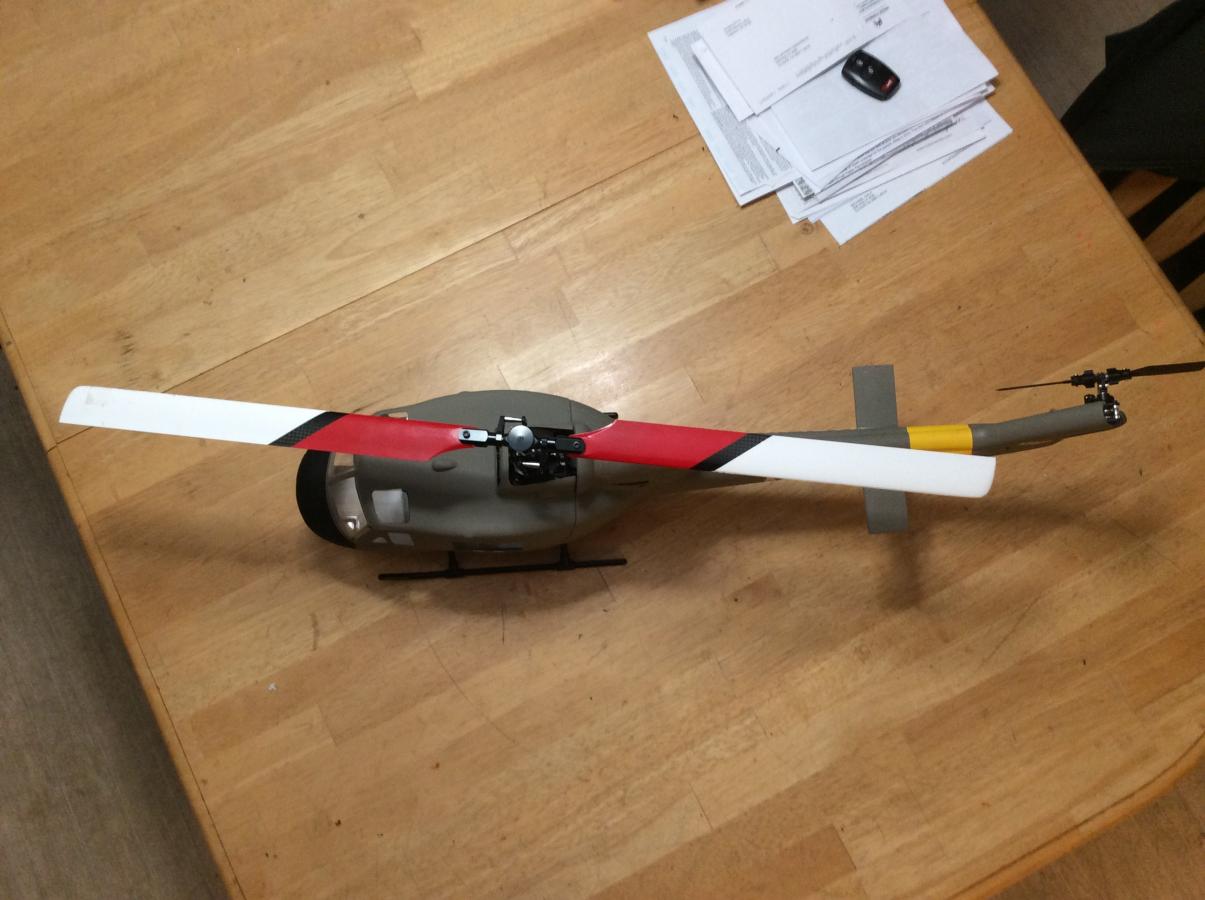

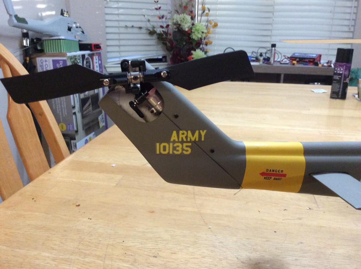

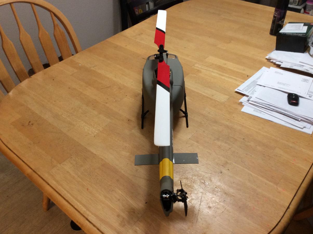

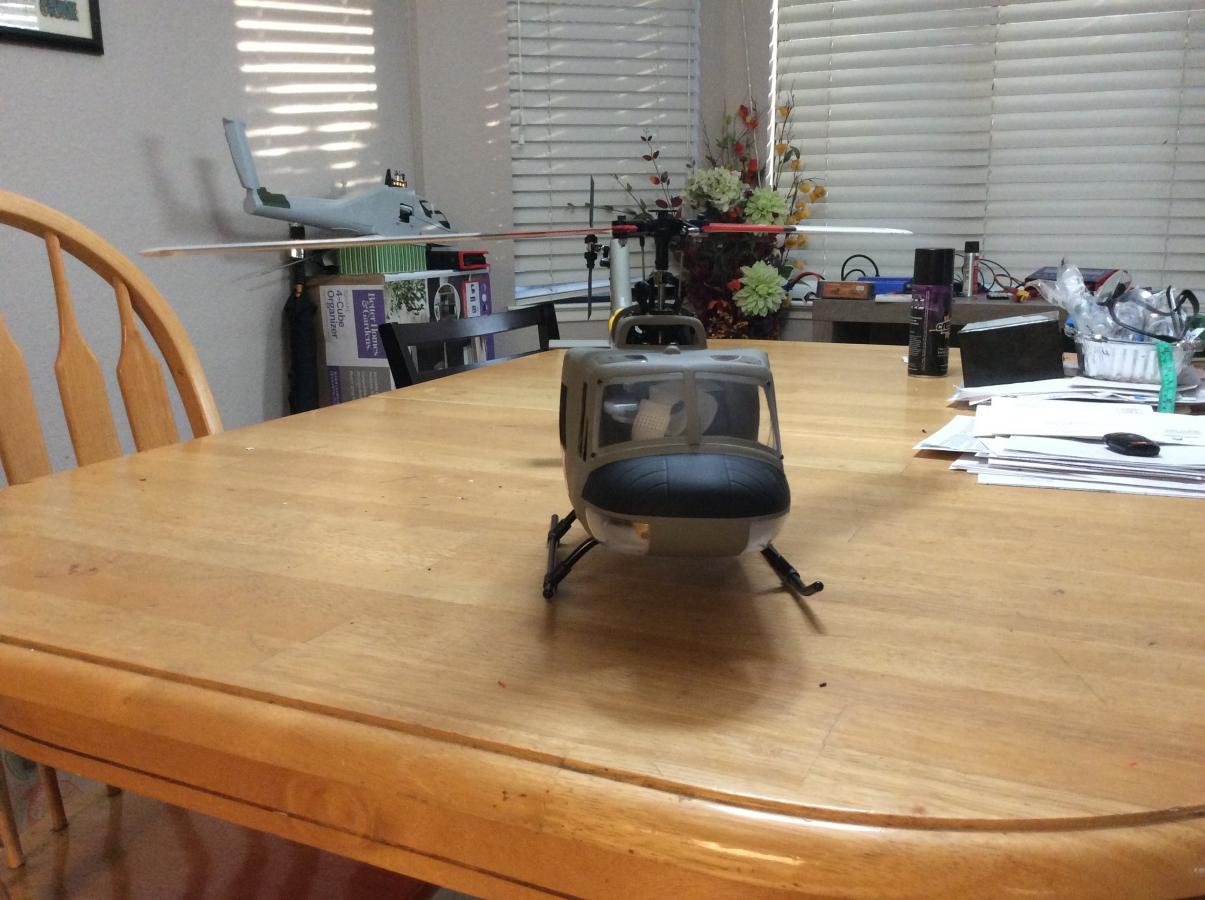

    Some pictures of my UH-1.
    Gravy
  • Gravythe clown
    You are right, that linkage is really rough. I do need to pull it all out and make some other modification/fixes. My mechanics don’t sit square as well. So I will pull it all out any change the linkage rod and fix the fuse mounts.
    Gravy
