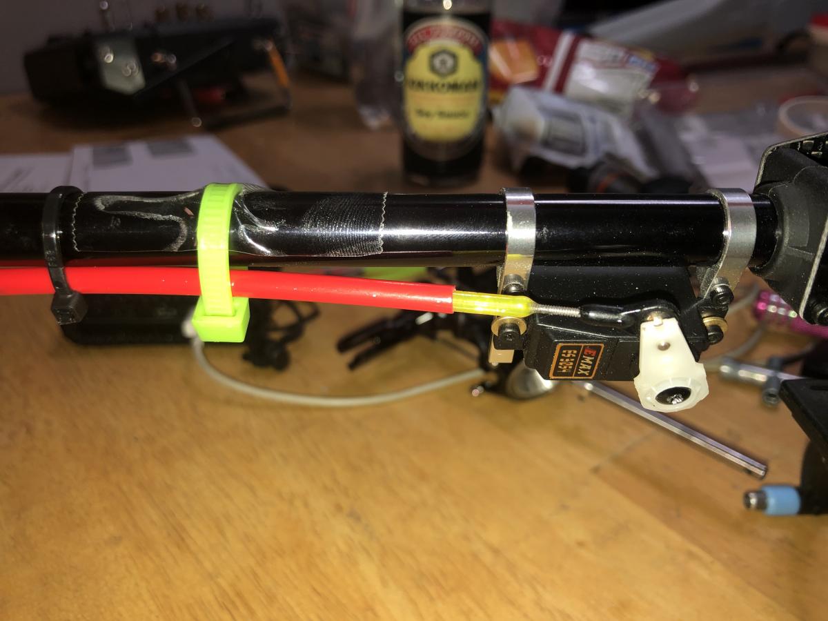

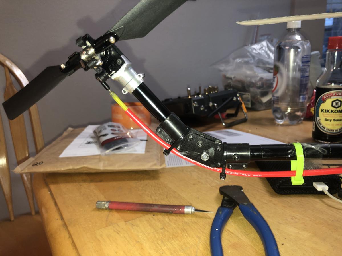

                                • Guys you haven’t, do the tail mod F106DeltaDart did. It made all the difference in the world. My tail gain is right where all my 450 microbeasts are at now. Between 27 and 30 and rock solid. Also now that my tail is under control I can see it working on 4s as I tried it at 50% throttle on 6s and I hand good tail control.

                                    • Removed the mechanics from the fuse today and adjusted the belt tension. Now it rotates a lot better. Installed the Microbeast and took it for a test flight. Major tail wag. Going to mod the linkage per the suggestion and see what happens. Talon 60 on order as well. Note: CHECK ALL SCREWS! A ton were loose and without thread lock. Thats why I asked a few days ago if these are flown at the factory as stated by MRC.

                                      • The tail mod works wonders.
