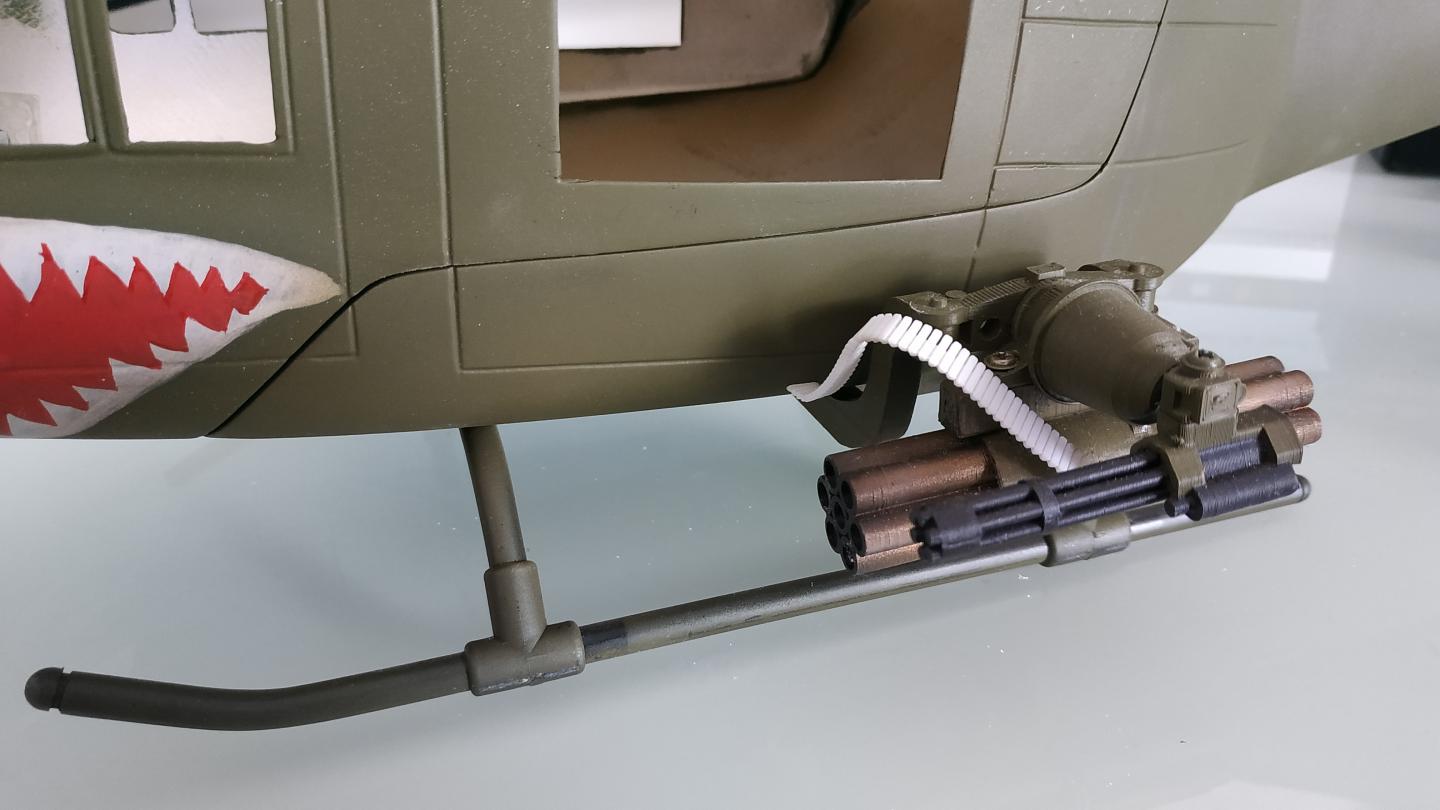

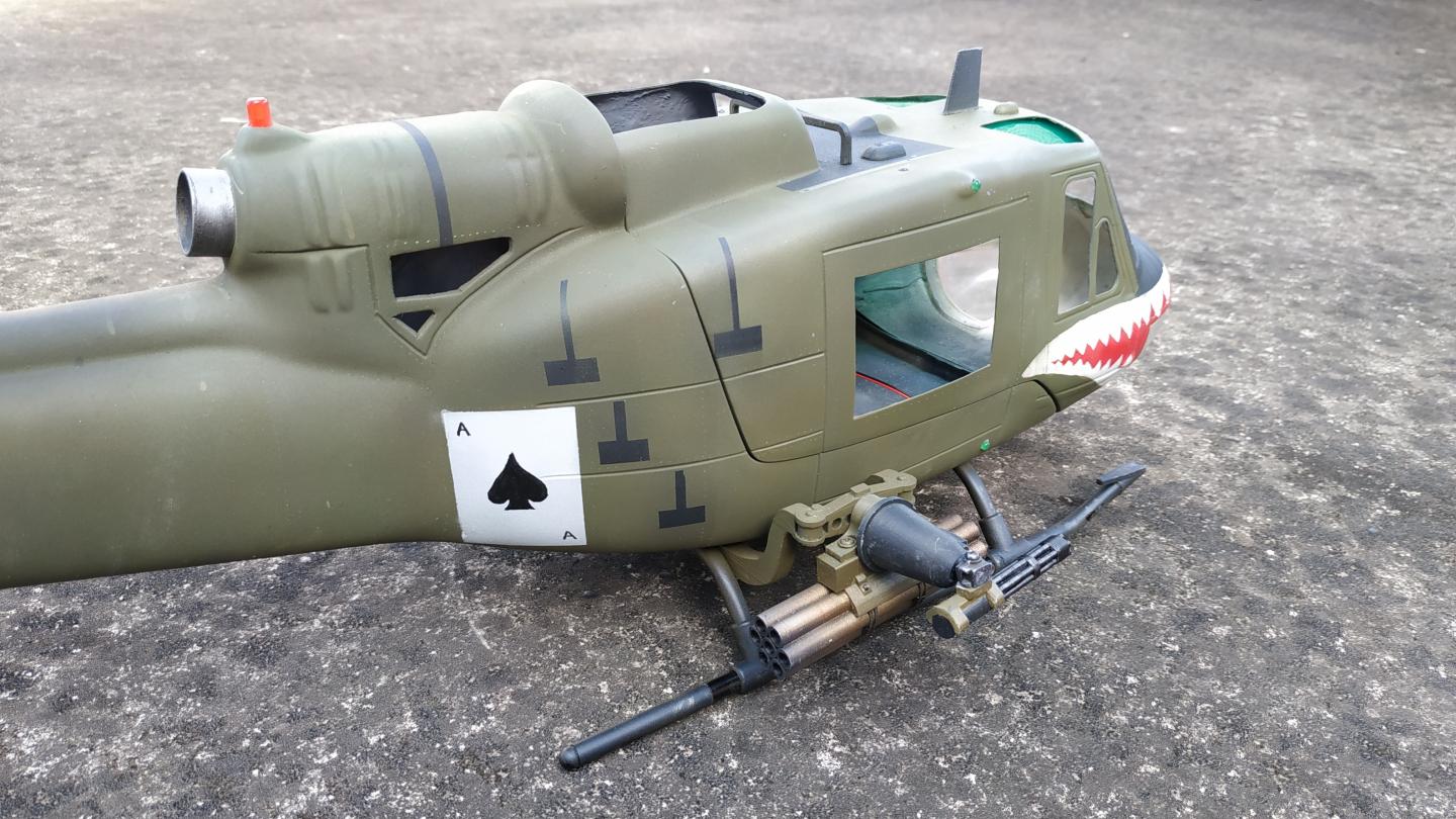

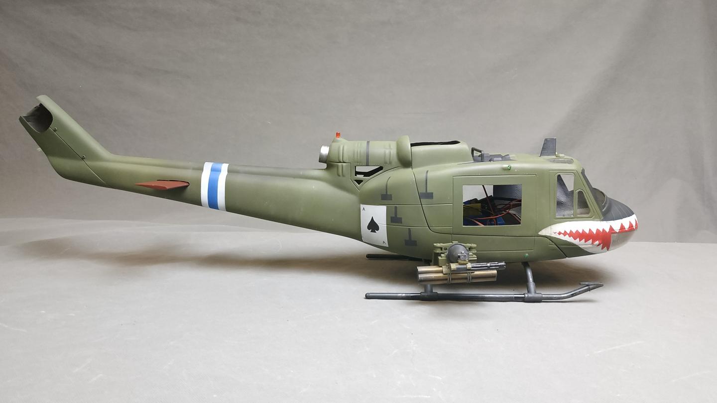

          In time for Independence Day, here are some updated 3DPUP .STL files for the UH-1. With a few hours of printing and basic painting/cutting/screwing/soldering, one can really personalize the model beyond what arrives in the box. I especially like the fiberglass body because typical techniques from the plastic modeling world can be used. I haven't had the time to take this model to the next level, but it's nice knowing I could. Work in progress...
          Stance: Cut the struts down the lower the stance as shown below. For more scale, shorten the skids themselves. I haven't done this yet on mine.
          3DPUPs: The files attached for the most part screw together. You'll need lots of 1.5mm wide screws.
ID:	204309Click image for larger version

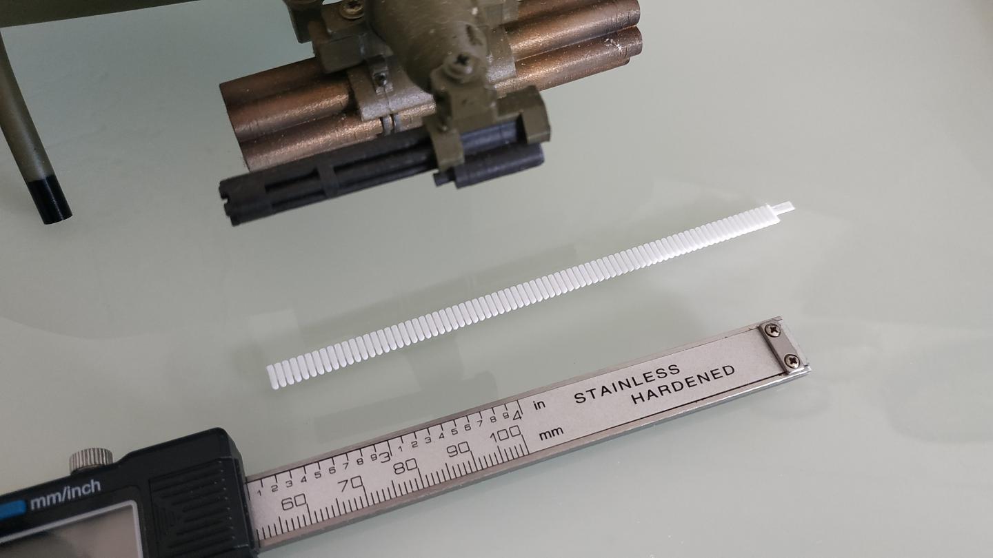

          Ammo belt: The great thing about PLA is that it softens under heat. A half second pass over a lighter will soften areas enough to bend the strip before it hardens again.
ID:	204330Click image for larger version

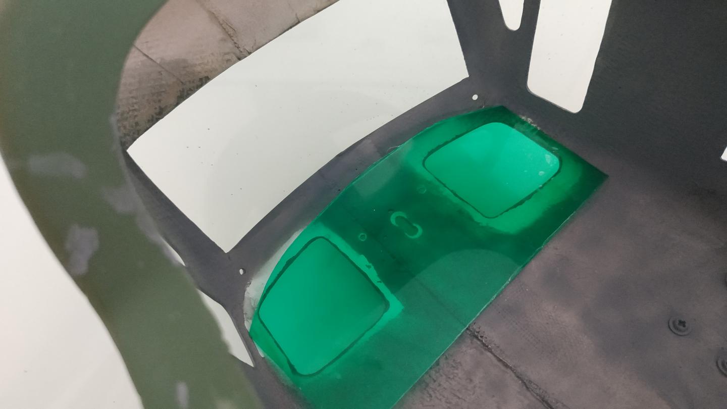

          Drill 2mm holes into the fiberglass, and use those holes to also drill through the holes of clear green sheet. I try to minimize where glue is used.
ID:	204306Click image for larger version

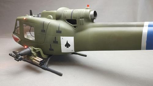

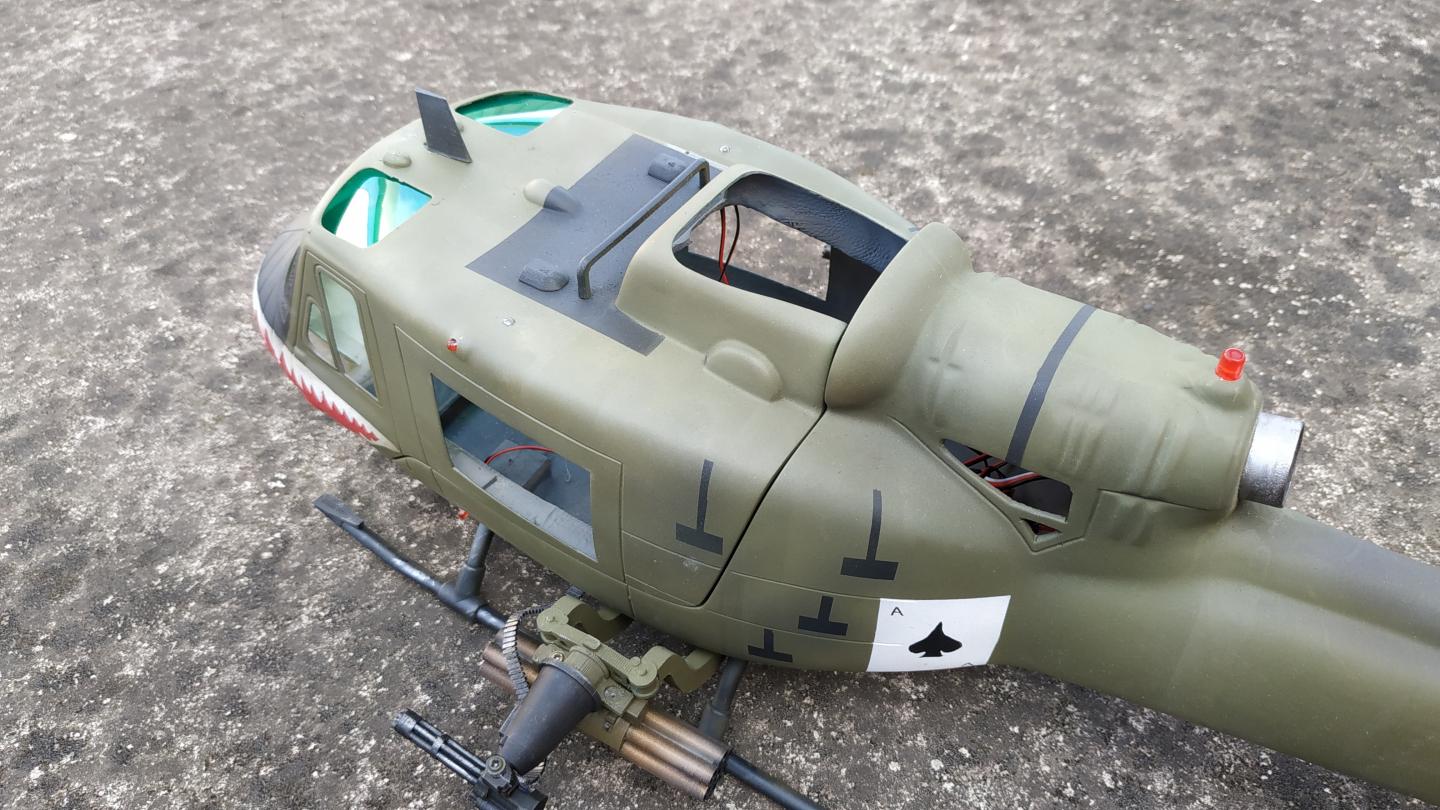

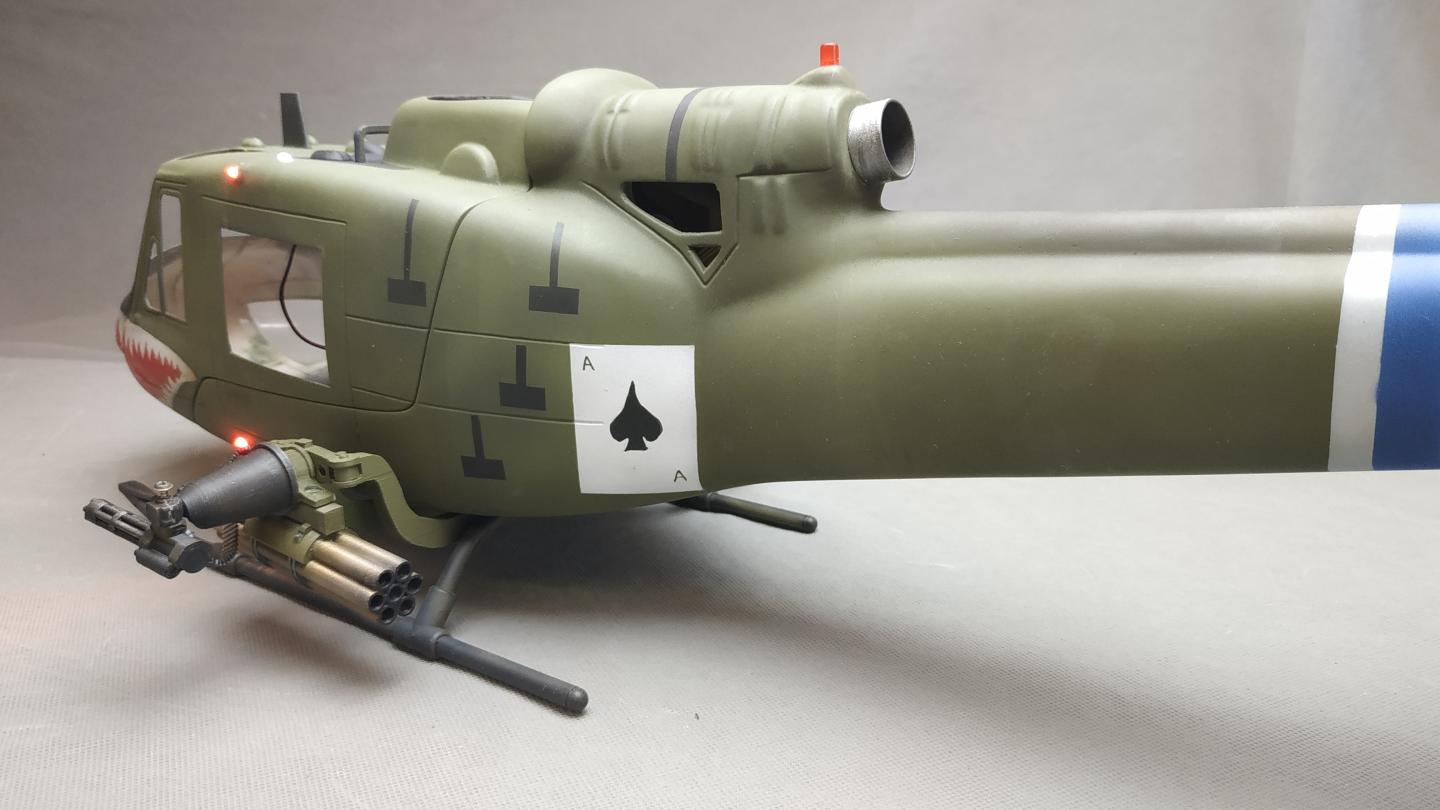

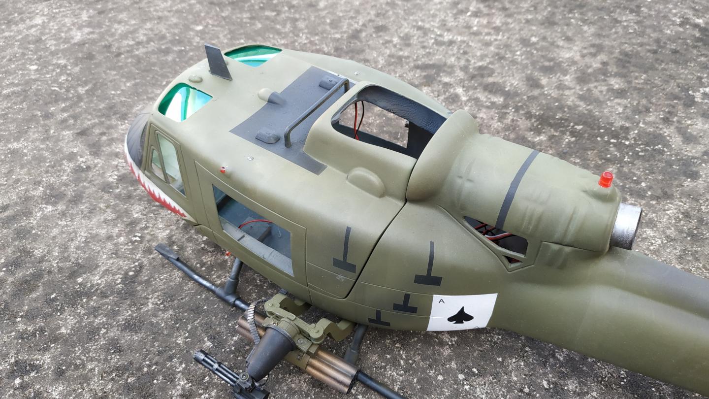

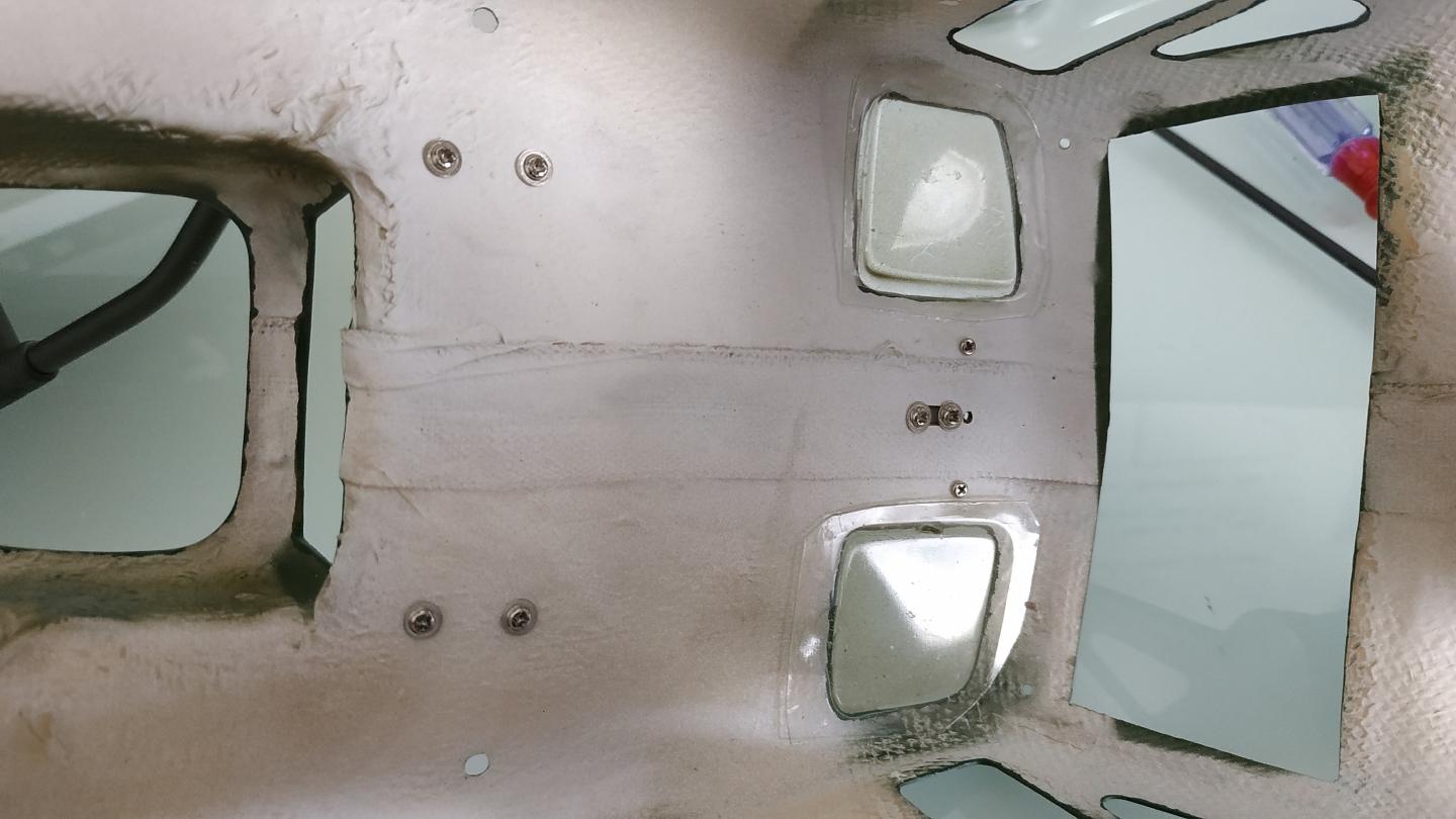

            Work in progress. Right now there are eight LEDs being driven from an MFCB. Simpler circuits can also be used if space is a concern.
ID:	204340Click image for larger version
ID:	204342Click image for larger version
ID:	204339Click image for larger version

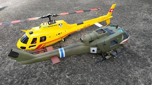

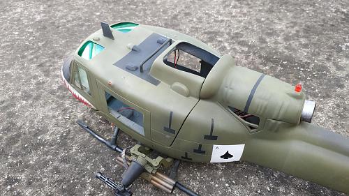

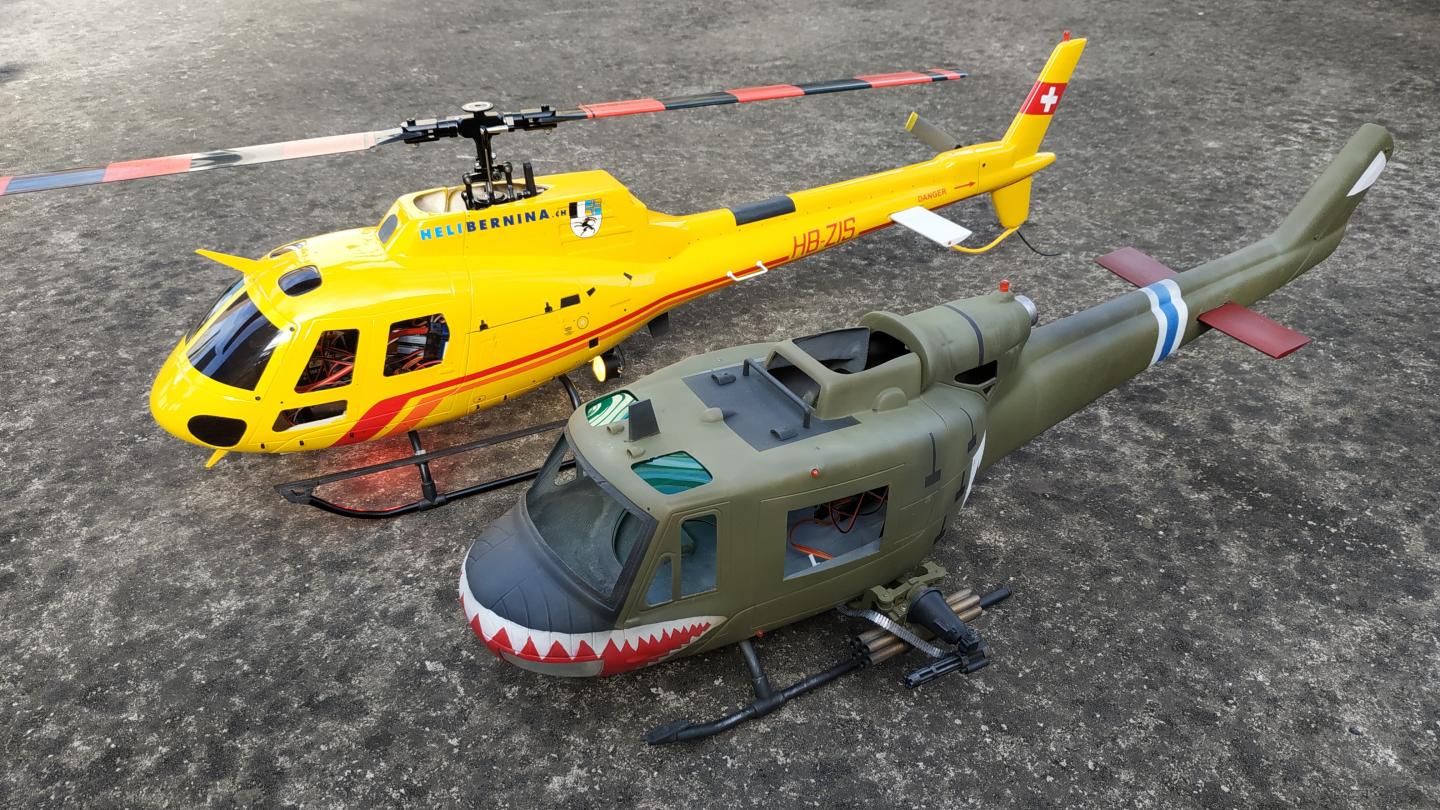

                      Greetings!
                      I just stumbled over Alpha's pictures of his modifications. Good job, especially with that not at all scale landing gear. I also like the weapons. They are scratch built, right? There is one more thing that you really must do: Get rid of that ugly front window and the wide brim it is mounted on. It looks like the helicopter is wearing thick horn glasses.
                      How do I know? I have the same fuselage and spent some time with modifying it. Here it is, but please be merciful. It's my first scale helicopter.
                      And I like the ammo belts. My experiments look similar, but I don't quite trust them to stay where they are when actually flying the model.
