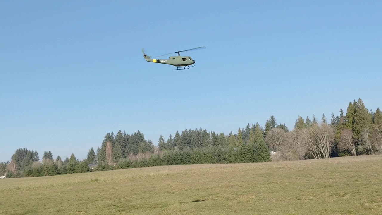

      • Flew the last tuning flight on my UH1 today. I am using a 4s 2200 mAh battery and a Spirit flight controller. I get about 7 minutes of flight with about 1100 mAh left in the battery. The helicopter flies very well, hands off hover in a no wind situation. I would include a video, but can't seem to get one to be accepted. Here is the youtube link.
        Danny
        • Rotorscale 450 UH-1A Medic I did for Mr. Danny Rice, Washington flown Saturday using 50A Castle Creation ESC with 13T Pinion on 4S Lipo.

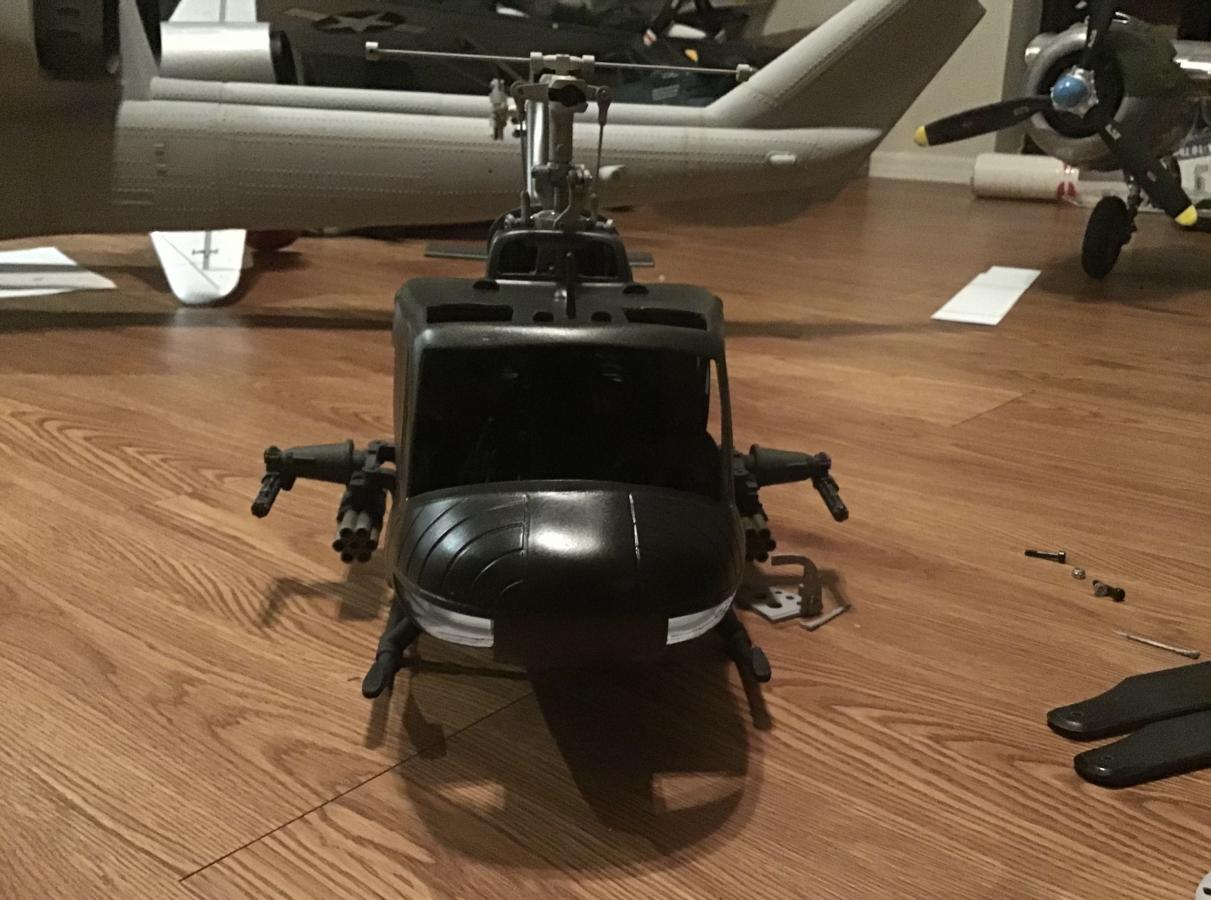

          • Looks like it’s flying great Ed, nice work! Finally decided to start modding mine a bit more. Planning on a complete redo into a US Navy HAL-3 Seawolves Bird. I dremeled out the windshield to scale size and made a flybar out of some spares and a Trex 250 pitch gauge. Next will be printing out all the 3DPUPs to get it armed up to spec!

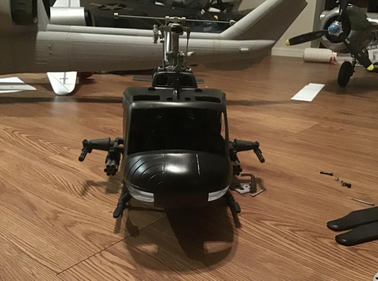

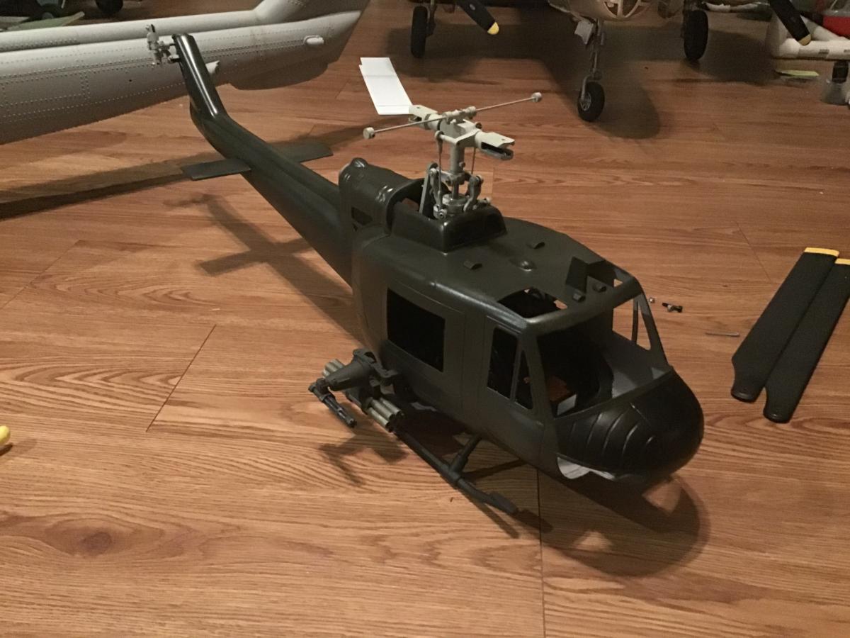

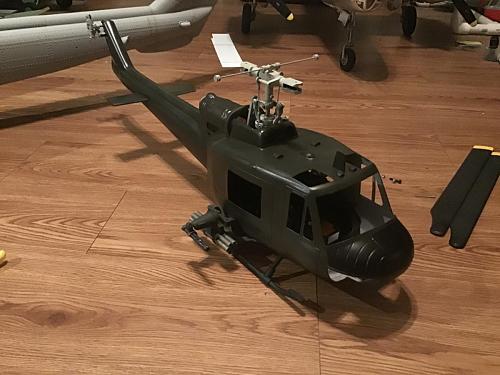

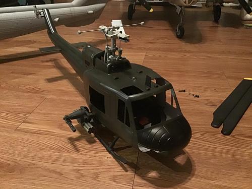

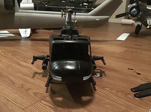

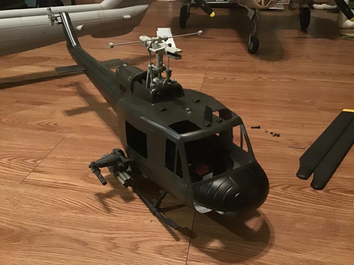

                          • 3DPUPs for my Seawolves Huey are printed, assembled, and primered. Also placed an order with Callie for the decals. Next step will be painting, whenever we get some good airbrushing weather.
                            • F106DeltaDart I designed those ordnance pylons to attach to each other with 3mm carbon tubes. This reduces the side twist.
                              Also, the ammo belt is shaped by passing it through a lighter's flame for a split second, then bending it while its warm and holding it in place for a few seconds until it cools and rehardens in its new shape.
                                Thanks for the tips Alpha! Planning on adding the carbon tubes once I get ready to attach the pylons. The biggest difficulty now has been trying to match the Seawolves paint color. It is a very dark, glossy green. Working on mixing a few different colors to get something close.
                                • Painting complete and ordnance attached. Just need to add windows, ammo belts, and markings. Decals have been ordered and are on the way from Callie.
