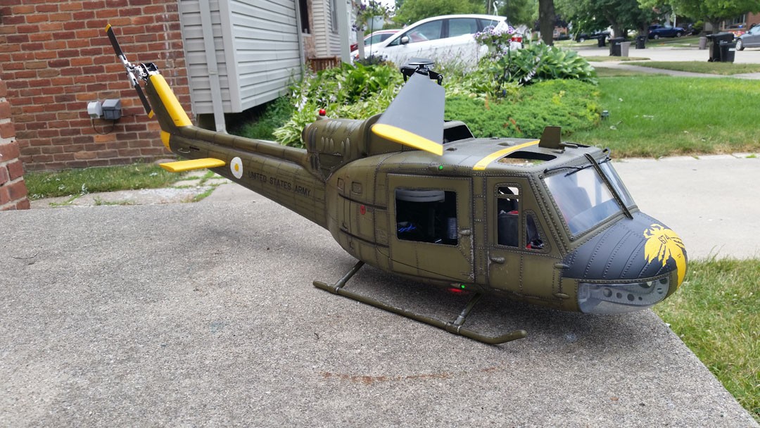

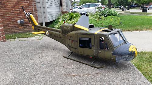

      From one old geezer to another. 1st thing is do a recon of your local area and see if there is some guys flying RC helicopters. If you find some they will be of great help to you. Look up RC AMA fields near you, that would be a good start( Most of the guys will be flying Fix wing but there is some RC helicopter guys in the mix). Right now this is not a good choice to jump into for you. The old saying more stick time needed to work into this aircraft. As far as Radio's ? I fly a Specktrum IX20. I've flown many systems over the years from Futabra to JR. Whatever radio you get make sure its has as many channels as you can afford. I fly Fix wing as well, some with 4 engines and they eat channels up fast. I have a BlackHawk that uses 10 channels for all the scale stuff(7 for flying)
      Picture of the last UH1 500 size I built.
