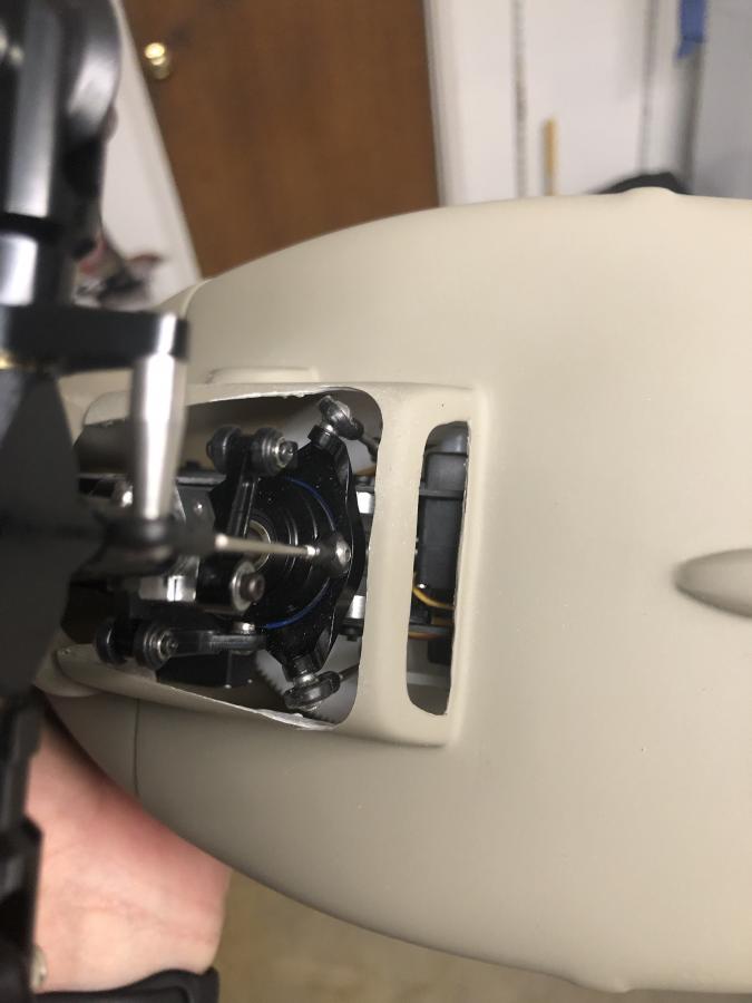

          • I got it worked out today. Had the day off so worked on it and am happy with it now.
            I first thought was like you said lower the head speed a little. So this morning I started out by changing from rpm mode to simple governor mode. This way I could play with some different head spreads. So after that was set I did some test flights and ended up where I was really happy. This was all done with
            out the front canopy on. Then when I was happy I added the front back on. She got bouncy and vibration sound came back. So what I noticed was the front swash plate ball links were rubbing up agains the fuse. So I got the Dremel and standing bit and cleans up the area. No more rubbing and no more jumping or vibrations. She flies great now.
            Gravy
