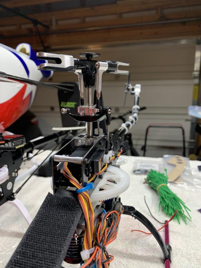

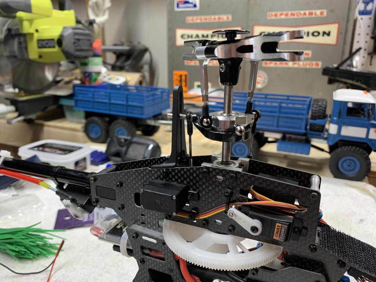

Well, crap!!!!!!!!!!!! I got the stabilizer bar put together (Trex 250 pitch gauge, flybar, and wheels locks) and when I tried to attach it with the head screw found out that the threads in the top of the head are buggered-up/stripped. Oh well. Checked at MotionRC for a replacement head, but, they are still out of stock. Bummer.......just have to fly it without a head cap until I can get a new head assembly.

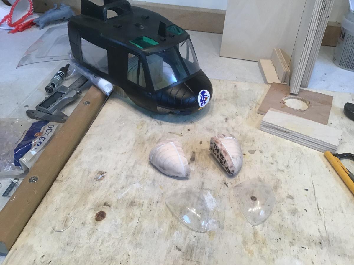

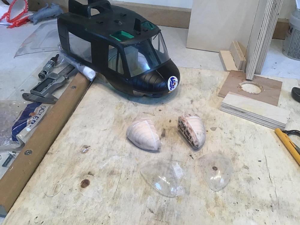

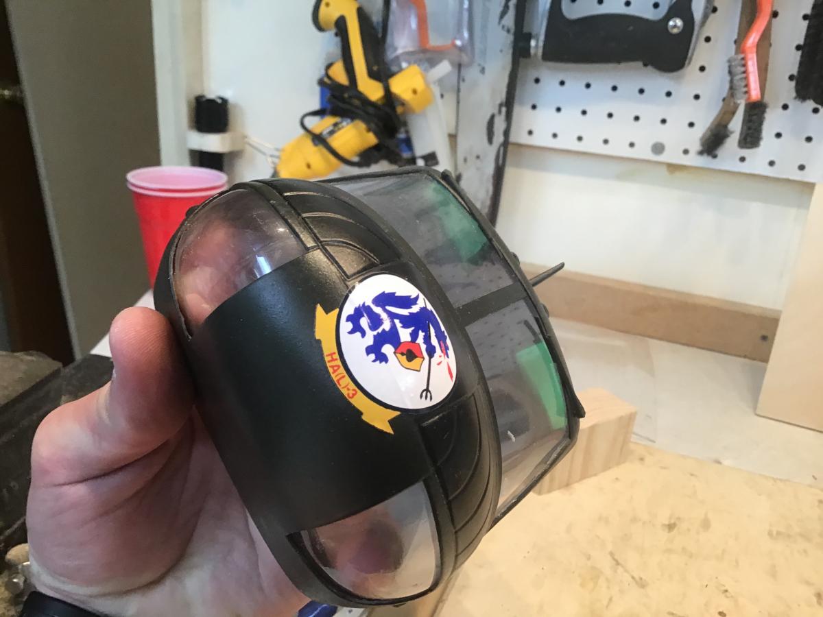

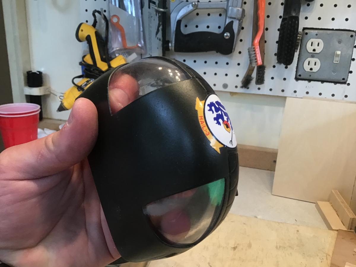

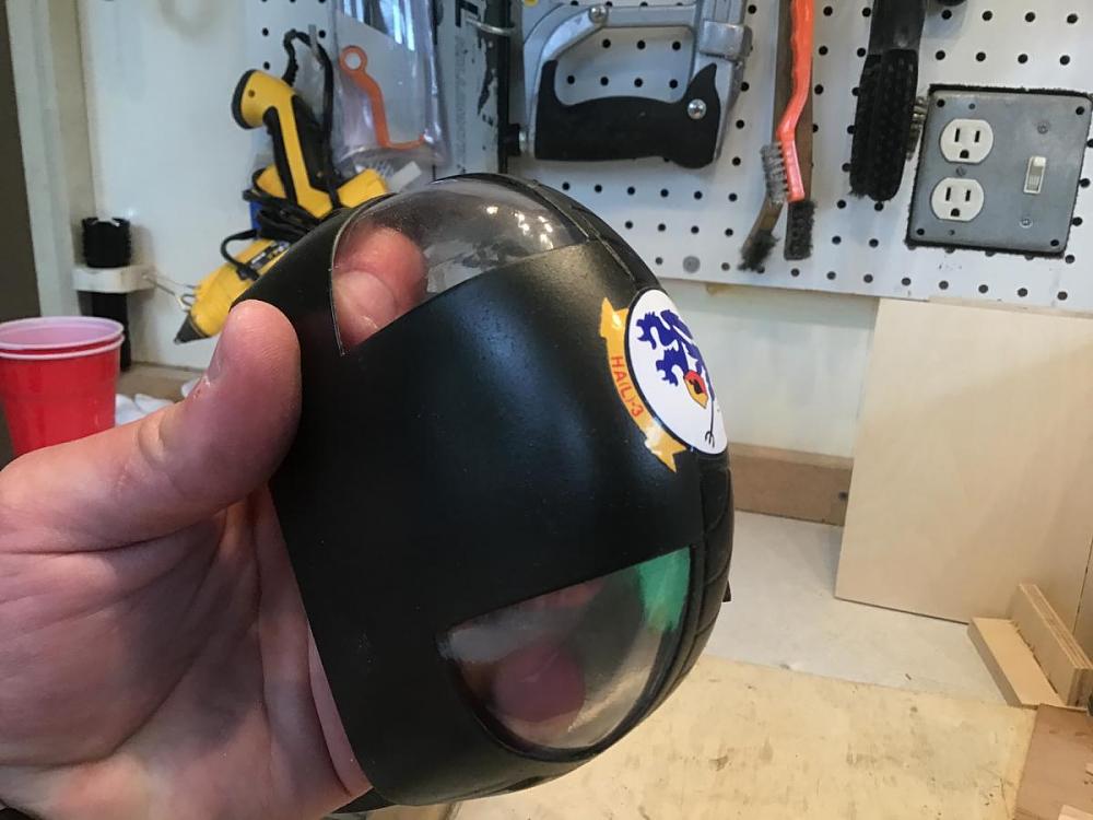

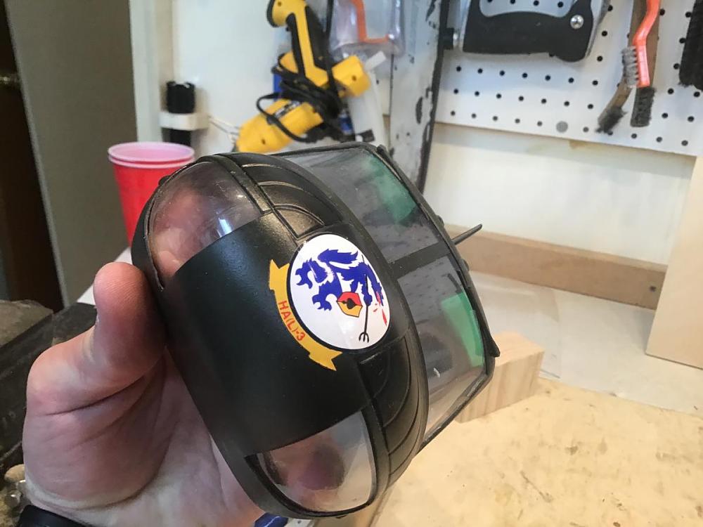

For a while now, I’ve had my Huey finished except for 1 part; the chin bubbles. After waiting for 2 months now and searching for different sources, I finally decided to make my own. Built a few wooden molds, set up the vacuform machine, and pulled a new set of bubbles. Very happy with how they turned out for a quick job! All that remains, is to change out the tail servo for something a bit faster and I can call this project complete!
