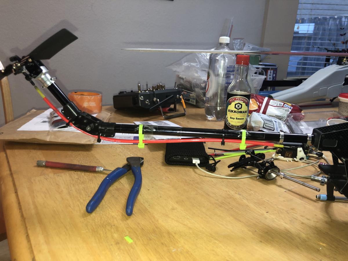

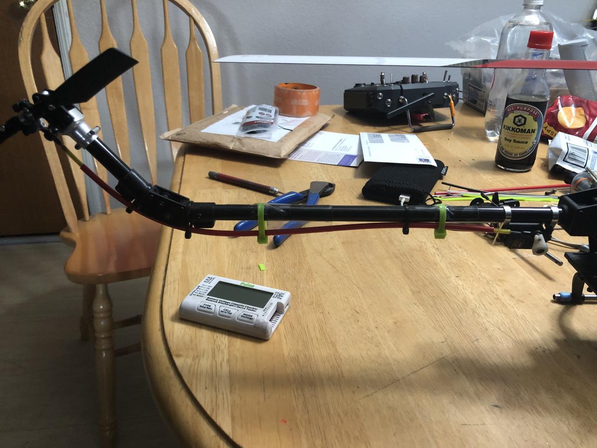

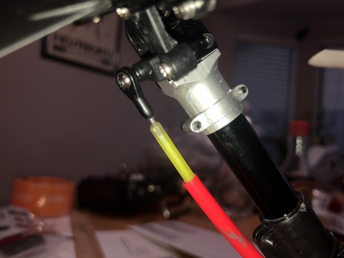

    Guys you haven’t, do the tail mod F106DeltaDart did. It made all the difference in the world. My tail gain is right where all my 450 microbeasts are at now. Between 27 and 30 and rock solid. Also now that my tail is under control I can see it working on 4s as I tried it at 50% throttle on 6s and I hand good tail control.
    im going to get a talon 60 before I put it all back in
    I also made some shims so when I put her back into the fuse it will sit level instead of leaning to the left.
    she’s going to be a sweet flier.
