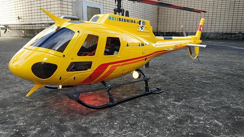

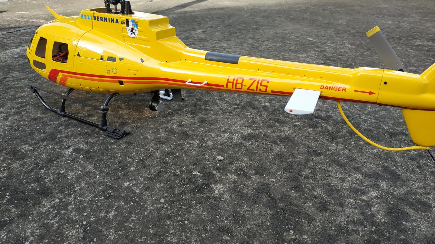

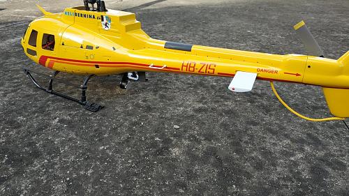

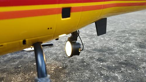

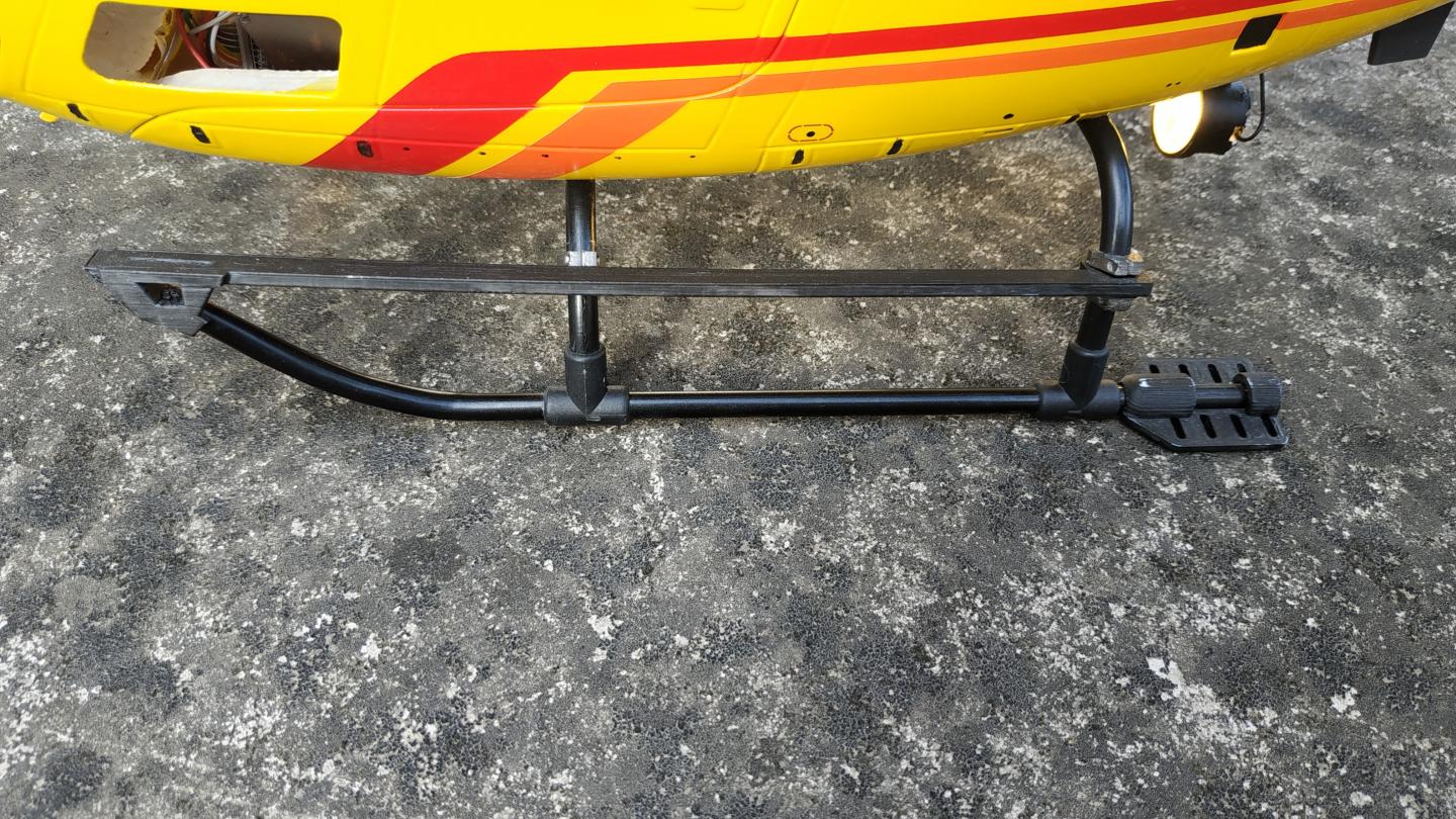

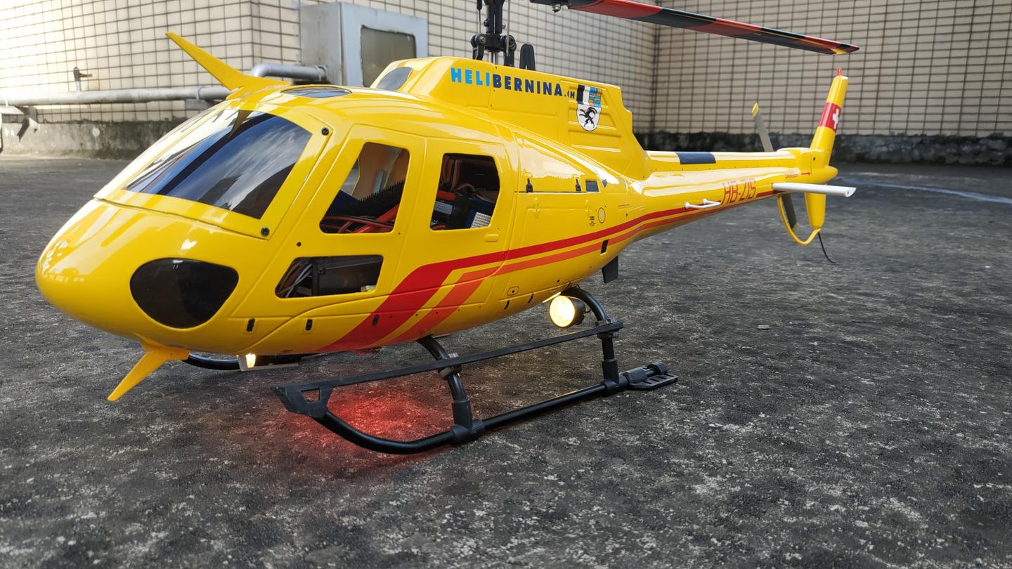

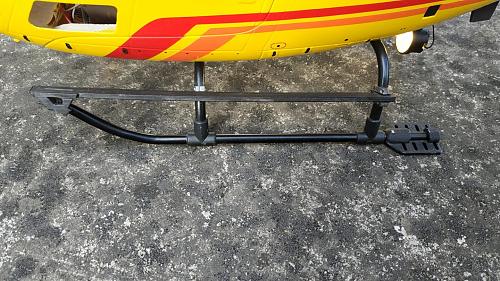

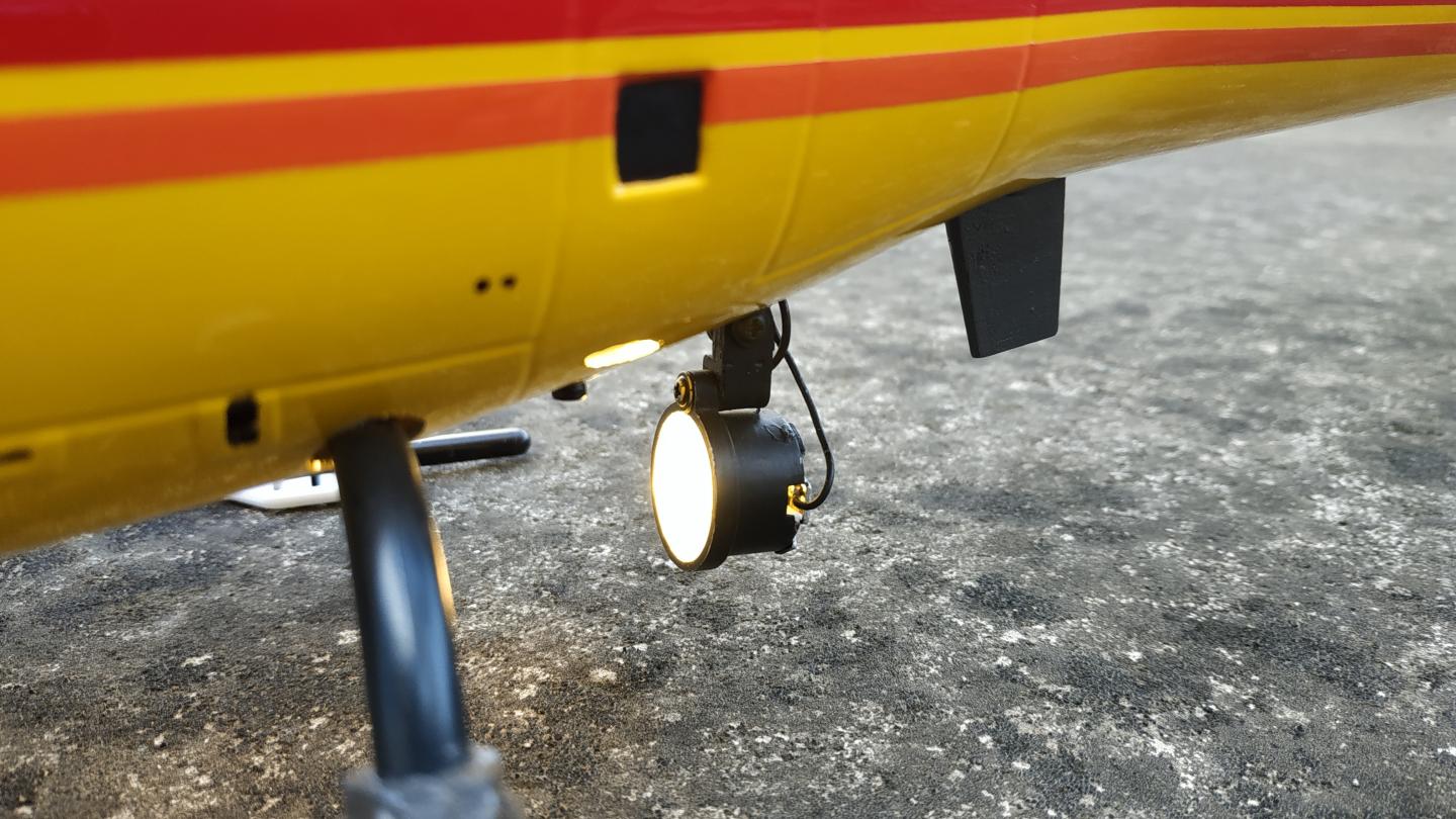

                    Hi Chief58D, as you requested, attached are the adjusted files for the AS350. The LED mounts are now affixed with screws instead of glue.
                    If you had any questions about specific 3DPUP files, where they go, or how they're attached, just post and one of us can chime in. I titled the files with a prefix that states which general area, then you can cross reference these photos to confirm the exact location.
                    Click image for larger version  Name:	IMG_20190704_165907.jpg Views:	0 Size:	219.9 KB ID:	204294Click image for larger version  Name:	IMG_20190704_165856.jpg Views:	0 Size:	255.4 KB ID:	204295
                    Click image for larger version  Name:	IMG_20190704_165646.jpg Views:	0 Size:	175.3 KB ID:	204293Click image for larger version  Name:	IMG_20190704_170038.jpg Views:	0 Size:	301.0 KB ID:	204296
                    The LEDs install very simply. More detail in one of my earlier posts on Page 1. Now, both belly LEDs and the Searchlight are screw-on, and the searchlight is also adjustable for angle.
                    I'm still working on the exhaust and static winch.
