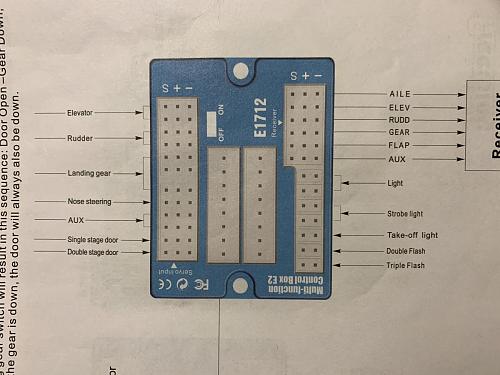

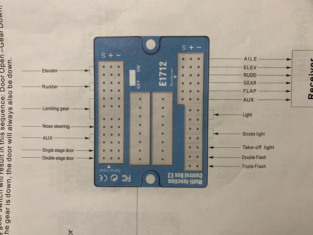

    Every one of these "blueboxes" that I've seen in my planes have the ability to plug lights in. Here is the diagram of the one from my F-22 and you can see all the light inputs (2-pin). All Freewing LED lights should accept the same voltage that comes out of these blueboxes and all are 2-pin. Since only the take-off light is used, the rest are open for you to choose. You should have this same diagram in the manual of your F-22. If you want something much brighter from an aftermarket kit, then you may need to also get their light controller and plug that into the appropriate port on the RX.

    Thanks that’s great. The videos I’ve seen the f14 leds look bright enough for me.

    Originally posted by Gsky
    Hi everyone,
    im looking into fitting some lights to the f22 for orientation.
    I saw some people using the f14 light set. Does anyone know if these lights fit straight into the bluebox? Or would the l39 set be easier to fit? Im not so got with the soldering/wiring.
    thanks for the help.
