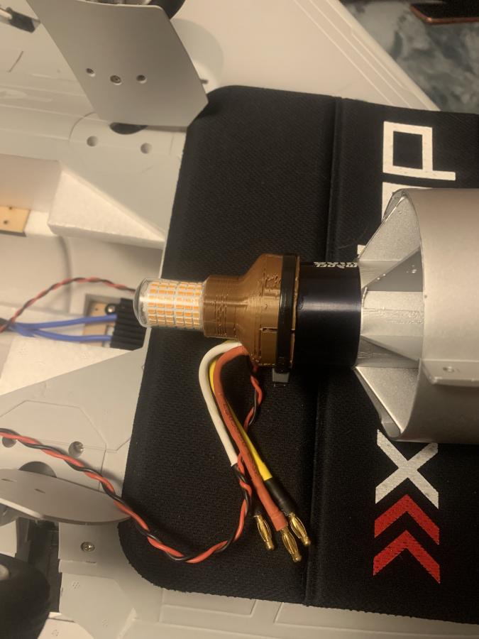

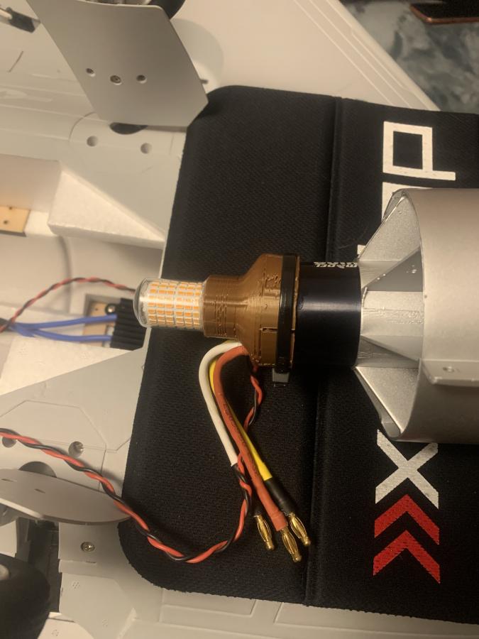

    Thanks Gmack908 I had a four cell balance plug so I just resoldered it on an copied the same pattern. And it works now. Wow you got lots of wires all over the place hehehe

    You can push it out and move it. You only need two wires. Should look like this if attaching to one 4s battery.

    Here is what I have
  • Av8er278

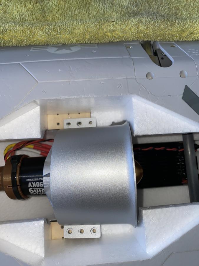

    Ok got my afterburner in with a little cutting looks good. Only problem now is it came with the balance plug for 6s battery I’m using two 4s batteries. Do I copy the same with positive pin four in from left?
    Helps reflect the light and stop light from just shining through the foam.
  • Av8er278
    Yes some people put aluminum tape inside.
  • Gmack908
    What’s that? Inside the exhaust cone to make it shine brighter? I did not. You can see it in broad daylight no problem. If it’s in your house or in the dark the lights so bright it makes the whole back of the fuse glow lmao
  • Av8er278
    Thanks Gmack908. Looks good guess I’ll have to do the same. Did you use aluminum tape also?

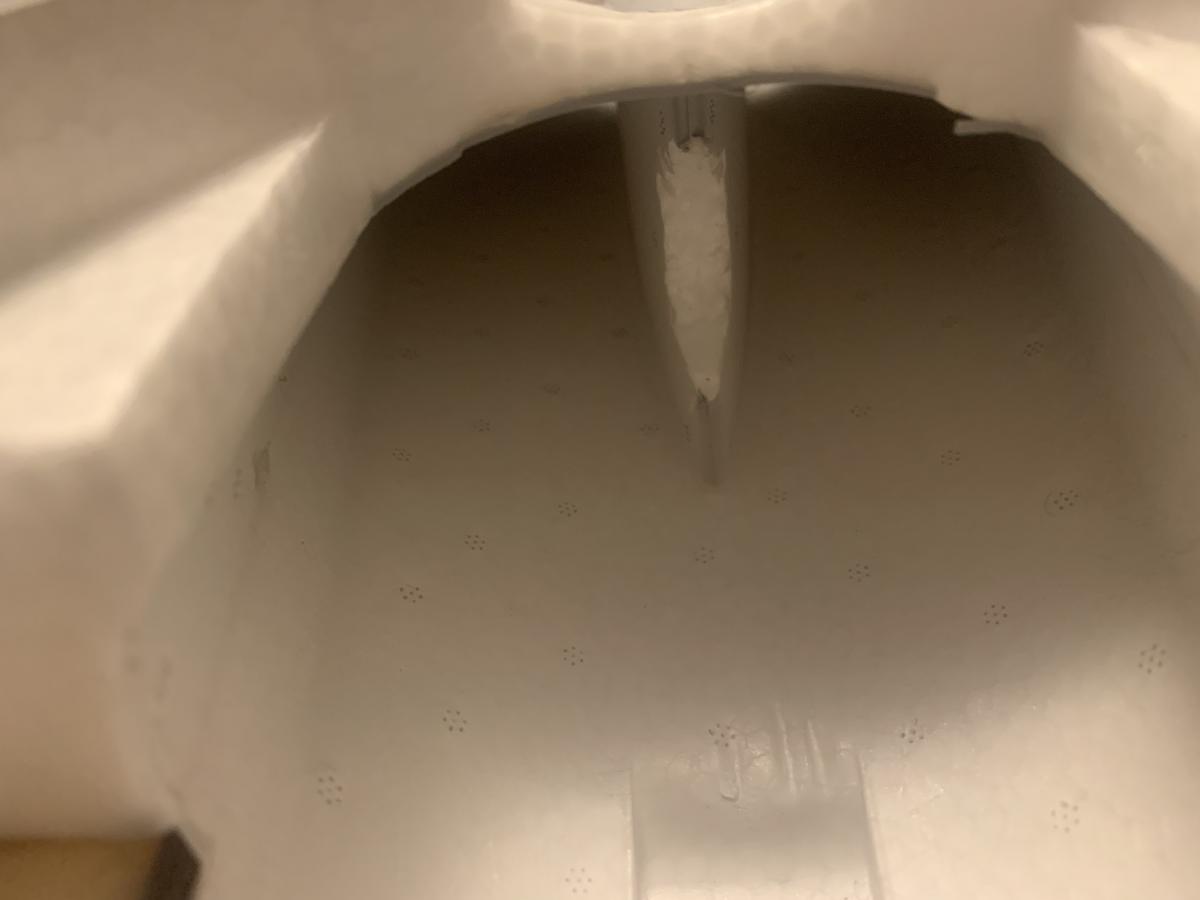

    Originally posted by Av8er278

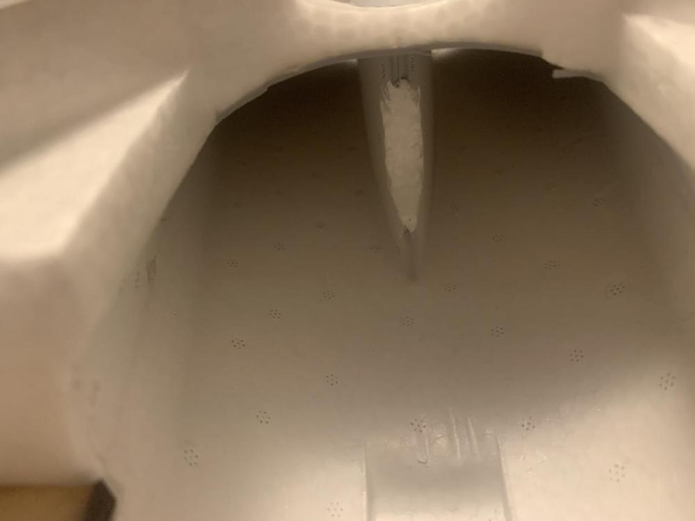

    I really don’t want to cut up my plane. And if I did the only problem with that is the very end where there are led’s would be inside only the led’s on the side would be lit and not sure if that would be bright enough for the full effect. If the light unit was shorter there wouldn’t be a problem. I wonder if the others that have this had this problem and what did they do.
    Yes I had to as well. I used a potato peeler.
    Yes, they cut it. Just do it. Add some aluminum tape back there to help reflections.
  • Av8er278
  • SanExup
    Can you smoothly shape where you cut into a blunt V? To keep the light essentially inside the duct? And maybe use reflective tape in that area...
  • Av8er278
    I really don’t want to cut it and disrupt the air flow. And from the looks of it if it was cut the burner wouldn’t be as bright with it inside of the V.
    Sure looks like it...

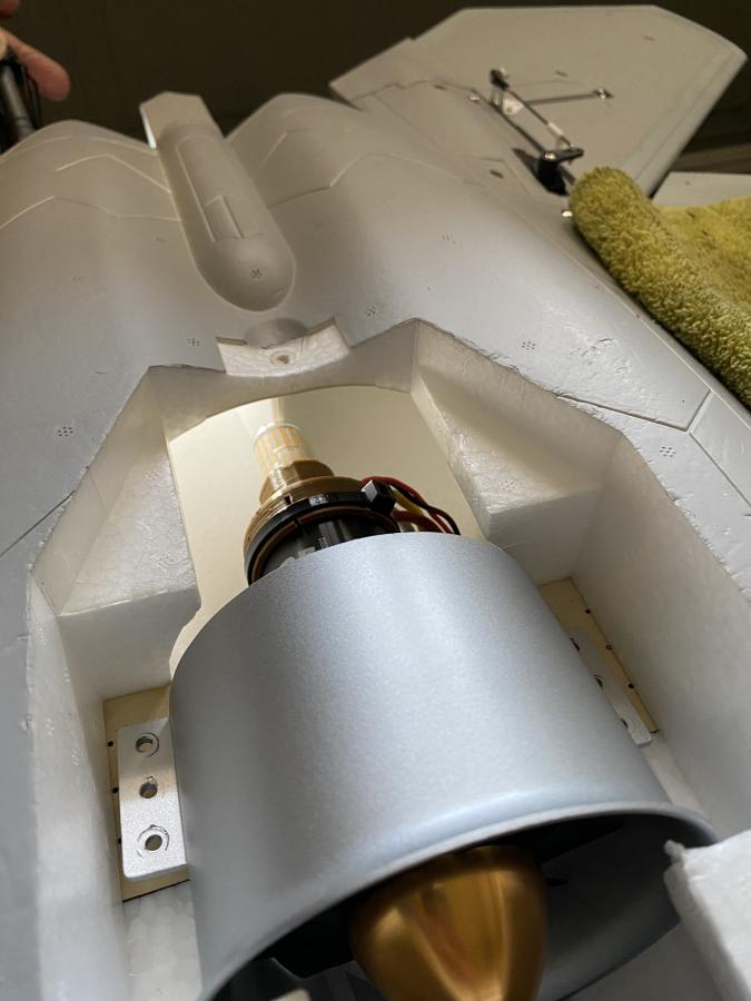

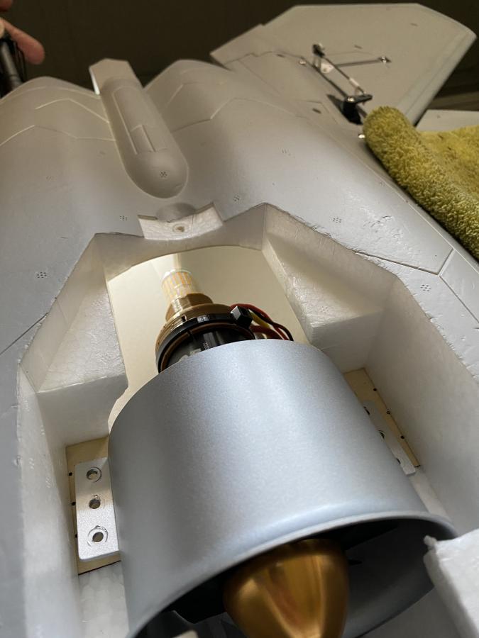

  • Av8er278
ID:	307210 Hey guys do I have to cut foam to make my afterburner fit? It hits the V portion and fan won’t fit. It’s about 1/2 to 3/4 inch to long. Click image for larger version
