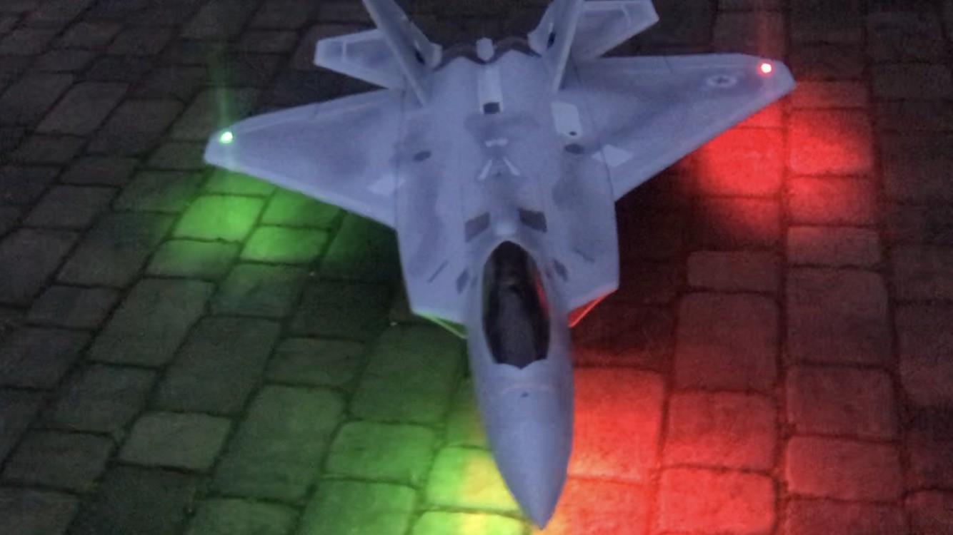

    Took mine yesterday for a spin , was pretty windy, wasn’t sure then i did it. I have the 8S version and i never have a single problem after 50ish flights . All stock, just add lights on wings and front side . The AB are from the RCGeek .. a must on jets
    Gray sky helps alote to show led for orientation.
    this jet dosn’t have the looks of a “ OMG “ but sure is a great flyer.
    great power even after rain on grass, dosn’t care, will go up no problems at all .
    super easy to fly , in my opinion much easier this then the t-45 which aswell it is a easy jet to fly .
    had fun !

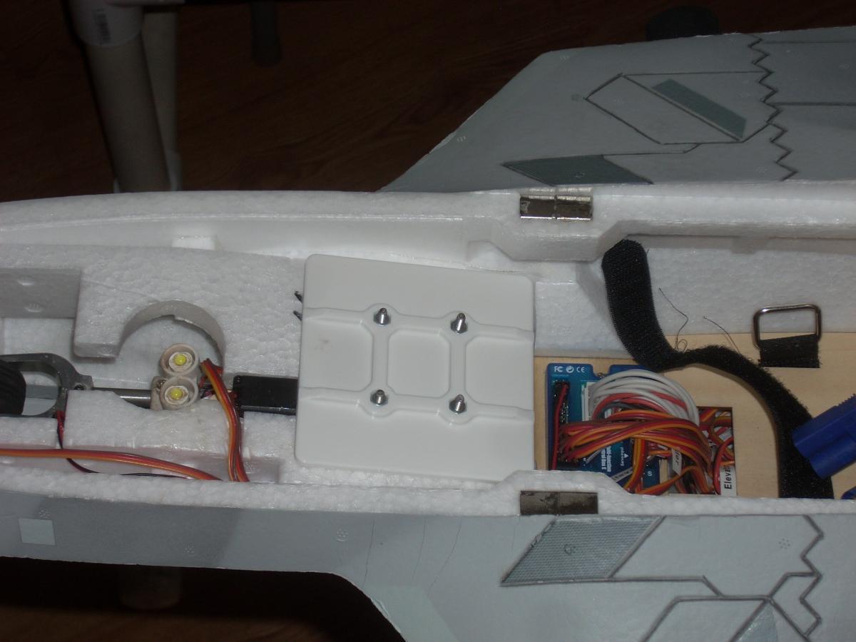

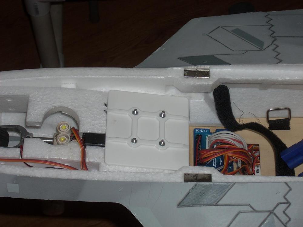

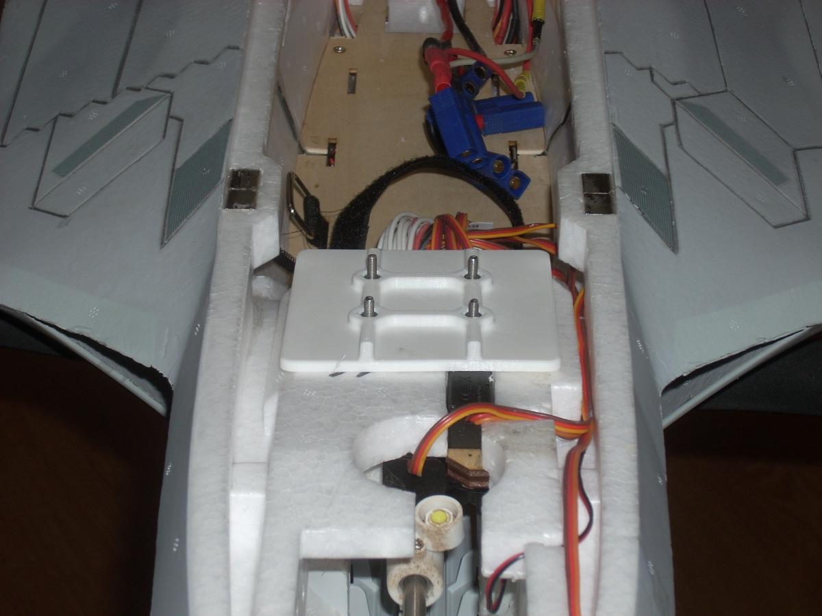

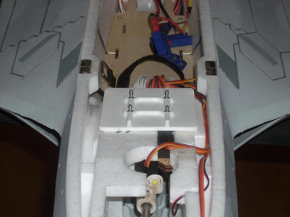

    When you first talked about this, before you got a replacement MCBe I thought you had something plugged in wrong. I still do.
    Here are the instructions. Please verify you have the nose gear doors in the single stage door slot, the second connection in. And that the landing gear servo is in one of the landing gear slots and the steering is in the steering slot (I think you probably have those right).
    MCB-E.pdf (shopify.com)
    Evan yes that’s the first thing I checked to see if factory did it right and all is correct. When I got the new MCB-E I made sure all plugs were in correct place and checking it twice. This time it does the same thing but with a new twist. With transmitter on then plug in battery on plane door servo arm goes up which makes the door close more and makes it overlap. The strangest thing is when I first got the new MCB-E in it worked perfect only once. But after the first time it has the same problem and with the new problem.
