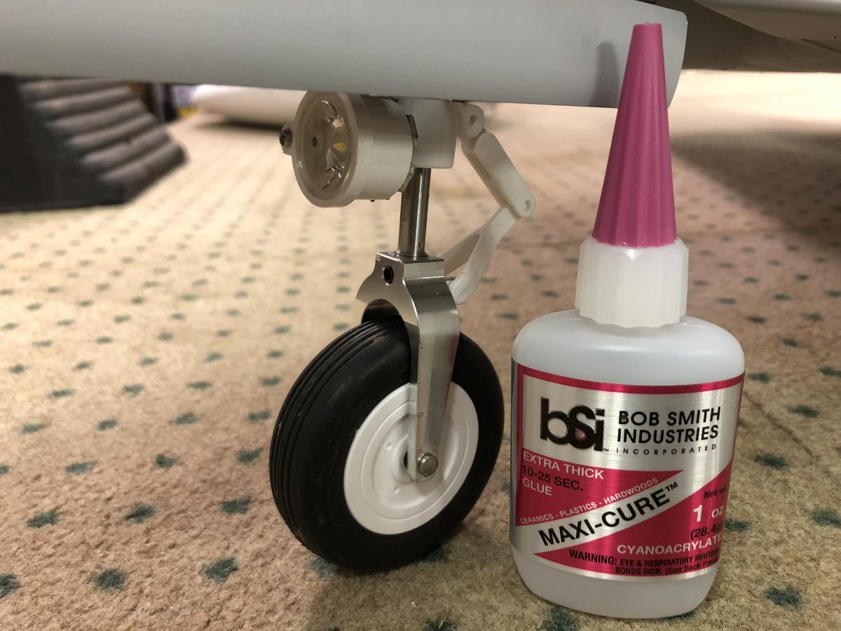

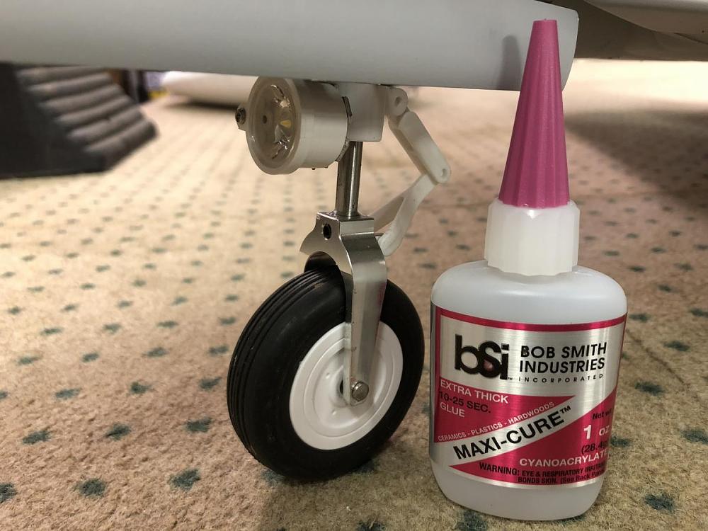

                  To all of you guys that are enjoying the F-22, check your nose gear! Maidened this morning really successfully, greased it on for the landing. Took it back to the bench to swap packs to go up again. Was mid-takeoff rollout when the front gear came off and sent the front of my beautiful F-22 into a dirt nap. Guess that's life with a grass field :(. Gonna contact Motion to get them to replace my gear doors and maybe gear assembly if the damage is too bad. All things considered, I'm glad it happened earlier than full rotation speed since the 8s bird is pretty heavy. Just such a shame to see my spotless new bird dinged up at all... Looking forward to getting back in the air though! Have a pic of the scene but HobbySquawk won't let me upload it.

                    Originally posted by Patriotic_Banana
                    PUBLIC SERVICE ANNOUNCEMENT!!!
                    Try resizing the picture, it's probably a file size limitation.
                    Welcome to Hobby Squawk, sorry about your trouble:(
                      I have checked mine several times and it is still rock solid. Only 4 flights on it though but all off of grass.
                        #951
                        I re-tightened mine and used this to take up any slack between the pin and yoke.

                          Sorry to hear about your Dirt nap issue. Another member had the same issue before take off. He posted a few pages back.
                          Being Primarily a helicopter pilot I always check and Loctite anything metal to aluminum. It doesn’t look like free wing Loctite any parts on their models.
